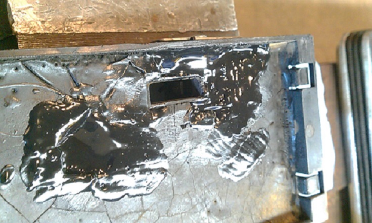

Did a quick repair on the relay board.
Come to find out the spade lugs on my new voltage regulator have a step on them.
Which causes you to push the female ends out thru the tar coating. (IMG:style_emoticons/default/sad.gif)

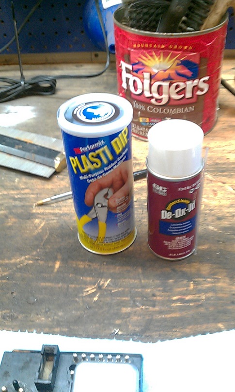

Weapons ..................
Brushed on the Plasti Dip. Let it sink down and skin up for about 10 minutes then flipped over and let in dry. I only gave it about an hour to dry.

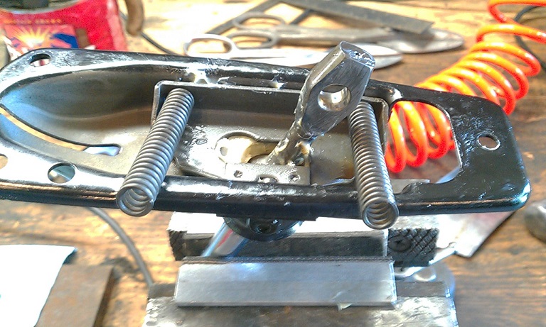

Did quick clean up on the shifter.
As long as I've owned these cars I never taken the shifter apart.
I was having trouble with the 4-5 shift.
This was special. I didn't shoot any pictures of getting the springs compressed.
Basically I bowed the open end to the hole. Then slid in an M6 bolt to hold it in place then tapped the pin thu. You have to keep your thumb on spring to keep it from bowing up and out.
Oh yeah ..................gooder than new.

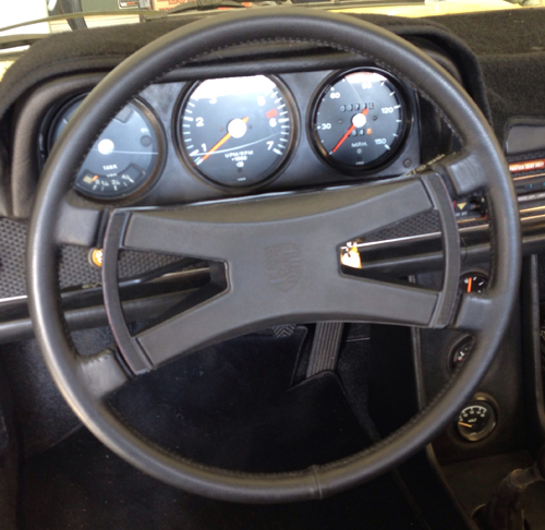

Just got my new Leather wrapped steering wheel. This goes very nice with my new carpet, console, and backpad. Next up, new seats. Maybe this summer...

Where did you get your steering wheel done and how much? Looks great!

I sent my wheel to Alan Gun Leather in Florida. It was not cheap. $330.00. But it was done very well and is now absolutely perfect. As good or better than when they were new from the factory.
I have used them in the past and knew it would be perfect. They take a while, but the quality is the best and it was worth it.
This was a present to myself to celebrate my first successful engine rebuild. I love the feel of a quality leather wheel when driving.
