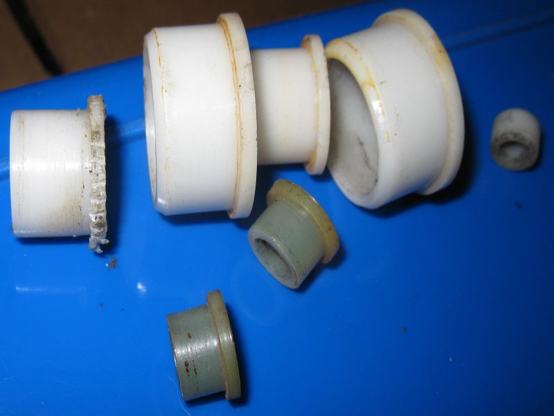

Replaced pedal bushings with bronze kit.
I have records for this car going back to '74 and they had never been
replaced. The condition was amazingly good for ~44 years. MC probably
never leaked in there, but still, I could have left these alone. The only
issues were caused by removal.

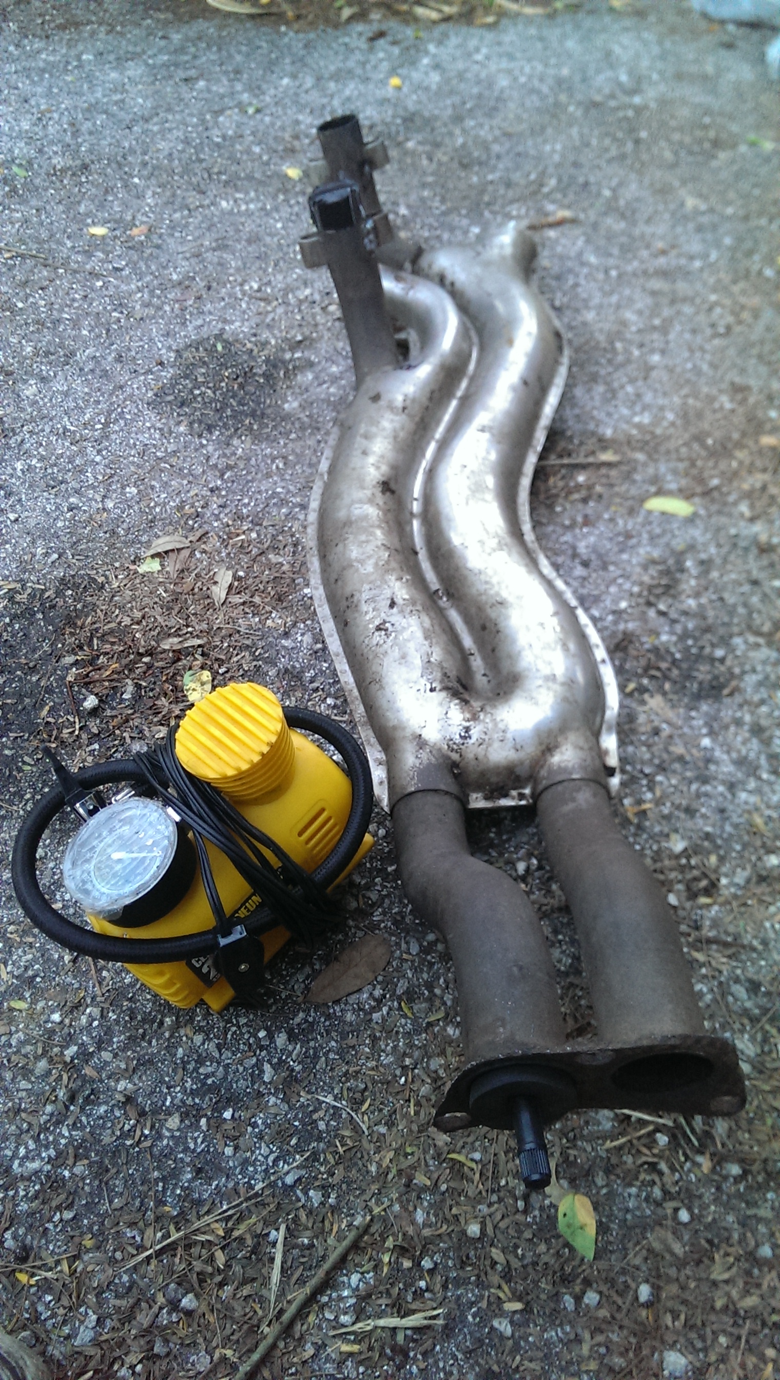

Anyhow, yesterday I finally decided to start testing my SSIs that I got on Ebay last year. Used two rubber plugs and drilled one for a valve stem. Added water to the pipe, then hooked up my cheapo 12v compressor. Results: only one pipe holds air currently. (IMG:style_emoticons/default/mad.gif)
The good news is that on the ones that were leaking, the leaks were visible outside of the HE portion. Mostly small cracks around the top of the portion that bolts to the heads. Should be able to file then and fill with a few short welds.

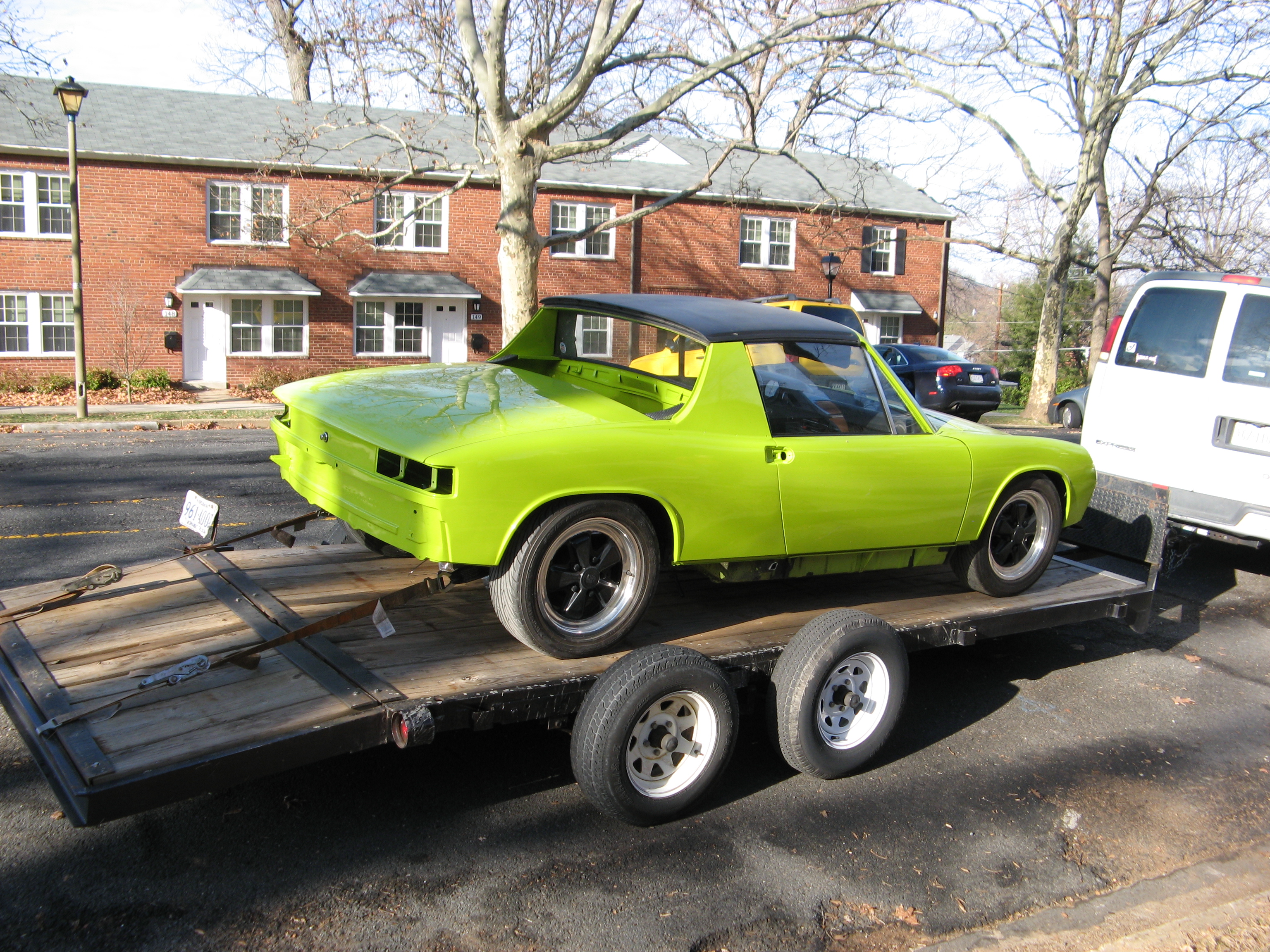

Not today, but this past weekend I got it back!!!

Nice (IMG:style_emoticons/default/smilie_pokal.gif)

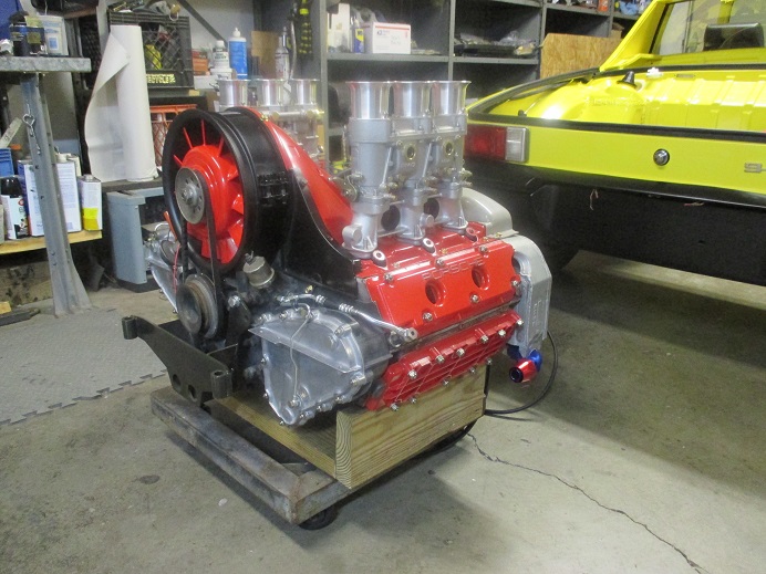

Mounted clutch & pressure plate and started fitting carbs...

QUOTE(t collins @ Dec 27 2013, 07:53 PM) *
Mighty Purdy! (IMG:style_emoticons/default/beerchug.gif)

thanks

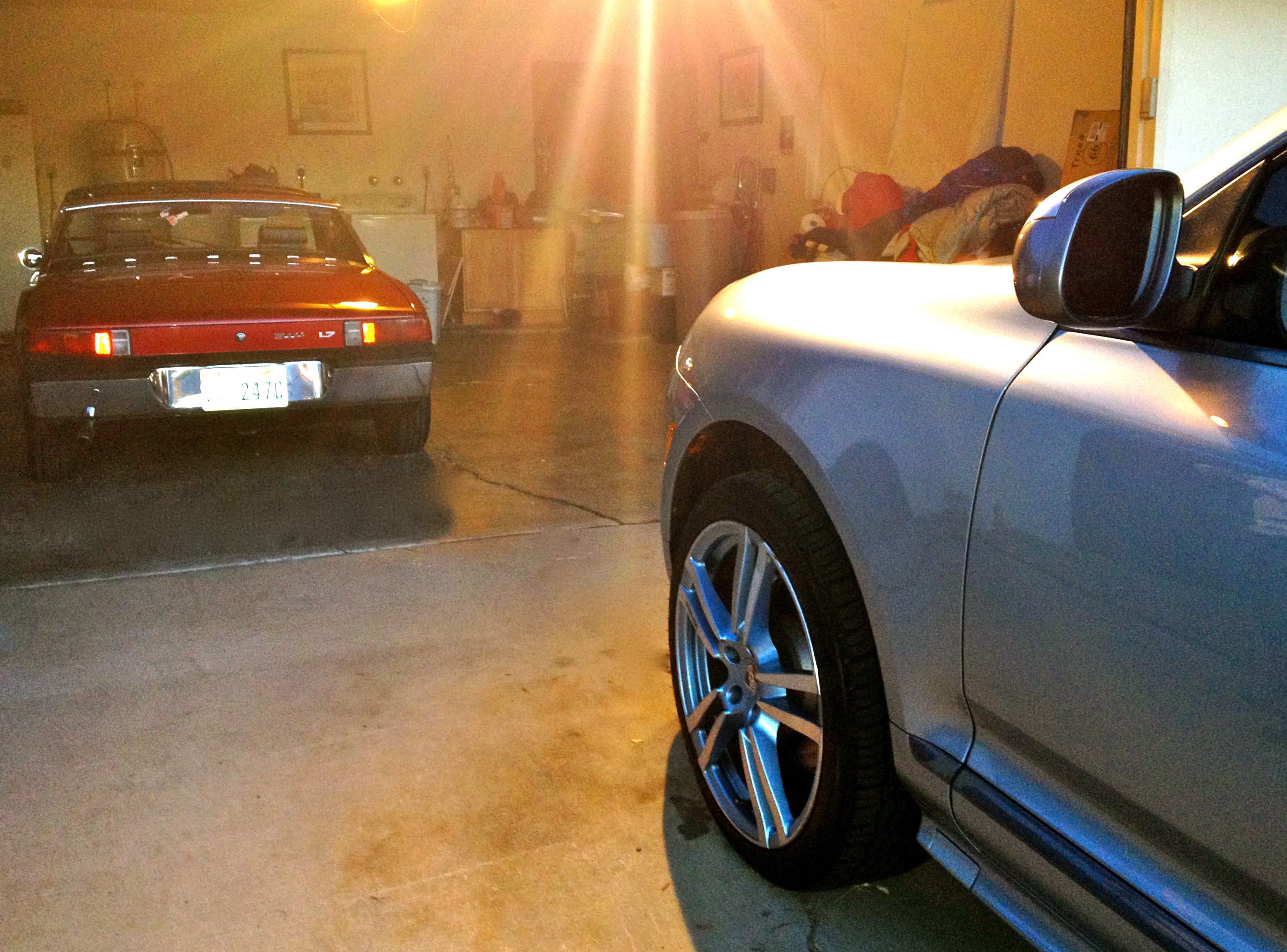

My Teener got a BIG brother.

(IMG:style_emoticons/default/drooley.gif) Nice Christmas present (IMG:style_emoticons/default/santa_smiley.gif)

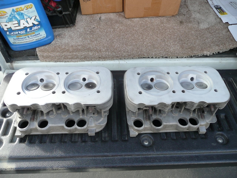

Colin (colingreene) and his dad stopped by the shop and grabbed a set of 2L heads.

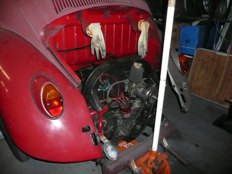

Later, a radio bud (Fred) came by and we dropped the motor out of the bug. Need to deal with a leaking rear main seal (IMG:style_emoticons/default/dry.gif)

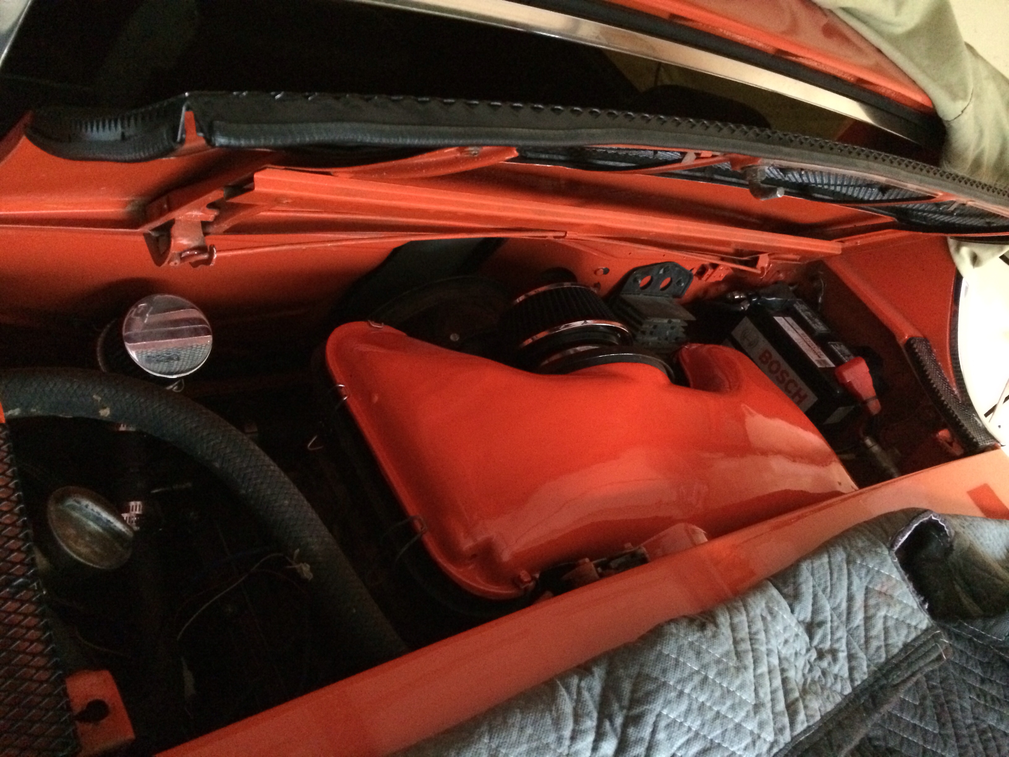

Installed my factory air box for the carbs for noise reduction and maybe the look.
