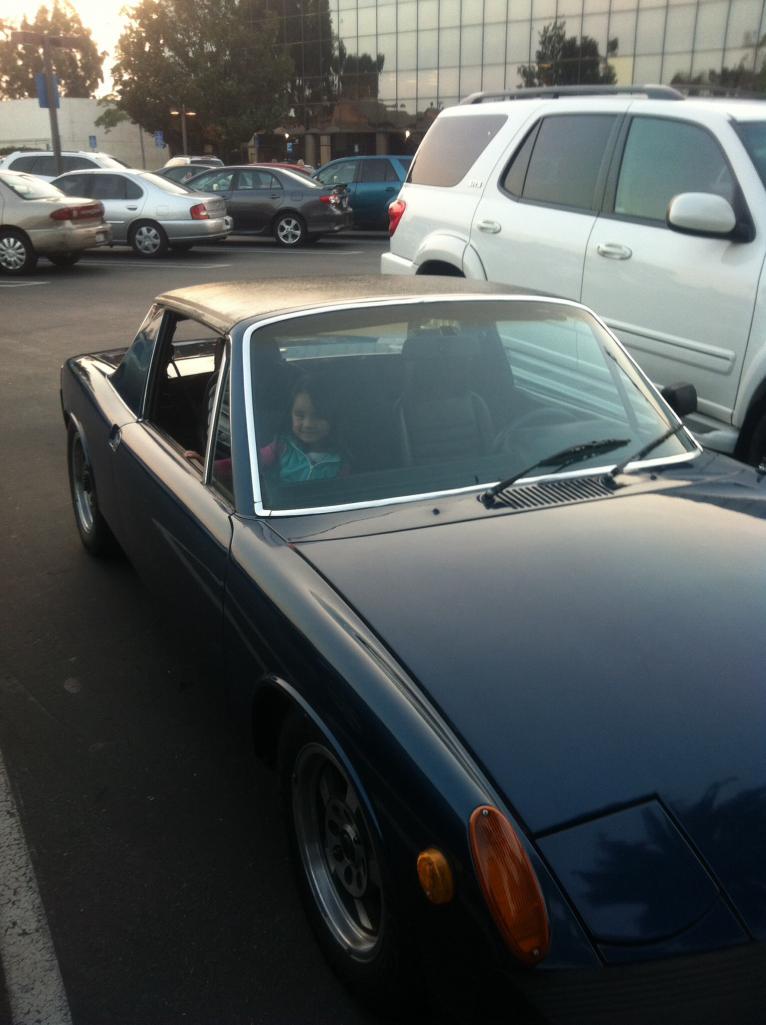

My 5 year old daughter insisted me that we use the blue car going to her doctor's appointment. Well here is a picture of her after doctor's check up in Kaiser. Drove it for a 25 minutes side street one way. And what I noticed after removing the rain tray this afternoon from the engine hood, my temp stayed only to a maximum of 210 degrees.

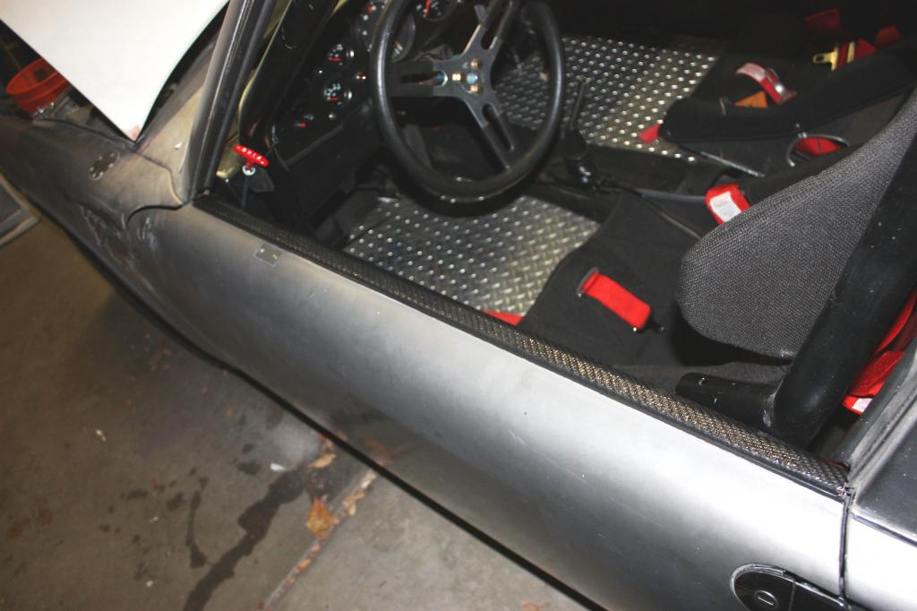

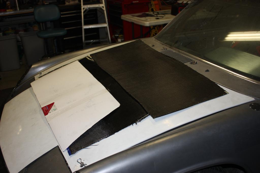

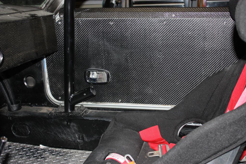

Finished my door panels.
hand layup carbon fiber.
Here are the bare sheets that we made with vacuum bag & a piece of glass.
The template is laying on top. We rough cut the sheets with a tile saw to that shape, then trimmed them down with a belt sander.
(IMG:http://www.914world.com/bbs2/uploads_offsite/i366.photobucket.com-10819-1389417011.1.jpg)
Pass side panel:
(IMG:http://www.914world.com/bbs2/uploads_offsite/i366.photobucket.com-10819-1389417011.2.jpg)
Driver side:
(IMG:http://www.914world.com/bbs2/uploads_offsite/i366.photobucket.com-10819-1389417011.3.jpg)
The top lip has no hole for a window.
The top lips were vacuum bagged over a wooden positive mold
Drivers top lip:
(IMG:http://www.914world.com/bbs2/uploads_offsite/i366.photobucket.com-10819-1389417011.4.jpg)
There is no hardware inside the door except the latch.
It is so cool to slam the door and have it sound like a drum.

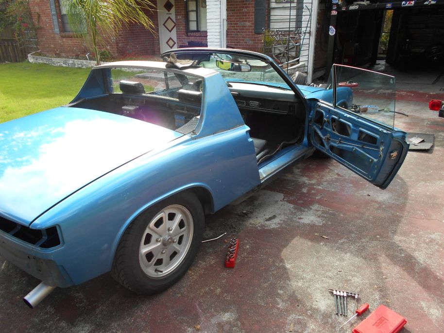

Stripped the Trim off the car to get it ready for Paint

QUOTE(carr914 @ Jan 11 2014, 04:35 PM) *
That is the original color of mine. Keep us updated!

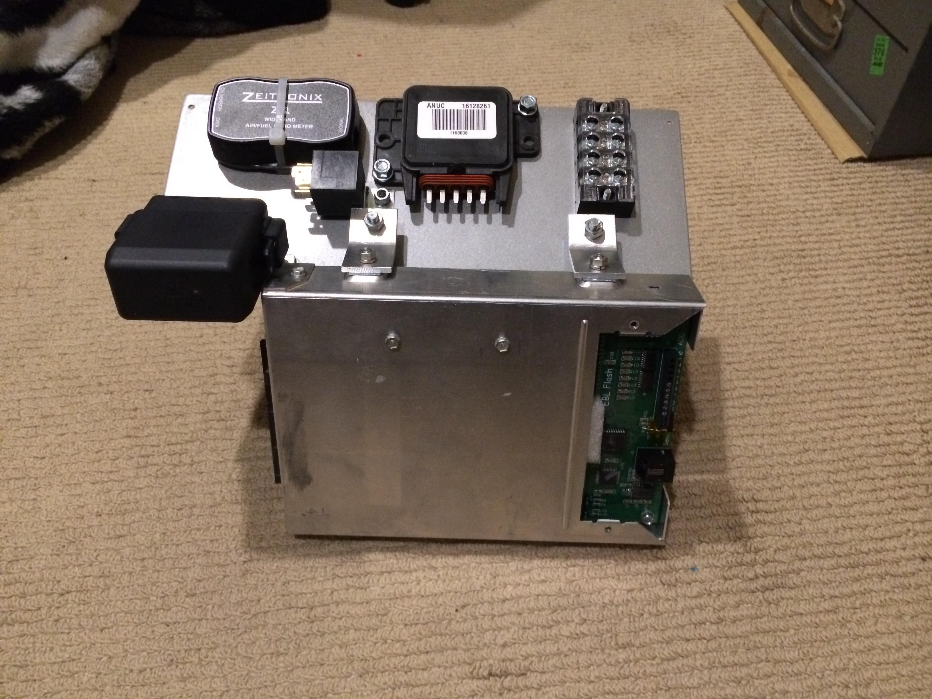

Built a panel to mount the GM ECM and assorted other bits for the TBI conversion in the trunk.
Taught my homebrew LED instrument panel to read the data stream from the EBL Flash in the GM ECM; will let me do away with the speedo, tach, coolant temperature sensor wiring, read trouble codes, etc. Still a shocking ratsnest, but that's prototypes for you...
