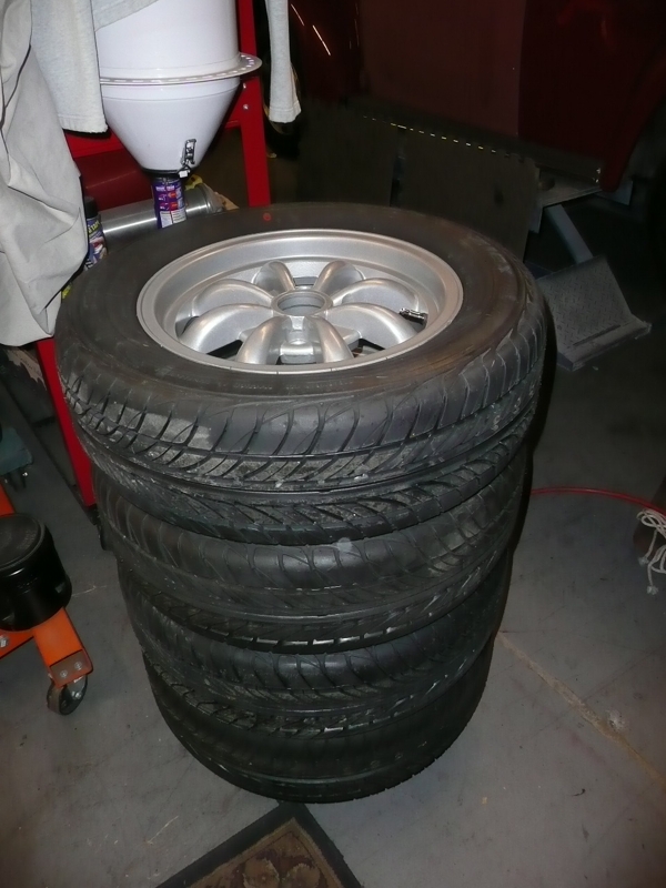

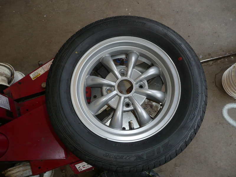

New Falken Ziex ZE-512 tires mounted and balanced on a set of powder-coated EMPIs. These are going on my wife's car (until I get her stock 'steeles' powder-coated) ... then they'll probably go on the 'BB' until my other (better) set of ATS Classics get refurbished (Al Reed ? ) (IMG:style_emoticons/default/smile.gif)

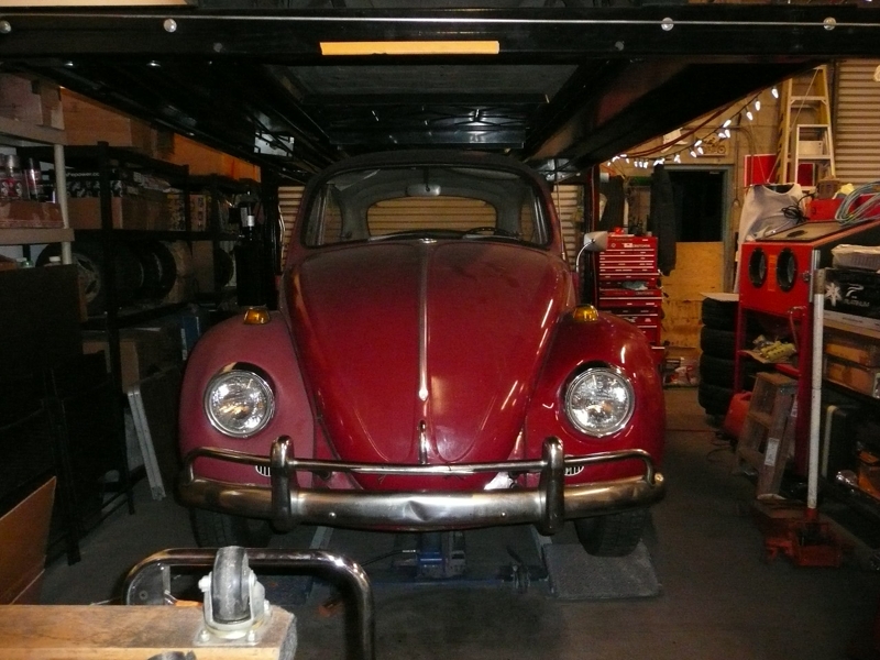

'67 Bug stuff:

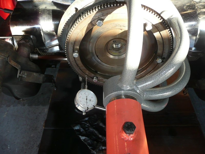

Checked crank end play: .120" (IMG:style_emoticons/default/blink.gif) ... uh, no wonder why the RMS was leaking.
Picked up an assortment of shims, a new o-ring and a RMS to correct that issue.
The PO literally threw this motor together and failed to install a lot of the required cooling tins too (IMG:style_emoticons/default/dry.gif) ... Located and hot-tanked the needed tins and painted some of the visible stuff.
The MC reservoir was leaking where the lines connected - fixed that and readjusted the front bumper (while I was down there). It was pretty crooked.
Scrubbed and painted the wheels and threw the bling accessories back on (IMG:style_emoticons/default/laugh.gif)

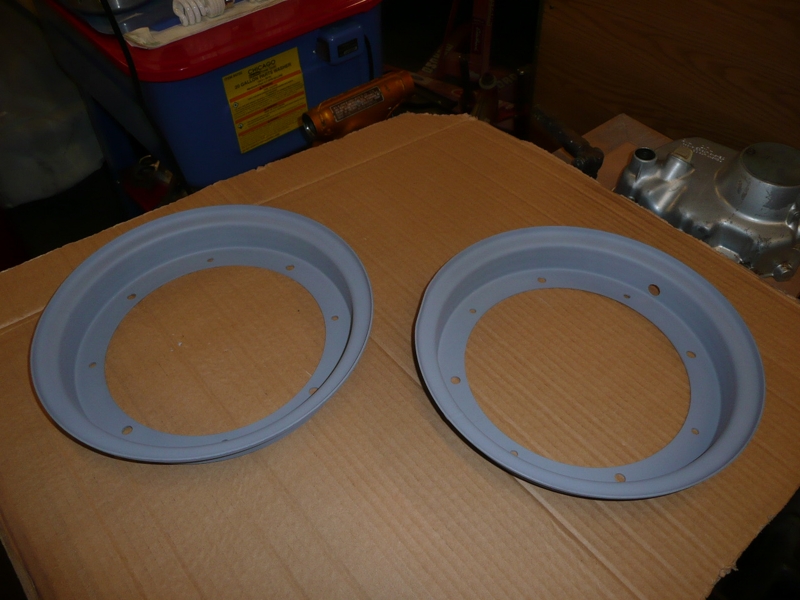

Blasted and primed some rusty Honda Mini Trail wheels (we're also building up a few basket-case bikes that have been sitting around for the past 10 years).

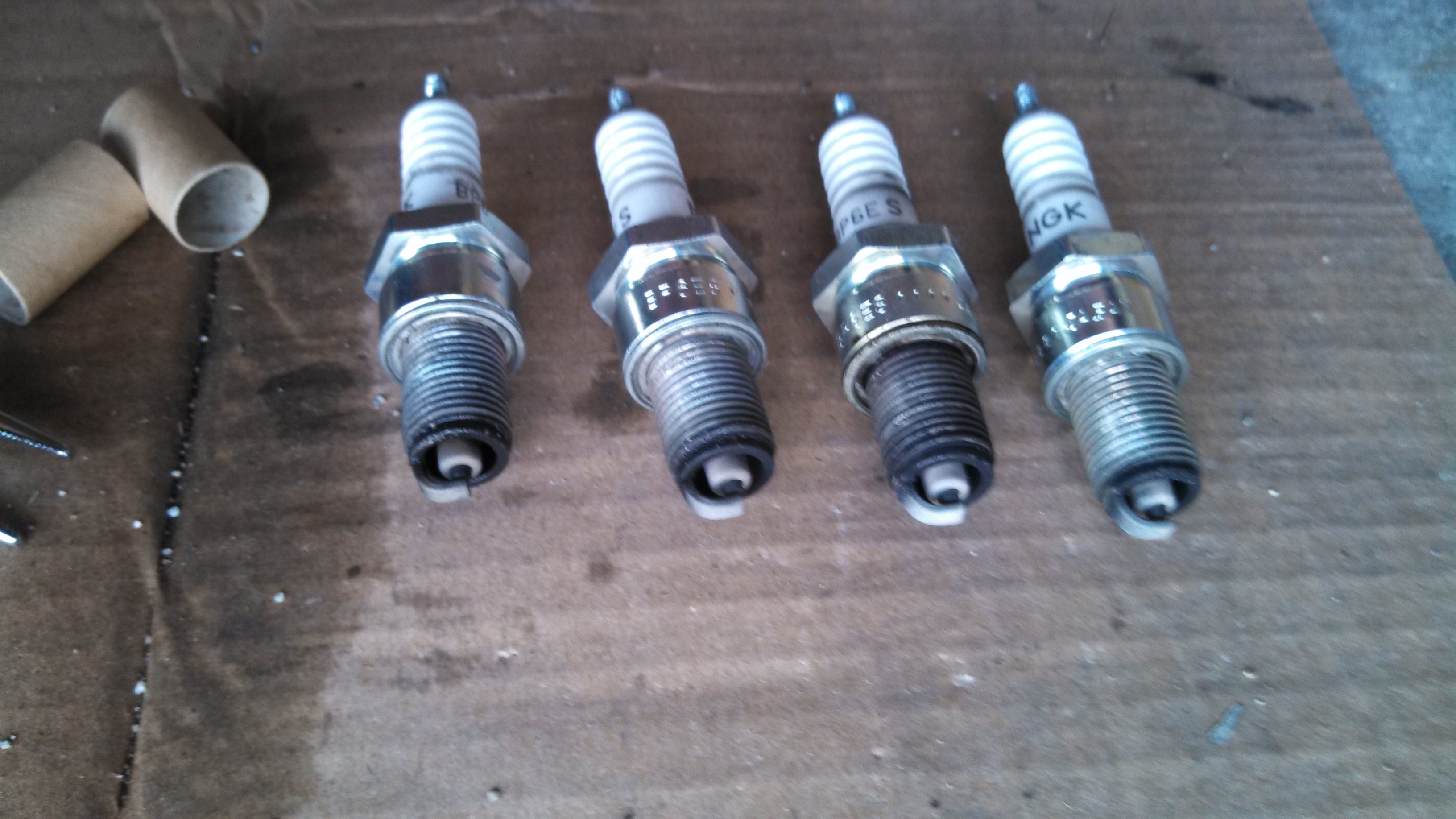

1. Installed new spark plugs (had done new coil and Clewett wires a few weeks back).
2. Installed 9.5mm to 8mm SS adapter fuel line and installed new fuel lines from firewall to the SS lines that go up through engine bay (both supply and return). PO had re-used an old tapered hose that started to leak on me.
3. Rattled canned my headlight surrounds in Semi-gloss black (thanks to another member here for getting me a new right side surround that had been broken by a rock or something).
Plugs looked OK.

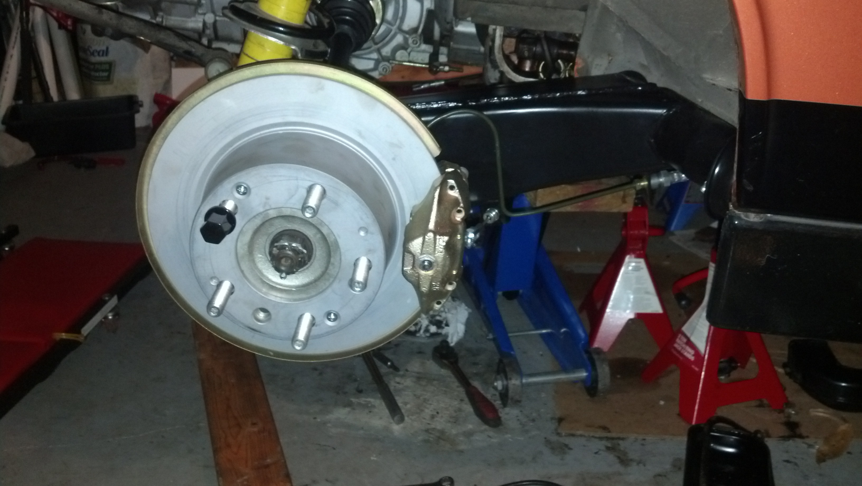

Installed new rotor , caliiper, brake line and e-brake cable, also new c.v. went no as well.

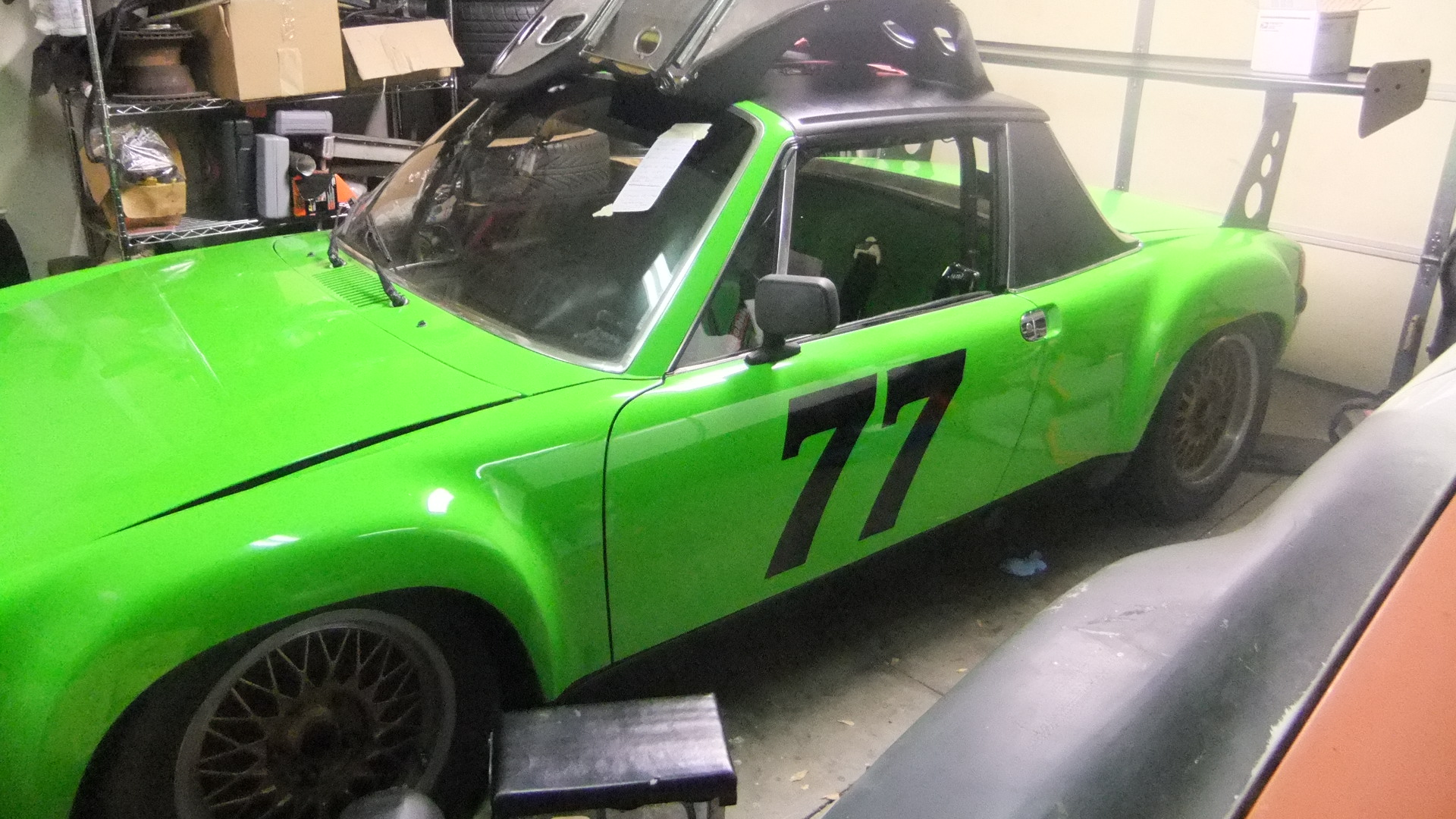

Track car finally got FG trunk painted and installed today. Installed new dash
(always good for a laugh) fixing broken wiper switch removable steering wheel and trunk.
Also started project that has been sitting for two years ..snowflake

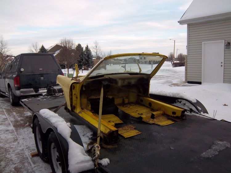

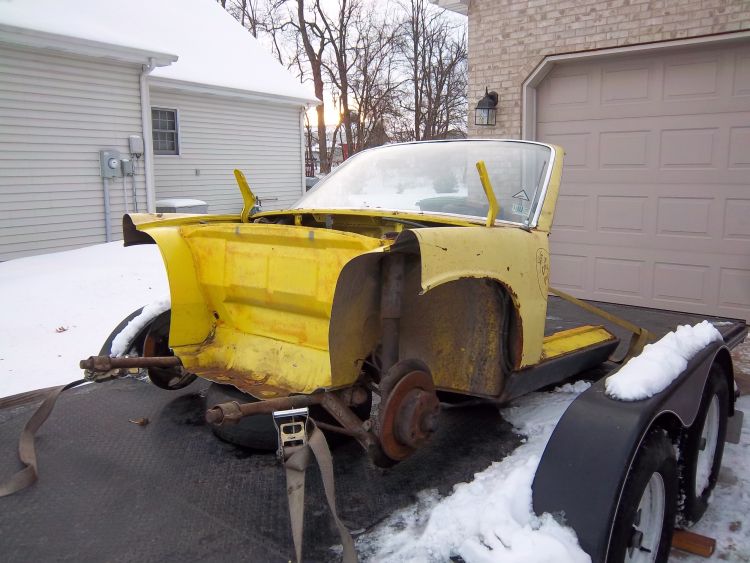

Finished (IMG:style_emoticons/default/sawzall-smiley.gif) 4722909504

Did you sell it or scrap it, Garold?
If scrapping, is the windshield trim good?
Did you grab the front fuel line grommet?
GaroldShaffer

QUOTE(euro911 @ Jan 26 2014, 11:04 PM) *
It is still on the trailer waiting for a day ABOVE 0 before I go to the scrap yard. I sold the grommet already and the chrome, if good I would have saved it.

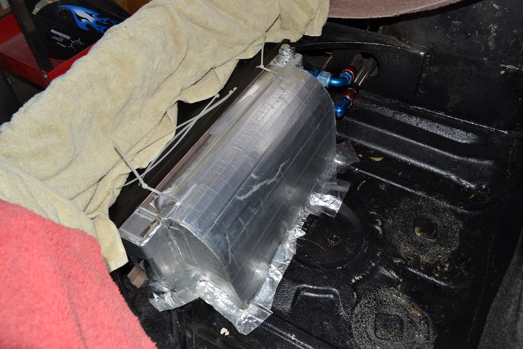

Almost done with the oil cooler setup in my car.. Unfortunately I can only work on it a weekend at a time, so usually every Sunday I have to make it driveable then take it all back apart thursday night when I get back from school.
Anyways, made an exhaust duct for cooler finally, here's the mold made out of cardboard, covered in aluminum foil tape, then 3 coats of mold release wax, two coats of PVA, and another 2 coats of mold release wax. I'll have a picture of the final product when I head out to my car later today.

what tire size did you install in that newly powder coated empis?
[quote name='euro911' post='1988700' date='Jan 26 2014, 01:12 PM']
Wow, nice looking drive trains (IMG:style_emoticons/default/thumb3d.gif)
914 stuff:

Falken 195/65-15. The guy I got them from said they were on a 914 with wide tires, so I just assumed they'd be OK.
The Falkens were really inexpensive ($45. each, no tax and free shipping from AZ), so we'll see how they work out.
If too wide for the car, I can always sell them to a VW guy (or girl) on The Samba ... or throw some skinnier tires on them (IMG:style_emoticons/default/confused24.gif)
