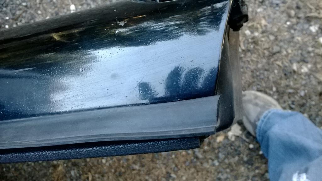

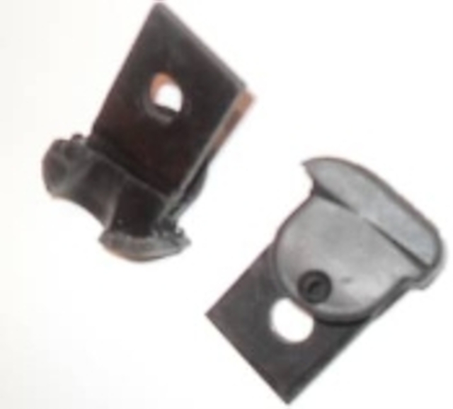

put in some new rubber from Mike
this is the passenger side and the scraper doesnt seem to fit right at the end.
euro911
post Feb 7 2014, 10:44 PM
Post #3666
Posts: 8,937
Joined: 2-December 06
From: So.Cal. & No.AZ (USA)
Member No.: 7,300
There's a small plastic end cap that attaches to the end of the scraper (it screws into the door), so you'll need to trim the scraper when you go to install the end cap.
Which end cap you need depends on the year of your car:
Early - click here
or
Late - click here

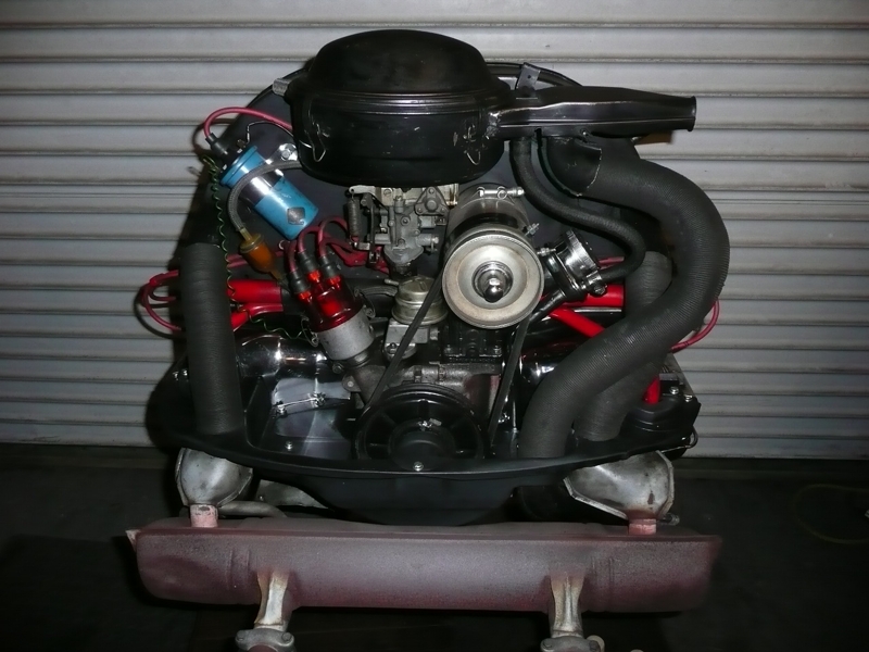

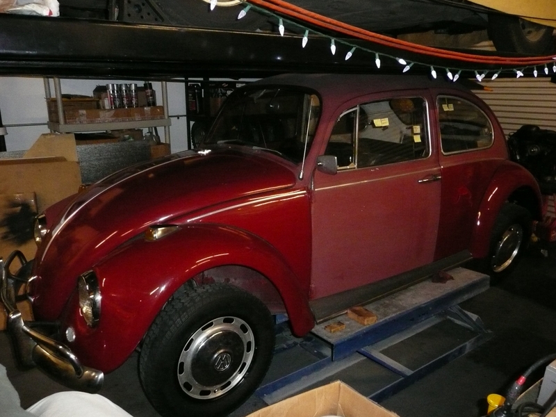

Bled the MC on the bug, then re-bled the wheel cylinders - all four corners are working great now (IMG:style_emoticons/default/aktion035.gif)
Got the bug motor all back together with all the correct tins, hoses, stock air filter, etc. and got rid of most of the chrome aftermarket crap the PO stuck on there (IMG:style_emoticons/default/dry.gif)
Before
After

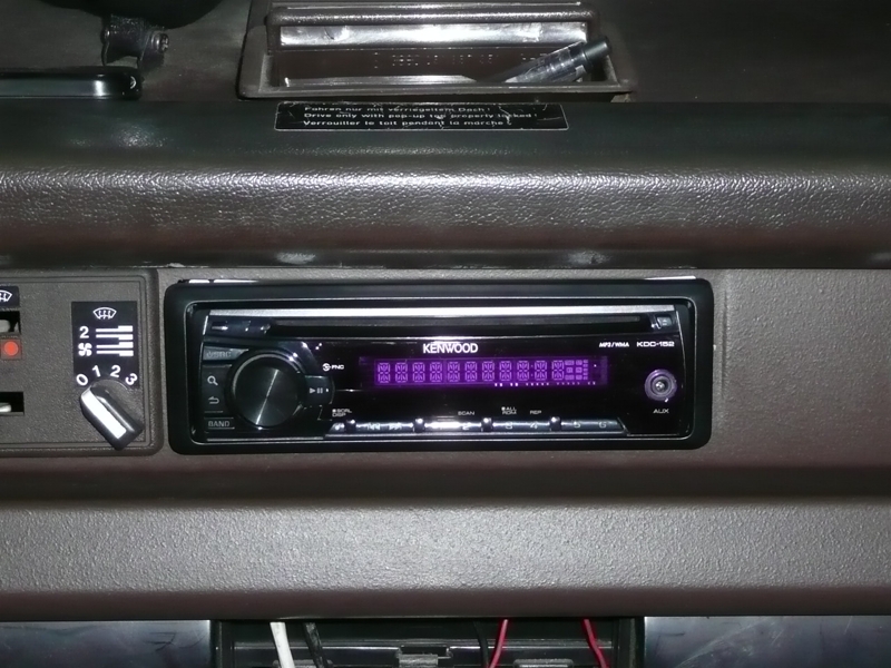

Also, installed a new sound system in the Westy Camper (IMG:style_emoticons/default/rock_band.gif) (IMG:style_emoticons/default/tunez.gif) (IMG:style_emoticons/default/party.gif)

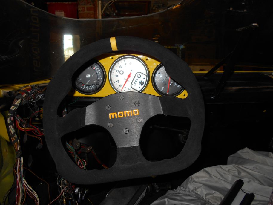

Mounted my Gauge Pod
carr914

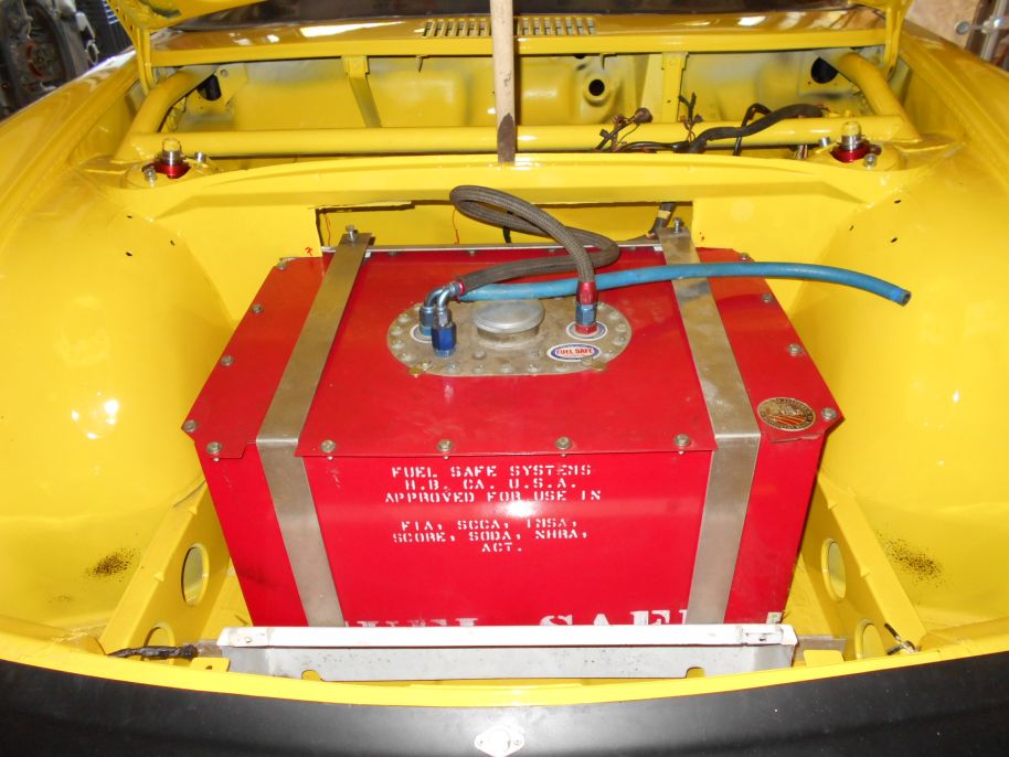

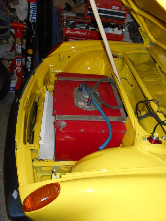

bulitt
post Feb 9 2014, 03:03 PM
Post #3671
Achtzylinder
Posts: 4,189
Joined: 2-October 11
Member No.: 13,632
QUOTE(carr914 @ Feb 9 2014, 03:32 PM) *
Mocked up the Fuel Cell Mounting Points
Wow! What's that capacity like 100 gals? You can power up your generator during the next hurricane? (IMG:style_emoticons/default/biggrin.gif)
carr914
post Feb 9 2014, 03:56 PM
Post #3672
Racer from Birth
Posts: 132,403
Joined: 2-February 04
From: Tampa,FL
Member No.: 1,623
20 Gallons

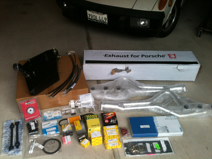

Had some more of my -6 conversion parts show up today. (IMG:style_emoticons/default/piratenanner.gif)
My MSDS ceramic coated headers and exhaust showed up. Headers look awesome Marty, thanks again.
Flywheel and clutch are at the machine shop getting balanced, the car goes into McMarks shop on Sunday for the new motor mount......things are starting to move along. Be nice to (IMG:style_emoticons/default/driving.gif) it to WCR.

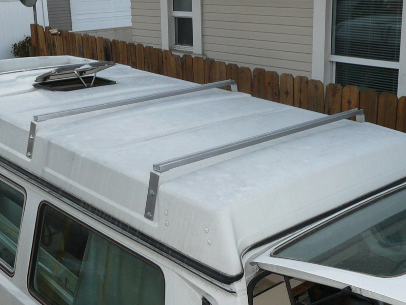

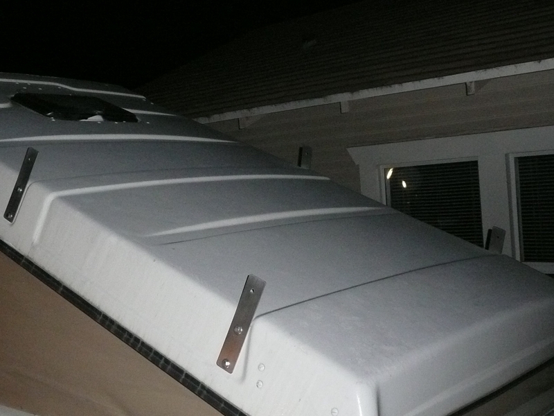

More Vanagon work today :
Removed the curtains and rear upholstery, washed the fabric and sprayed the foam pads with Febeze
Fabricated some brackets for a roof rack ...
... and got them installed right around sundown.
Plans for tomorrow : Install the cross rails and install two 100 watt solar panels on the rack (IMG:style_emoticons/default/aktion035.gif)

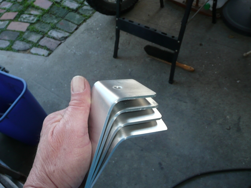

More Vanagon ...
Changed the design a little - so I had to remove the brackets and make a fixture to uniformly bend the upper ends of the brackets ...
Cut a couple lengths of shallow aluminum UniStrut for the cross rails ...
and installed two 100-watt mono-crystalline panels (wired in parallel) ... approx 15 Amps of power in full sunlight (IMG:style_emoticons/default/aktion035.gif)
I need to fabricate a wind deflector for the leading edge of the panels next. Maybe a 914 'duck tail' trunk spoiler will do the trick (IMG:style_emoticons/default/idea.gif)
I'll be installing a 20 Amp charge controller, an Odyssey sealed battery and a 1500-watt power inverter under the rear seat.
