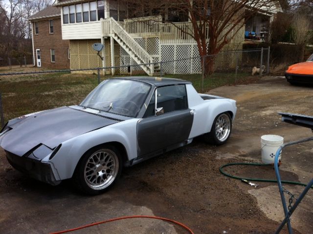

Nice day here in Bogart... I was able to get a coat of epoxy primer and a couple of coats of 2k primer on my steel flare install. Hope to have it ready to paint by early spring.
If you look close you can see all 3 of my 914s

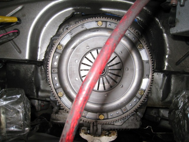

FINALLY my car is back on the wheels!!
Got new flywheel shims from FAT performance today, I installed them and rechecked the shaft endplay and came up with .0046" which is now within spec.!! So remounted the clutch. Transmission and CV' put the new wheels/tires on an out her on the ground! Now I can pull the front tires/wheels and get them shipped off the their new home in Arkansas!

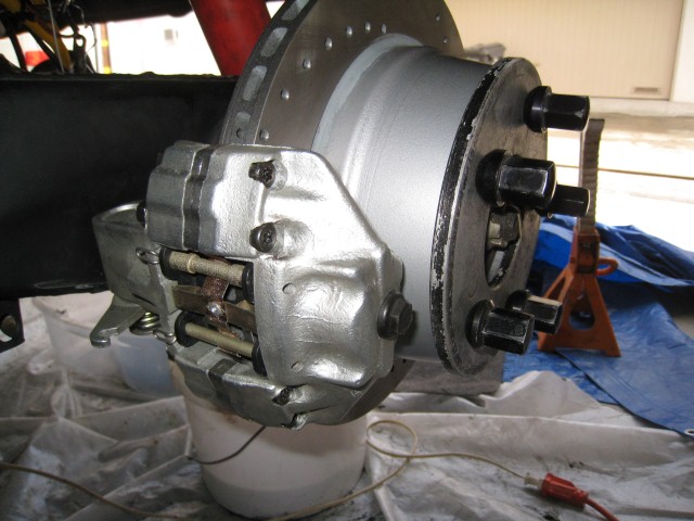

I have been driving it for the past 3 days after rolling the rear fenders and lowering it back down to where it should be!
I didn't take a photo but this is what is looked like raised up so it wouldn't rub!

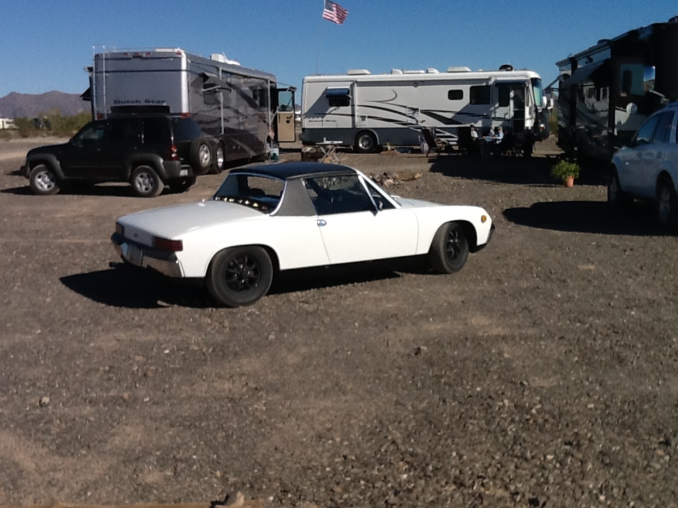

Drove to Quartzsite to visit some friends... was a great 340 mile trip. (IMG:style_emoticons/default/driving.gif)

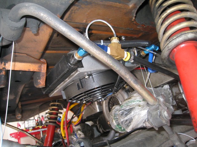

New stuff: Flywheel, clutch, pressure plate; vented rotors with widened calipers ( thank you Eric Shea ! );finished installing the remote oil cooler; and sent tranny to Dr Evil for a checkup. Now to clean up the garage.... (IMG:style_emoticons/default/sad.gif)

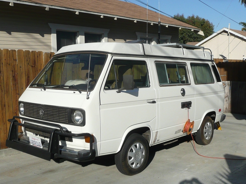

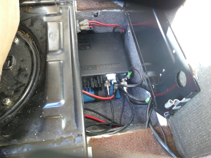

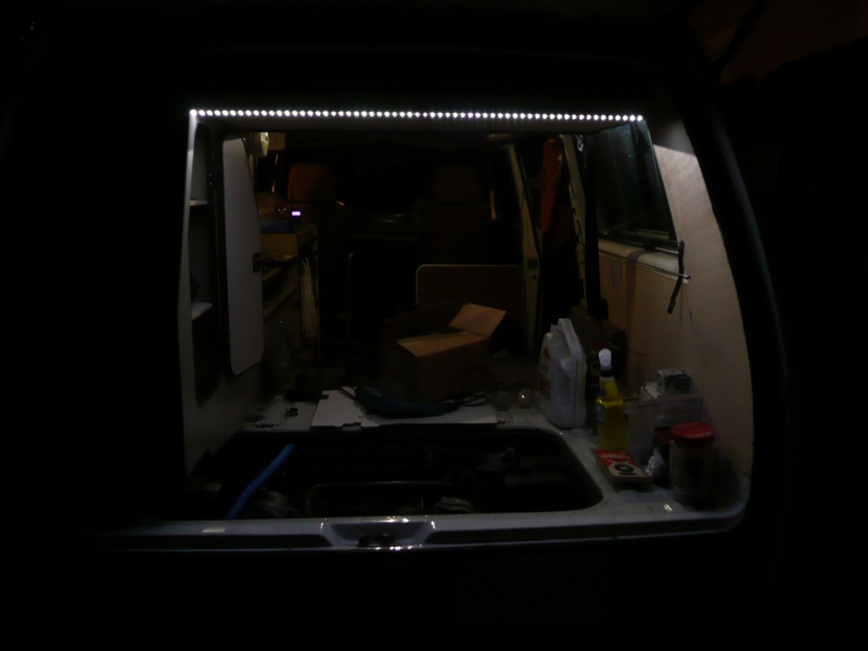

Almost finished with all the electrical/electronic work in the Westy. Did a lot of repairs to the electrical wiring 'while I was I there'. Also tightened up every nut, bolt and screw I ran across in the cabinetry - she is tight now (IMG:style_emoticons/default/aktion035.gif)
Swapped out all the incandescent bulbs for LED panel lights, and added a 36" wide Pilot® LED strip across the bottom of the rear air conditioner cabinetry (the photo doen'nt show the luminosity very well, but it really lights up the rear cargo area and the engine bay pretty good).
I also picked up a red 36" wide LED strip to do a third bake light mod (Vanagon tail lights are low to the ground, just like Porsches, ya know) (IMG:style_emoticons/default/idea.gif)
The HAM radio gear is all working too (IMG:style_emoticons/default/smile.gif)
Now to put all the tools away and start cleaning up the rest of the interior (IMG:style_emoticons/default/FERG.gif)
I'm on the hunt for a reasonably-priced set of CLK 16x7" alloys for when I go get some taller off-road tires. PM me if you run across a set (like these)

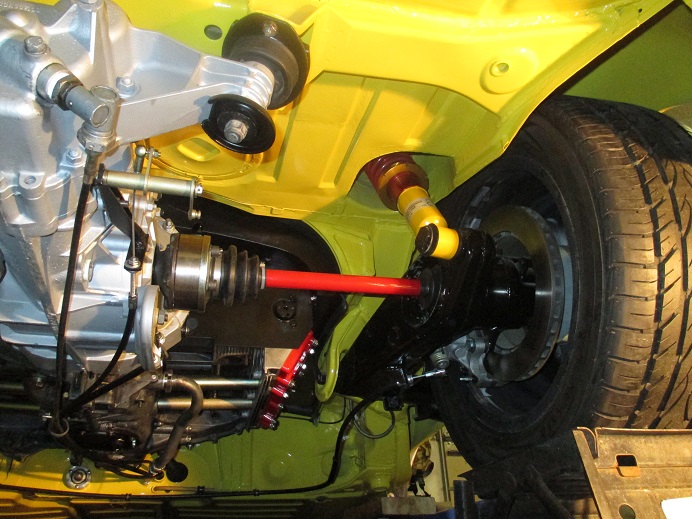

Installed the proper 911 output flanges to complete my 5 lug conversion using 930 CV’s and Swayaway axles. My thanks to Mark Henry for advise and GMS for correct the flanges .

QUOTE(t collins @ Feb 21 2014, 05:39 PM) *
I think your cup washers are installed incorrectly on the rear trans mounts. (IMG:style_emoticons/default/confused24.gif)

QUOTE(Kirmizi @ Feb 21 2014, 06:11 PM) *

QUOTE(Kirmizi @ Feb 21 2014, 07:11 PM) *
Yep, should be under the rubber (IMG:style_emoticons/default/biggrin.gif)

Member No.: 7,300
Yep, same orientation, but above the 'ears'. Those are the notched ones for early engine mount bar, but totally acceptable for trans mounting (IMG:style_emoticons/default/shades.gif)
Super clean undercarriage (IMG:style_emoticons/default/smile.gif)

QUOTE(euro911 @ Feb 21 2014, 07:51 PM) *
I even Know better, senior moment I guess (IMG:style_emoticons/default/headbang.gif)
