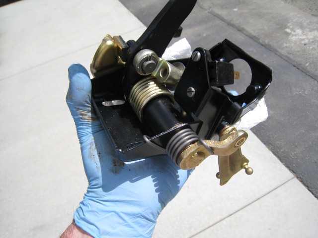

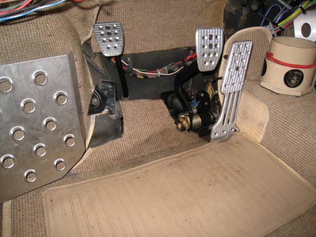

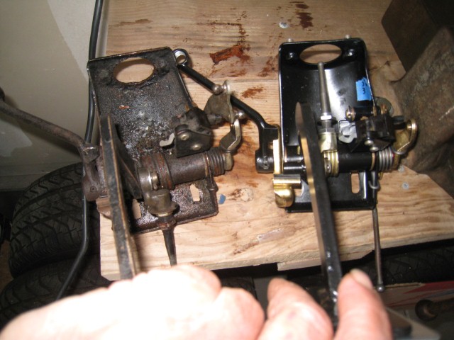

Installed a refurbished Bruce Stone pedal cluster. Pretty easy, still can't believe how fustrating the reattachment of the clutch cable is... (IMG:style_emoticons/default/smile.gif)

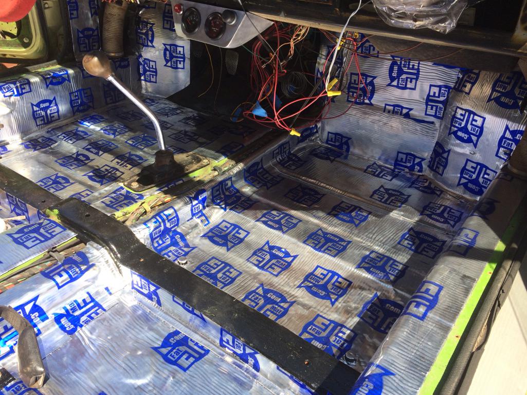

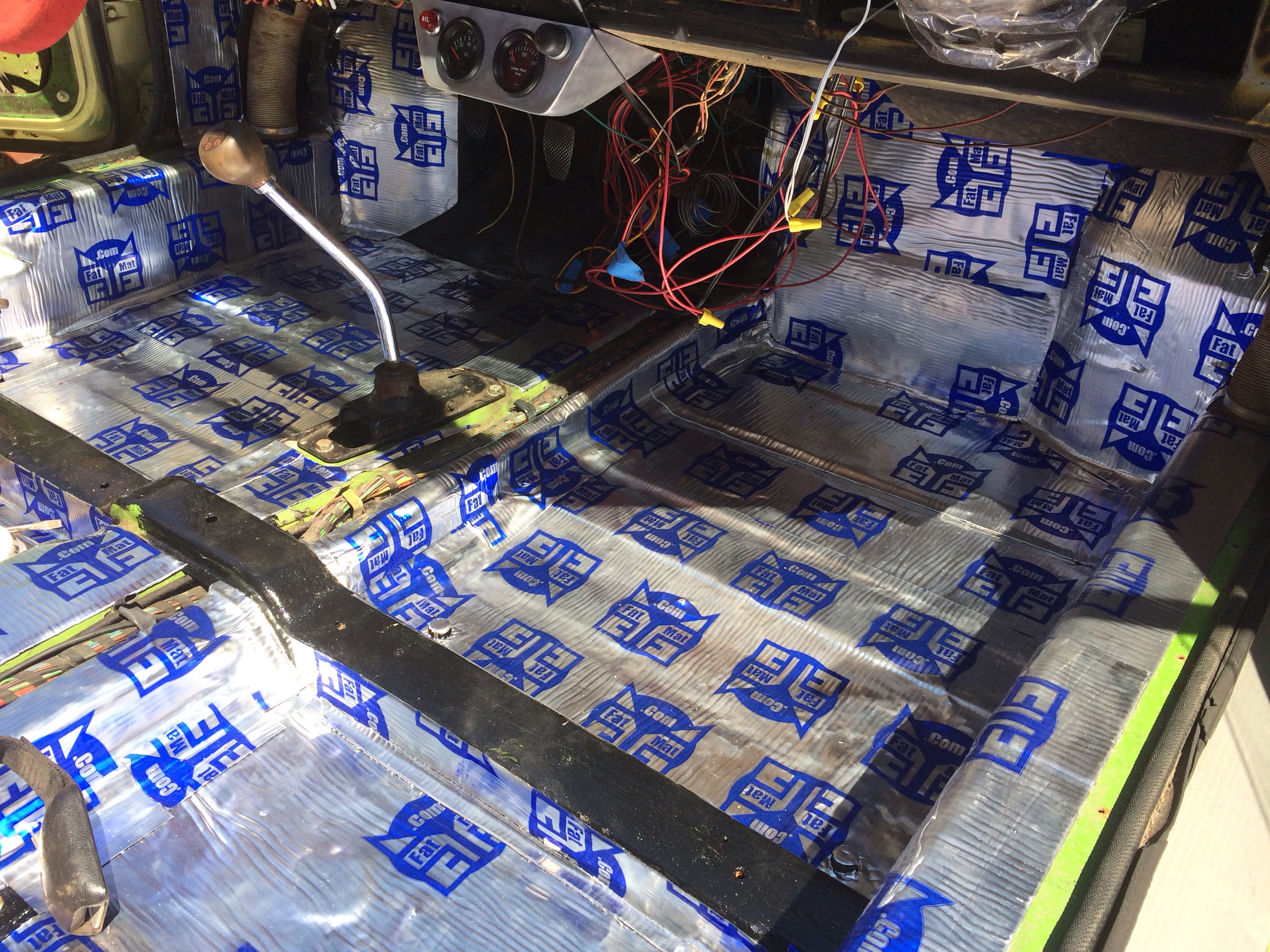

Installed some Fatmat today. Happy with the product, easy to work with and can't tell a difference between this and Dynamat.

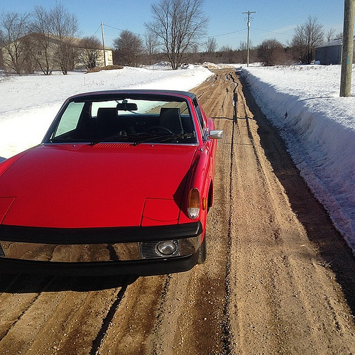

Took the car out of the pole barn FINALLY. Changed out some Euro front blinker lenses and installed American new ones.
Lots of things planned for the red car this year!

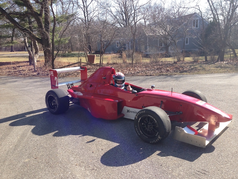

Boy ortho, you've got some serious snow melting to do!!
Luckily we finally got rid of our white stuff so my son could get out his new toy- gotta get it ready for his first race in it in a month!Attached Image

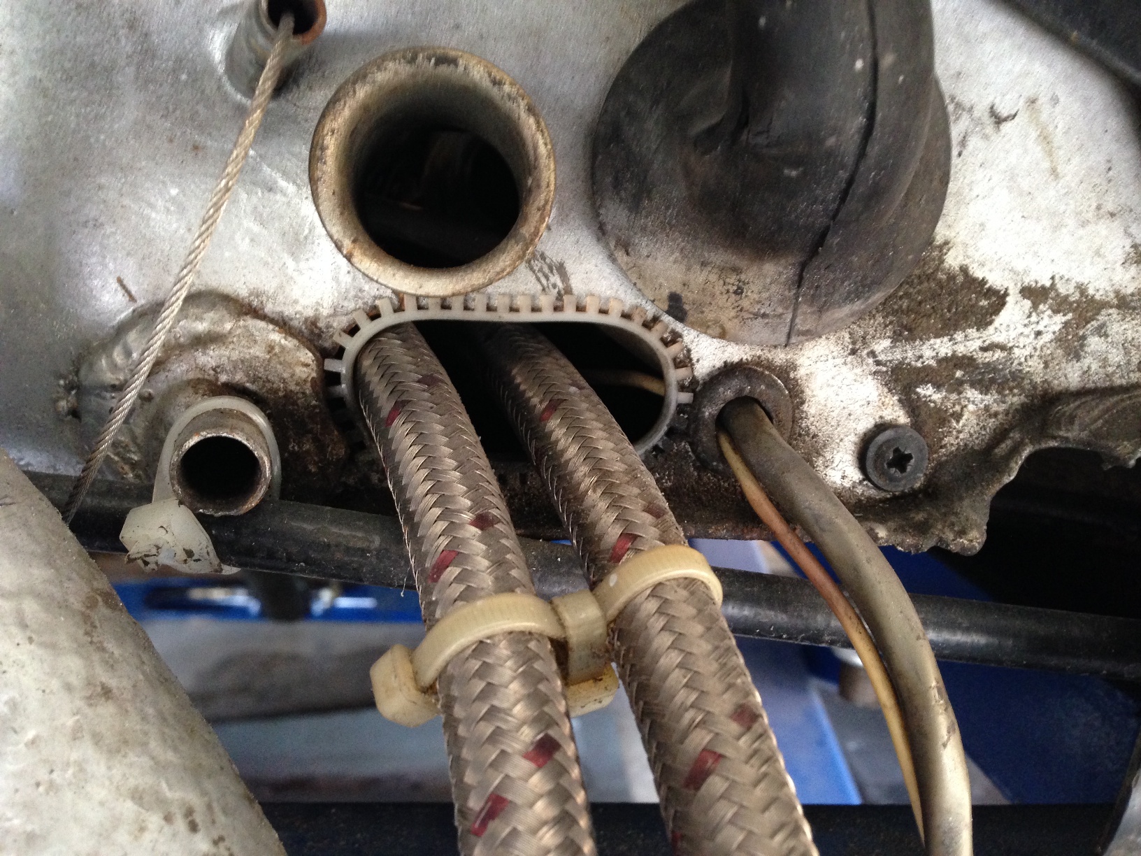

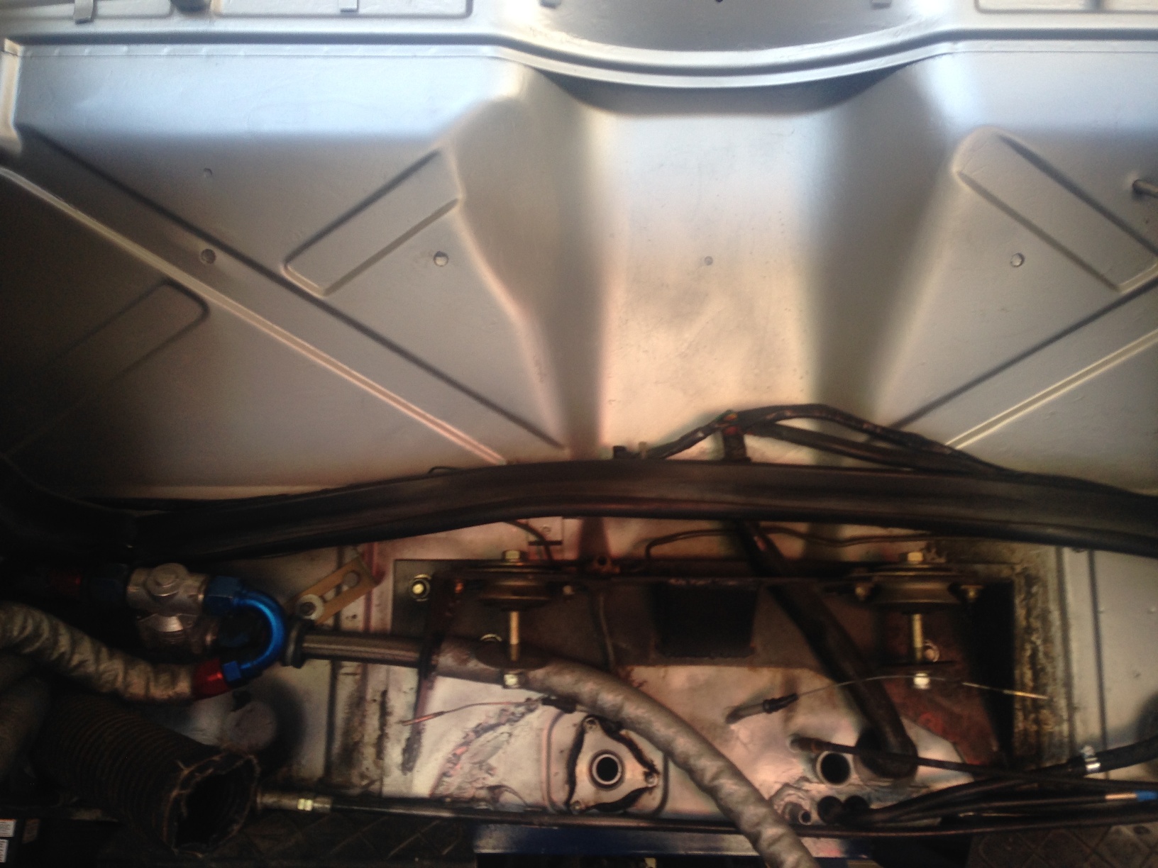

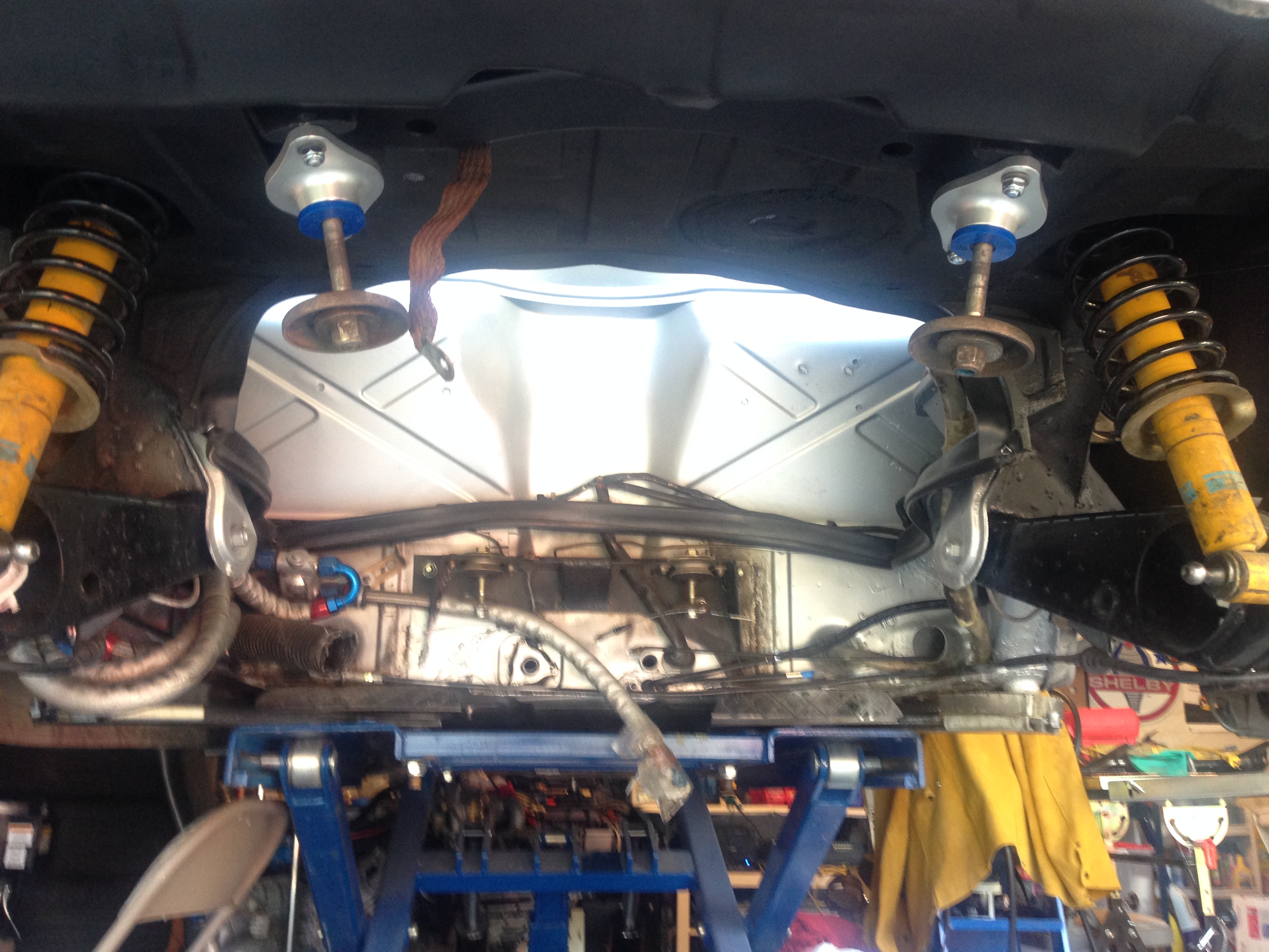

After two years, I am finally ready to put my 3.2 and 916 trans back in the car.
Before
After

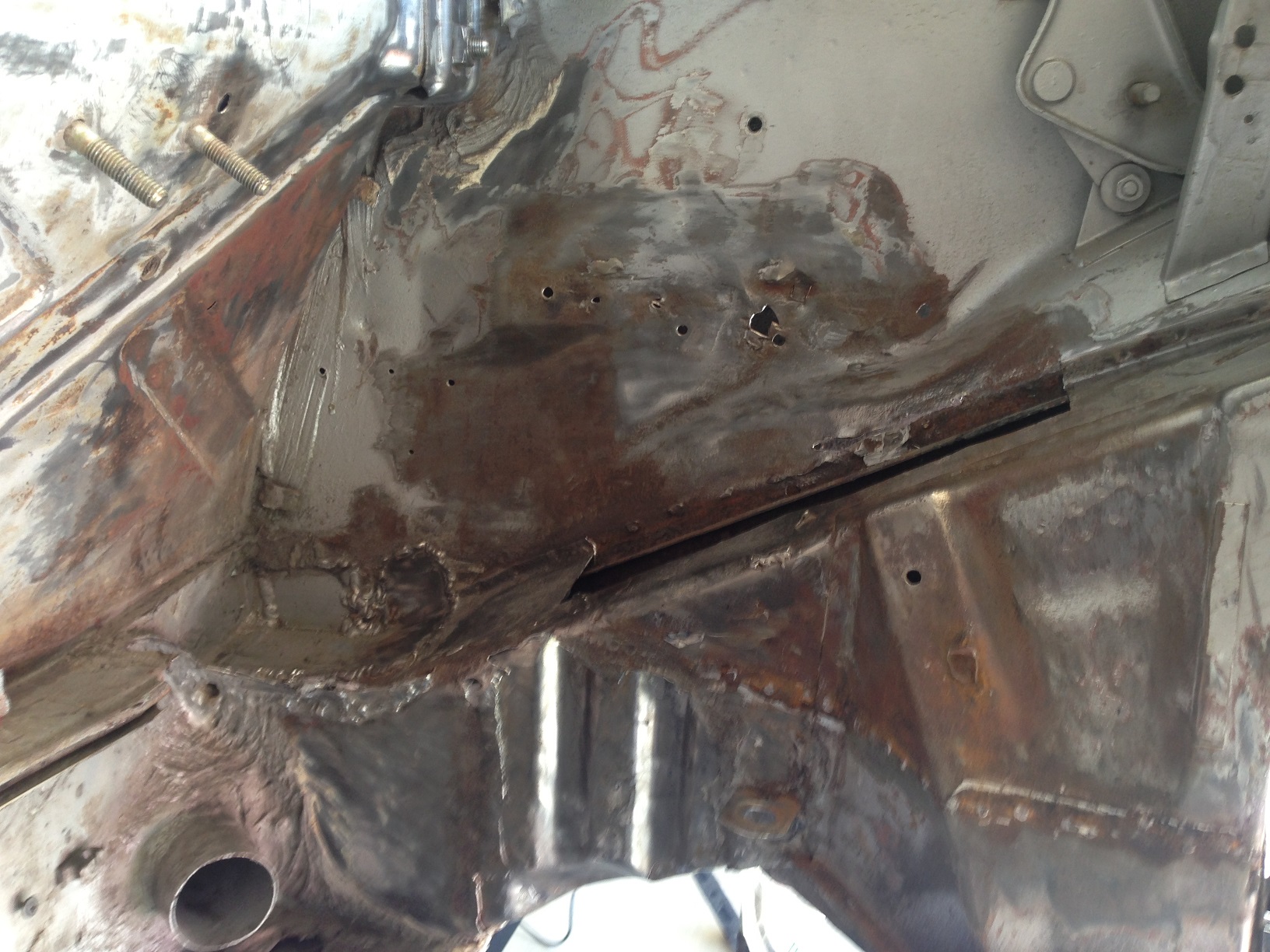

Welded in new firewall plate to cover big steel braided line hole and replaced with S&S Fuel Lines. Also replaced all rubber with Mikey Rubber.

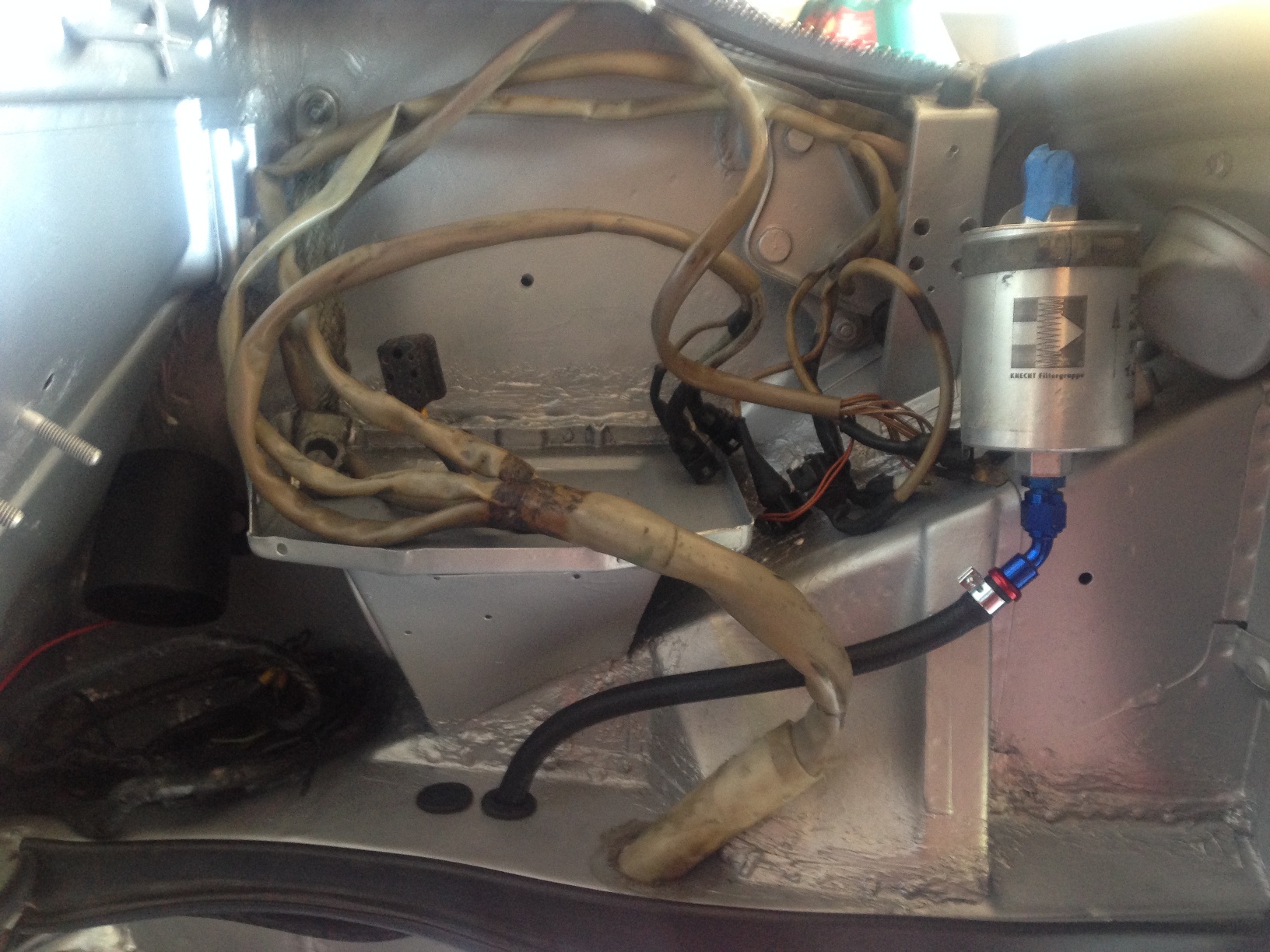

Hell Hole Before
After (maybe too much seam sealer). Restoration Design Engine Shelf. Great products, people and service.

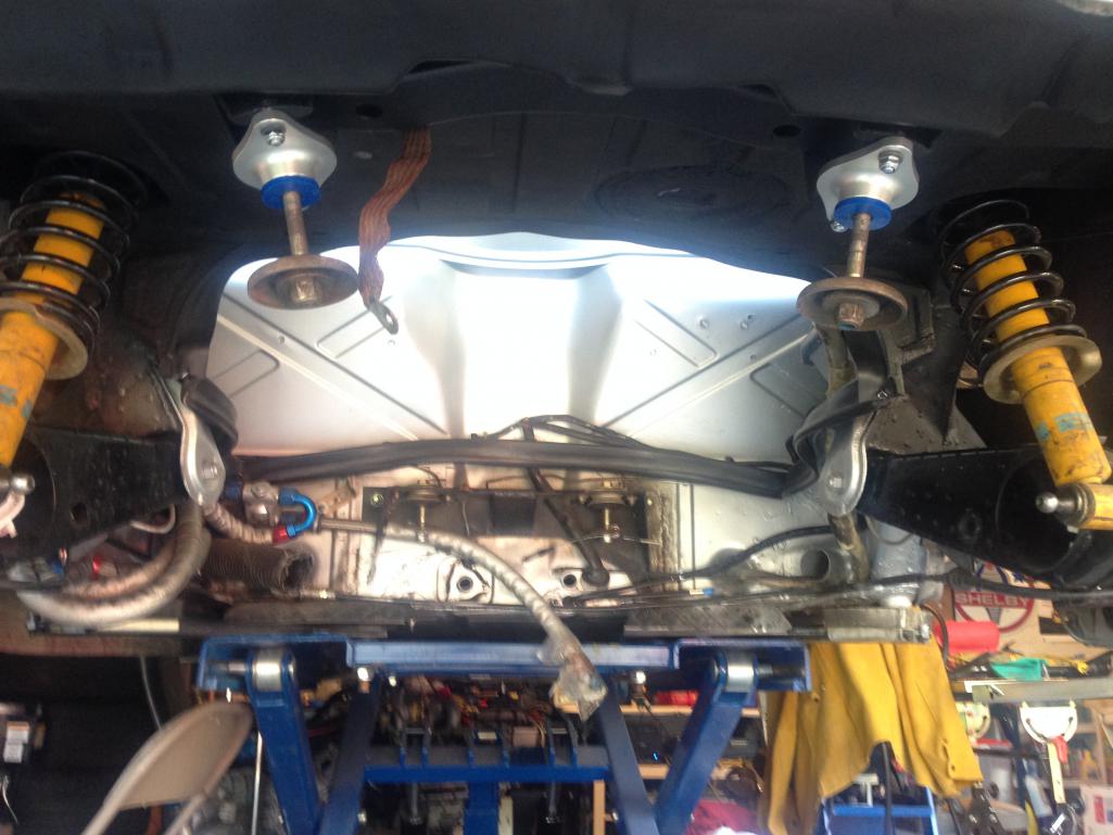

Now ready to put my 3.2 and 916 trans in the car. Project for next weekend!!

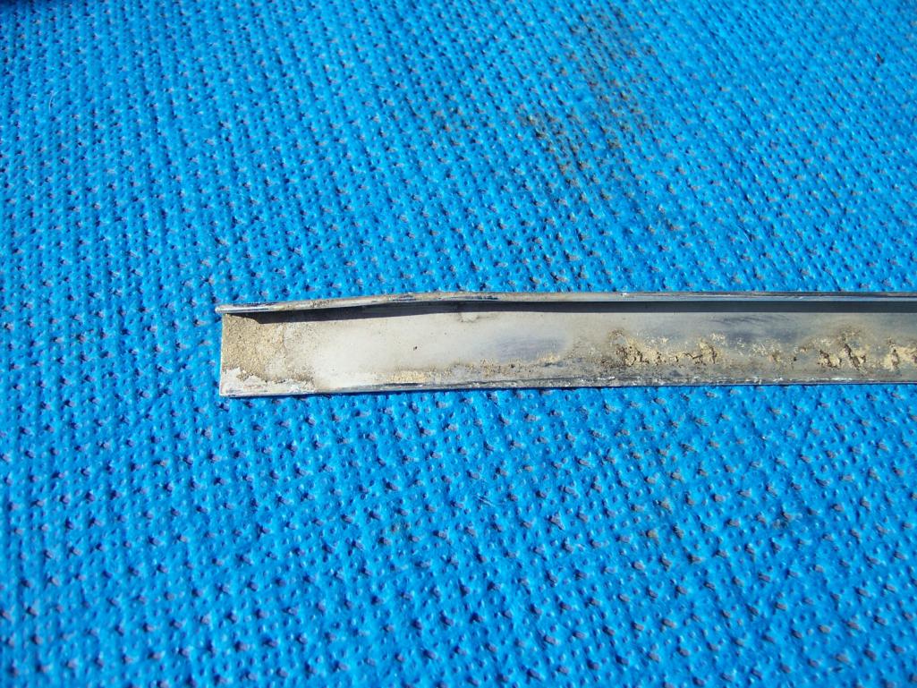

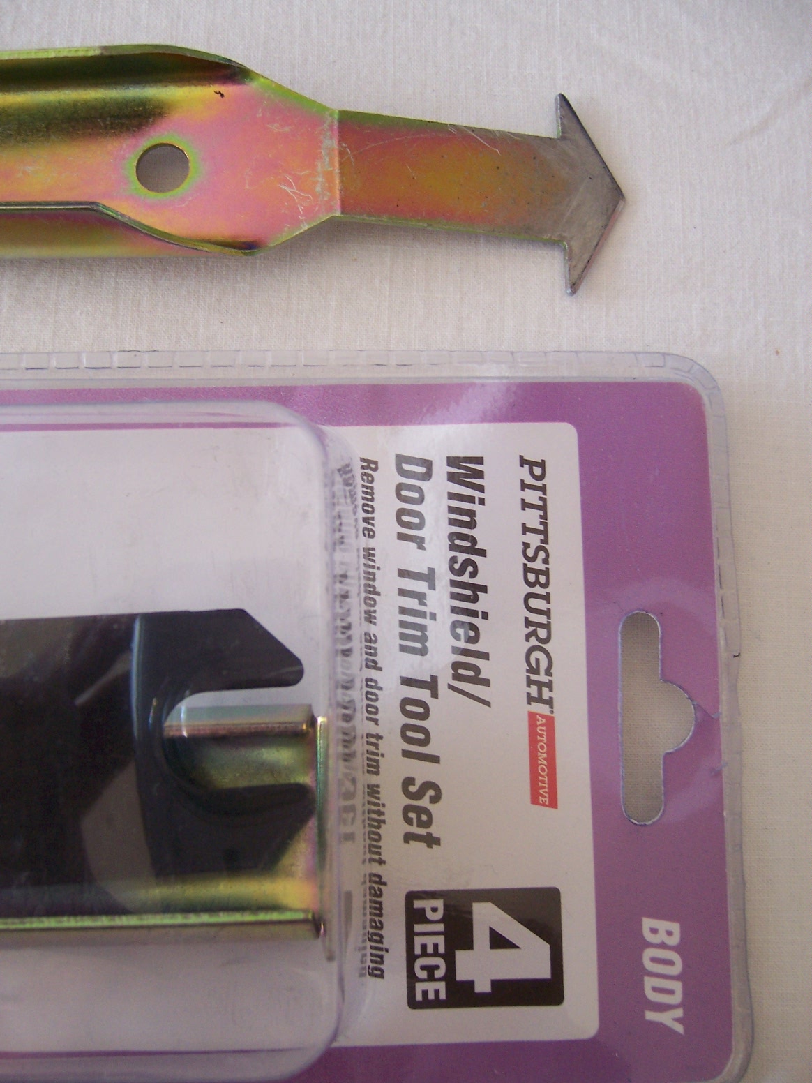

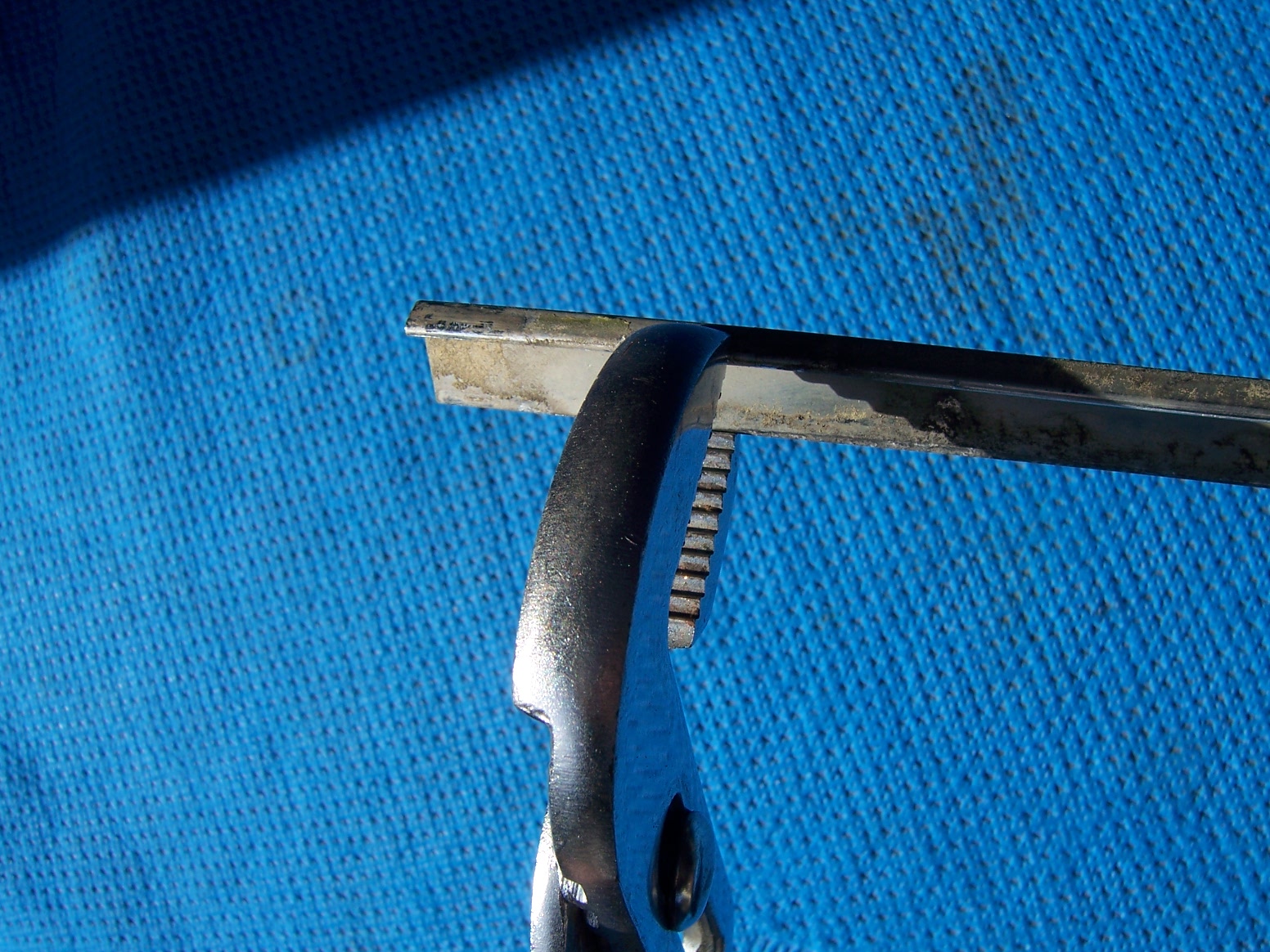

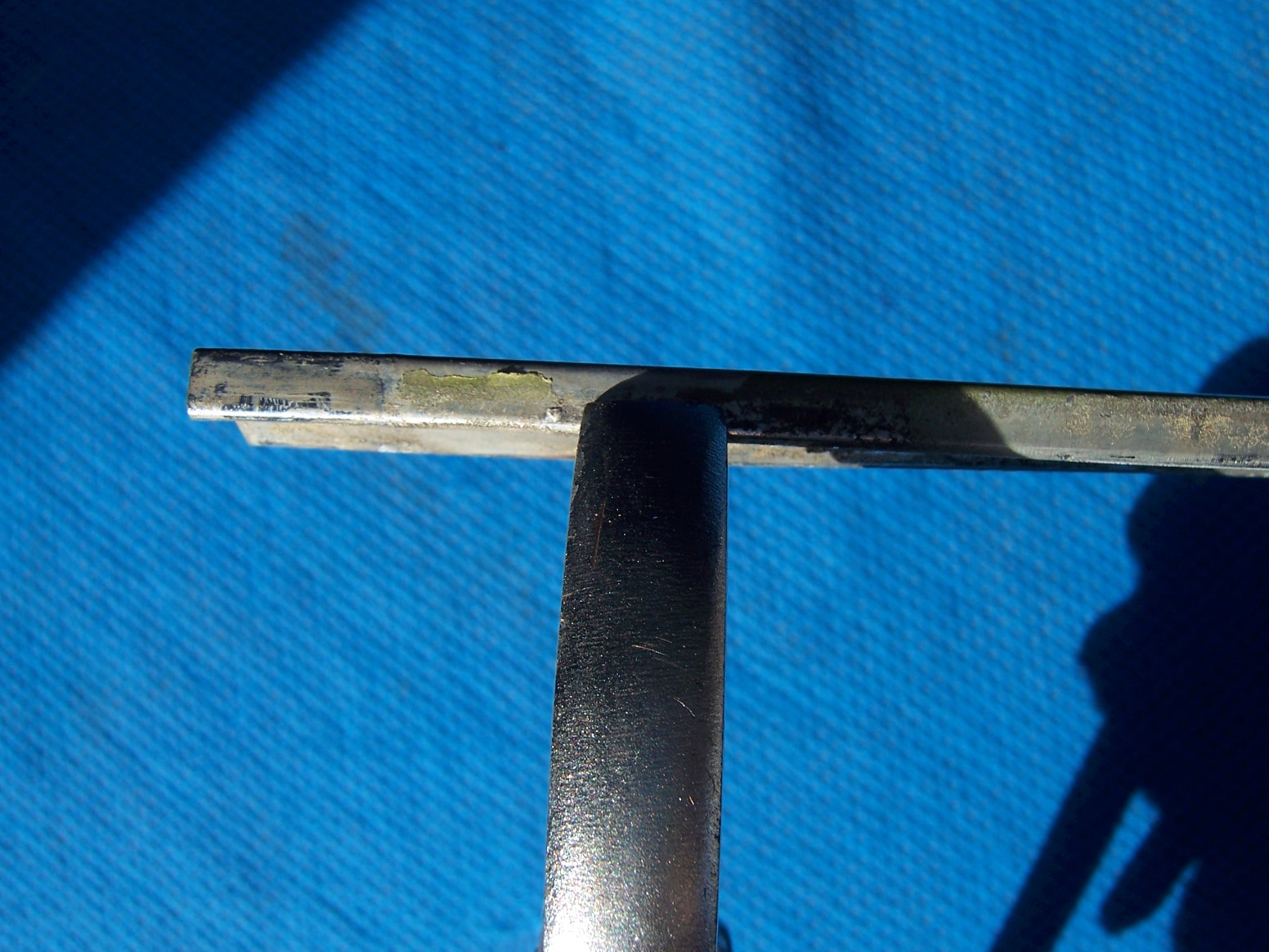

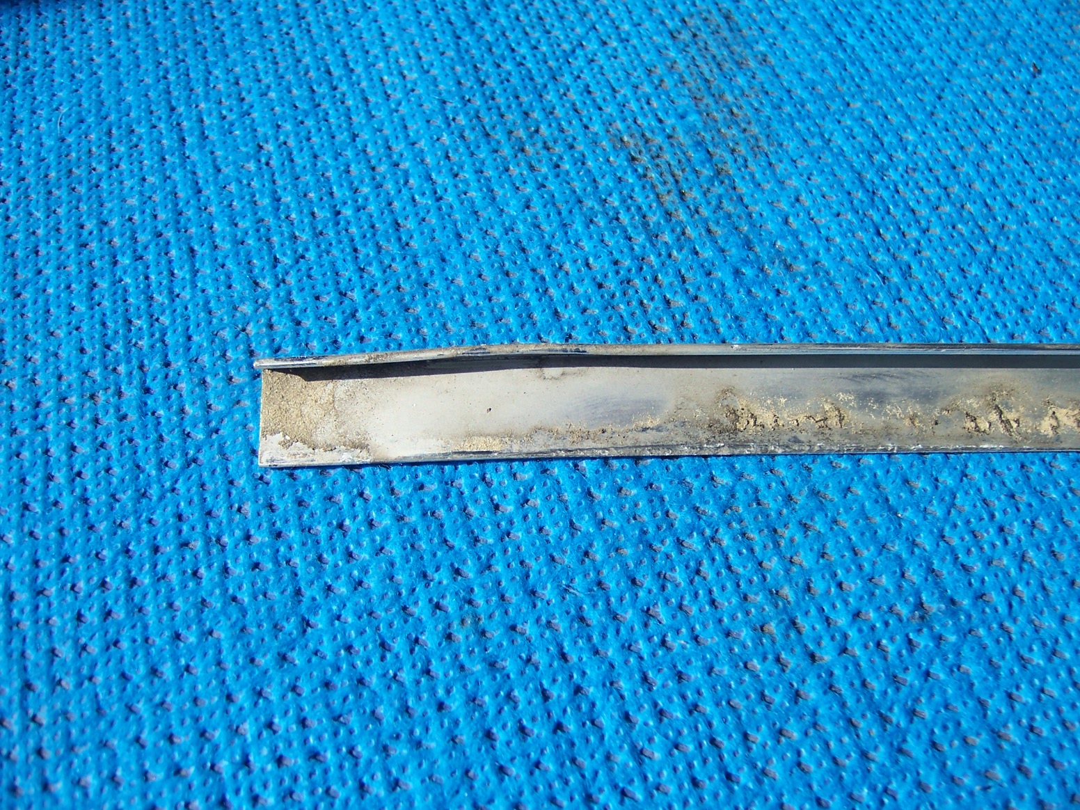

used the HF tool and removed the windscreen trim, then re-shaped the trim with a channel lock (without marring the trim) where the clips hold the trim. just a gentle squeeze to restore the integrity of clipping surface. (IMG:style_emoticons/default/smile.gif)

My trim keeps popping out at the lower right corner, I need to do this too.

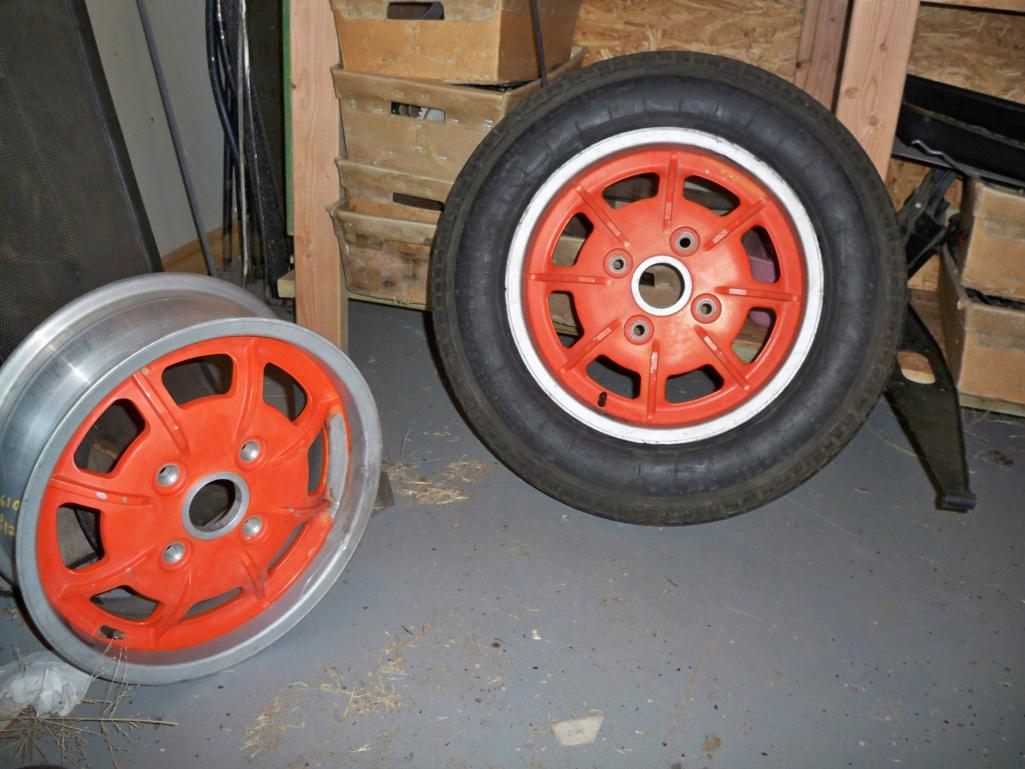

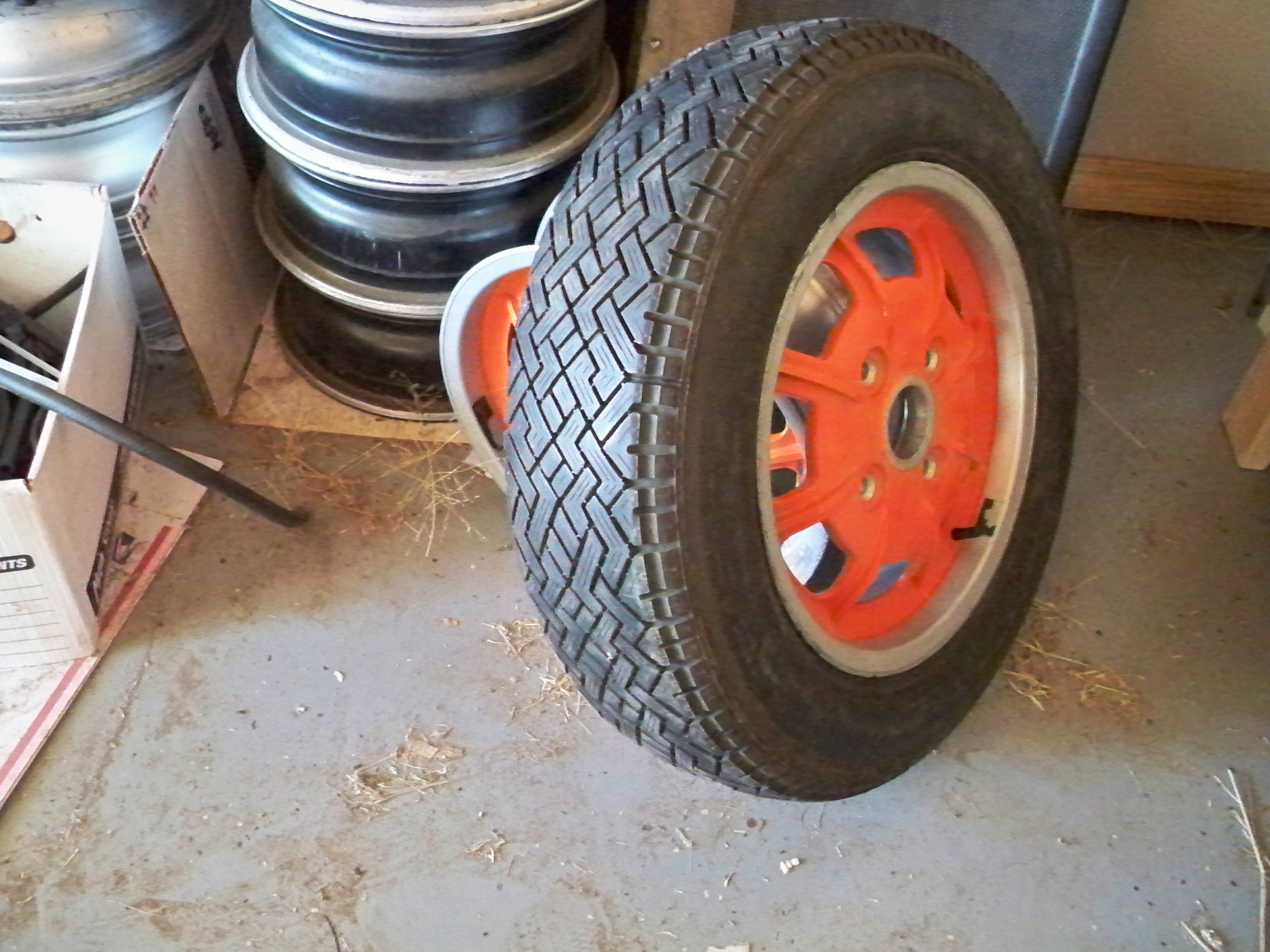

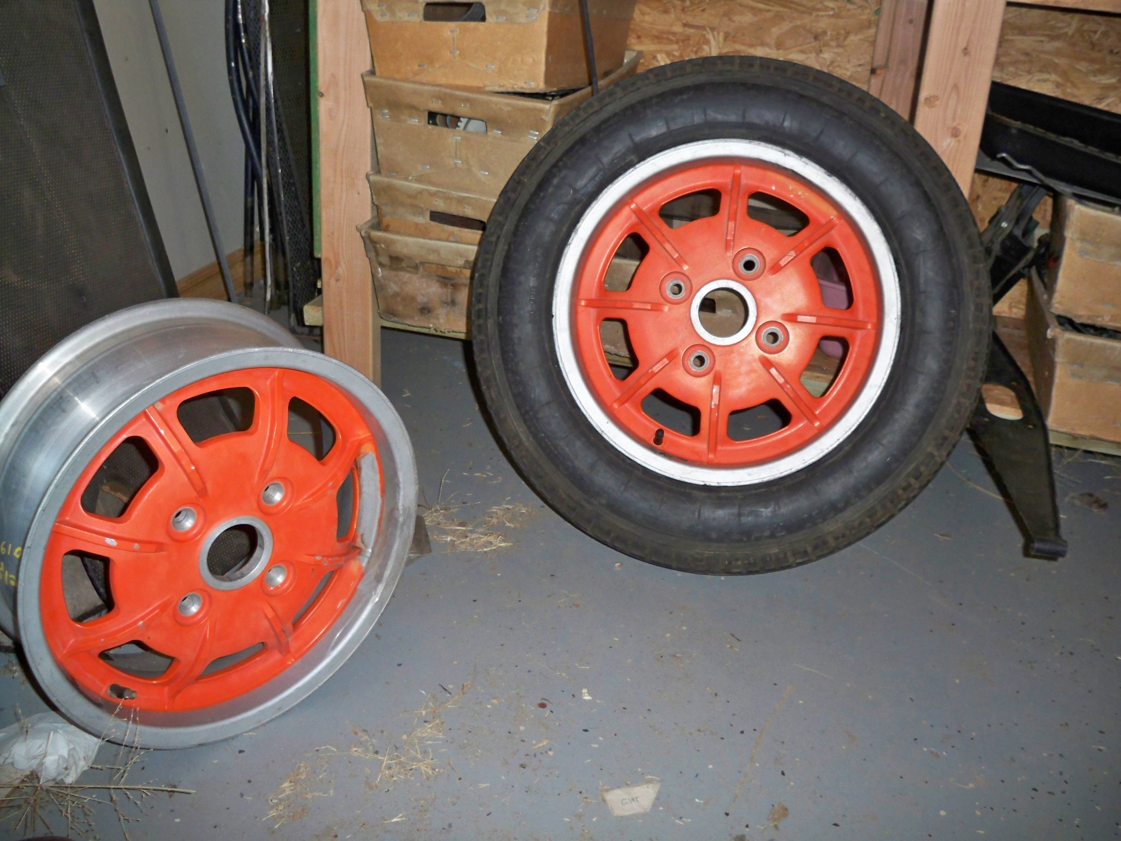

I have two LE wheels in one corner of the garage and a Continental 165-15 tire in the other. The wheels I got some time ago at a junk yard and the tire has been hiding in the corner so long I forgot where and when I got it. I figure its decades old of course but looks brand new, never been on the ground.
So,... got up early and not ready to start rebuilding brakes, I hit Walmart to have the tire mounted just to have the fun of rolling it around the garage when its in the way of whatever project is going on. I remember those skinny tires and distinctive treads and wish they still made them.

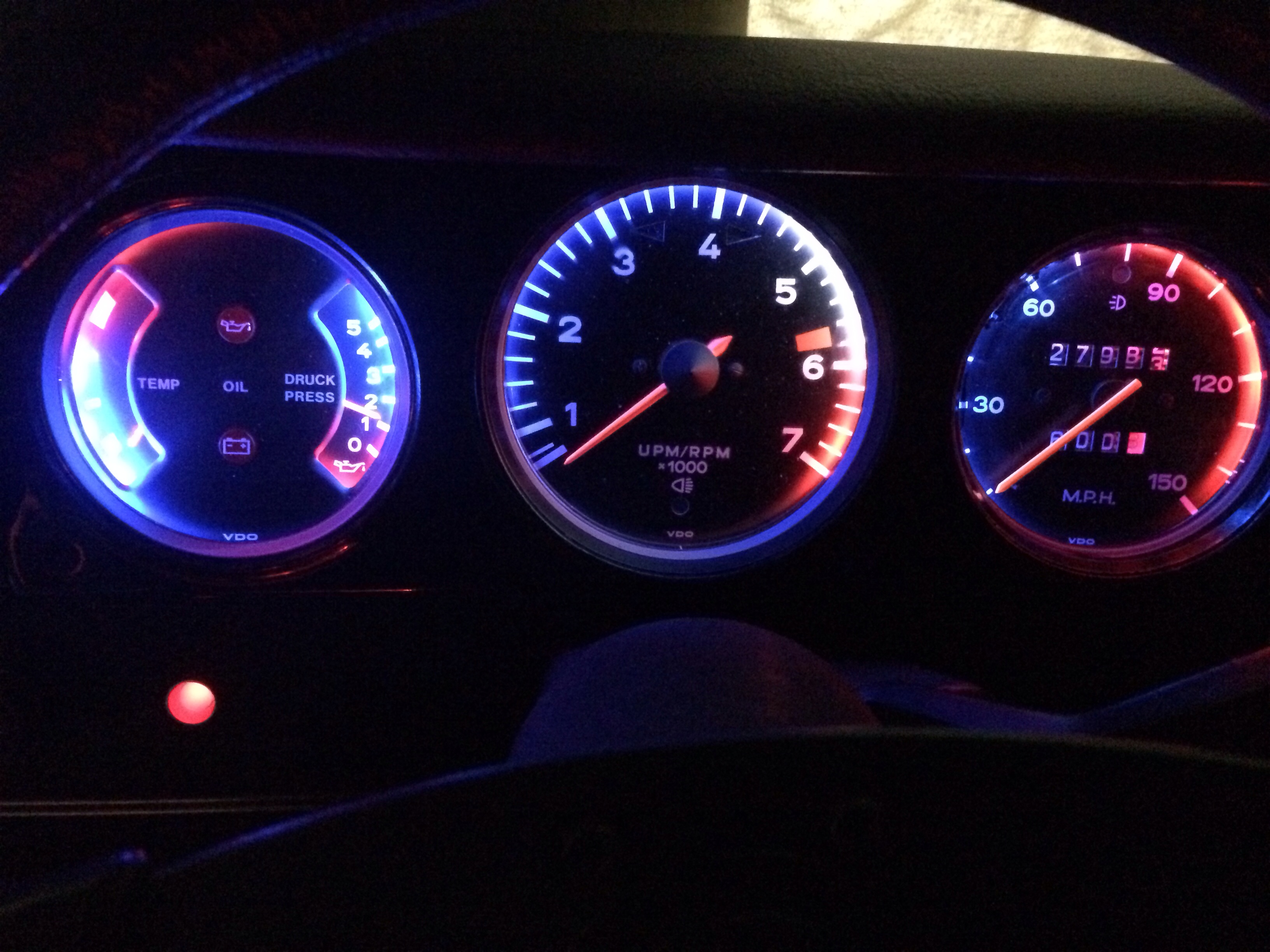

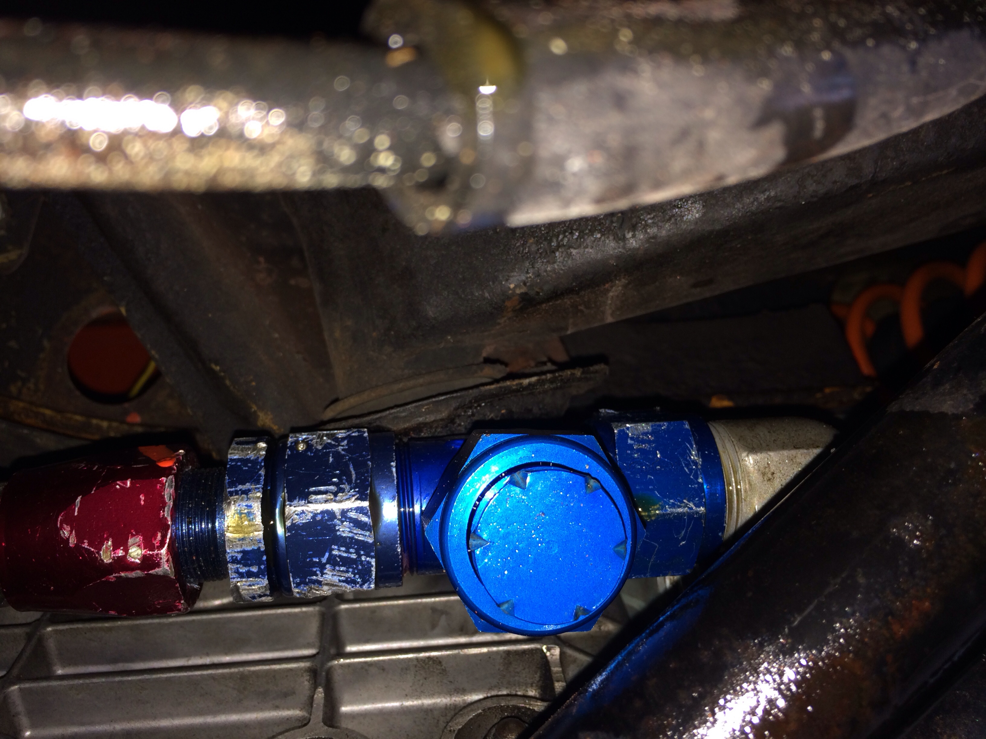

In Preparation for Hershey, I did an oil change, reinstalled my gauges (converted and new LED by Tim ) he did a great job. Installed a fitting for easy oil drainage from tank.

Looks like the fitting to the left of the T fitting isn't seated all the way. There shouldn't be any threads exposed. You may want to check that before it comes apart and drains all the oil from the tank.

Thanks Luke> will do

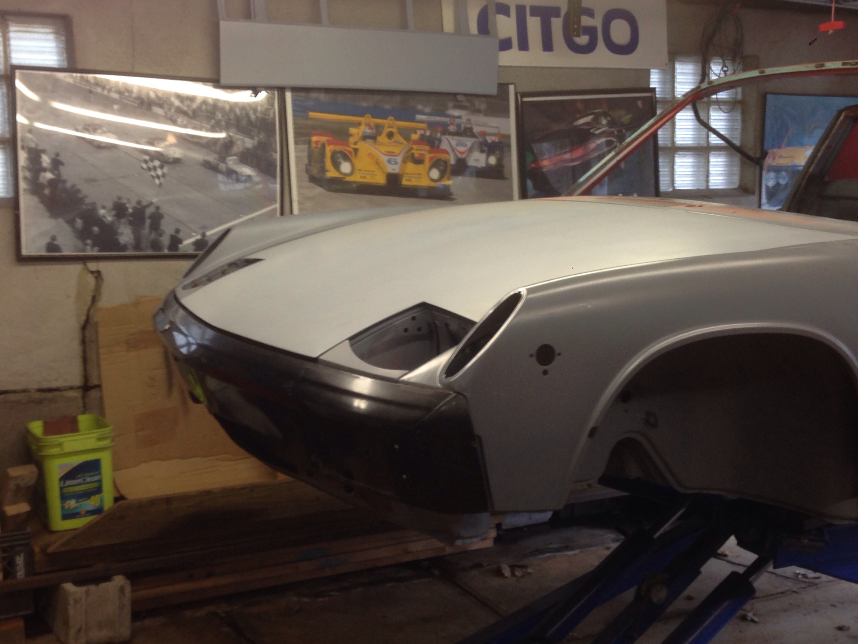

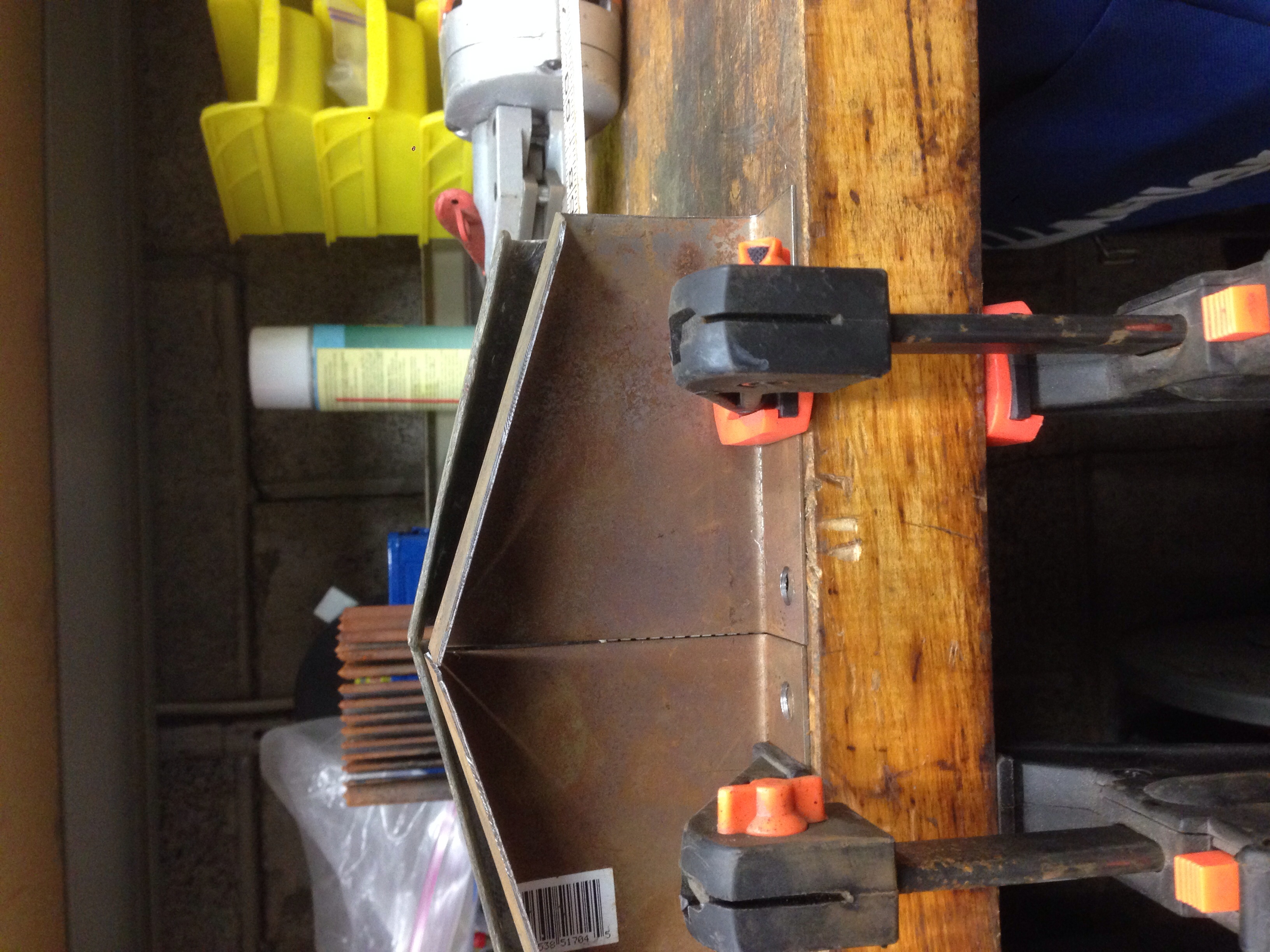

Started fitting glass bumpers. Had to remake the angle of the front bumper bracket.
Bonded then with fiberfill bondo. Will overlay fiberglass on them when I take them off.
I'll have to add some on the edges to get an even fit. It is progress.
