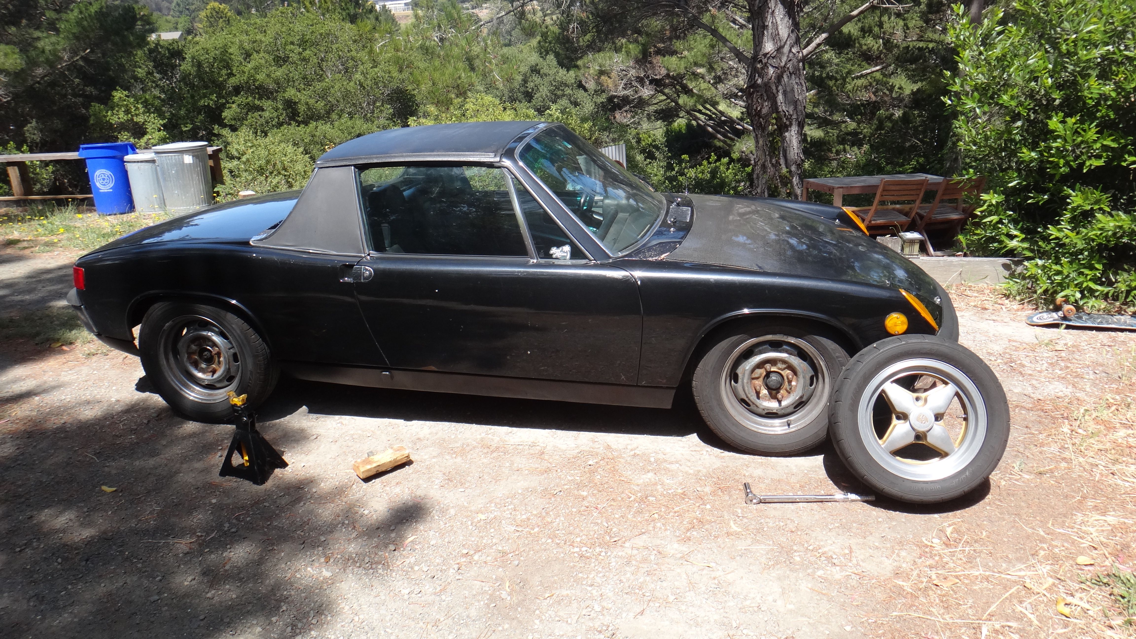

I removed the "winter tires/wheels" and put the American Racing alloy wheels with Dunlop "summer performance" tires back on. Lower, grippier, and fun! (IMG:style_emoticons/default/beerchug.gif)
195/65 vs. 205/50.
The 4 VW rims w slightly used Kuhmo tires will soon be posted in the Classifieds for sale. Cheap. (IMG:style_emoticons/default/biggrin.gif)

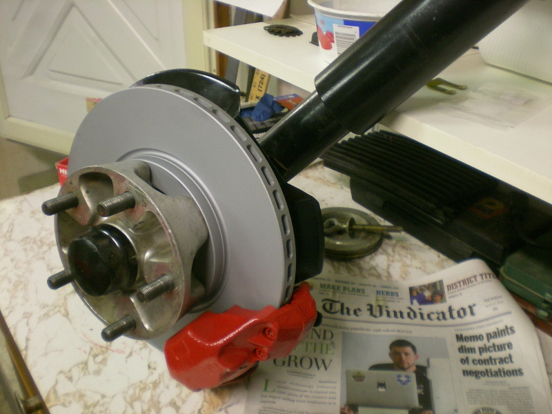

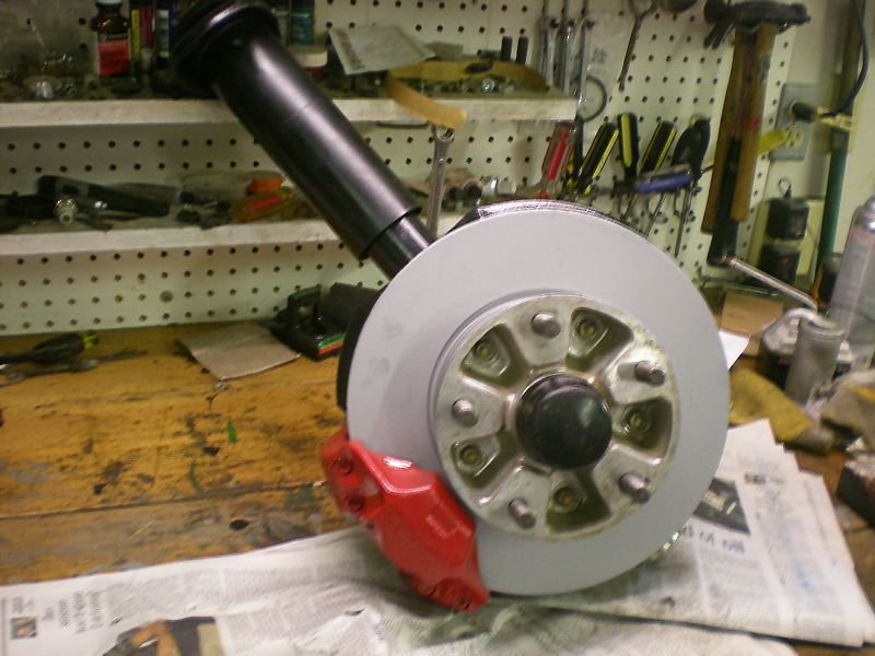

Rebuilt these 914-6 struts for the 5 bolt conversion on my black 73.

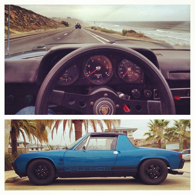

I drove mine today! (IMG:style_emoticons/default/driving.gif) 2 years in the making. Still have some odds and ends to tie up, such as the tac, speedo and fuel gauge not working....but its on the road and running finally!

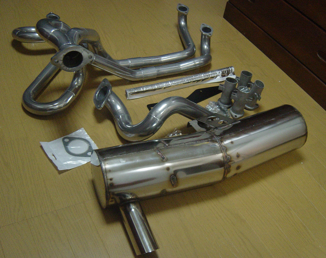

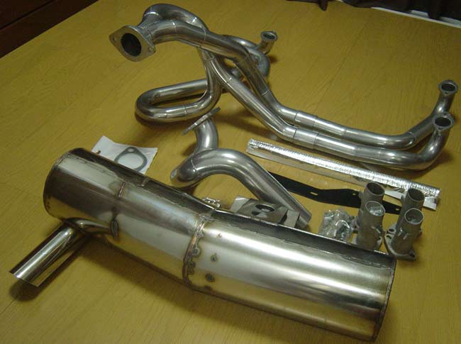

This arrived at my home a few days ago....hope to get it installed this weekend...want to thank Racer Chris !! its truly a work of art !!

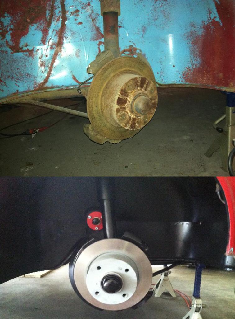

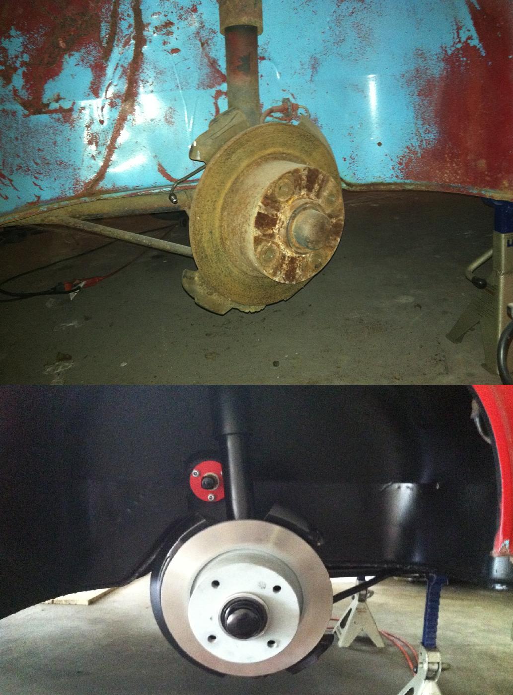

I got the rotors and bearing installed. I need to run the new brake lines. (Before and after)

good job. that first pic looks like something from the Titanic.

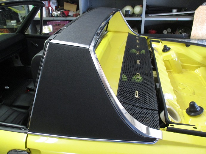

Installed new sail trim, balanced carbs and (IMG:style_emoticons/default/driving.gif) first shake down run around the block.

Added a sway bar also?

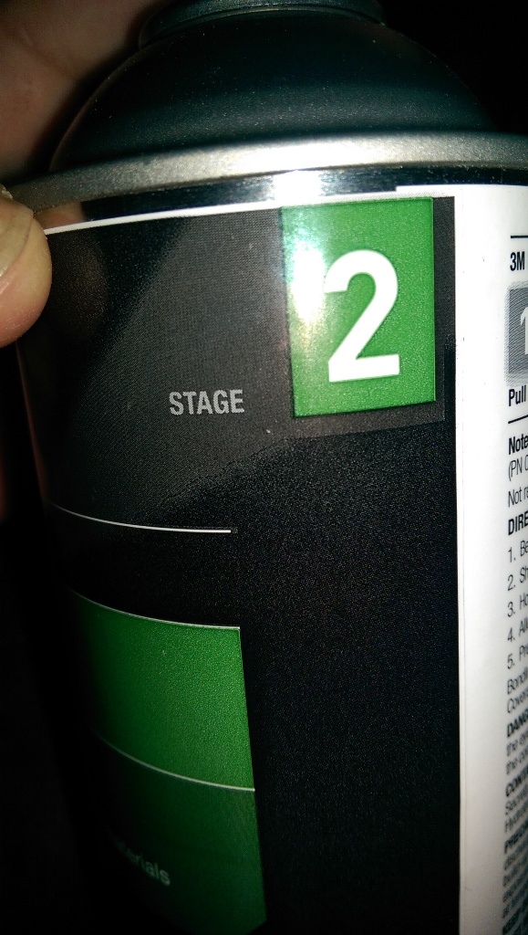

What adhesive did you use. I am getting ready to redo mine with the 914 Rubber German material. The adhesive I used before did not hold that well.

I got a qt. from my local upholstery shop, unfortunately, there's not a label on the can. If you don't have any luck let me know and I'll ask him for the brand name.

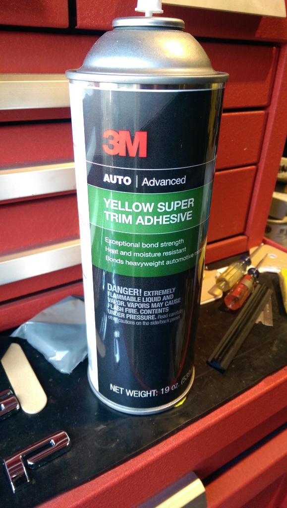

QUOTE(Mblizzard @ Jun 27 2014, 01:42 PM) *
QUOTE(t collins @ Jun 27 2014, 11:08 AM) *
Here's what I use and is designed for vinyl tops and headliners. Not cheap at $23 a can but six years later the sail vinyl and headliner on my old 72 is still holding. if you buy some make sure the can has stage 2 on it as there is another can the same color but not rated for heat and exterior.

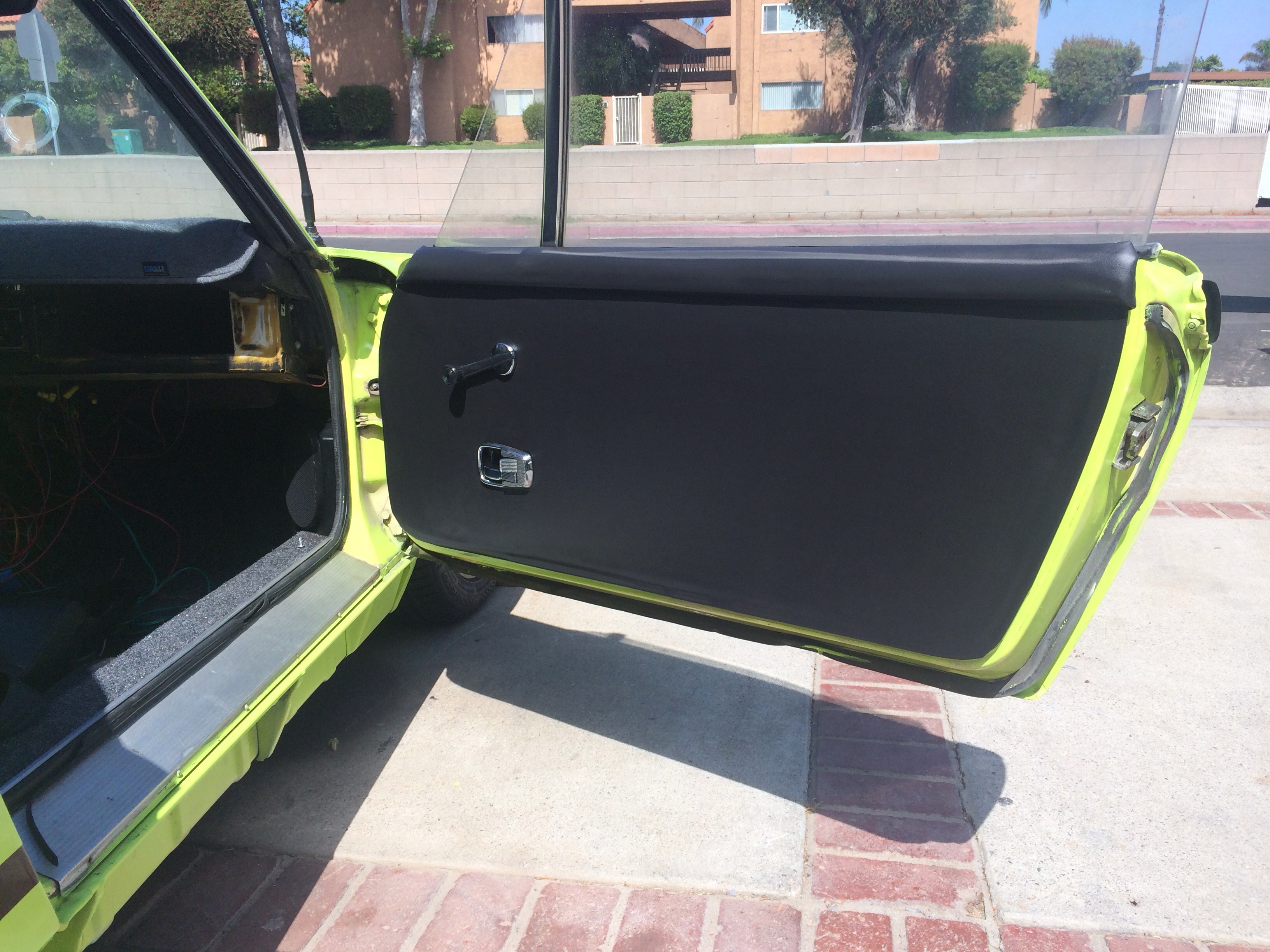

Covered the passengers side door panel, fiberglass panel from 914Rubber!Attached Image

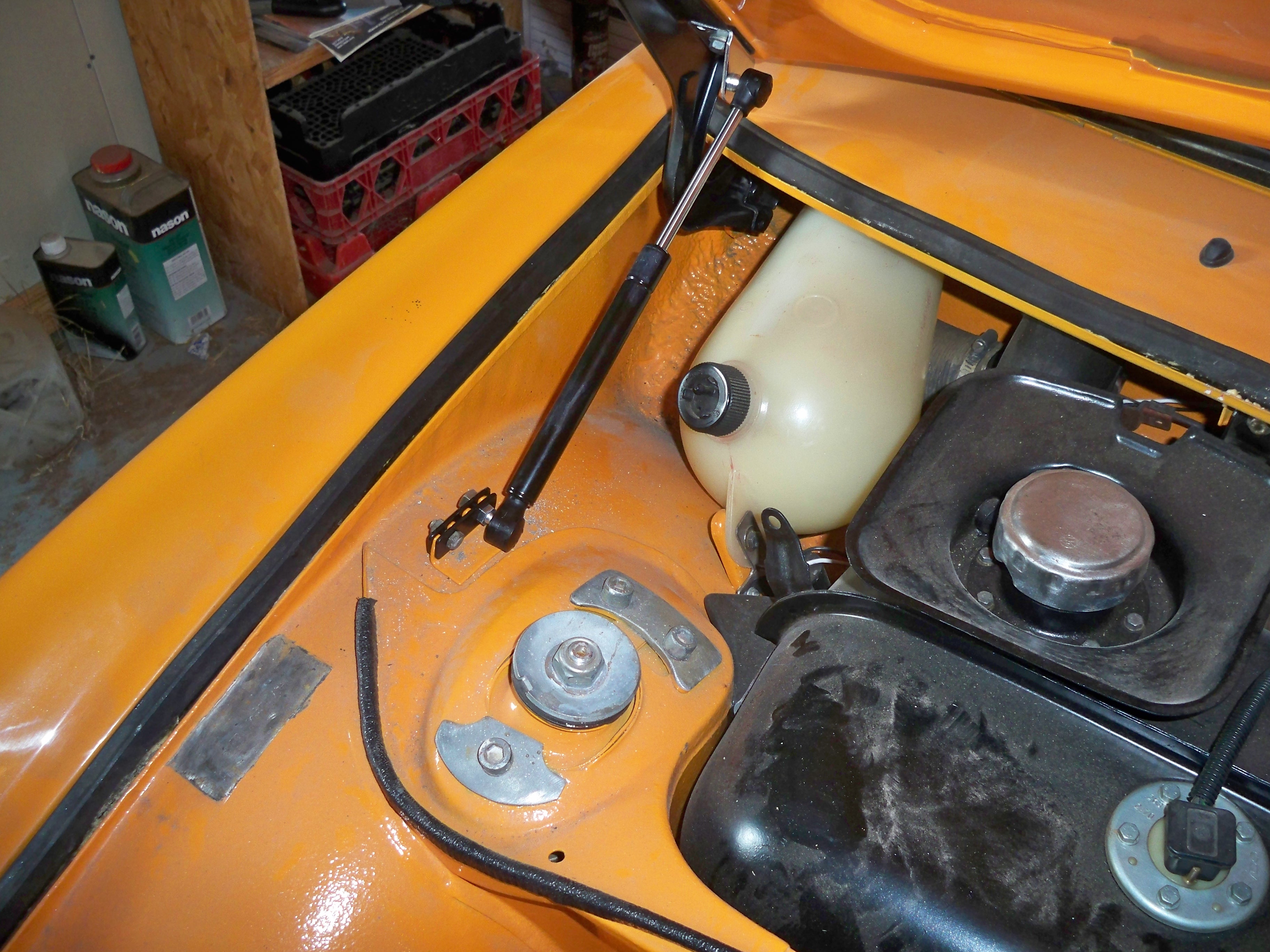

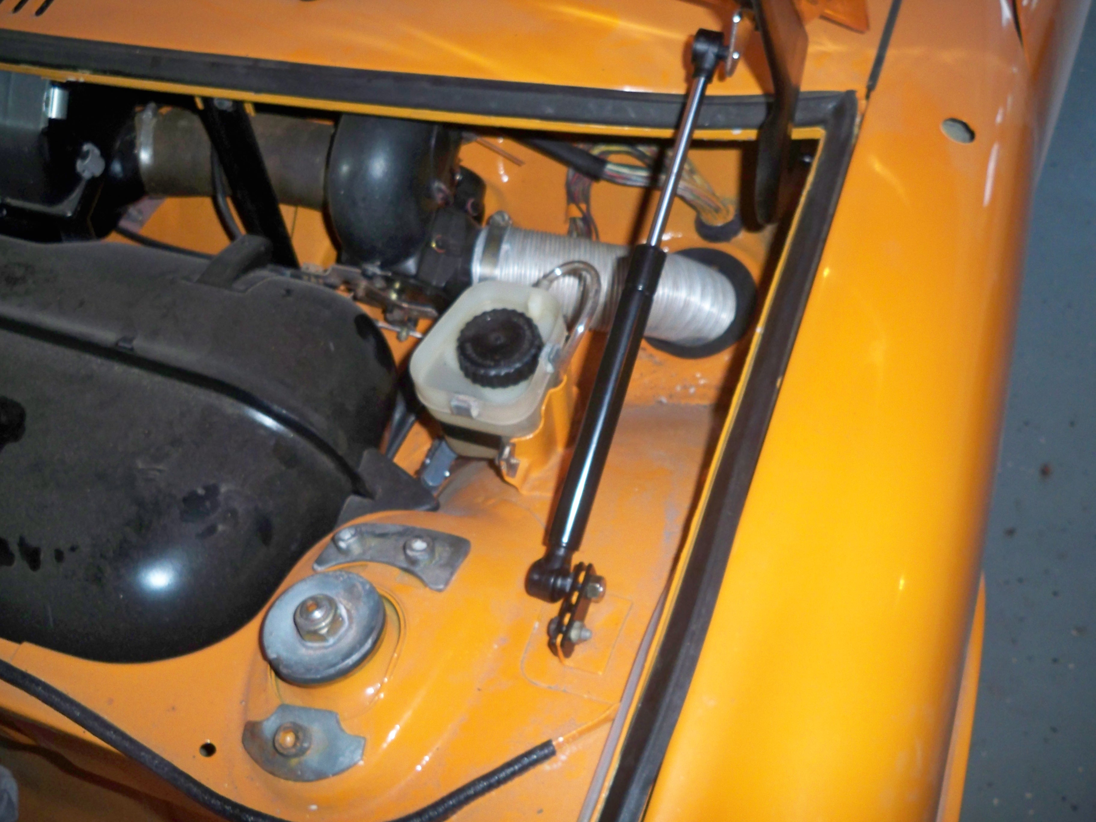

I got hood shocks from Camp914 and installed fronts on my '70 -6 conversion project.
I found that the shocks are pretty stout and the attachment at the spring anchor was bending in from the pressure. So....take apart....find some 5/8" scrap strap metal...overcome OCD impulse against using English measurements....drill holes for 10mm shaft on one end and 6mm one the other to line up with tangs on the spring anchor....grind and file....prime and paint....install with moderate effort and minimal foul language. Now the hood works and the spring anchors seem to hold. It will get a catch installed today too and hood emblem reinstalled....Holes drilled a little high by DAPO so what can I do...aaaaaannnddd....DONE! Engine goes in next.
