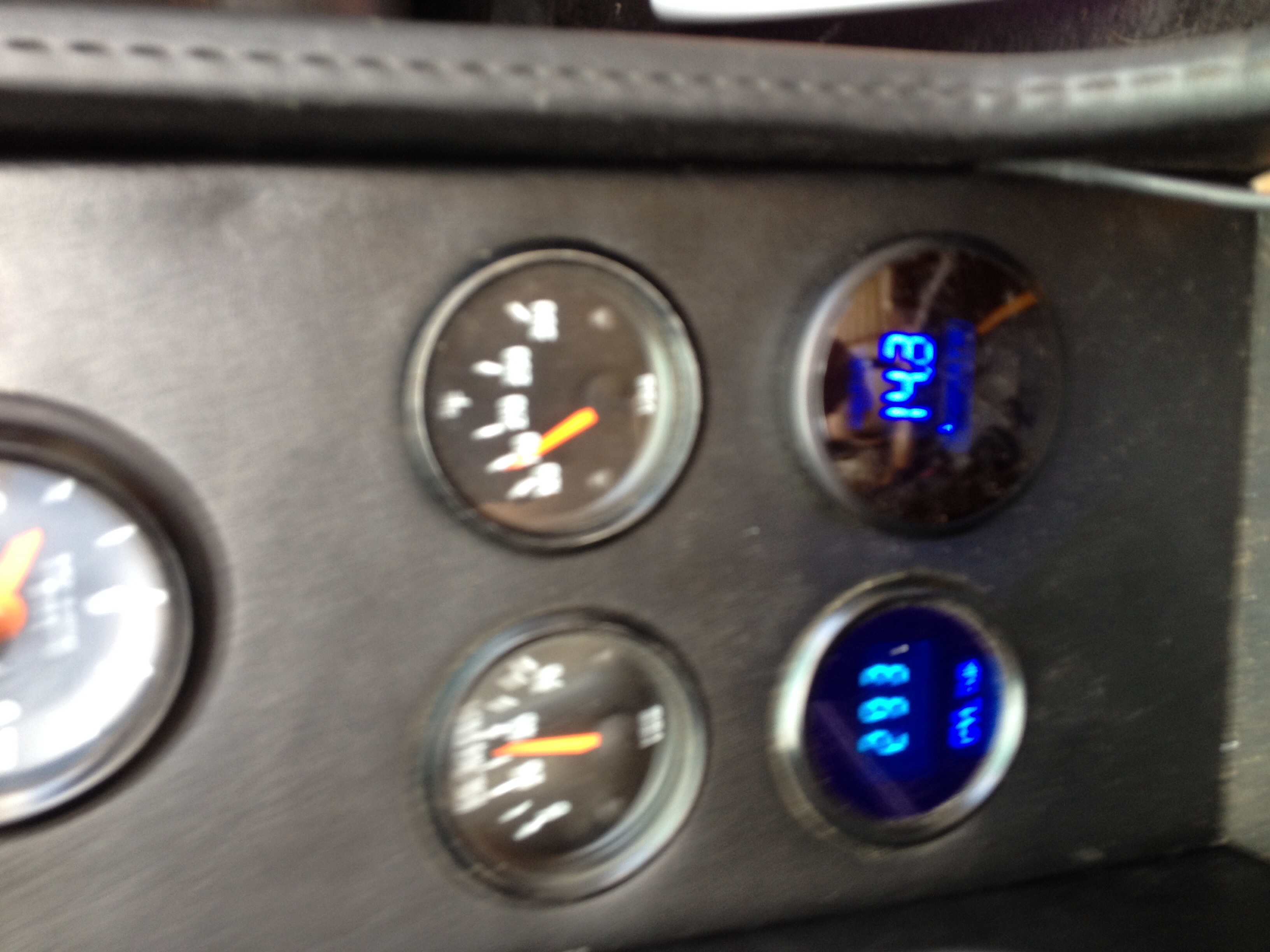

Installed an AFR gauge. Found my car was running more than a bit rich across the range.
Ended up weakening the dynamic to bring up the WOT reading, and leaning out the static. The Itinerant Air guide is very helpful, but a lot of guessing is eliminated with actual numbers.
What a sucky pic...

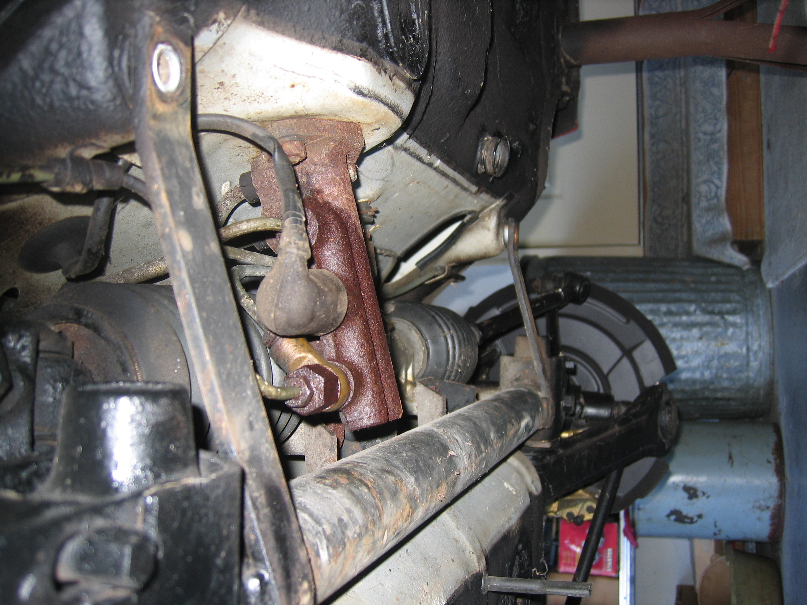

Unmolested, 17mm master cylinder, getting cracked for the 1st time in 40 years! No, it's not leaking, that's penetrating fluid soaking in overnight. Used a small wire brush to clean up around the threads & got them both cracked successfully this morning... (IMG:style_emoticons/default/smile.gif) Now to find my neighbor & get him to sit in the car & pump the brakes... (IMG:style_emoticons/default/dry.gif)

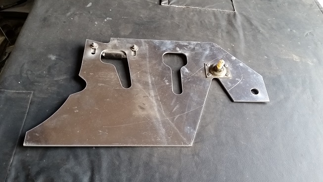

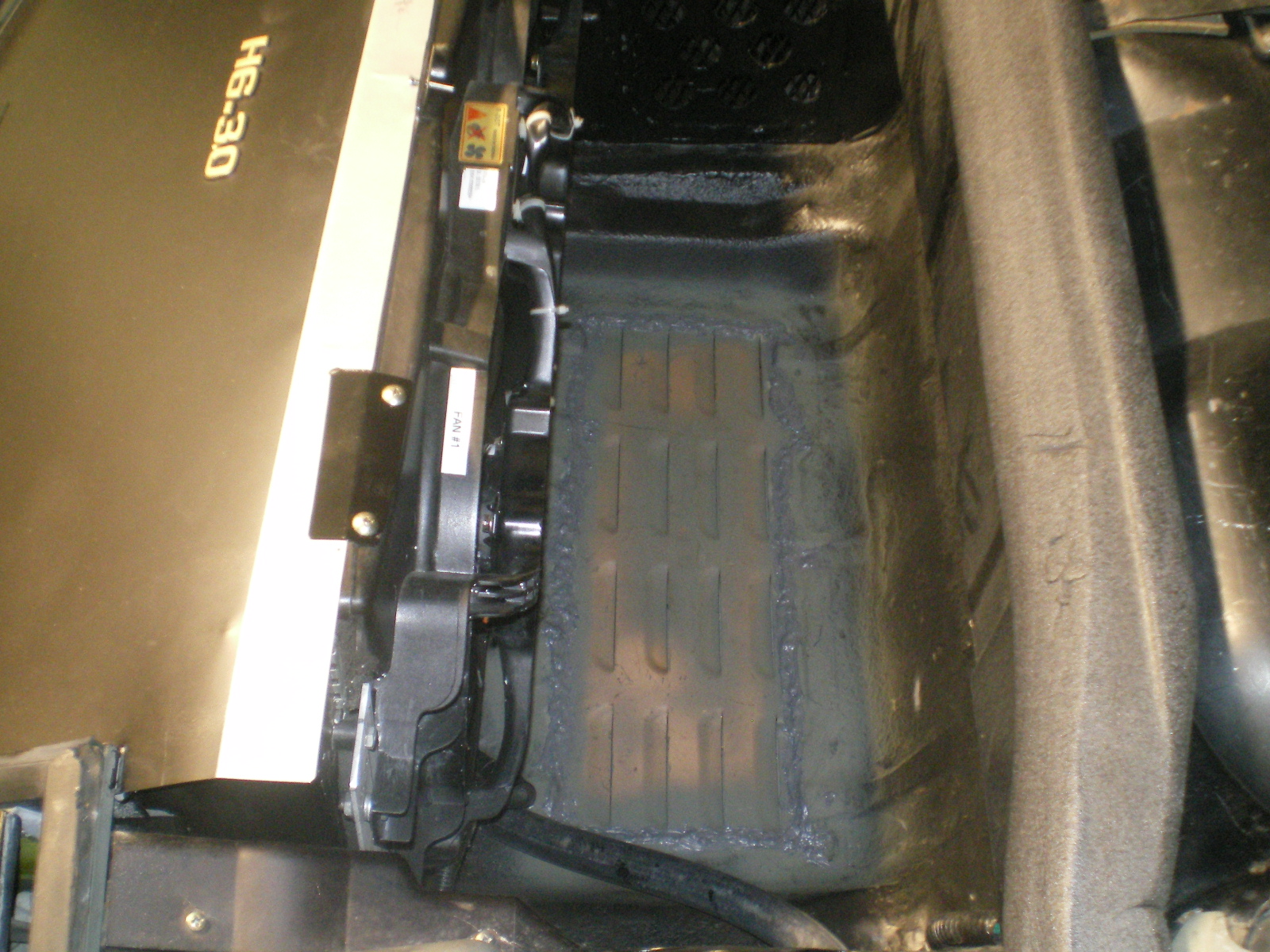

Installed new floor board.

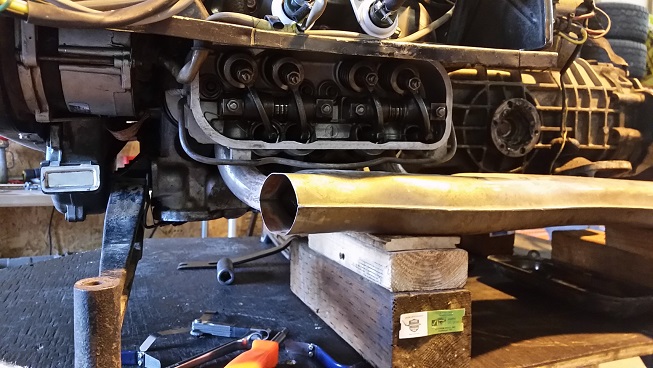

Adjusted the valves while engine was still sitting on the table. I do need to buy one of those stick on 1'*1' mirrors for under gearbox to see the flywheel.
I use the go, no go method. On the 2.0L adjust for 6, then test that the 7 won't go. Same with the 8 with 9. It's an anal thing
I only needed to adjust 3 intakes. Two loose. One tight.

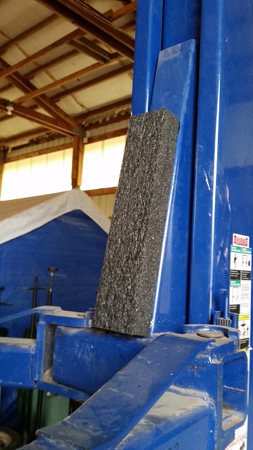

Added some bumper pads to my 2 post lift. old packing foam from something

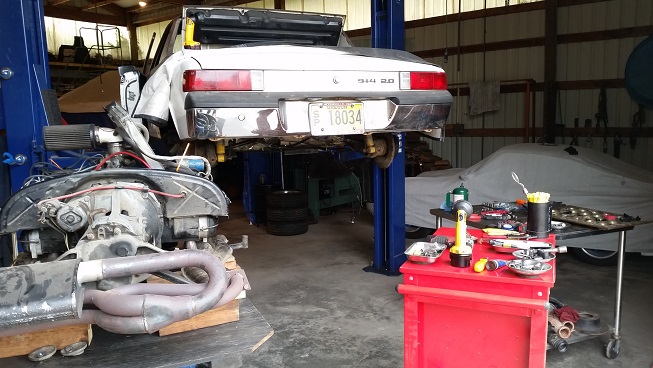

Pictures of the engine install.
New Super In Law gadget. Worked OK. Might need to be bigger and wrap around the backside to stay in place.
Everything ready to go ..................
Still pulled back the fuel rails
Dropping the car back on the engine
Did run to Ace and bought some new lock nuts for the motor mount bolts.
With everything I tinkered with I was a little paranoid (electrical) on the start up.
But other than those couple issues she ran like new car.

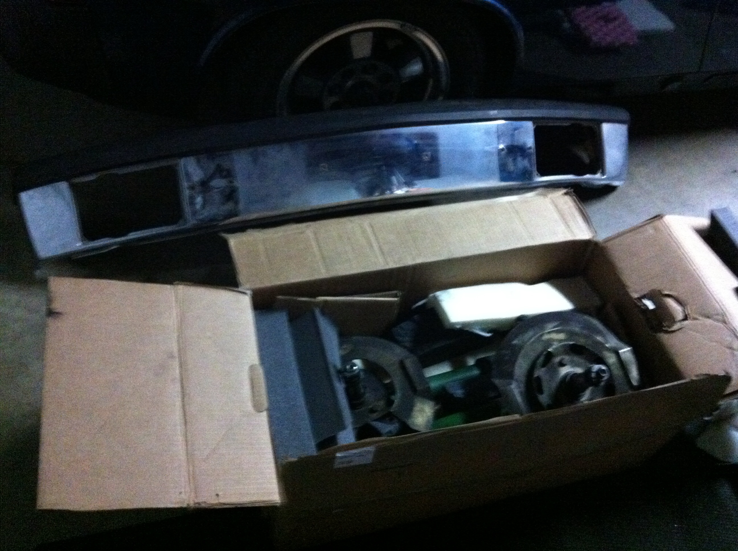

Went to a fellow 914world member to pay his 71 914 1.7 megasquirt set up with bunch of parts included on the sale.
Pictures is my drive heading home around 8pm at 605 freeway which my passenger are a box of 911 bilstein strut with hub and a nice front chrome bumper with perfect bumper top. Going to pick up the car this week with more parts.

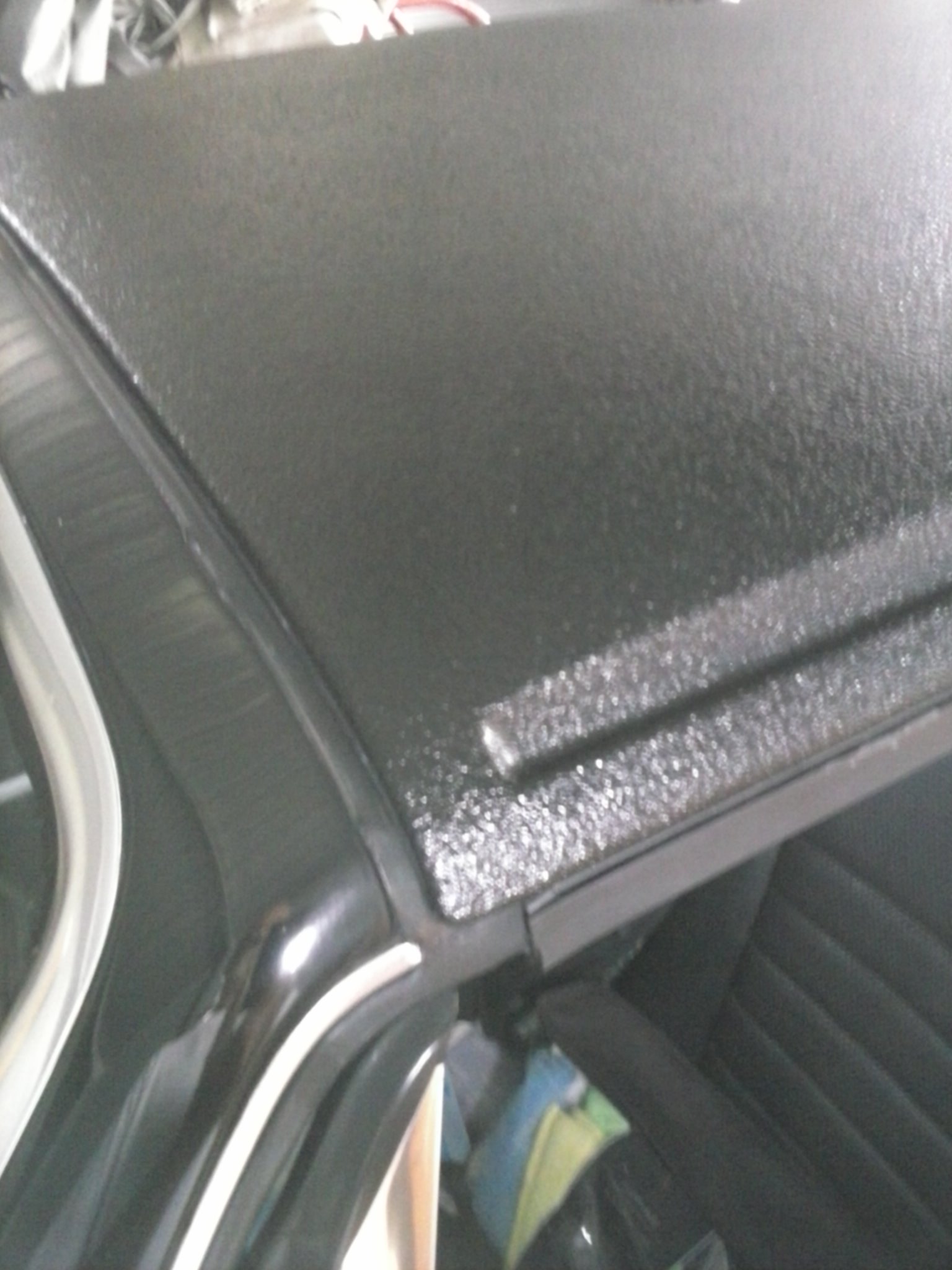

I finished the new refurbished targa top today.

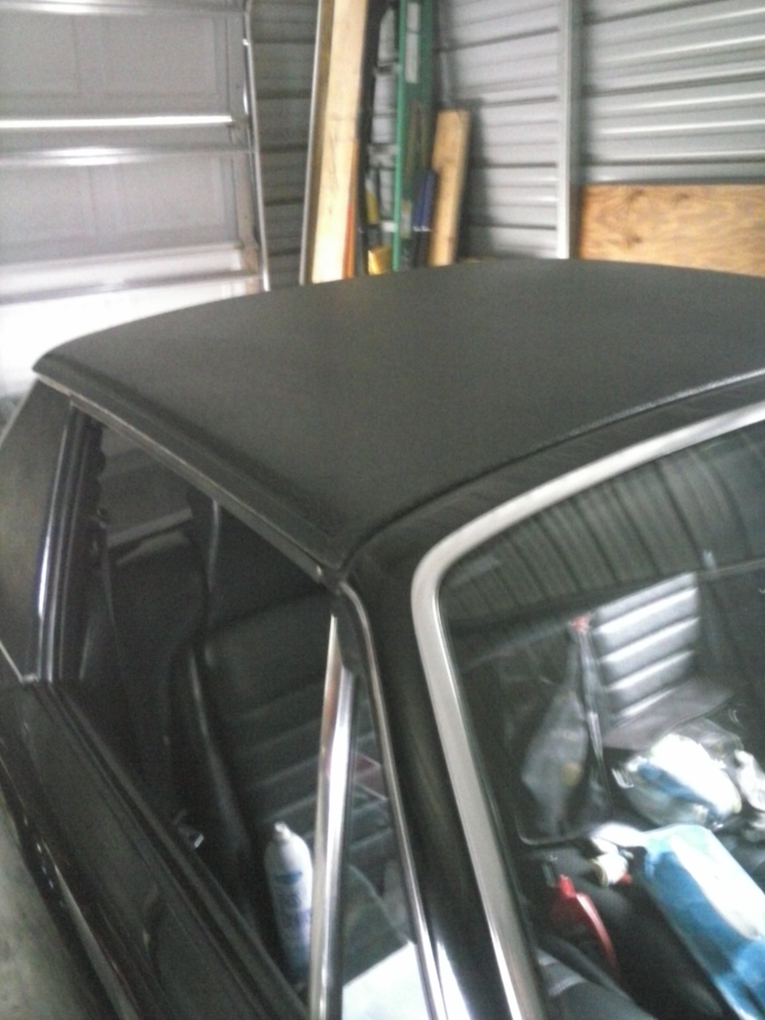

Installed the new targa top.

How did you refinish the top of the. . .top (IMG:style_emoticons/default/huh.gif)? Mine needs help before I can show it in public again.

Hey Bryan, no the top came from Linda painted along with the rear valance done . Now that I know how to spell it Ican find a place to get the front one done.

Thanks Joe. My last attempt to refinish the targa top didn't hold up very well. I will take it to someone who can prep and spray better than I can for the next round. The Line-x looks pretty good.
