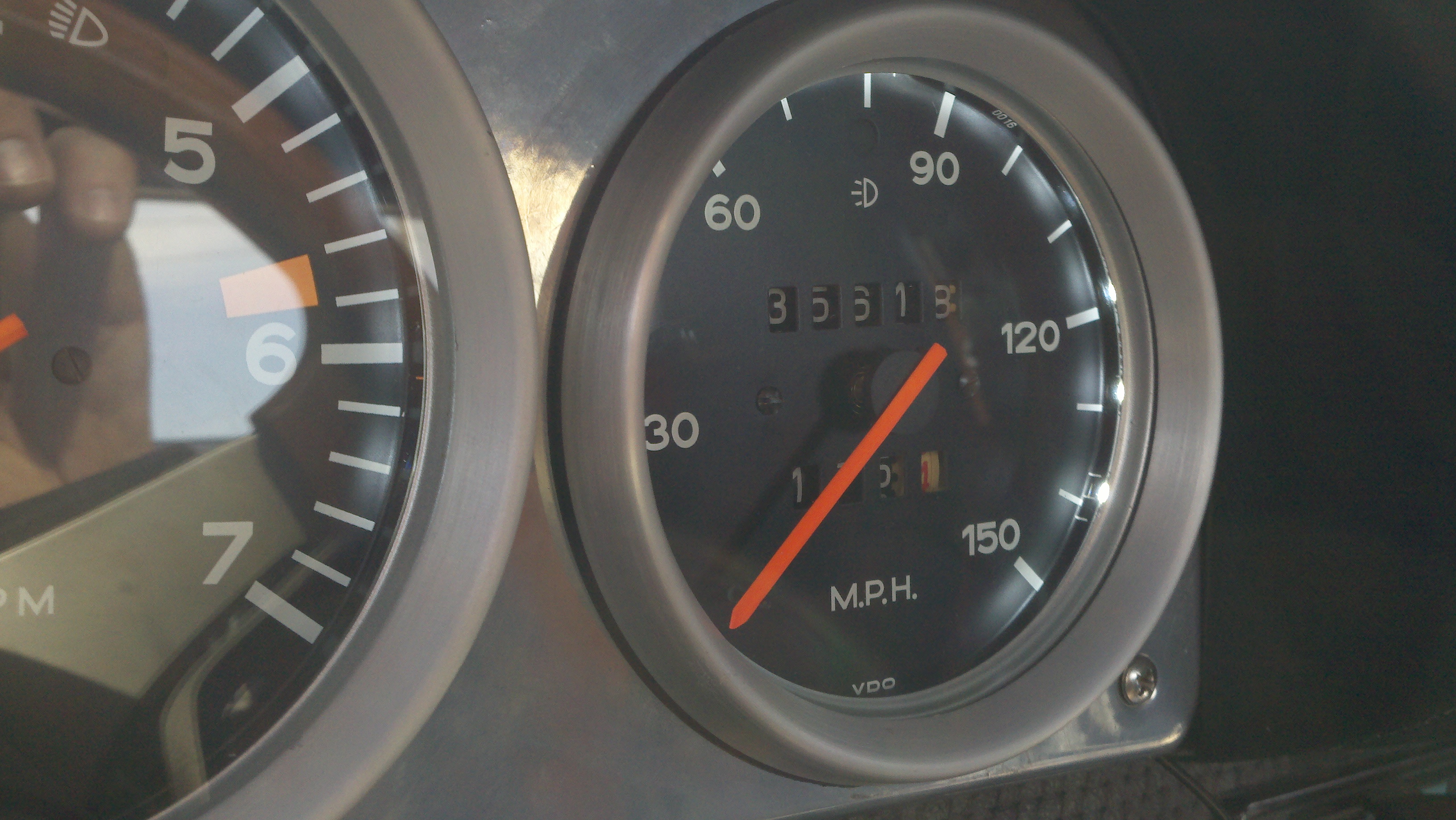

DRPHIL914
post Feb 22 2012, 08:42 AM
Post #483
Dr. Phil
Posts: 5,950
Joined: 9-December 09
From: Kennesaw, GA
Member No.: 11,106
fine tuning the MPS for proper A/F (had been running way too rich, got an mps that was set to factory specs , caused bad idle issue - it was WAY lean, - now it seems to be good, ran great to work yesterday, and
Drove it to work today, - yesterday put in a new rear window/engine deck seal- old one came out in a thousand pieces.
- blew a fuse today not sure why? #8/9 lost the tach, fuel level, cigarette lighter, console volt meter and oil temp. so what i dont know until i can troubl shoot this at lunch is whether there is a short or loss of ground connection that caused the fuse to blow or just a fuse issue---
fun fun fun. (IMG:style_emoticons/default/blink.gif) its the usual- drive the car 2 weeks , fix something. etc
- at least it is not on jackstands! (IMG:style_emoticons/default/biggrin.gif)
getting in on the egmann fuse panal buy. (IMG:style_emoticons/default/aktion035.gif)

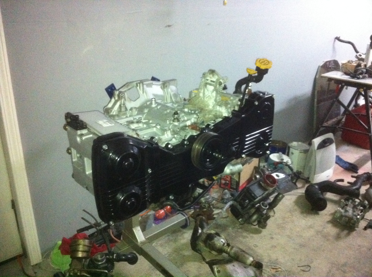

effutuo101
post Feb 22 2012, 10:32 AM
Post #485
Posts: 2,738
Joined: 10-April 05
From: Lemon Grove
Member No.: 3,914

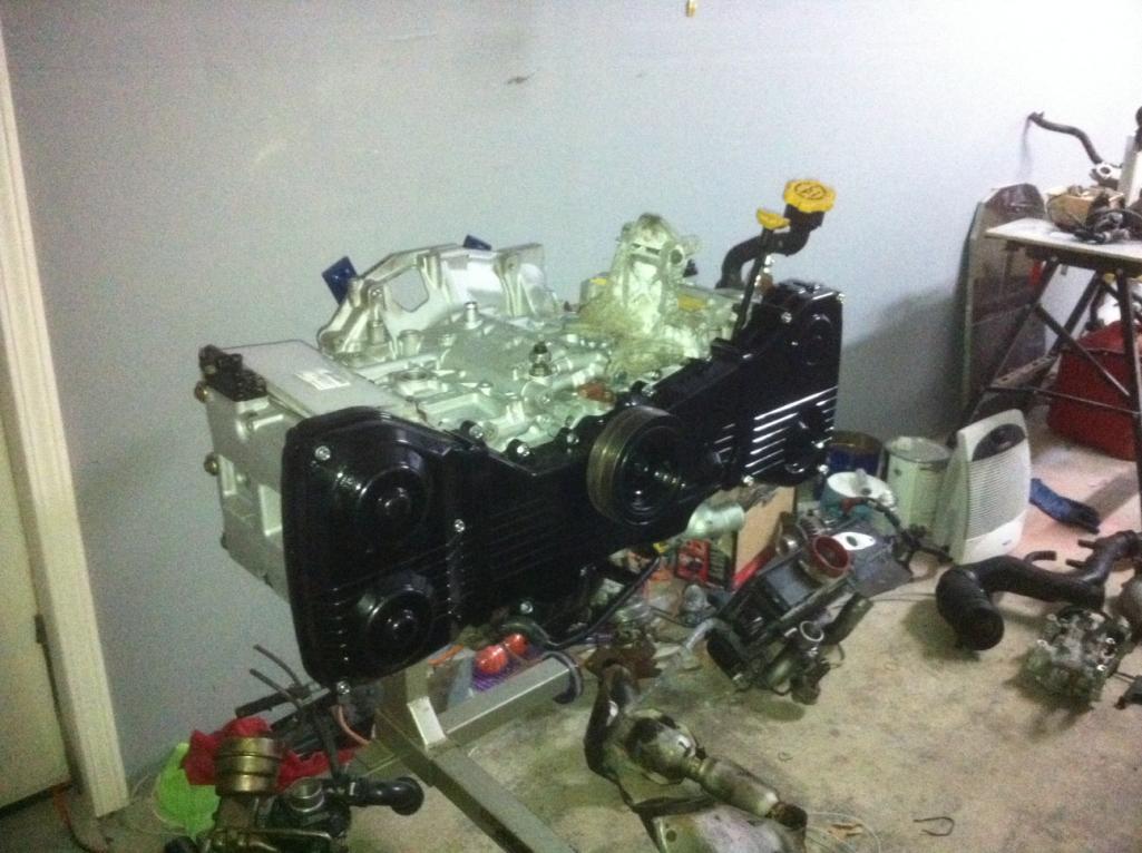

Retrieved my motor yesterday. Started mocking up parts. next step, transmission and engine cradle.
Engine: Subaru Japanese spec 2.5L sequential turbo with 300hp and 300ft lbs of torque from the factory. I will probably go with a single turbo to get the car on the road.
From the car side, got my front hood fitted, now I have to get the headlights in and finish fitting them.
On the rear deck i have to finish up the duck tail and get everything welded into place.
Take the doors to get welded and then media blasted. then back to my house for primer.
Shoot the two lizard skin components in the cabin and firewall.
iron out a few wrinkles and re primer, cut and sand then ready for paint.

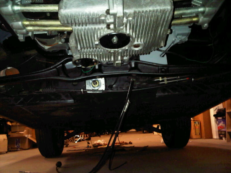

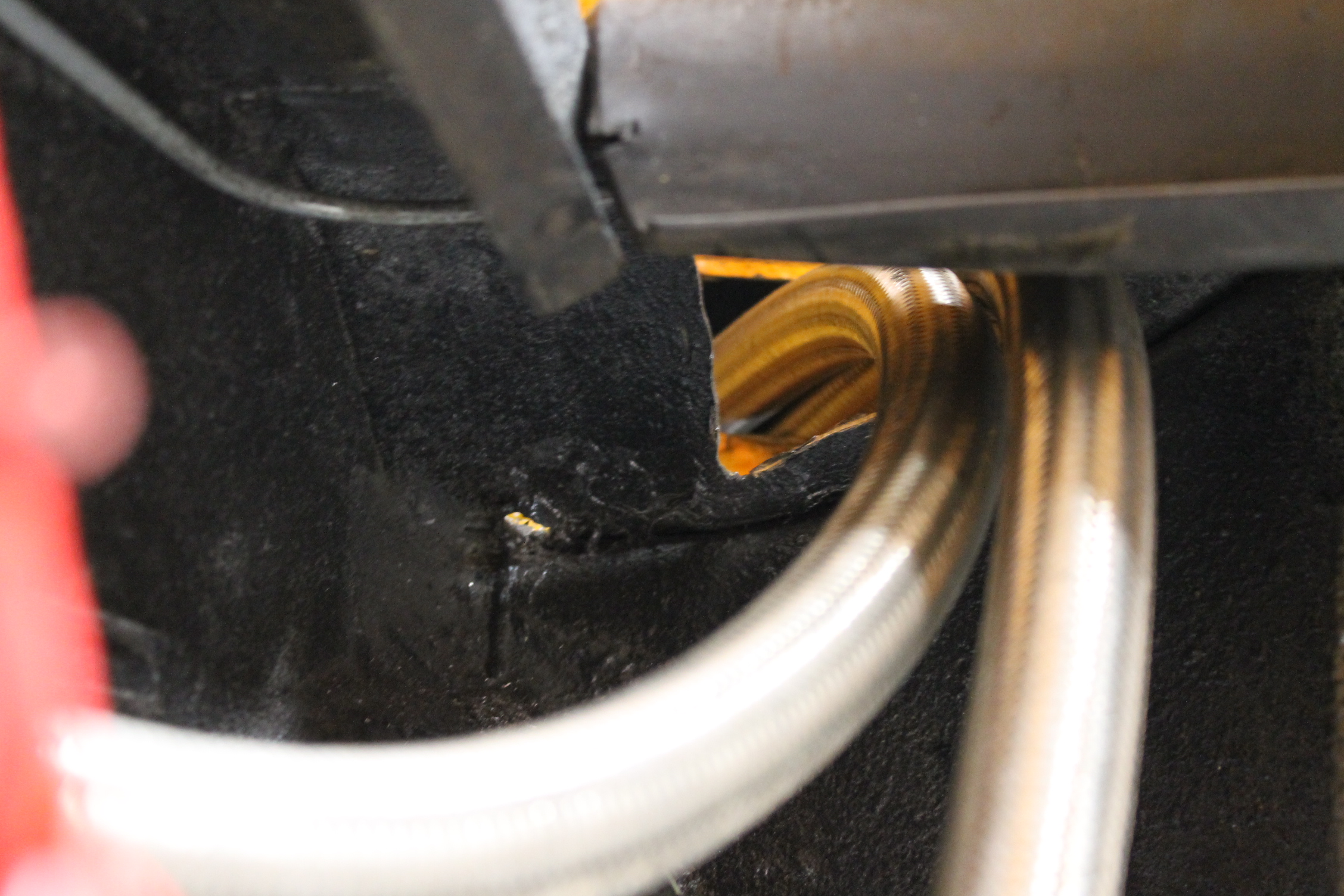

Richard came by the shop Monday and Tuesday morning. The engine and transaxle are bolted in and the axles attached.
It looks like I need to re-engineer the mounting plate for the Tangerine firewall bearing to allow for a little more shift rod travel (IMG:style_emoticons/default/smash.gif) (IMG:style_emoticons/default/sawzall-smiley.gif) ... otherwise the H/Es and Triad would have been installed too (IMG:style_emoticons/default/dry.gif)

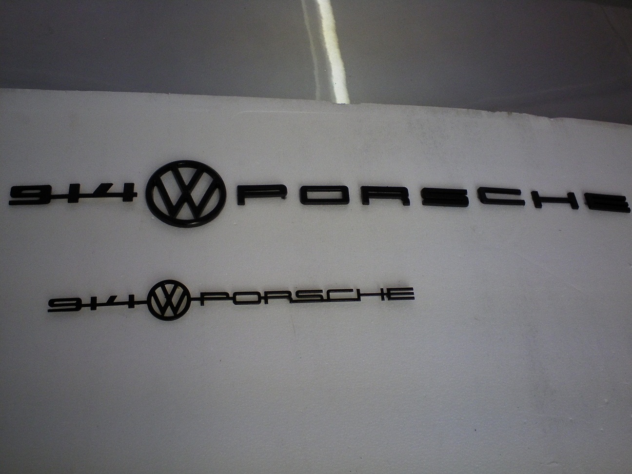

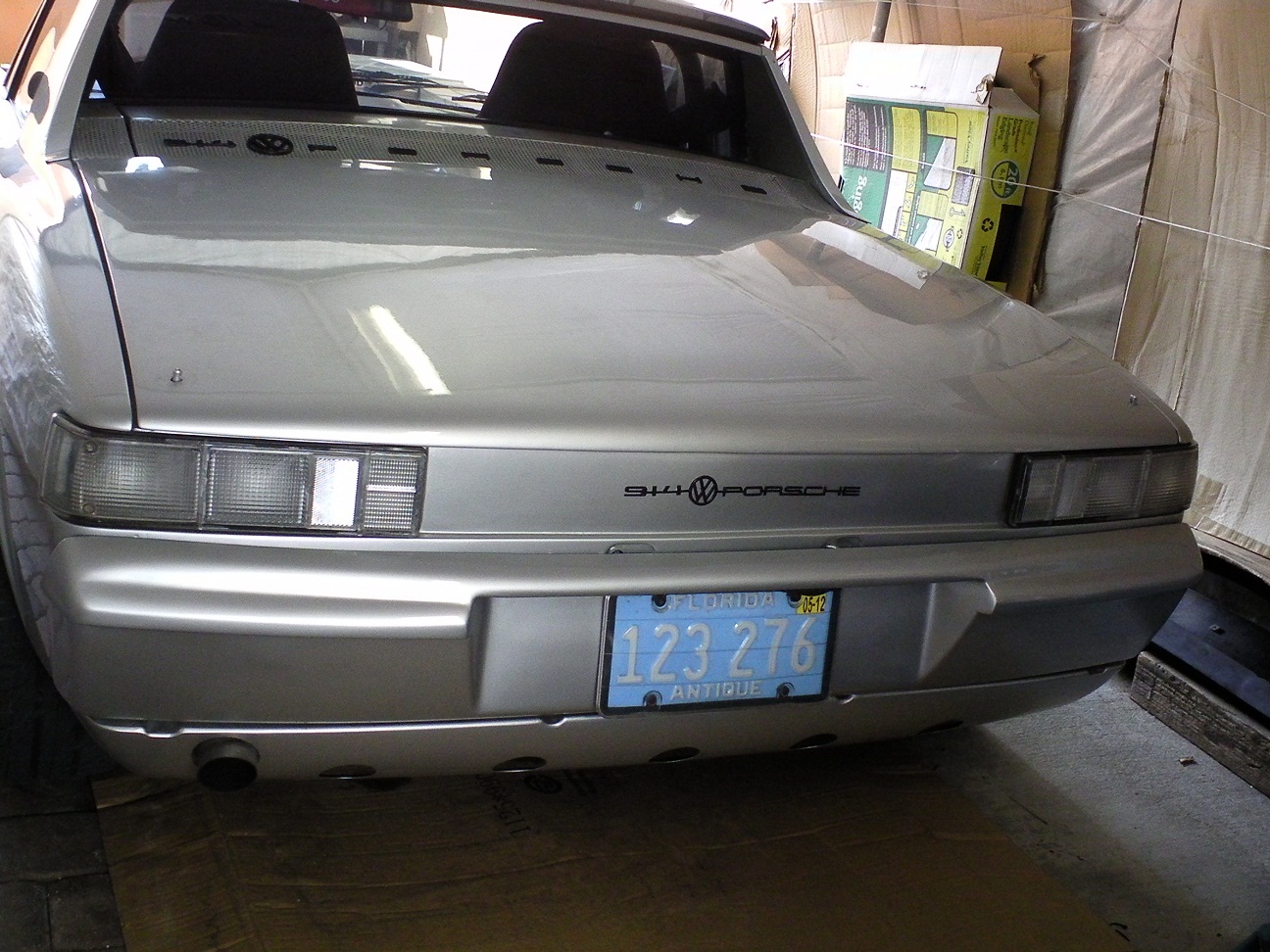

post Feb 22 2012, 08:23 PM
Post #492
Posts: 313
Joined: 1-March 08
From: suburbs of Miami FL.
Member No.: 8,762
Installed emblems ( now I dont have to tell them what kind of car it is (IMG:style_emoticons/default/biggrin.gif) )
euro911
post Feb 23 2012, 04:19 PM
Post #493
Posts: 8,937
Joined: 2-December 06
From: So.Cal. & No.AZ (USA)
Member No.: 7,300

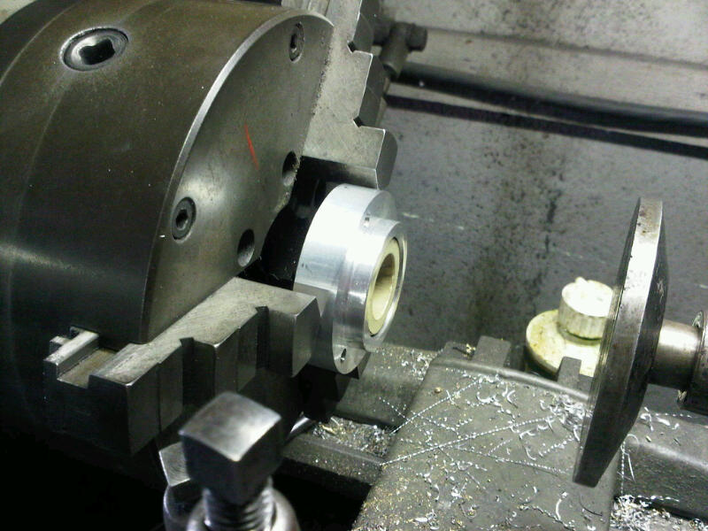

I had a friend take a little material off of the back side of the shift rod bearing's housing. This should take care of the shift rod travel issue.

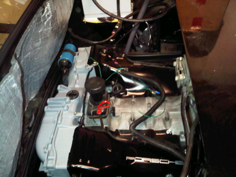

got my push rods and rocker assemblys, oil cooler and fan w/ shroud intalled on the engine. Pulled the car infront of the garage and got to working on the body again. got a few holes behind and under the driver sail pannel welded in. and the battery tray out. its trashed so ill make a new one. gotaa fix up the hell hole a bit first. the other side is surprizingly good. the rest of the car not so much

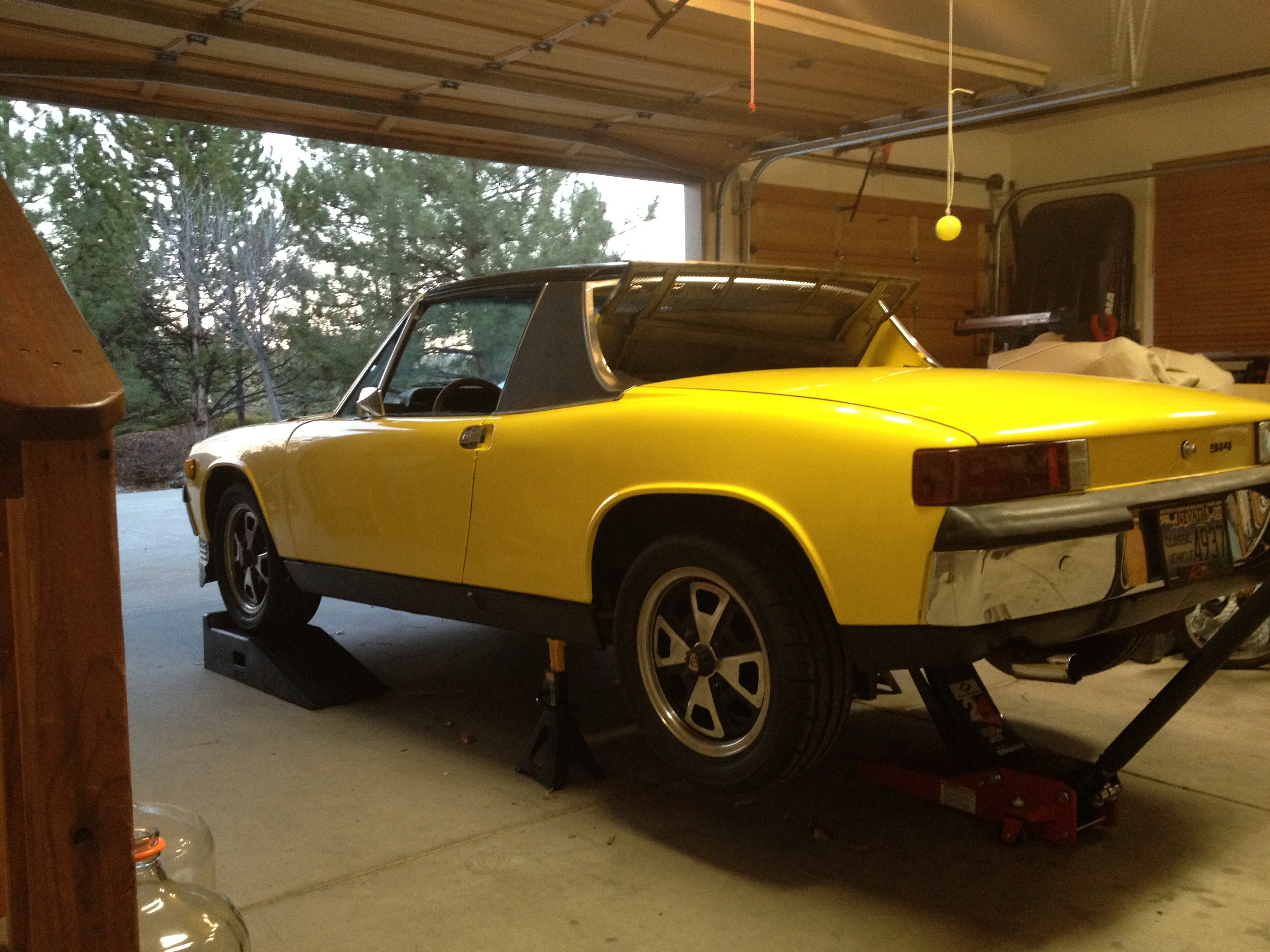

post Feb 23 2012, 10:30 PM
Post #500
Posts: 31
Joined: 18-August 09
From: Colorado
Member No.: 10,694
Got the 914 up in the air to drop the engine for the first time. Bit nervous but am optimistic that all will go well!
