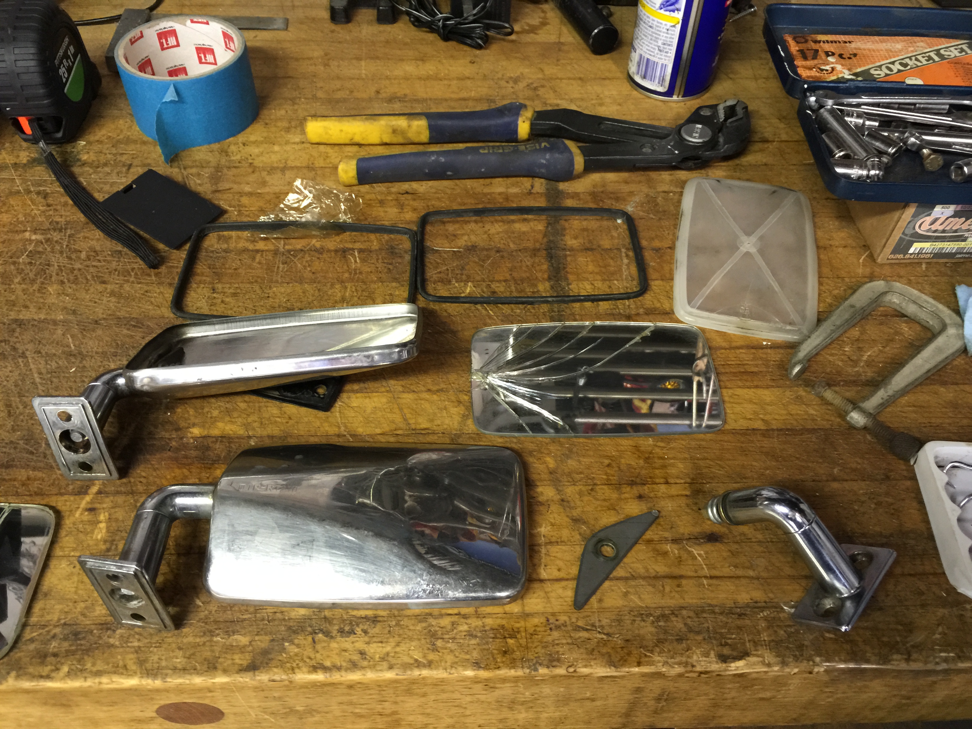

working on new RV mirrorsAttached Image

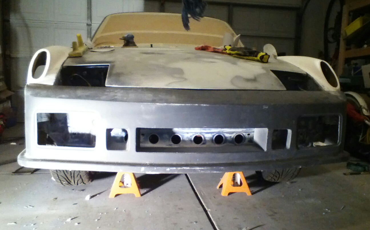

Fixed IMSA bumper brackets and did some filler work on fenders. Hoping to shoot primer later this week. (IMG:style_emoticons/default/smile.gif)

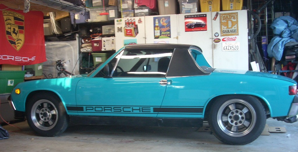

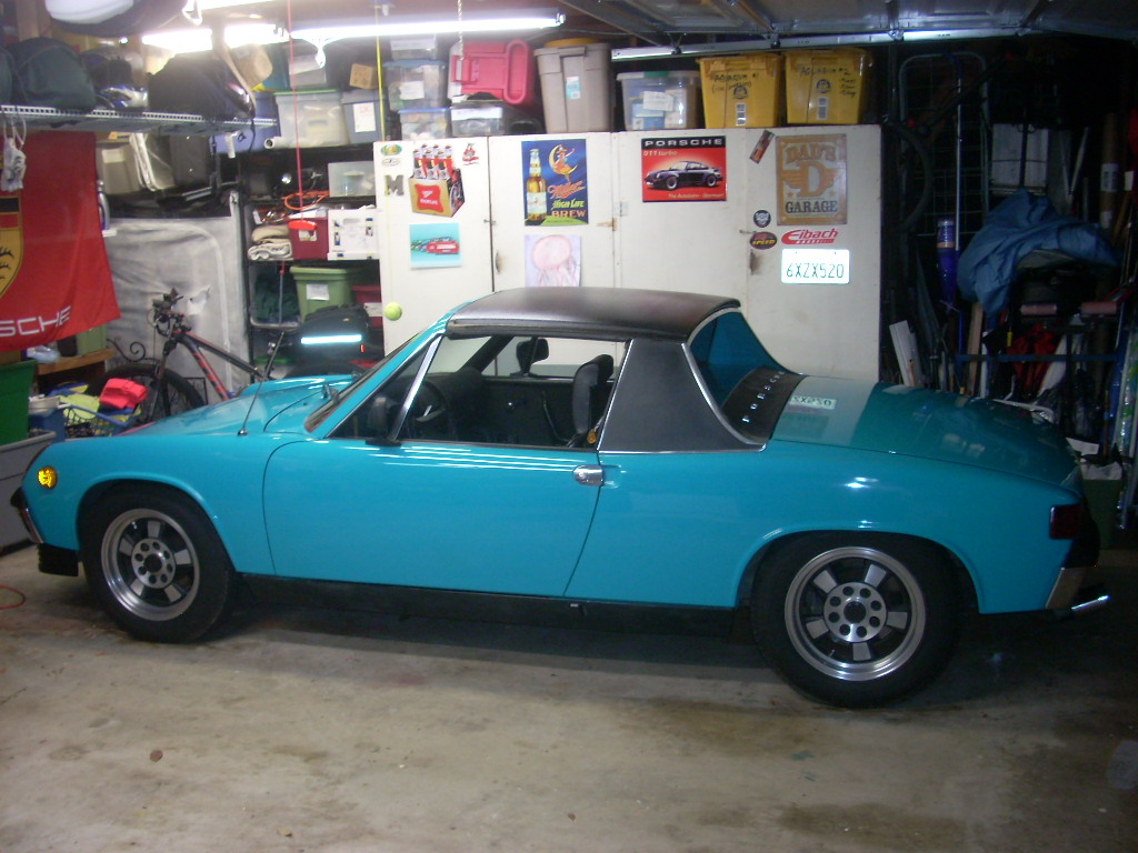

Put my side stripes on (before and after pix):

Very nice!

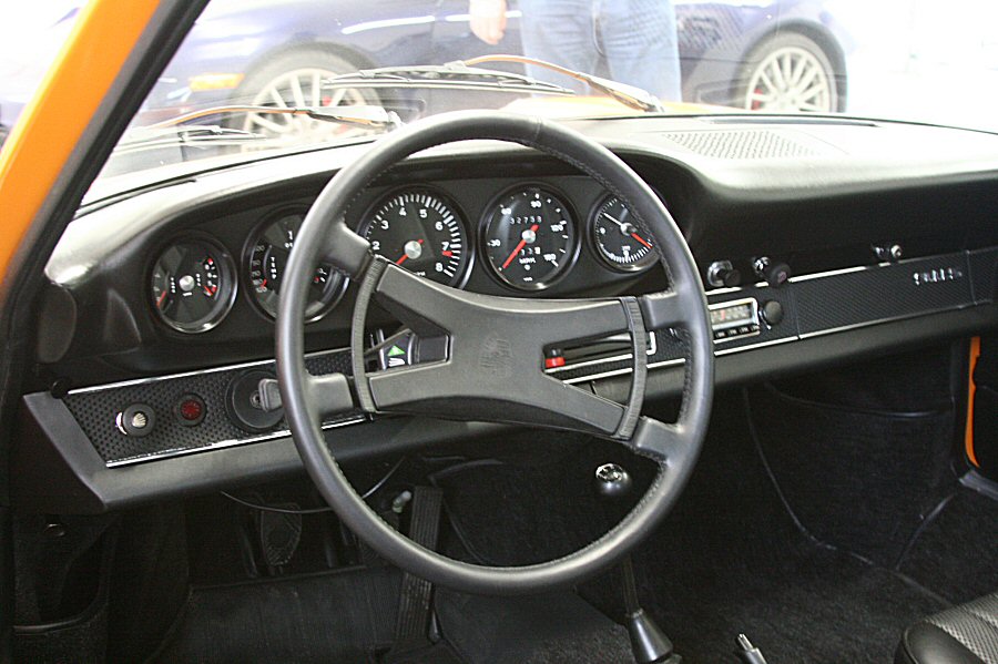

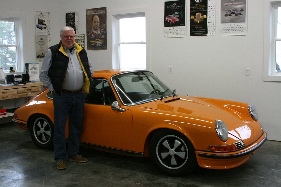

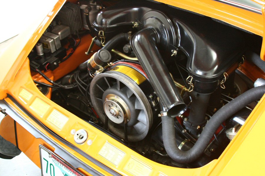

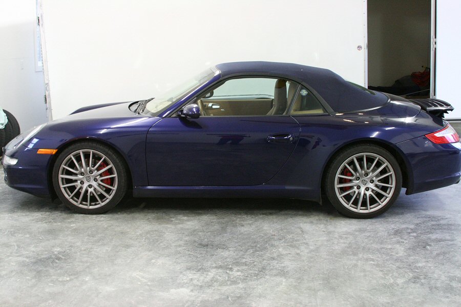

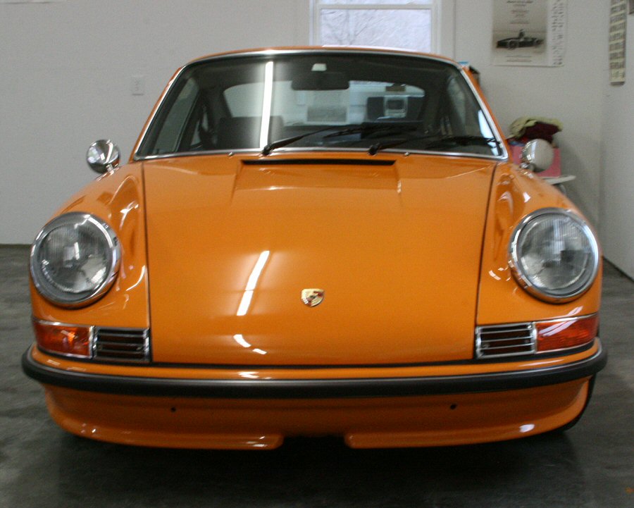

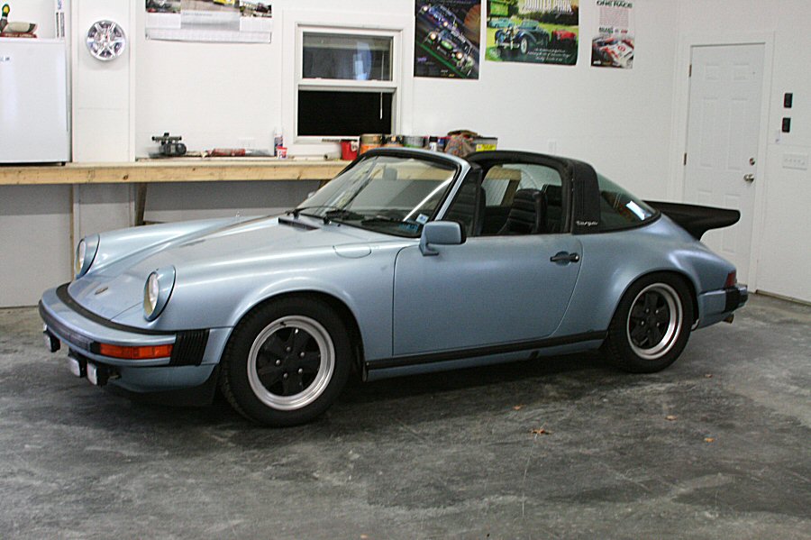

I was getting my annual termite inspection and the inspector saw my 914. He said he just inspected a home that has four 911's! He gave me his name and I called him. He just recently moved up here from Jacksonsville, Florida area where he was their PCA president.
The orange 1970 911S is just awesome. Complete tear down to bare metal restoration job. It was a three year restoration. The 911 has won several national show car awards.
The silver blue 1980 911T is next project. His daily driver is a 2005 Carrera S.
He has a 1973 911T too!
Needless to say, I was in complete awe! (IMG:style_emoticons/default/drooley.gif)

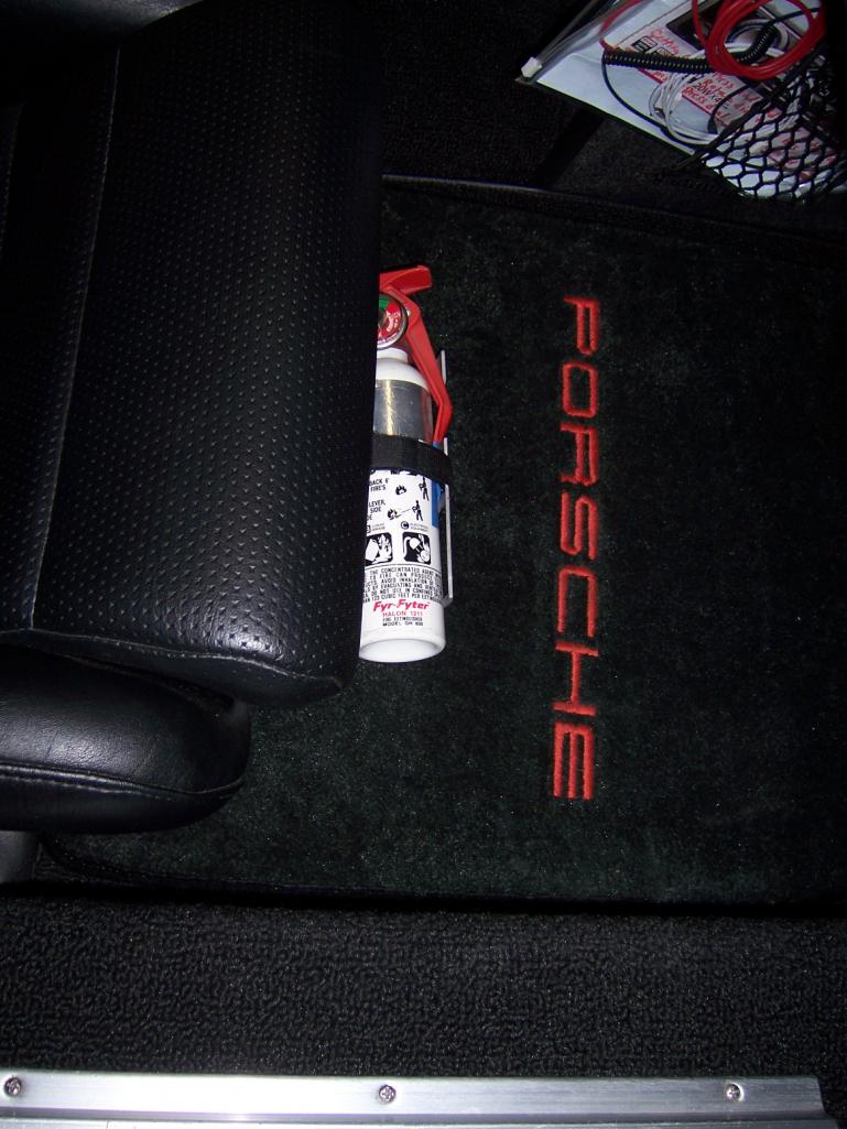

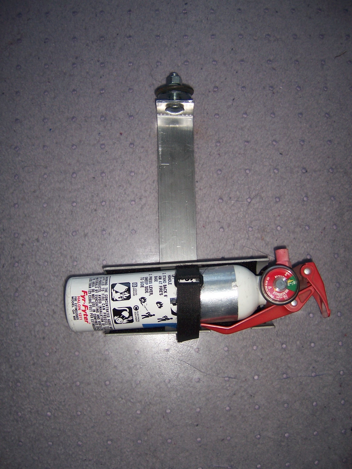

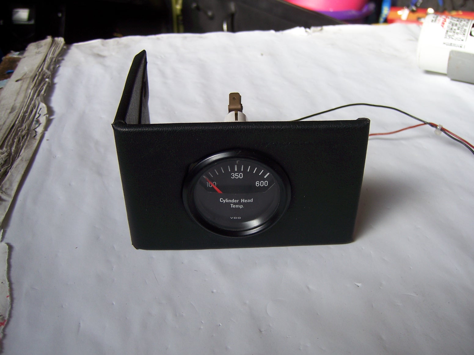

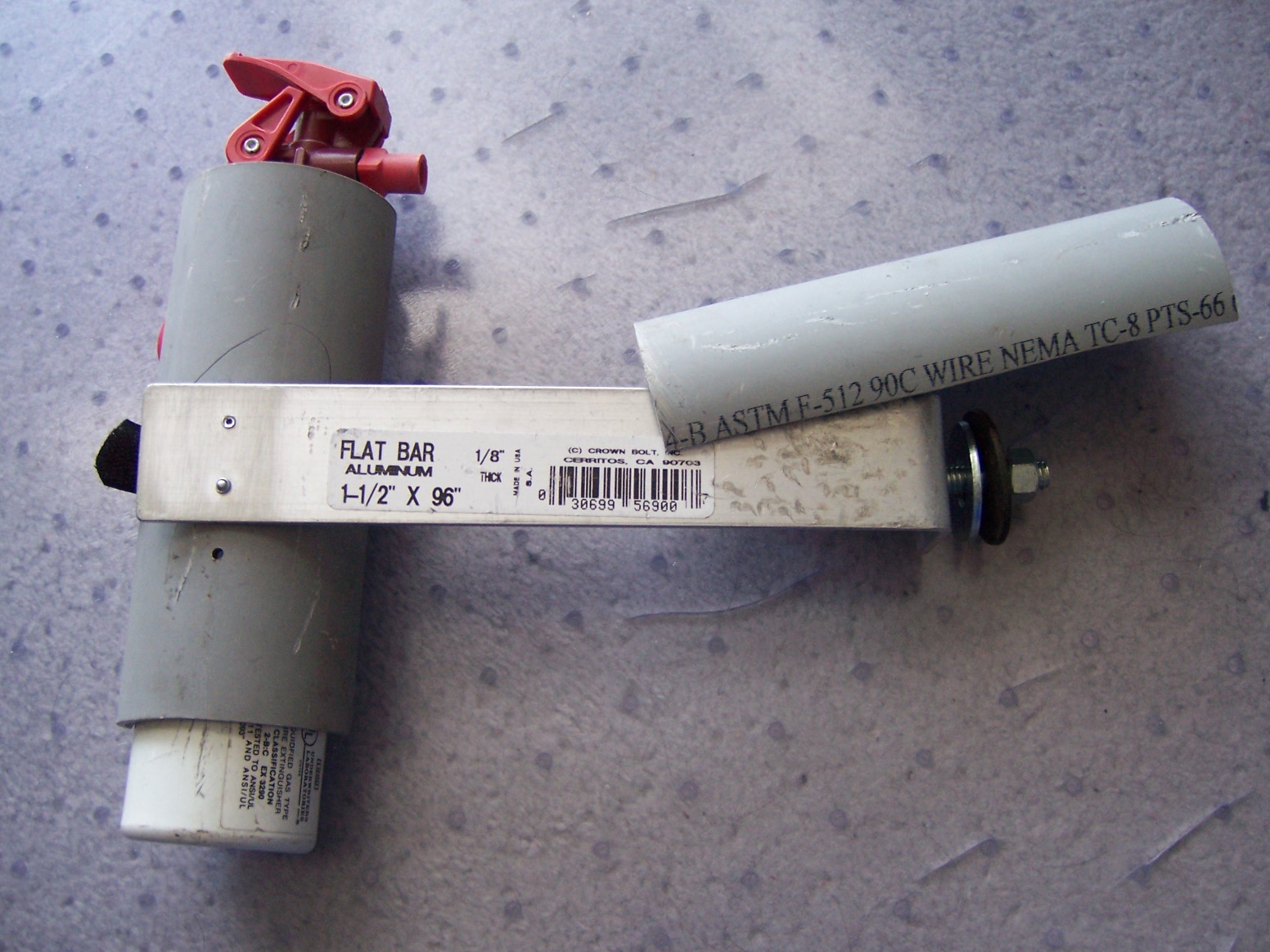

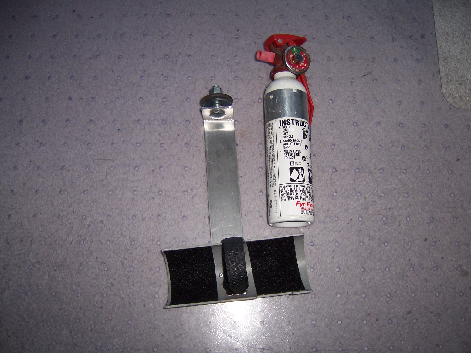

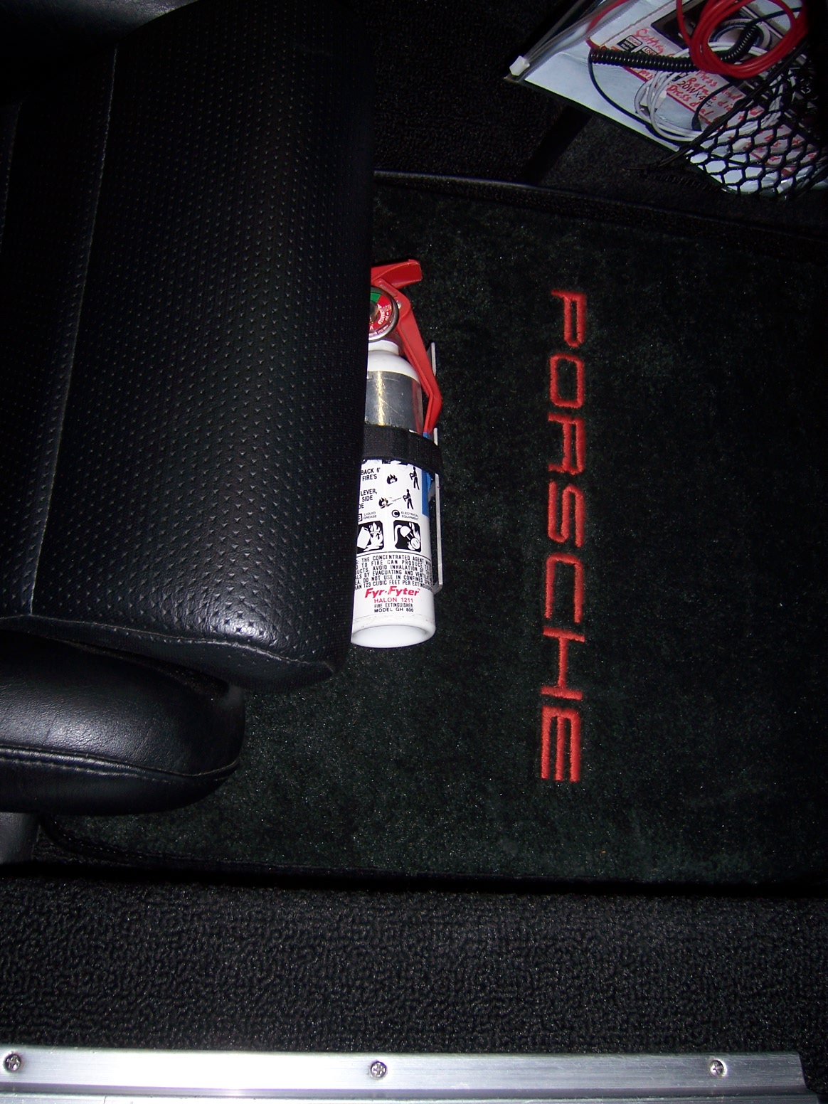

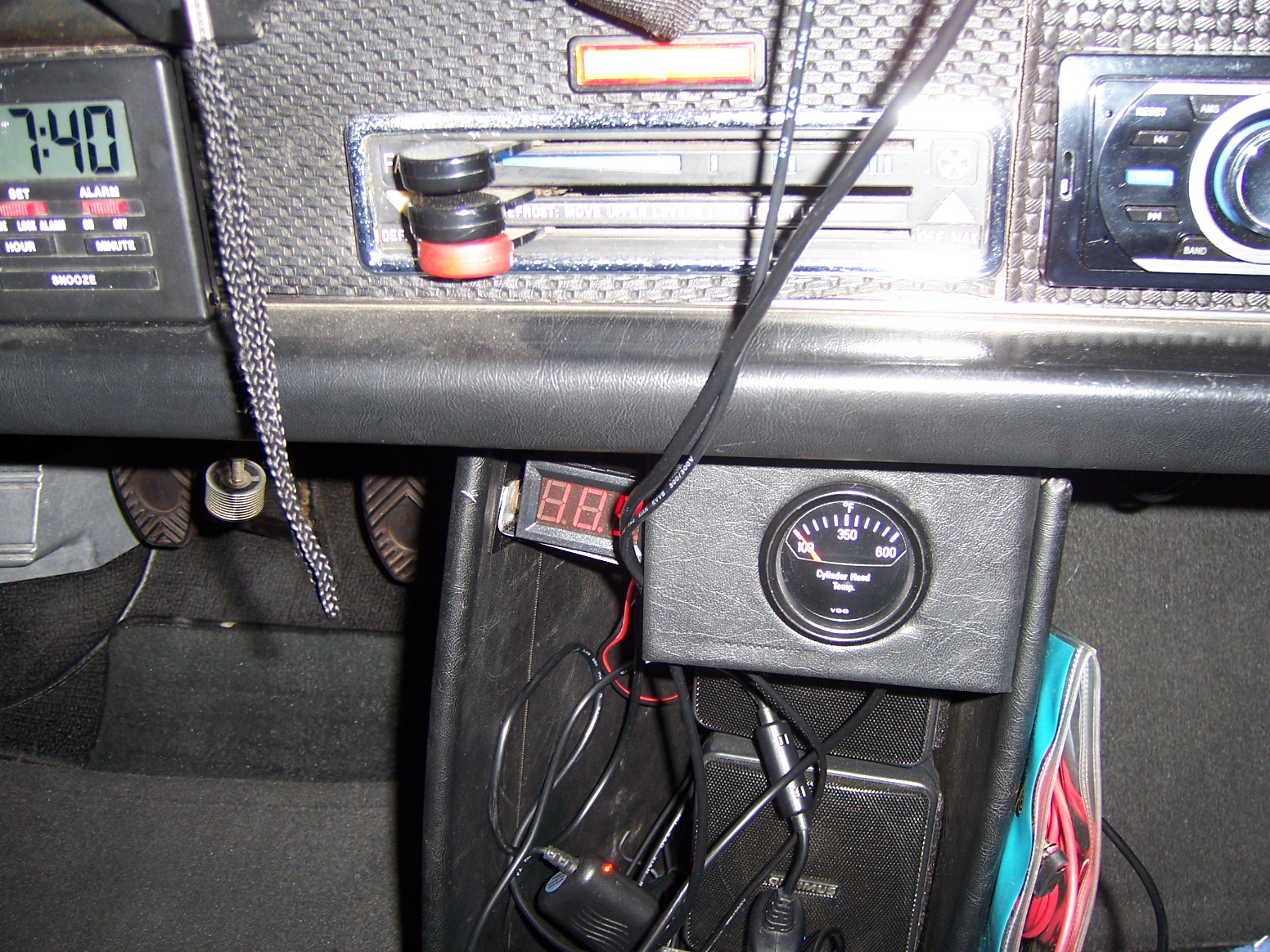

fabricated a halon extinguisher mount out of plastic pipe and aluminum bar stock and installed the #3 spark plug VDO head temperature kit. I also fabbed up my own VDO bracket out of aluminum and covered it in vintage sheet vinyl from a 914 seat. I know the VDO CHT has a bad reputation for being inaccurate, but it provides some information.

QUOTE(dangrouche @ Dec 30 2014, 06:26 PM) *
Where are you mounting that cylinder temp gauge bracket?

Nice job on the extinguisher mount- clean, simple and cheap as fuch! (IMG:style_emoticons/default/smilie_pokal.gif)

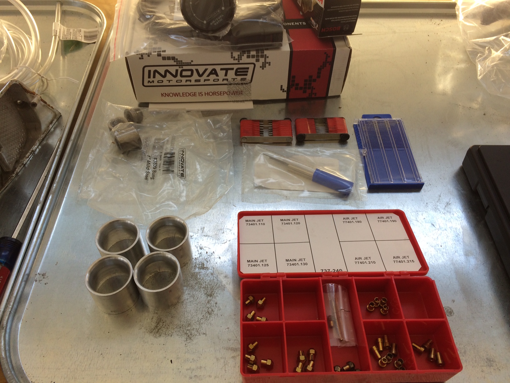

Changed my venturies to 32 from 28.
Then I used my Christmas present, an AFR meter from Innovate Motorsports (IMG:style_emoticons/default/piratenanner.gif) , welded in a bung for the O2 sensor in my muffler and I was set to do some rejetting (IMG:style_emoticons/default/chowtime.gif)
Ended up to increase the accelerating pump jets, and idle jets to 60, Main all the way up to 140.
Now I have a strong running 914 Pulling all the way (IMG:style_emoticons/default/driving.gif) great and the Cyl. head temp down and great AFR readings...
So happy (IMG:style_emoticons/default/biggrin.gif) Long time that I wanted to be able to set those carbs perfect

QUOTE(CG-914 @ Jan 1 2015, 06:49 PM) *
... So happy (IMG:style_emoticons/default/biggrin.gif) Long time that I wanted to be able to set those carbs perfect
Cool. I need to revisit the jetting game since I changed my muffler. It's close, but not quite 'there' yet (IMG:style_emoticons/default/dry.gif)
What size pump jets did you have to go with?
Are you running dell's or Webers?
