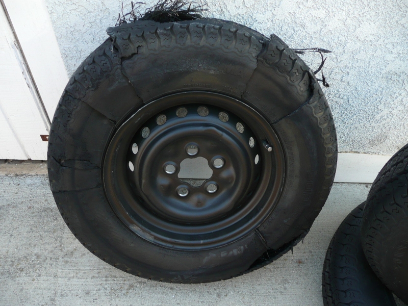

This borders on embarrassment and I should just say I changed tires and be done with it, but no. On the return trip home after the last GnR I felt I had thrown a tire weight. More recently, Kugel began to ride like a Stage Coach and felt as if it were moving up n down! (IMG:style_emoticons/default/confused24.gif) I began to envision my engine cradle flexing and to imagine the best course to reinforce the cradle. After all, I had "tracked" the tires rotation and all seemed to be within 1/8" of being true and had been balanced "to be sure".
I found a post here that stated where the date code is located. Hmmm, it appears that mine were made 5th week of 1998. Shouldn't tires last longer than that? (IMG:style_emoticons/default/wacko.gif) I switched tires/wheels between Whitey and Kugel and OMG what a fuching difference! I don't believe that these 165/80/15's will like the six very much but I'm enjoying the smooooooooth hi way cruise and the lower rpm's (IMG:style_emoticons/default/biggrin.gif) not to mention the handling and how nice Fuchs look on a black car!
In retrospect, I believe some of those "rides" that I gave at GnR were the nails in the old tires coffin. Now, I'm glad that I never got over 105mph. I knew they were old but not that old. (IMG:style_emoticons/default/headbang.gif)
If your wondering where the date code is.........if made since 2000, the date code is last 4 digits of an 8 to 12 letter stamp following the DOT stamp. 079822120409 = 4th week of 2009. If made in the 90's the last "3 digits" are the date code and will have a small triangle stamped in the start of the series. 88347498 = 4th week of 1998. Or something like that. (IMG:style_emoticons/default/beerchug.gif)
Yup ...
BTDT (IMG:style_emoticons/default/dry.gif)
If you have cracks developing in the sidewalls, also check between the treads ... and chuck 'em, FAST (IMG:style_emoticons/default/shades.gif)

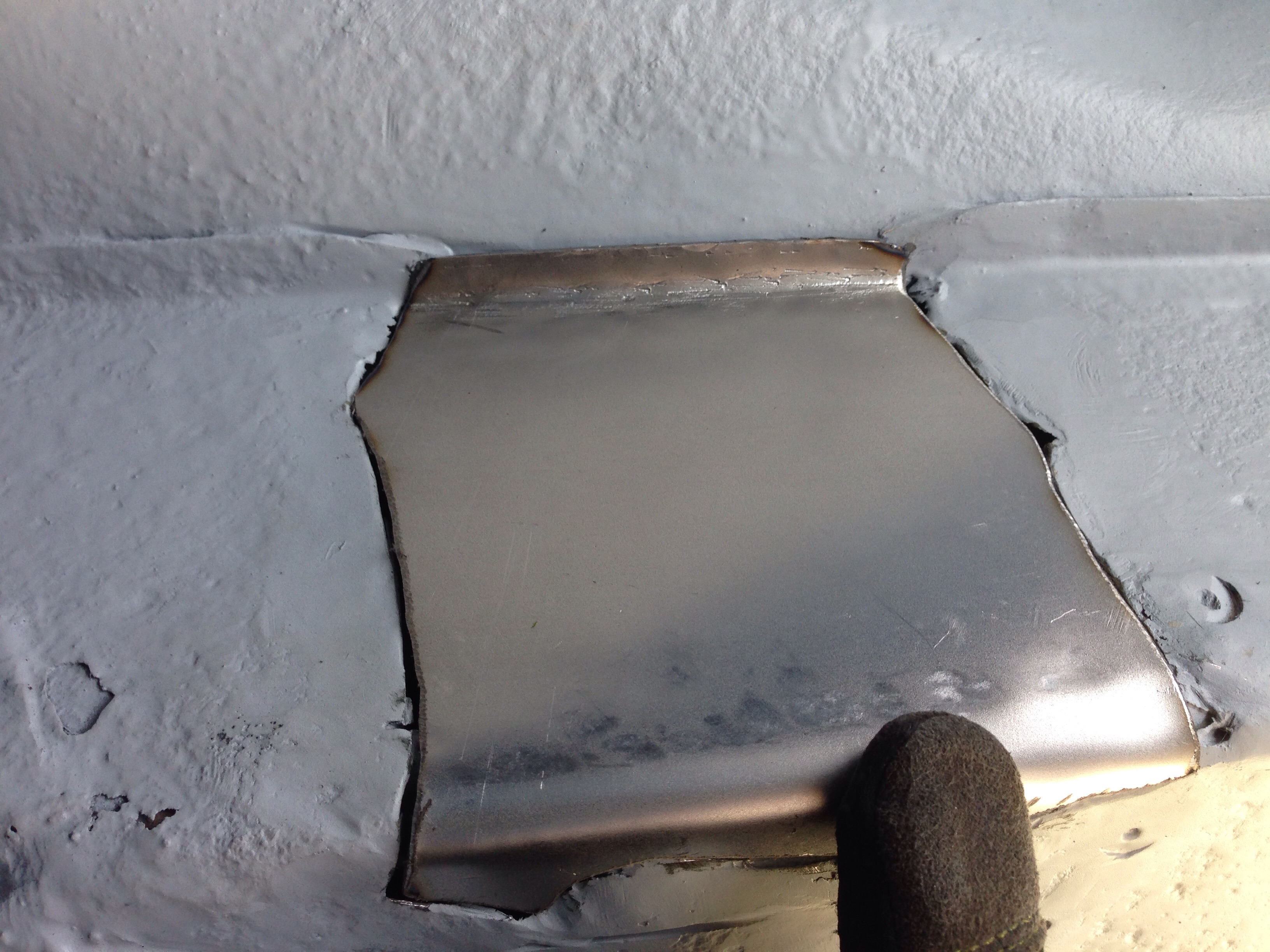

And was able to do some metal cutting to cover a cut out below my 71 battery tray and ready to install new rear suspension console.

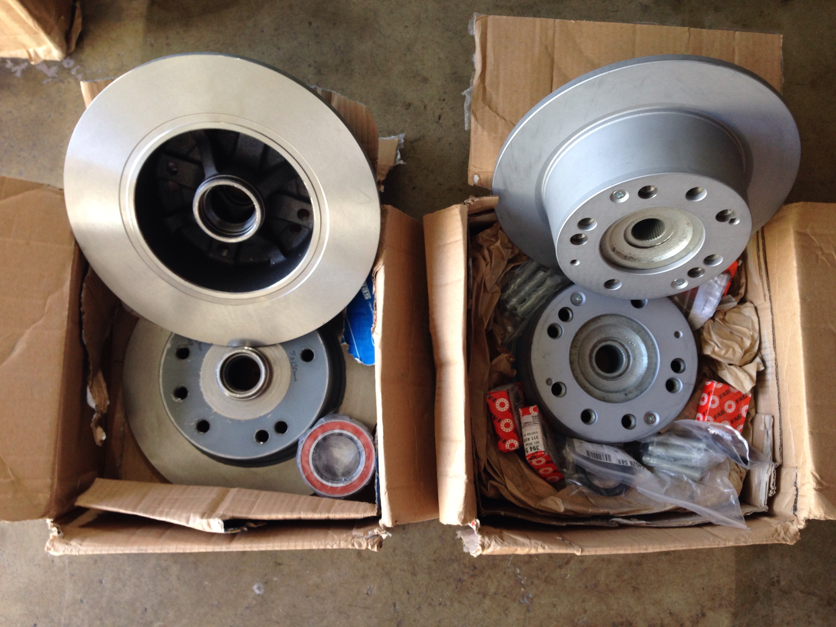

Pulled down my first trailing arm and removed the hub and bearing.
(IMG:http://www.914world.com/bbs2/uploads_offsite/i916.photobucket.com-8123-1423091947.1.jpg)
The clean hub is the Boxster 5 that I will try ?

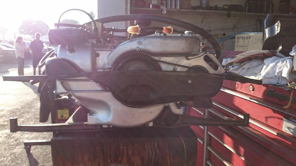

got the engine back together, cant wait to put it in first thing tomorrow morning!

Let us know if the hub works or if you have to modify for fit. Very interested!

For today I, cleaned up a 914-4 brake rotor and bolted (one hole) to the Boxster hub. It almost self centers. I then tightened up the wheel lug. Used a transfer punch to mark the 5 bolt pattern. Will drill them after getting a bit for a stud mount ? I want to do a mock up so I'm using what I have. Anybody try using allen bolts for wheel studs ? In dirt racing it is a cheep way to go . With some luck the stub's will be here in a day or two ?
(IMG:http://www.914world.com/bbs2/uploads_offsite/i916.photobucket.com-8123-1423164673.1.jpg)
(IMG:http://www.914world.com/bbs2/uploads_offsite/i916.photobucket.com-8123-1423164673.2.jpg)
The trailing arm is in the bead-blaster for cleaning. Then some welding. Any body on the board sell the metal kits for the chassis and trailing arm's ?

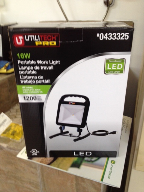

Bought this LED to use as a shop lamp. Tired of the reel cord cfl and regular incandescant filiments breaking. Lowes sells one for 20$ which is 700lumens.
This one lights the entire garage up 30$ (IMG:style_emoticons/default/blink.gif)

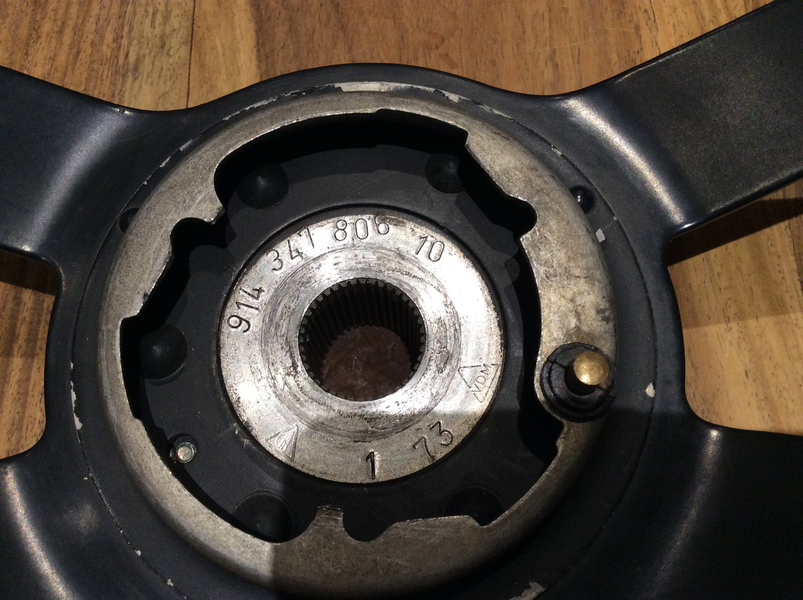

Took, delivery of two leather wheels this week and bought a GT roof marker lamp (IMG:style_emoticons/default/biggrin.gif) one of the wheels the seller described as a 73RS wheel, the guy used to work at Autofarm (renound early 911 and RS specialist in the UK). Part number and date codes would seem to check out?? and it was sensible money even if it turns out not to be an RS wheel
