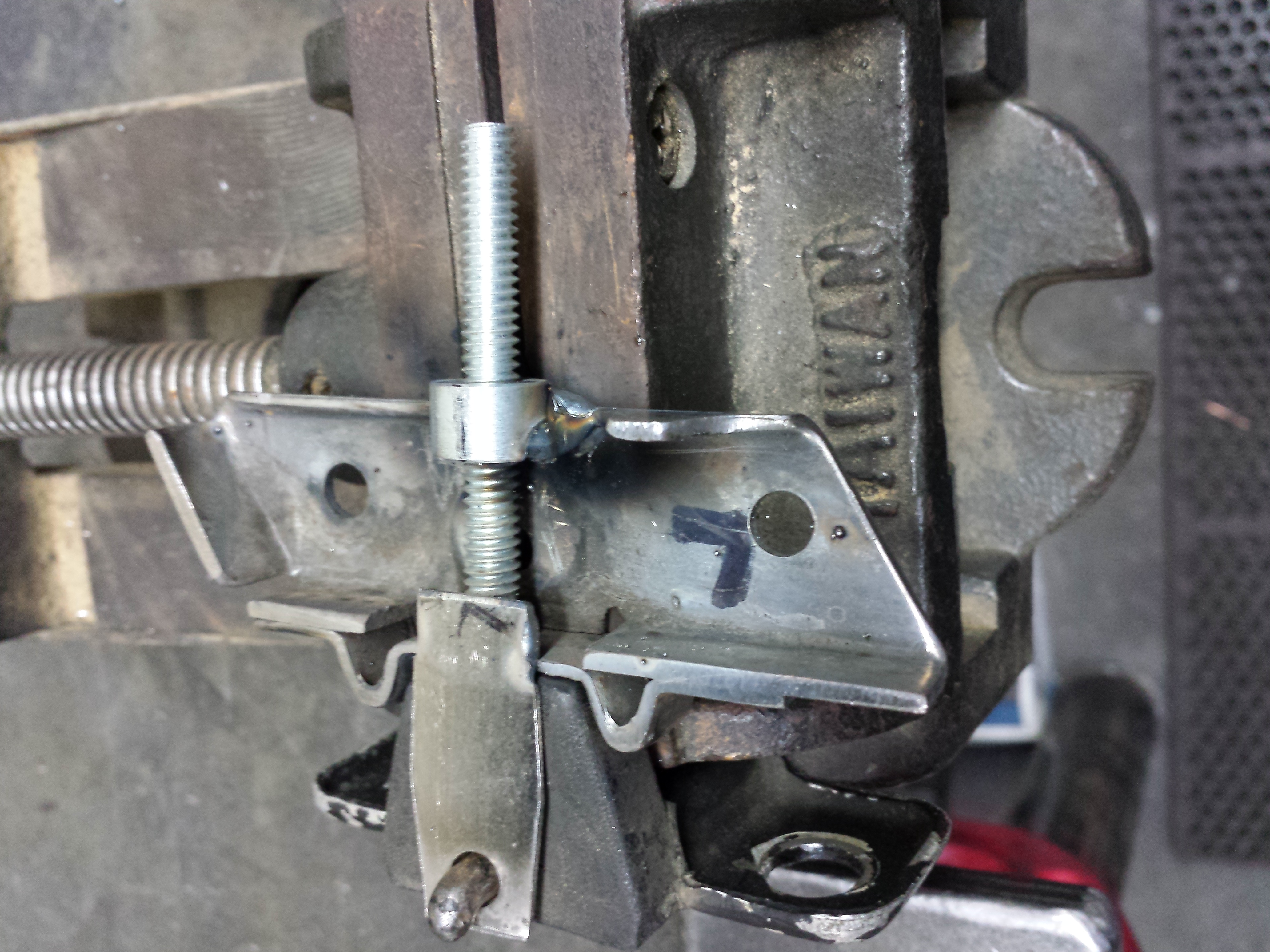

New "MSDS style" rear targa top roof latches, no springs.
To be tested at 185mph....stay tuned (IMG:style_emoticons/default/shades.gif)

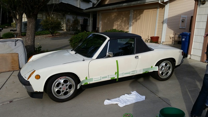

I know I am not supposed to "work" on the car yet...but I couldn't help myself...

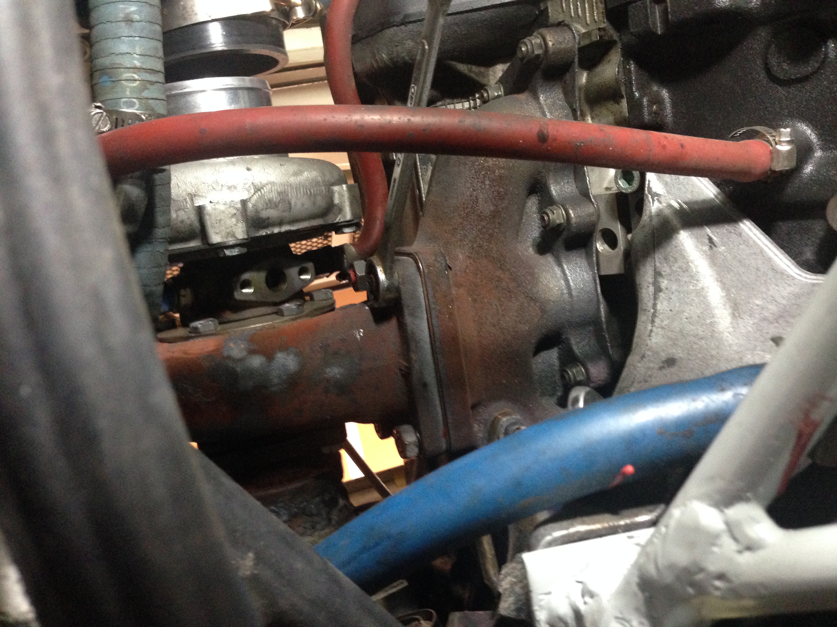

I changed the second hardest gasket on the car. Turbo to Manifold gasket. The old one was aluminum the new one is copper. Use copper gaskets turbo guys. Just make sure you anneal it first so it will soften slightly.n I could hear a slight leak and boost was down 1-2 psi. This one is .042 thick. Make sure you get a copper gasket about this thickness is possible. Some are paper thin. Over time the aluminum unit melted slightly, enough to get real soft and blew out. It made for a great gasket while it lasted. Also stay away from the laminated type. These tend to blow out under boost. It'a PITA due to all the stuff that has to come off to get to the 4 nuts I needed to access.
The hardest gasket (on this car) it the exhaust manifold to head due to access. I installed the manifold with the motor out of the car with "special" wrenches I had to make. I then peened the nuts to the studs. The motor will have to come out to change this one. Lucky for me it's OK. In the pic you can see a few easy nuts to get to.
I got the car rewired and installed new starter. Didn't really need the rewire but I wanted to simplify the system a little.

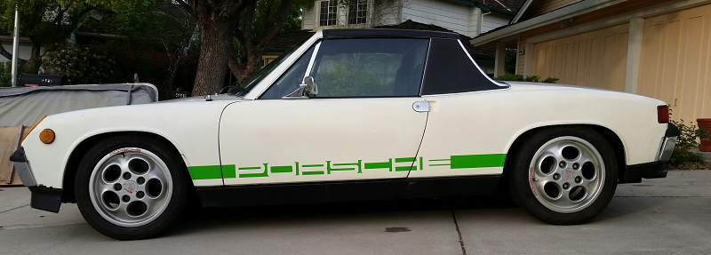

Mueller
post Mar 22 2015, 04:40 PM
Post #5647
914 Freak!
Posts: 17,155
Joined: 4-January 03
From: Antioch, CA
Member No.: 87
QUOTE(Cuda911 @ Mar 22 2015, 09:41 AM) *
The side stripes look great, Mueller!
Thanks....I cheated and only did one side yesterday due to the wind really kicking up.
I don't like the placement of the "H" and will move everything back at least an inch on the other side and might redo the passenger side (kit came with 3 stripes!)

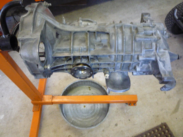

Cleaned the transmission. Found all kinds of problems.

QUOTE(914Sixer @ Mar 22 2015, 03:15 PM) *
Care to elaborate on the problems you found?
914Sixer
post Mar 22 2015, 06:08 PM
Post #5651
Posts: 9,326
Joined: 17-January 05
From: San Angelo Texas
Member No.: 3,457
See post about flange damage.
