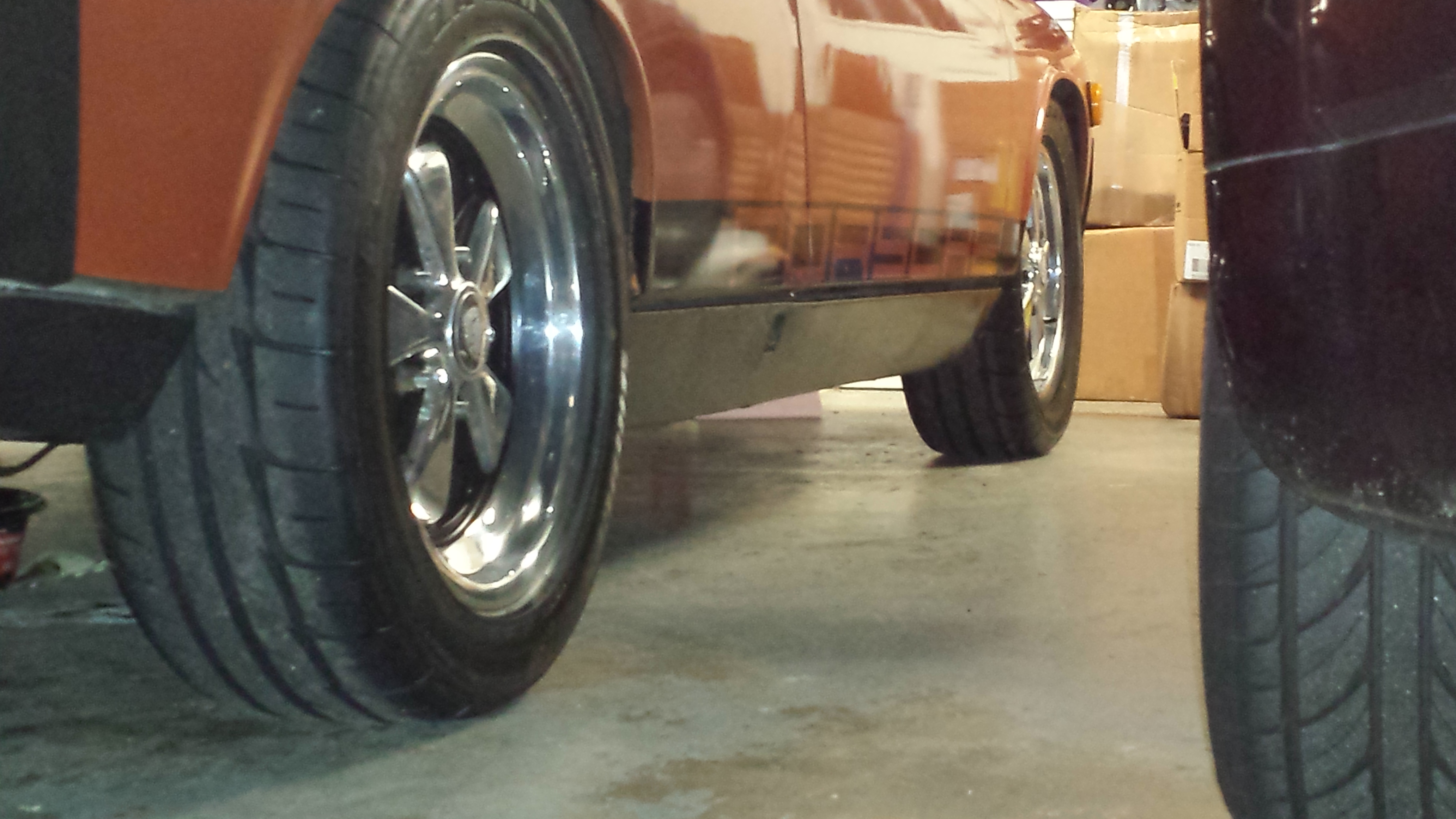

1. Oil change - back to 10/40 to see if it runs cooler
2. Pulled wheels, shocks, reset spring height on the rears to get better clearance for the new 7" fuchs, also resulting in a better balance from back to front. Tried the longer 90# springs but ended up staying with the 100# weltmeisters.
3. Drove to FroYo with my youngest and met the wife and other daughter for a treat! Best night in 2 months. Only 40% humidity ttoday and 85!, has been 95+ for over a month.
4. Lost the dash lights, and headlights won't go down, not sure why yet.

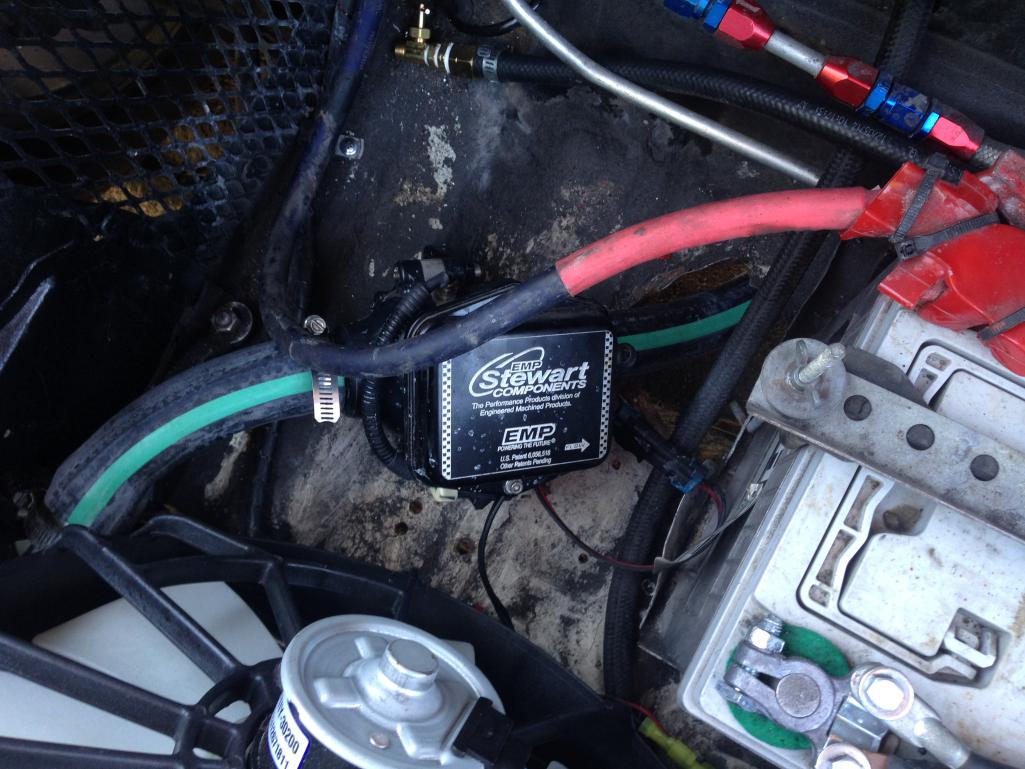

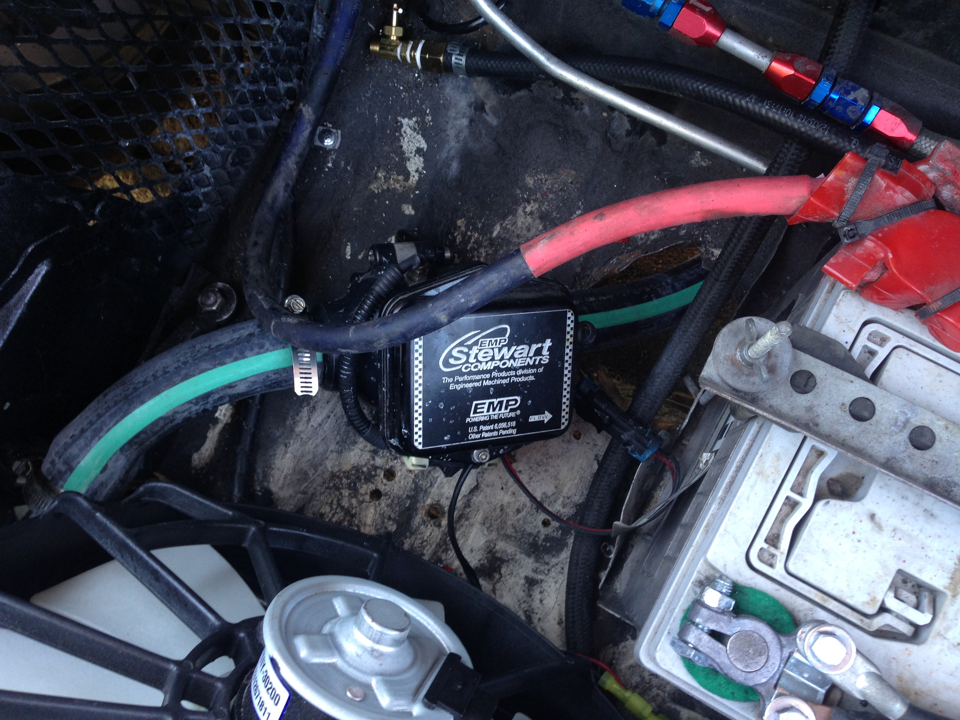

I replaced my cooling lines with new green stripe hose. I also moved my water pump so it will pull from the radiator and push to the engine. This seemed to reduce cavitation during testing. Should be driving again tomorrow.

QUOTE(Mike Bellis @ Jul 25 2015, 11:58 PM) *
Mike, that makes sense to me also. It's gotta beat the hell out of the little Subie water pump flailing away trying to pull that water column over what, like 6 ft or so of tubing? Anything to keep the coolant stream moving and put less strain on other pieces never designed to do the work has to help. What type of testing were you doing for these results? And when do we see MORE PICTURES??!! Sorry... I'm bored of hospitals and rehab with almost a month left to go... (IMG:style_emoticons/default/sad.gif) haven't even SEEN my car since June 5th. (IMG:style_emoticons/default/mad.gif)

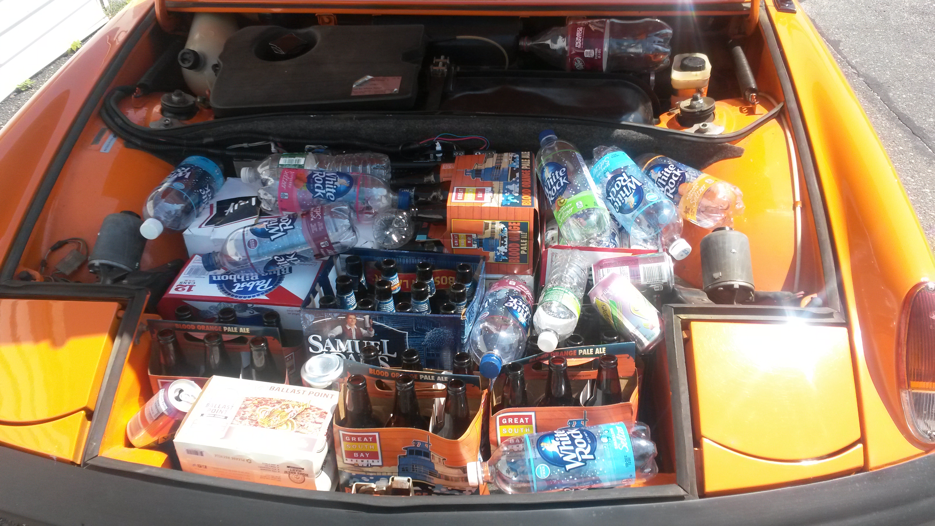

Returned this week's bottles and cans

QUOTE(Porschef @ Jul 26 2015, 07:34 AM) *
Glad you didn't post "drove it to the recycling yard today" (IMG:style_emoticons/default/poke.gif)

QUOTE(mgp4591 @ Jul 25 2015, 11:56 PM) *
My testing has been mostly by ear. The pump motor is almost silent so when running I can hear air cavitation in the line. With the pump on the outlet of the radiator, I hear no cavitation. The engine is running slightly cooler on the same radiator as well. I took it on a 20 mile journey today and the temps never got above 190°. An added advantage is this setup for whatever reason is easier to burp, pushing air to the high spot in-line filler.

QUOTE(matthepcat @ Jul 26 2015, 01:39 PM) *
Mike,
I wonder if this electric pump would continue to cool the Audi motor if the factory water pump impellers failed.
I'm not running the factory pump. Well it's there but no belt to spin it. The electric pump works great!
