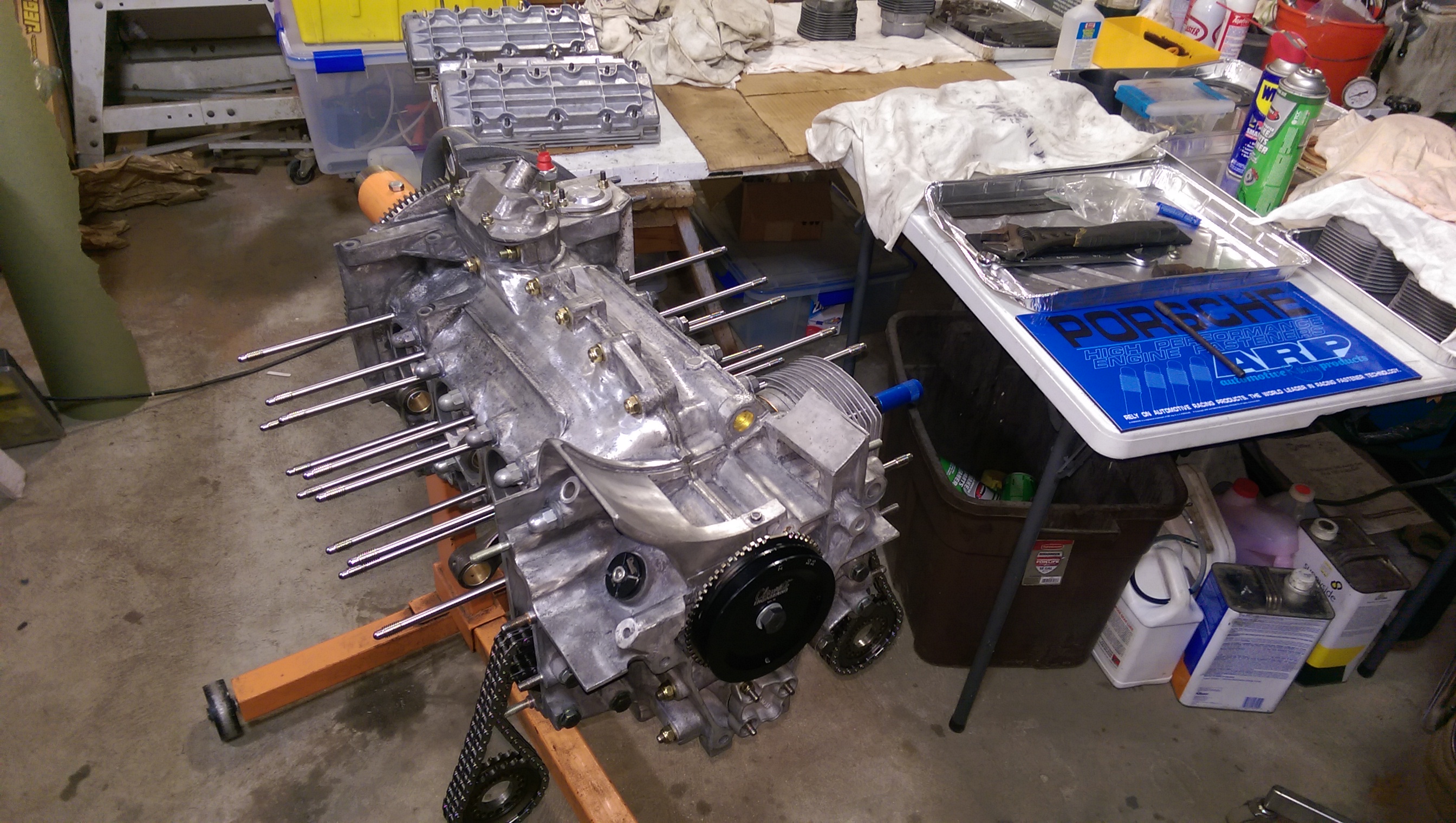

... I also had to remove a second cylinder# 1 upper stud that was too short (missing some threads at the tip) (IMG:style_emoticons/default/huh.gif)
Also removed the barrels to check the pistons, rings and rod play.
Now, off to search for a couple of good used studs, two good two barrel nuts and a few new exhaust port studs*... (and my ring compressing tool). Then I can install the new lower deflector plate*, new push rod tube seals, new head washers* and new o-rings* as needed ... (* all of these items weren't installed when the PO put this motor together) (IMG:style_emoticons/default/screwy.gif)
does that engine stand just have2 arms...?

Yes. It's a cheap old T-1 VW stand I've had since the 70's. A 912 motor is similar in weight with a T-1, so it does the trick. I wouldn't use one of these for a T-4 (IMG:style_emoticons/default/sad.gif)

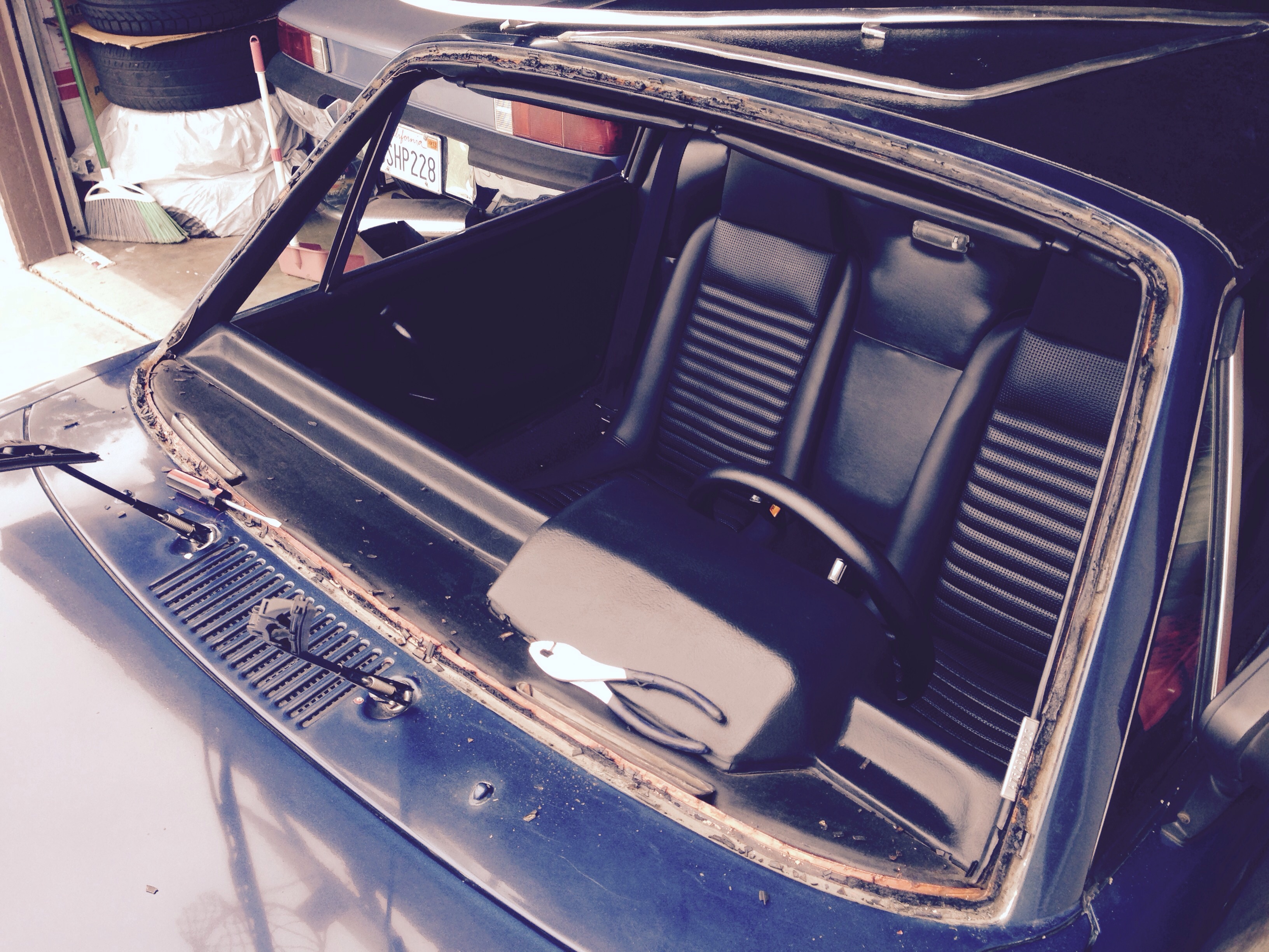

After my windshield was hit last monday and made a crack in the middle, yesterday started removing the chrome trim and today I was able to remove the windshield and cleaned the left butyl seal. Now it shows the original copper metallic around the windshield frame. But I'm glad no rust and now ready for new windshield installation.
Also I have to order new chrom trim clip, lower windshield to dash rubber seal and double side adhesive tape for the rearview mirror.

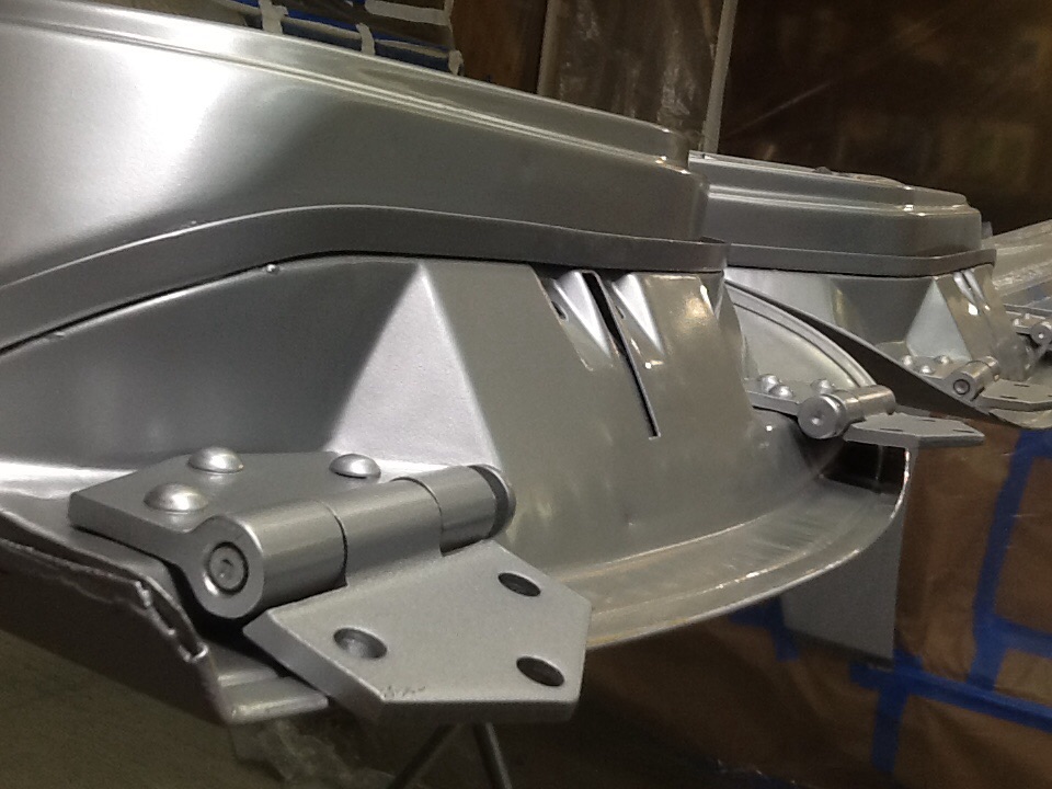

Painted the jam, side of the doors.
Lacquer metallic single stage. no clear coat, taken 1hr after spraying.

QUOTE(Garland @ Sep 5 2015, 06:46 PM) *
Love the silver... Nice job.

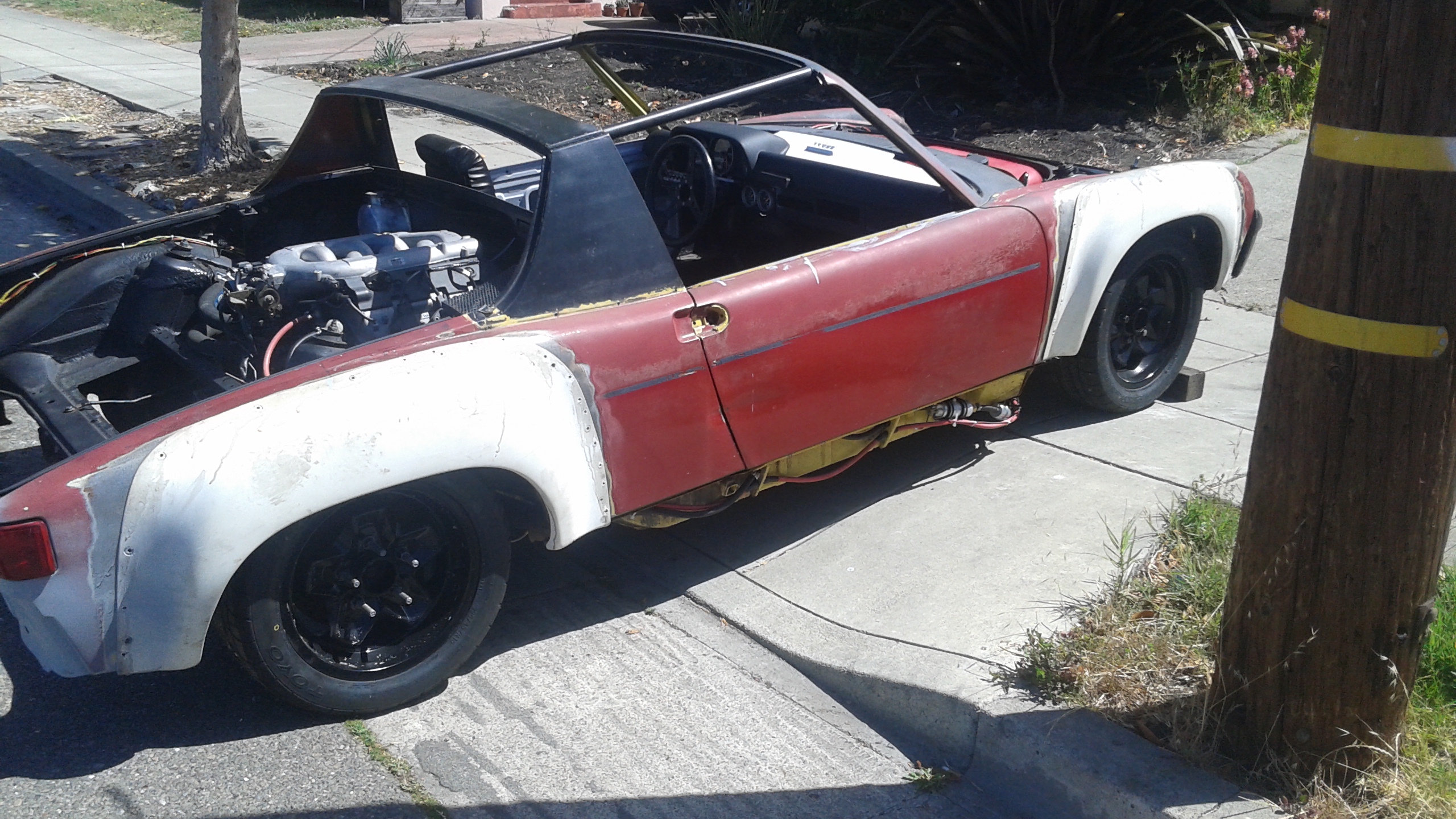

Discovered Spidertown in the '74 when I took out the front wheel well liners. Did that to remove the front bumper, to swap in Pilot driving lights for the factory fogs. Swapped the stub/vertical bracket from the originals, but I'm guessing they'll still be too low - I found several threads, one of which included Demick's bracket doc (index.php?showtopic=140554).
Also ordered some Hella H4 55/60W headlights, which Amazon says will be delivered Monday - Labor Day - which will be... interesting. (EDIT: Sunday's delivery of motor oil did arrive around 11:20AM, FWIW.)
The lighting upgrades have me thinking about relays for both of those, and for the starter. Preferably something with a push-to-start option, which several have mentioned (pic of Tom's version: index.php?s=&showtopic=224542). I sometimes have failure to start - not always hot weather, so maybe an ignition switch issue... Either way, a secondary keyswitch-pushbutton would be nice.

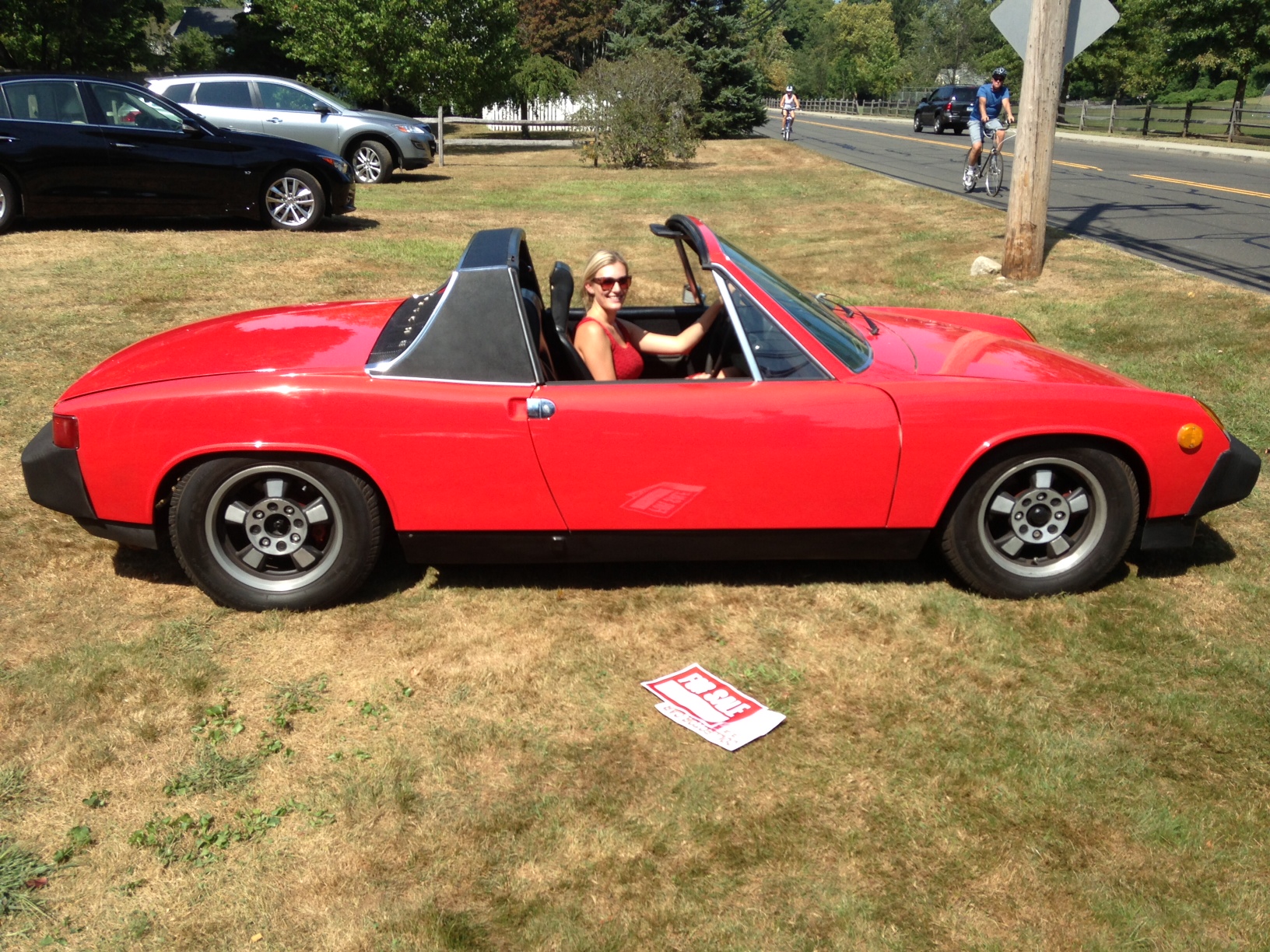

I had a For Sale sign on the car in front of my friend's house where she was having a tag sale....
I let this young lady drive it. She came back eventually with this smile on her face.....
euro911
post Sep 7 2015, 08:03 PM
Post #6598
Posts: 8,945
Joined: 2-December 06
From: So.Cal. & No.AZ (USA)
Member No.: 7,300
It's definitely 'her' (IMG:style_emoticons/default/smile.gif)

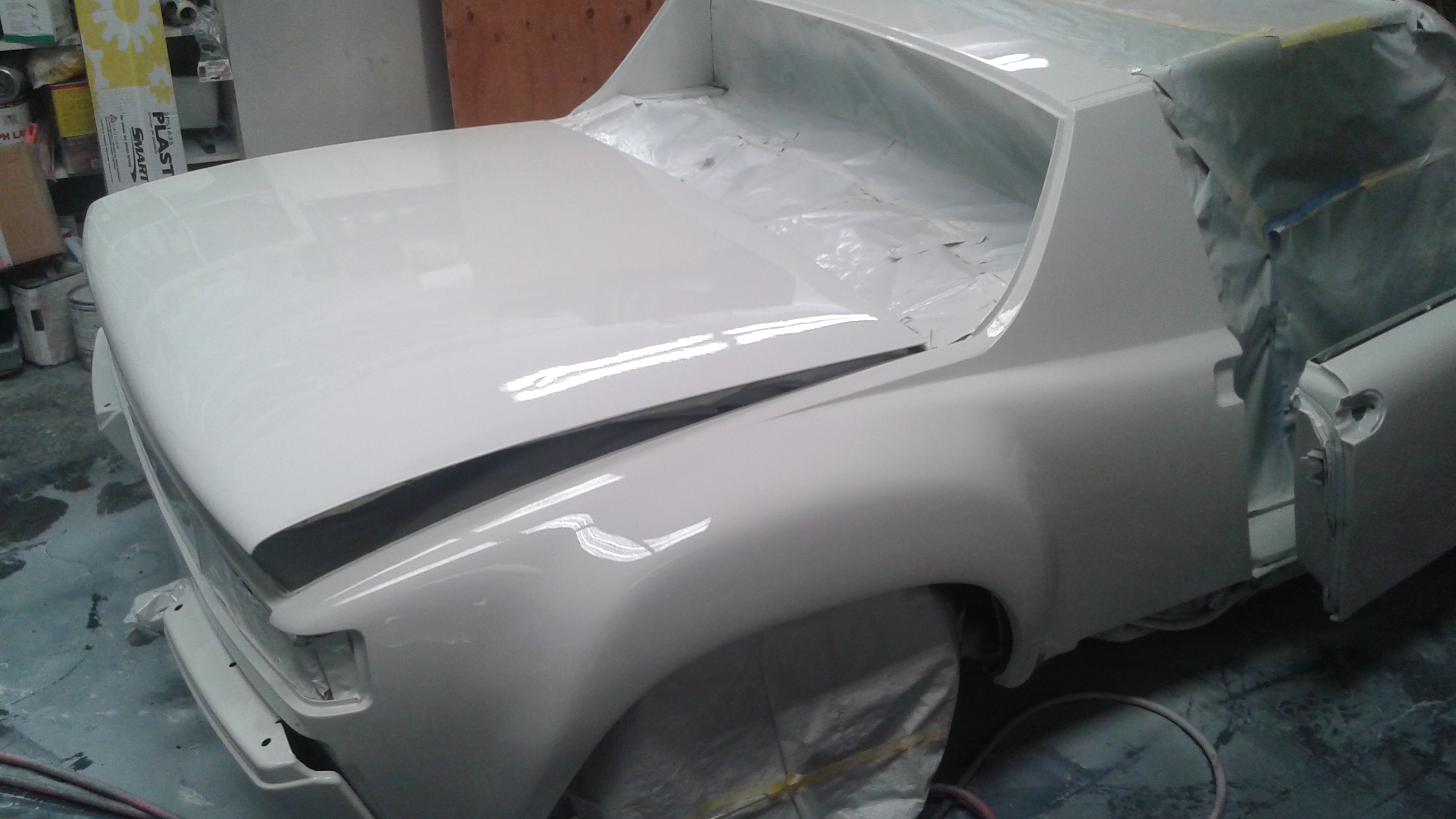

Cool. Did they remove the rear bumper to paint it?
QUOTE(cali914 @ Sep 5 2015, 10:21 PM) *
carrara white Porsche color (IMG:style_emoticons/default/cheer.gif)
