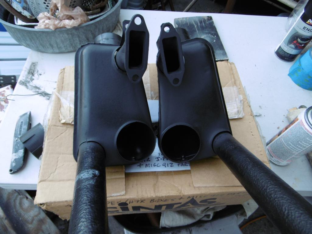

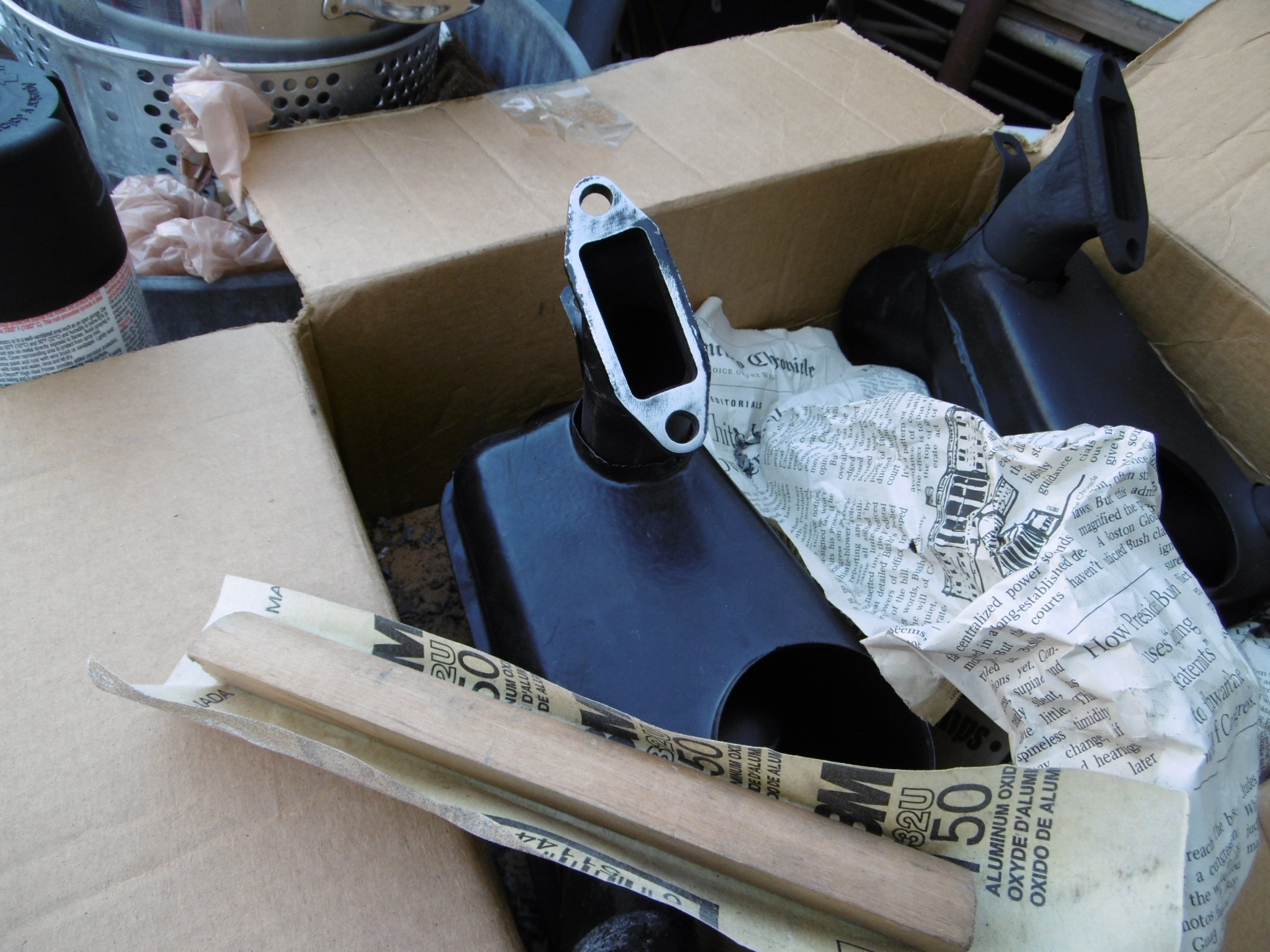

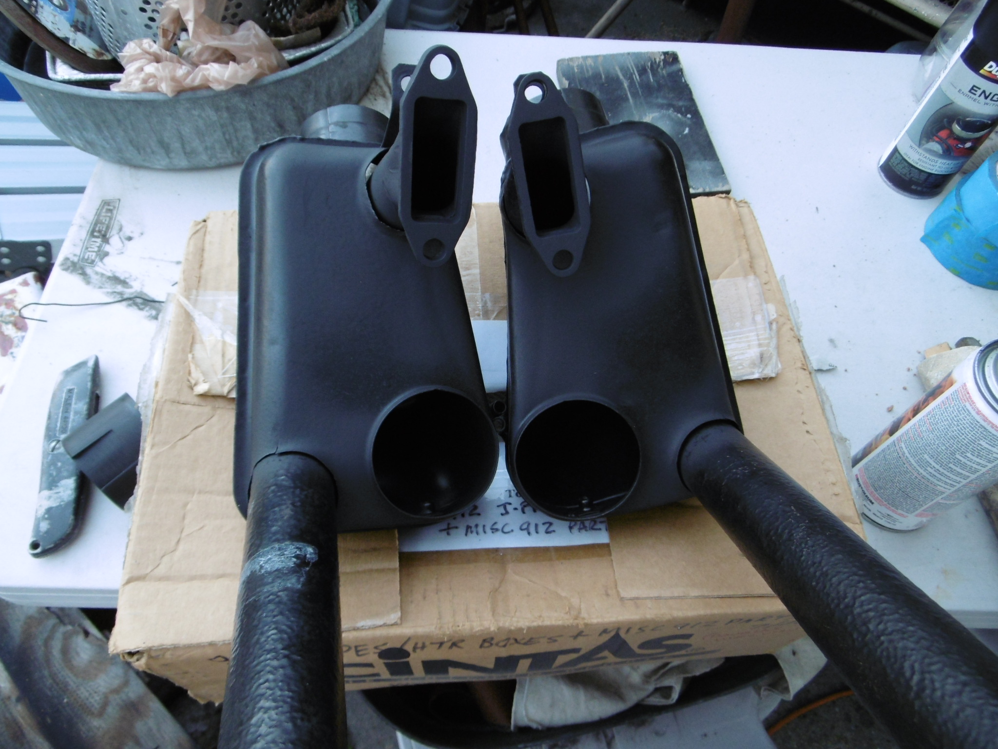

Feeling better, but still taking it easy. I ordered a bunch of parts from AZ Autohaus for the 66 912, and found a box with some j-pipe/HEs that I can utilize on the 912 motor I've been working on (IMG:style_emoticons/default/smile.gif) Just had to scrape off the old gaskets, sand the flanges flat and give 'em a shot of 2000° paint. They're almost ready to install on the motor ... I need to have a couple 3" sleeves welded onto the ends of the tail pipes first, but that's going to be easy enough.

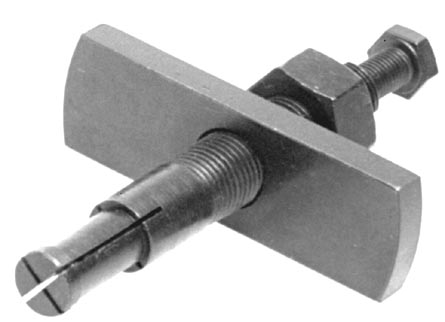

Also ordered a starter motor bushing puller tool (VW228B) so I can fix the [non] starting issue on the Vanagon - without having to drop the drive train and separate the motor from the transaxle. Nice to know that that this puller works for starter bushings on ALL air-cooled VWs and Porsche (IMG:style_emoticons/default/aktion035.gif)

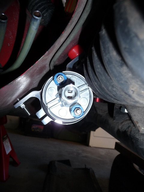

QUOTE(9fourteen14 @ Sep 27 2015, 12:24 PM) *
where did you put the fuel pump? plz take a pic and send to me
I think i want to do that.. I just overhauled the entire fuel system
did not move anything just wanted to review everything to make sure everything was in good working order
914 luva

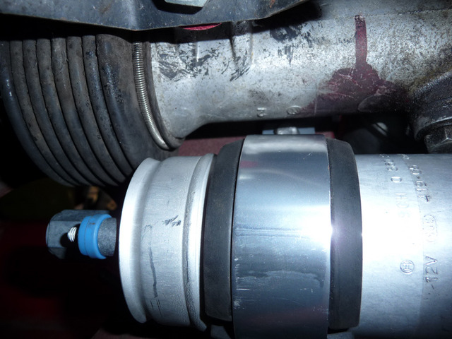

It's not final yet and i haven't connected the hoses.
The bracket i got is a bit bulky which makes it hard to find a spot with enough clearance all around...
hope that helps..

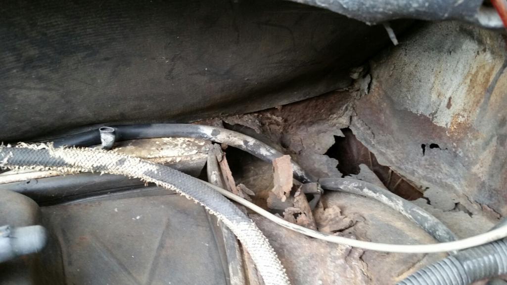

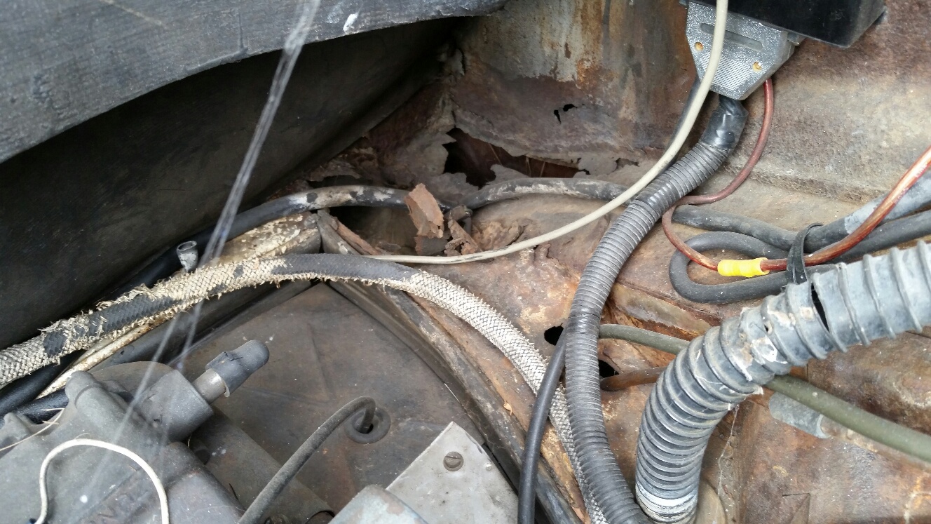

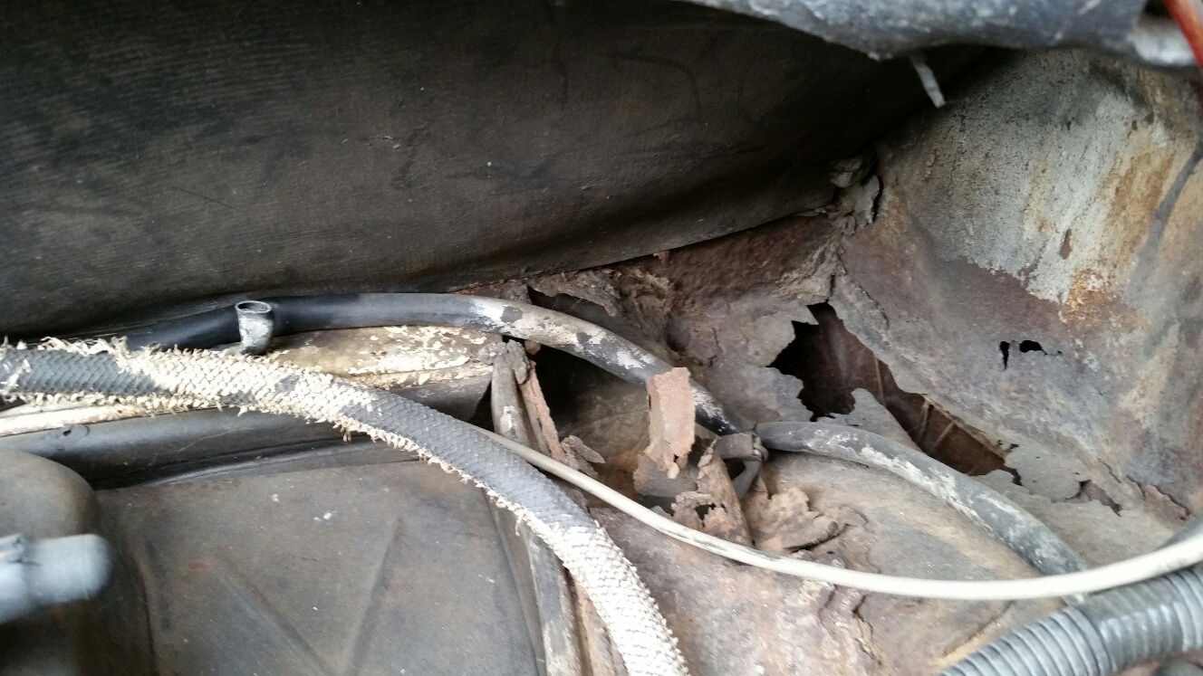

Put a new car cover on mine, the sun has beaten to death the cover that was on it.
I also took a bunch of pictures for the 914 Build Challenge....I wish I hadn't (IMG:style_emoticons/default/sad.gif)
I knew the car needed some sheet metal work in the engine compartment, but it is worse than I thought it was, to be honest I never really looked at it until now...it is fixable, but it is going to require more time and parts than I previously thought.
Oh well, it'll get done.

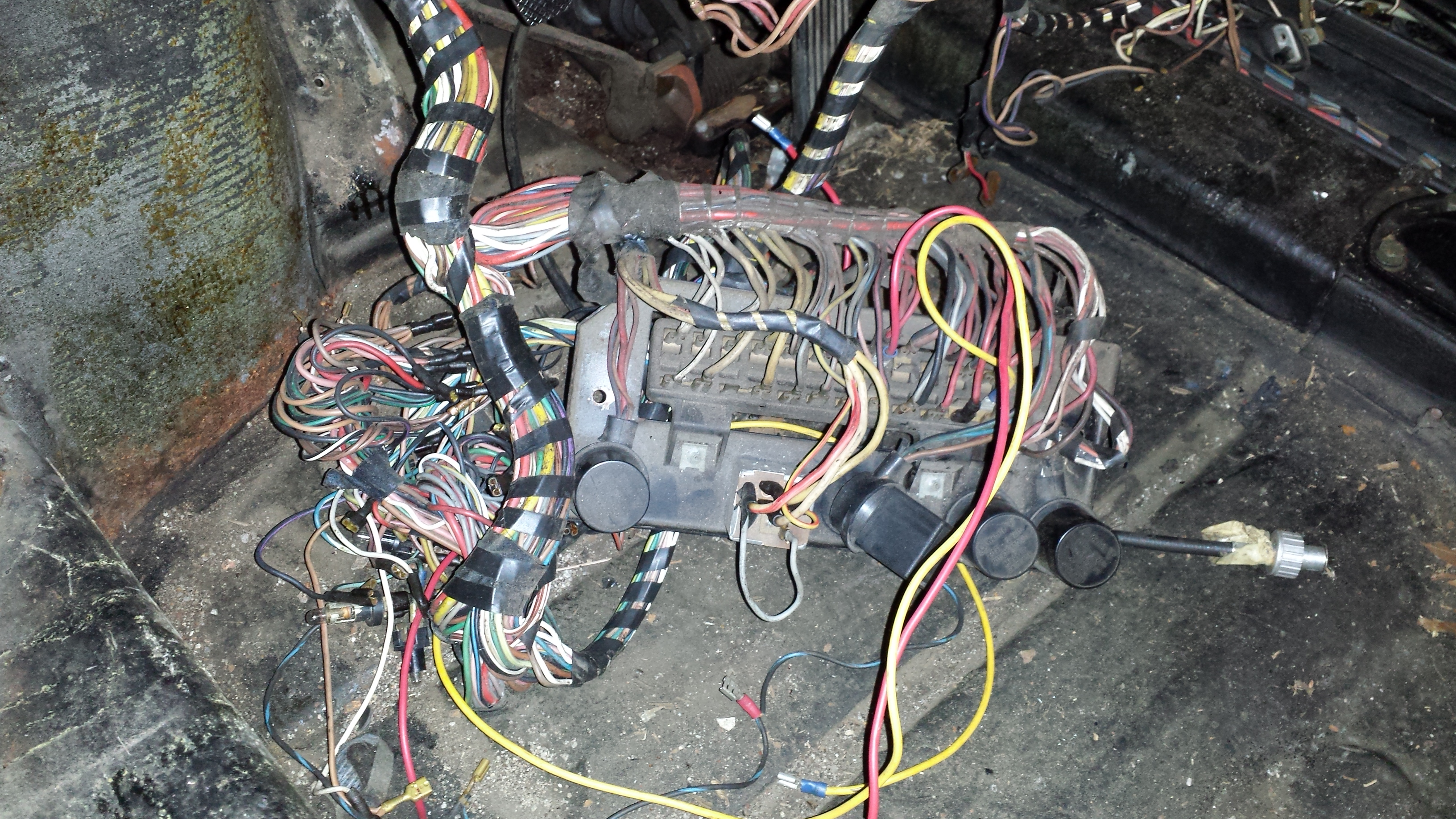

Took the coppertop on a short drive, blew a fuse,again, have not figured out why #7 blows when the dash lights are on.
Came home and tried to sort thru a wiring mess on the new black 75 project my daughter nicknamed "midnight"
I've got a ways to go!
Trying to get the harness pulled back thru and line it up and figure out which one goes to the fuel pump so that I can try and see if the car will crank, start. What color is the fuel pump wire?

Gawd (IMG:style_emoticons/default/sad.gif) ... I'm gonna have to do that one of these days - still have the Emgman fuse box I want to install in the 'BB' (IMG:style_emoticons/default/aktion035.gif)
I wonder if you can pull all the fuses (except for a new fuse in #7 slot) to determine what all is on that circuit (IMG:style_emoticons/default/confused24.gif)

QUOTE(euro911 @ Sep 27 2015, 11:44 PM) *
I left it for a couple weeks , just seemed overwelming, but lined it up and then used the other car , also a 75, to figure out what goes where. That helped. They cut the wires that go to the passenger side side market and flasher so I'll need to put new connectors on those. I know which ones are for fresh air fan, and headlight motors. I'll get them all figured out , labeled and see if she will start once the necessary circuits are hooked up. But I have to clean the tank, put in new lines etc, that I've done before. Trying to decide what to do and not do.- not sure I have it in me to do a restoration, might just sort this out, get it running and put it back together enough to sell to someone that can do the rest .
