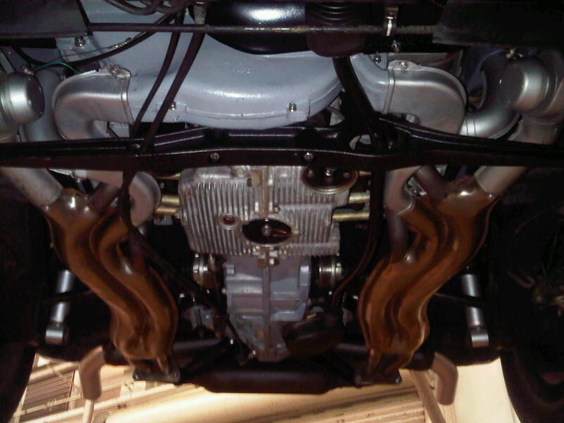

pressure washed the engine and trans Just curious. Are you happy with your heat? What size 6 is that? Nice ride. Looks perty! semi stock 2.0 BB headers what heat they suck....crap design...trying to come up with a better design that i will custom make (IMG:style_emoticons/default/smile.gif) |

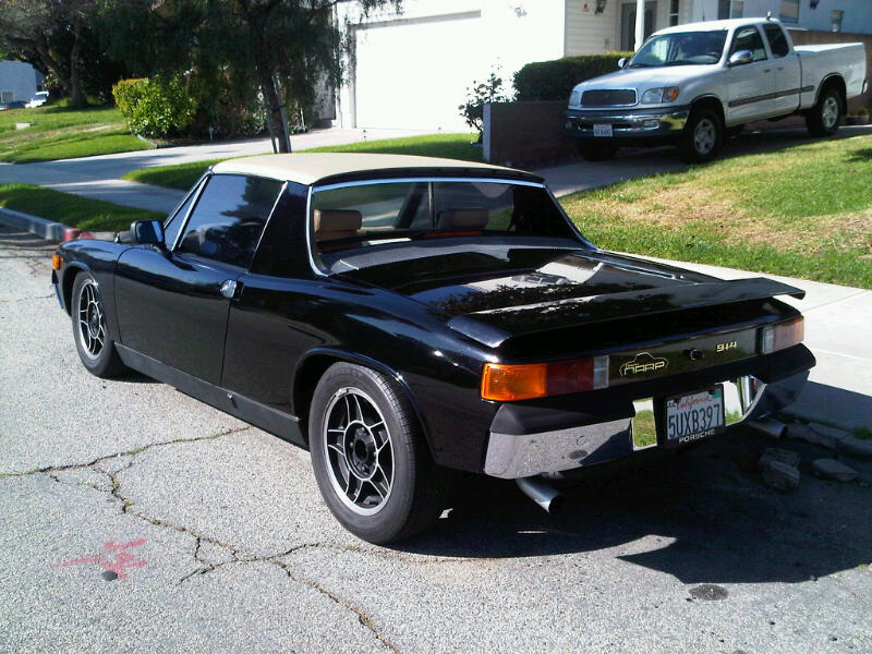

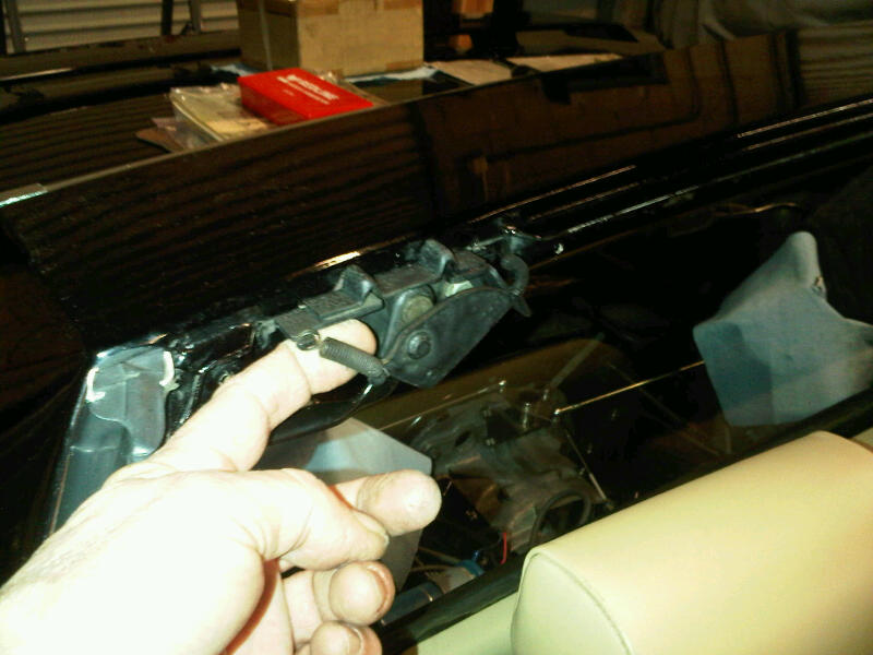

Yesterday, I installed the new .60 idle jets and some freshly-painted side grilles.
![]() Also refreshed the rear targa clamps ... and managed to fling one of the springs into the next world (IMG:style_emoticons/default/dry.gif) This morning, Richard preformed the timing and tuning procedures ... then I took it out for a quick test drive (IMG:style_emoticons/default/driving.gif) Runs smooth, great acceleration (IMG:style_emoticons/default/cheer.gif) It's back up on jack stands now ... need to stop an oil leak from the base of the oil pressure sender and readjust the clutch, and figure out why the fuel and oil temp gauges aren't working (IMG:style_emoticons/default/confused24.gif) I'll check the condition of the front wheel bearings and brake pads while it's up in the air again (IMG:style_emoticons/default/shades.gif) |

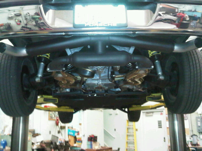

Painted my rear valance ... will install on Wednesday. Installed a carbon/kevlar patch to fill the gaping A/C condenser hole in the front trunk, wrapped teflon tape on the oil pressure sender to fix the oil leak, replaced a couple of burned out side marker lamps, installed the engine lid and targa top, then drove to my shop class.
Drained the break-in oil, put Brad Penn 20/50 and a new filter in and lowered the front end about 1.5" ... handles (and looks) much better ... eliminated a crawling yaw feeling while in a turn. ![]() I can't figure out why the H/Es look rusty in all my pix (IMG:style_emoticons/default/confused24.gif) ... they're clean as a whistle (IMG:style_emoticons/default/blink.gif) Also, replaced some burned out lamps in the dash & console gauges with Mikey914's LED lamps ... what a difference (IMG:style_emoticons/default/biggrin.gif) |

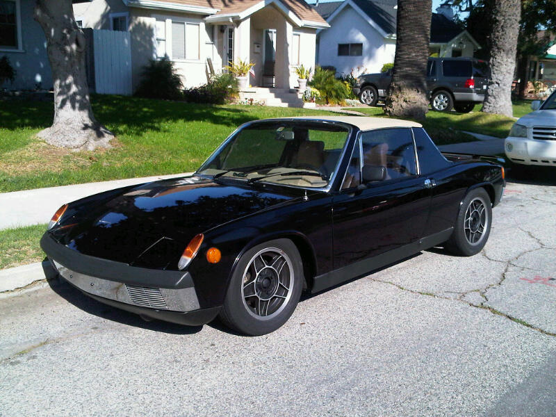

More carb work today. Changed main jets again. It's tough getting this thing dialed-in (IMG:style_emoticons/default/dry.gif)
Front valance was scraping too many speed bumps, raised the front suspension back up a little (pic is prior to raising it back up) ![]() Didn't have time to install the rear valance (IMG:style_emoticons/default/dry.gif) Packed up for the RT-66 (IMG:style_emoticons/default/driving.gif) ... Leaving EARLY Thursday morning, will meet up with Mr. Sharp for breakfast in Banning (IMG:style_emoticons/default/chowtime.gif) |

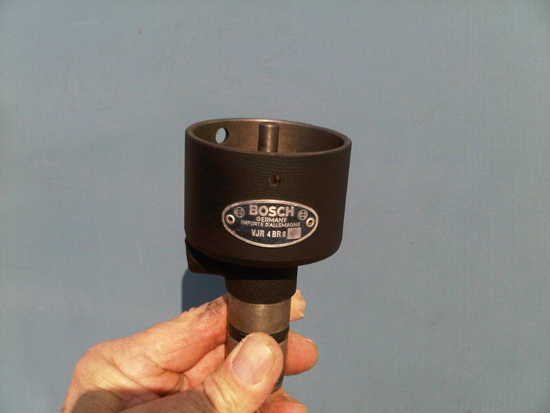

Bosch VJR 4BR8 with Pertronix module
![]() Just for grins, what jetting are you running? Headed to the shop now (in Harbor City) |
