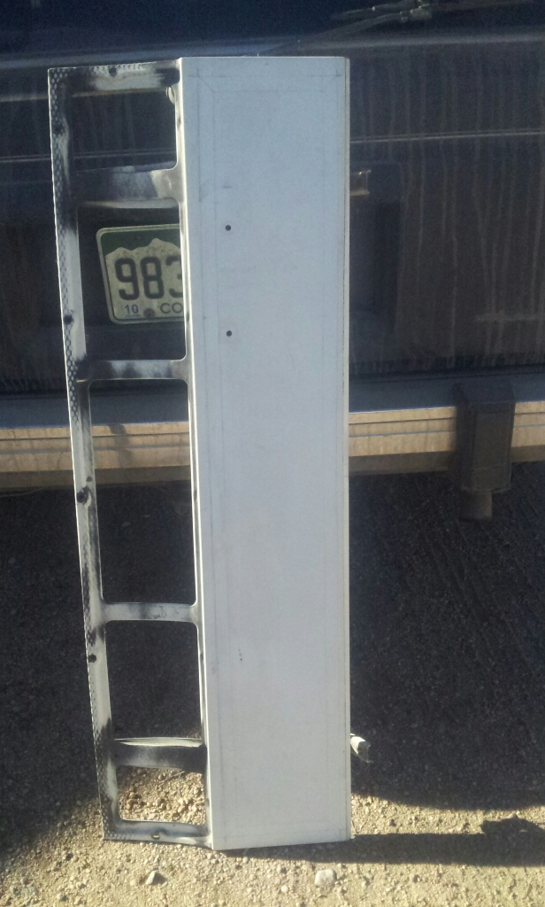

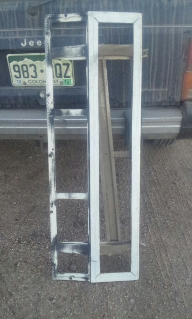

Pulled the motor, started stripping the rear. Goal is new paint on the back half for WCR!

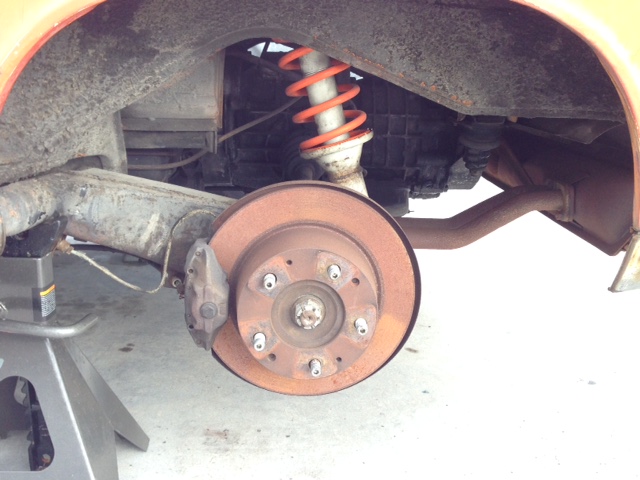

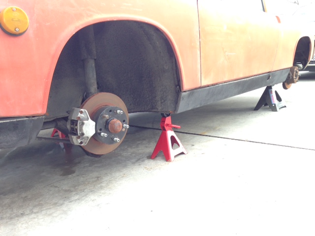

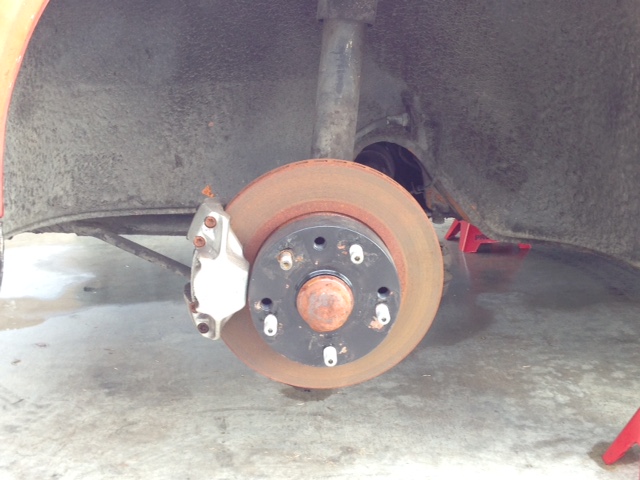

Removed the wheels of the 73 recently purchased to bring them to a tire shop and install my old tires for roller.
Not really sure how the 5 lug conversion was made.

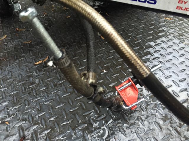

Got the fuel tank out. The old cloth-wrapped rubber hoses from the return line back into the tank were soaked with gas; when I squeezed the hose to clamp it off, gas ran down my hands and arm.
Then what was supposed to be a pretty straightforward and quick removal of the old plastic tunnel lines became a challenge; PO had left the plastic return line in there, but replaced the line going to the engine with some kind of braided-metal-covered rubber hose which was also running through a hard plastic sleeve into an A-N type connector on each end bolted through the firewalls. The rigid plastic "sheath" made it the devil of a job to get free but finally worked it out:
Rubber inside the hose was rotted and weeping gas.
Feeling lucky that I've sorted this all out before disaster struck.
Also as a bonus PO left the original plastic engine fuel line inside the tunnel, clipped at both ends, just floating around in there.
