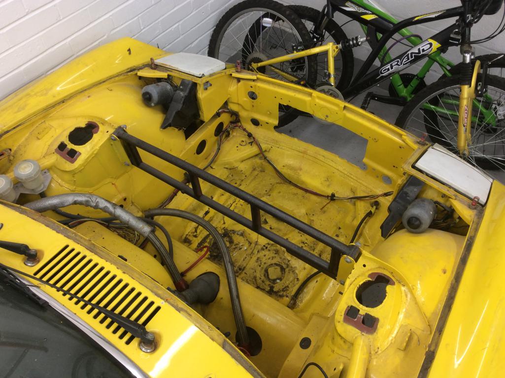

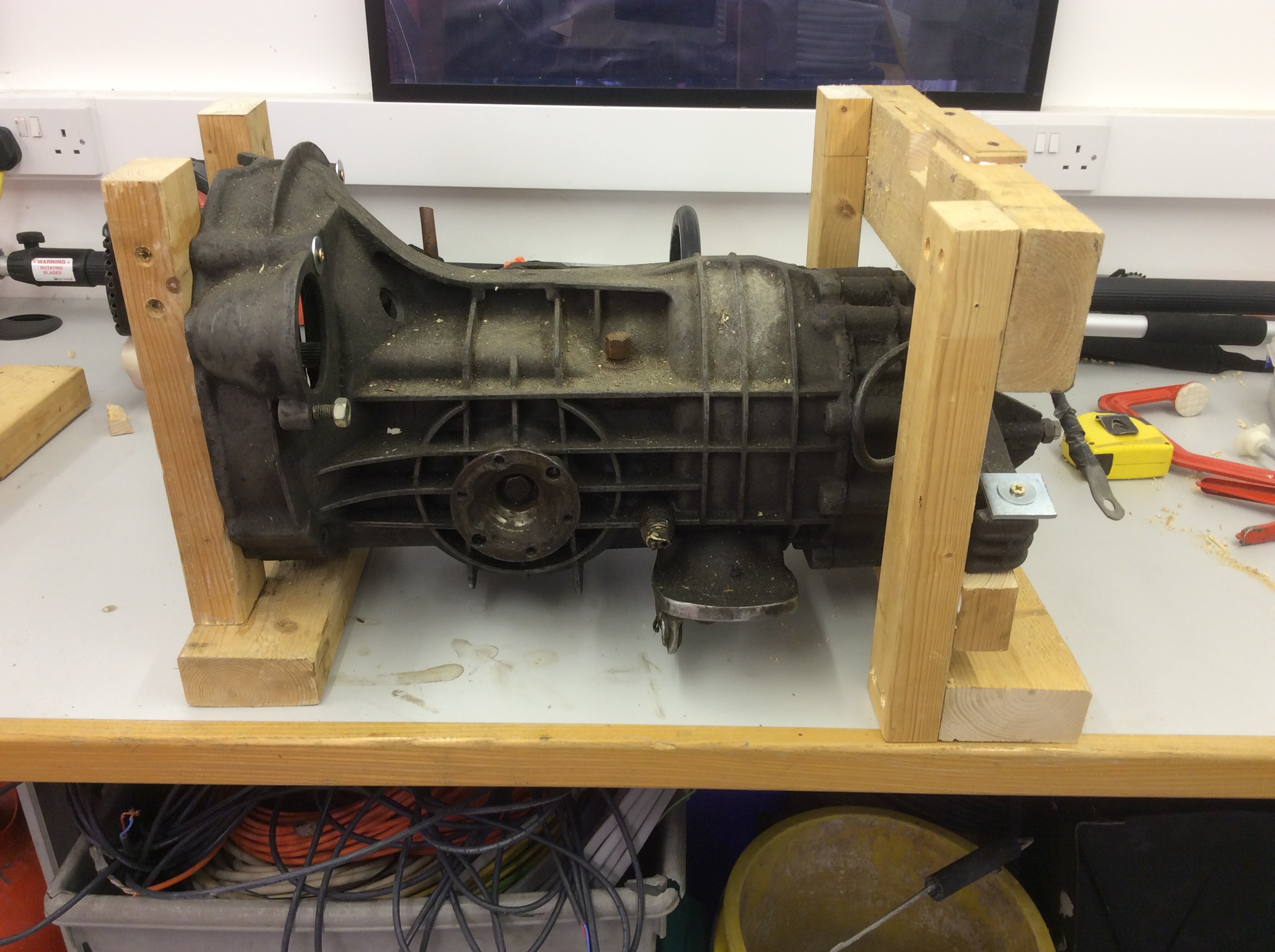

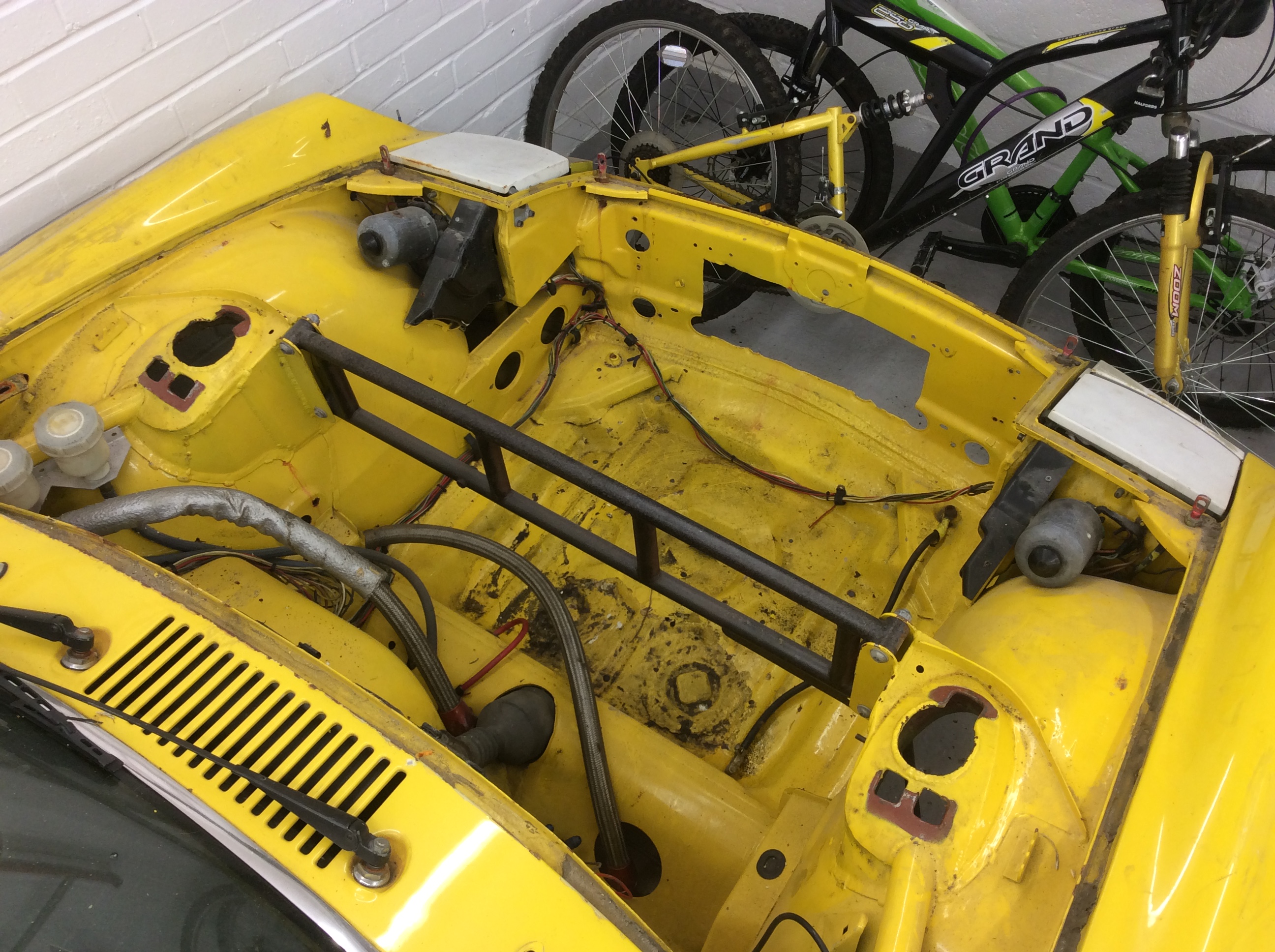

Made a quick and dirty storage crate for the spare gearbox from the donor car, making sure no weight is on the speedo drive and ready to stack the -6 box on top with some minor additions
Started stripping the -6 (IMG:style_emoticons/default/beer.gif) Flipped and mashed hood removed, rear bumper off, front bumper and lower valance removed plus a load of minor stuff bolted in the front boot area. Front cooler opening is as I feared, too narrow (not an issue) but way too tall for the GT cooler

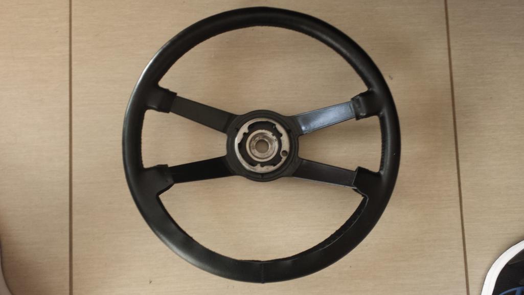

Work in progress.

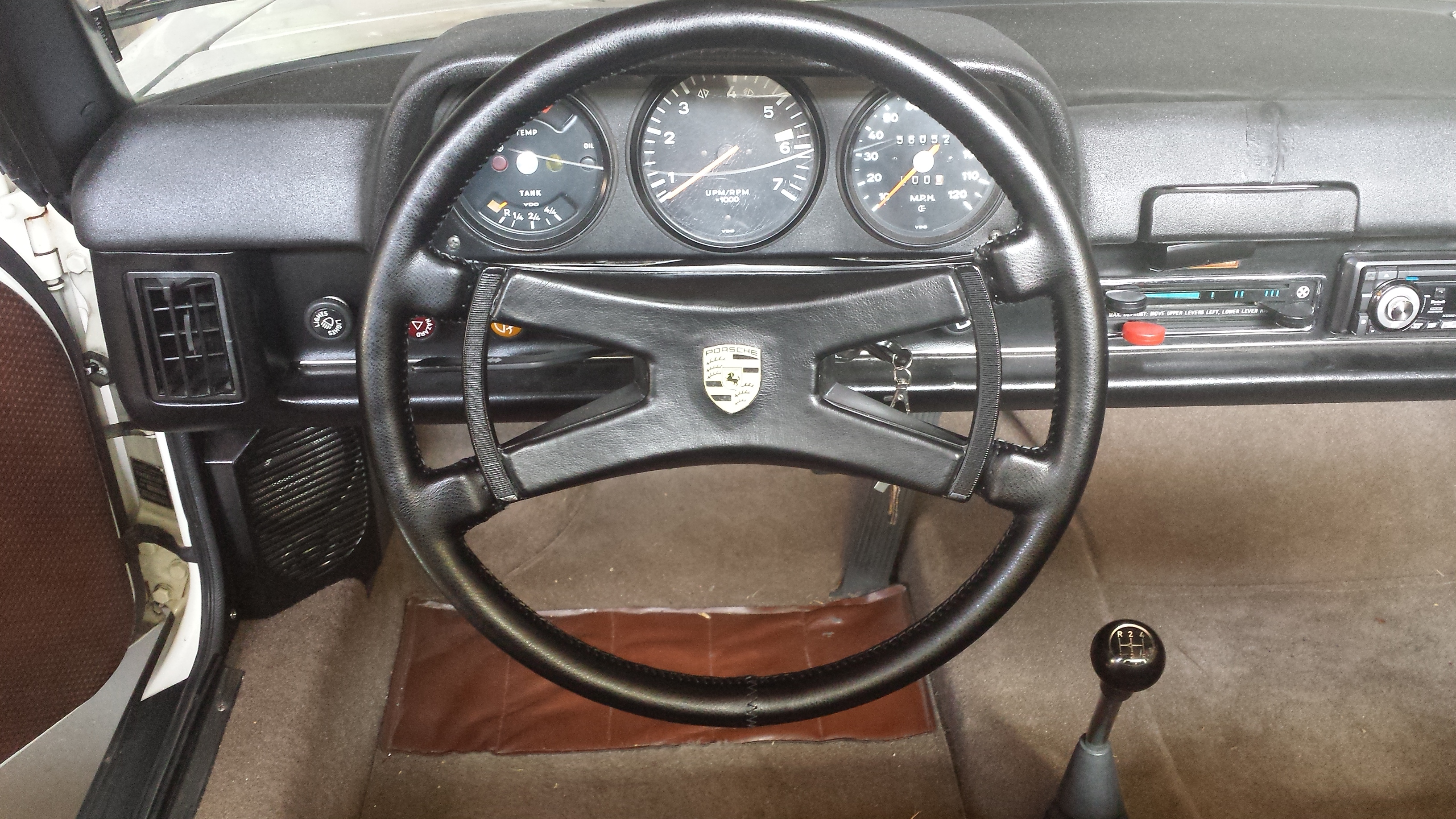

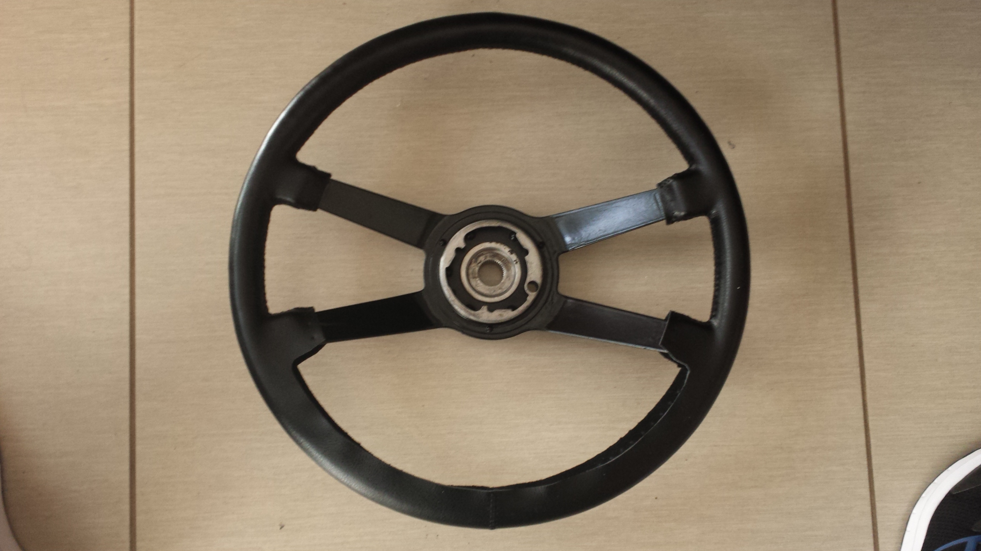

Done.
New steering wheel finished and installed.

That looks REALLY good, Valy. Did you use that leather kit that's available?

Where's the LIKE button?
Nice job Val (IMG:style_emoticons/default/thumb3d.gif)

Where is it available?
It's all handmade by me.
Materials are cheap, labor is about 3-4 hours of stitching.

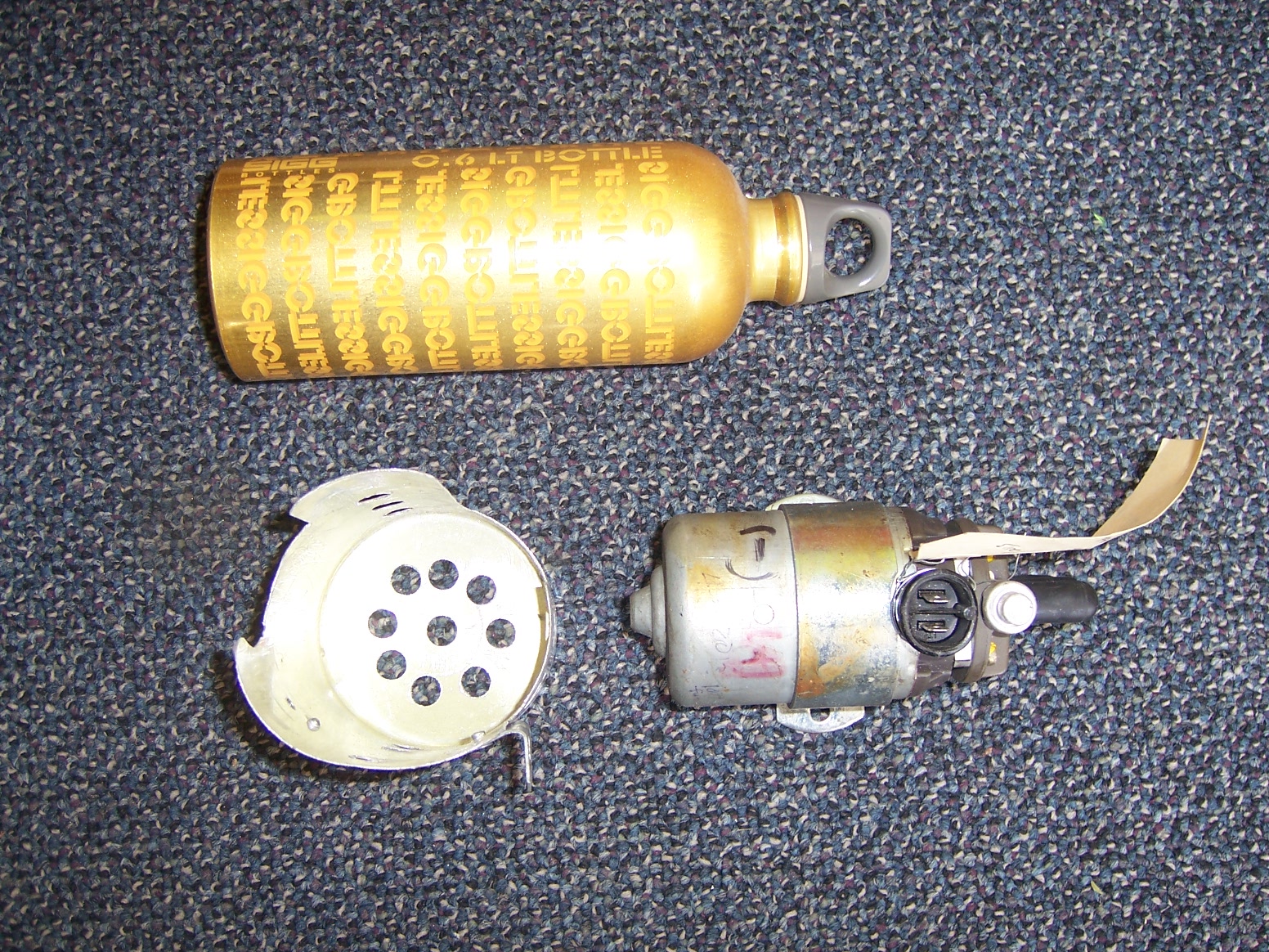

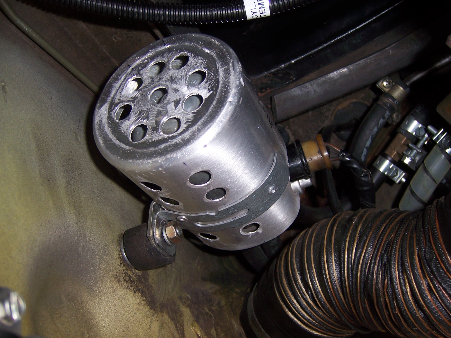

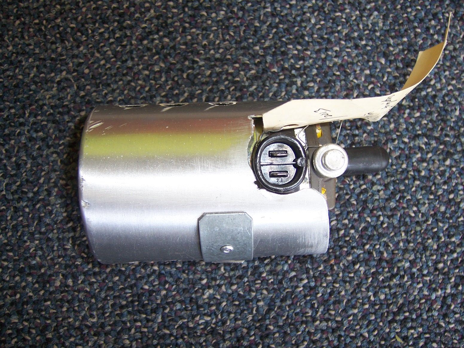

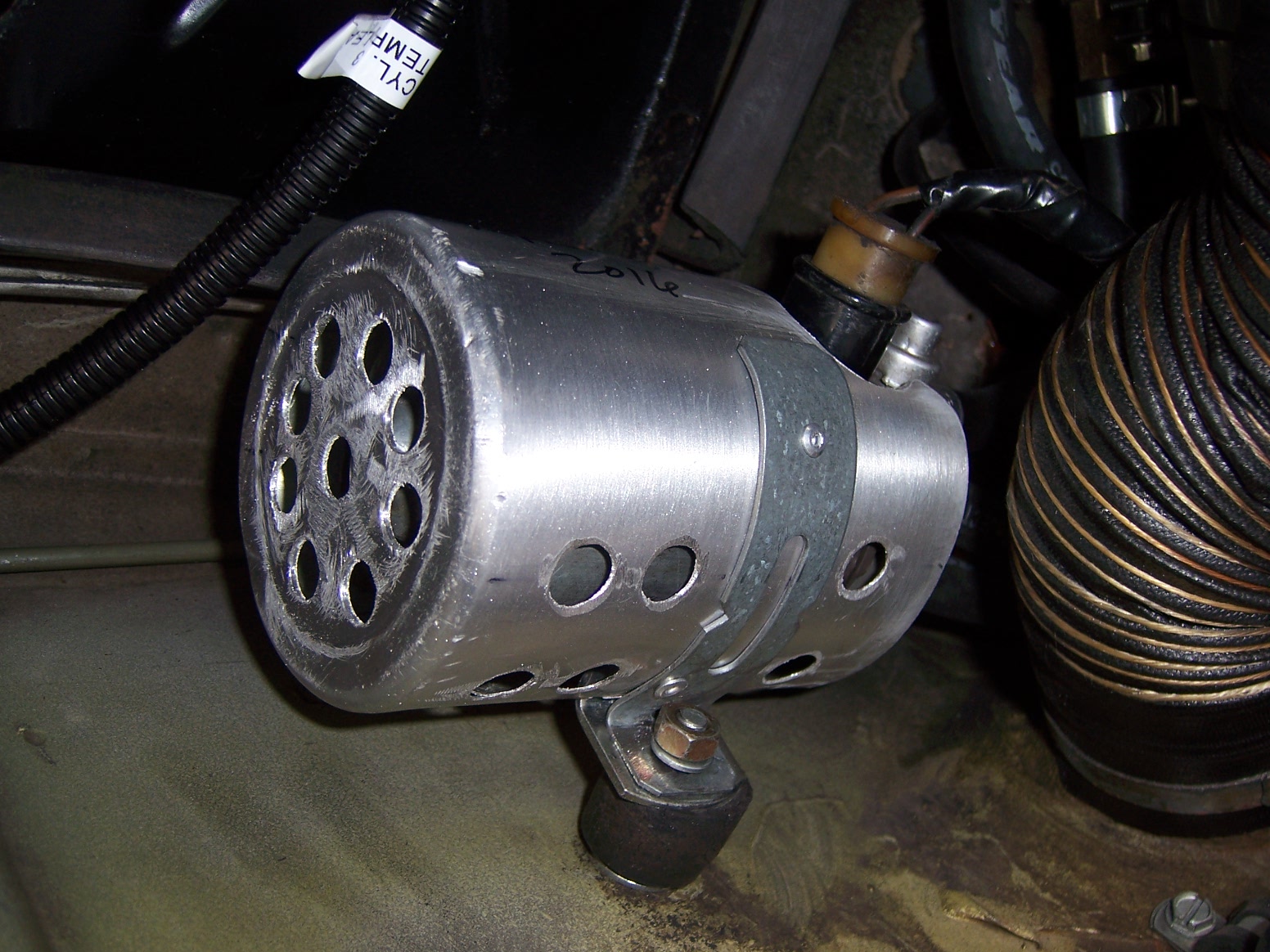

Fabricated a heat shield for the relocated fuel pump. It is bolted behind the passenger seat on the firewall. I actually don't have any hot start issues or vapor lock, but made this thing in anticipation of vapor lock. I took a 3 inch diameter aluminum water bottle and cut it up and ventilated it. Actually the major heat source is radiant heat from the passenger side heat valve and maybe some heat rising from the longitudinal conduit that leads up to the passenger footwell. Sorry, the fuel pump is not for sale.

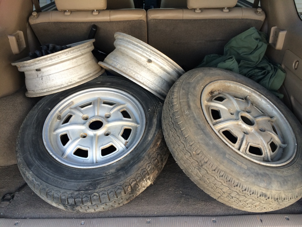

I got these today:

Fantastic! Love it.

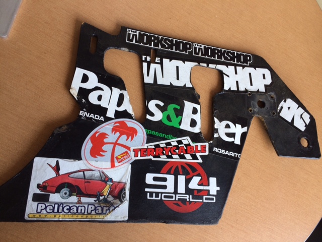

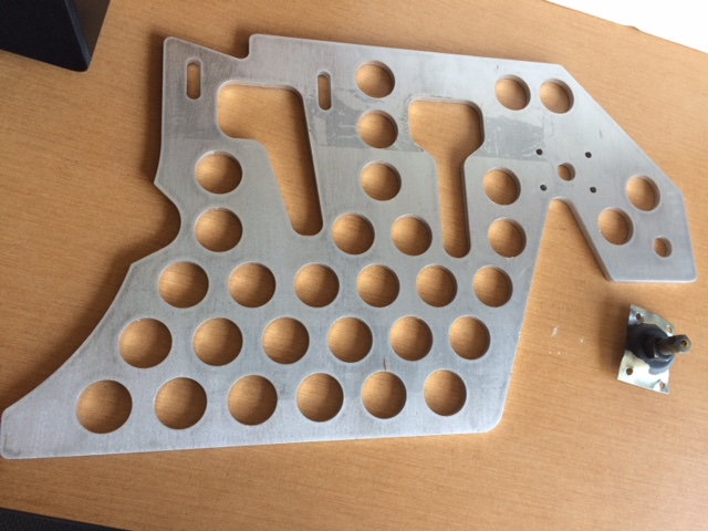

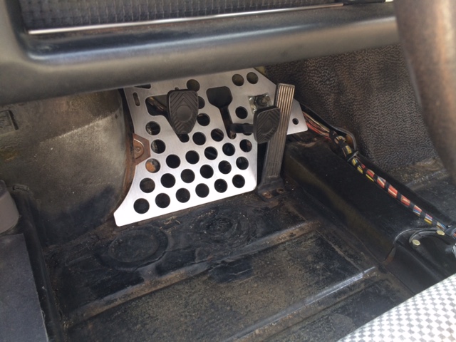

i like my old pedal board but i can't resist a good deal-Engman pedal board from Stephen (914forme). (IMG:style_emoticons/default/beerchug.gif) Thanks buddy!
