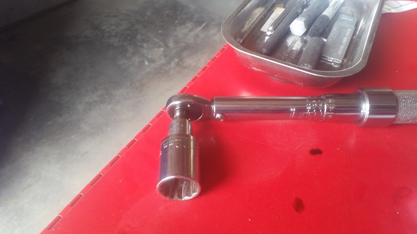

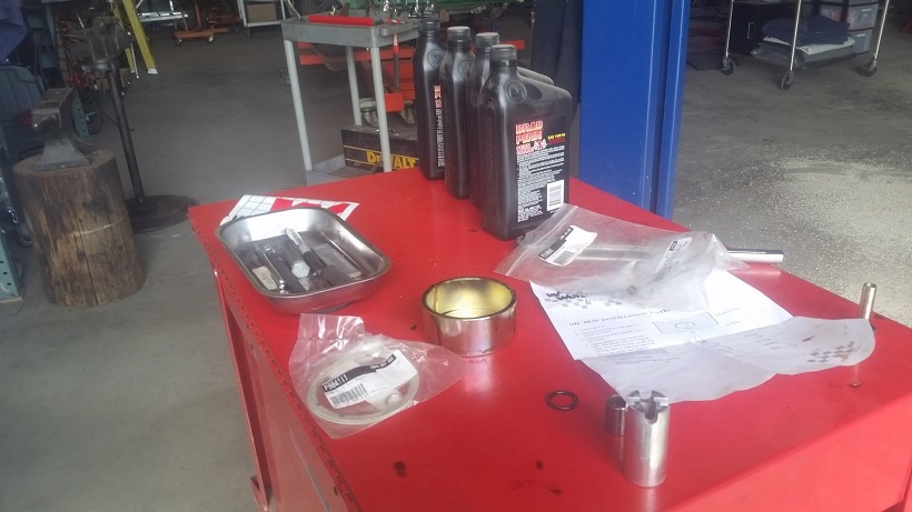

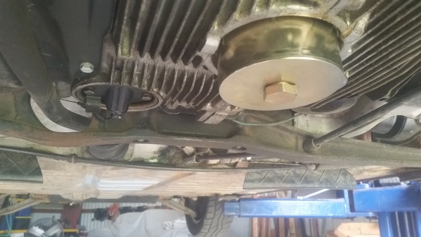

Changed the oil and added a tuna can.
9 lbs. of torque. 7# click, 8# click, then 9# click.
No drips ...........

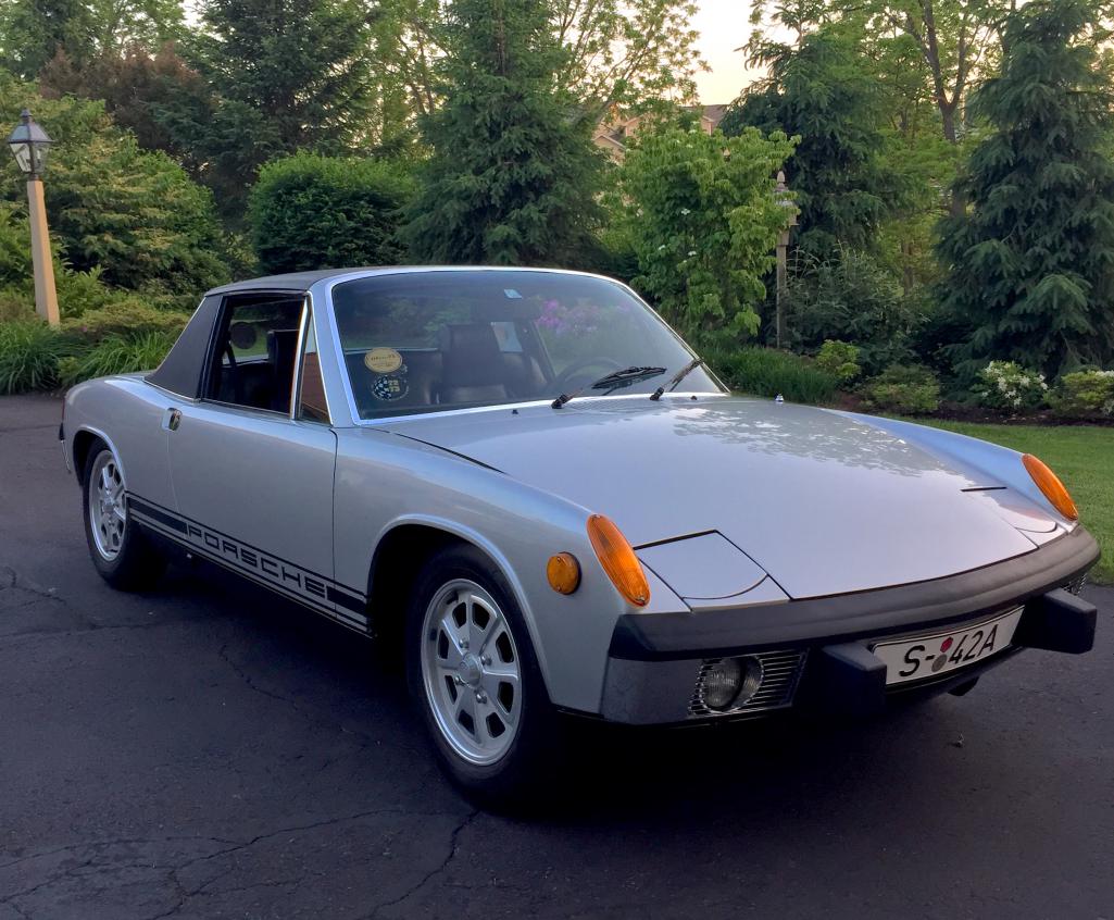

Porsche side script installed today....courtesy of Bob Tilton over on the ESR.

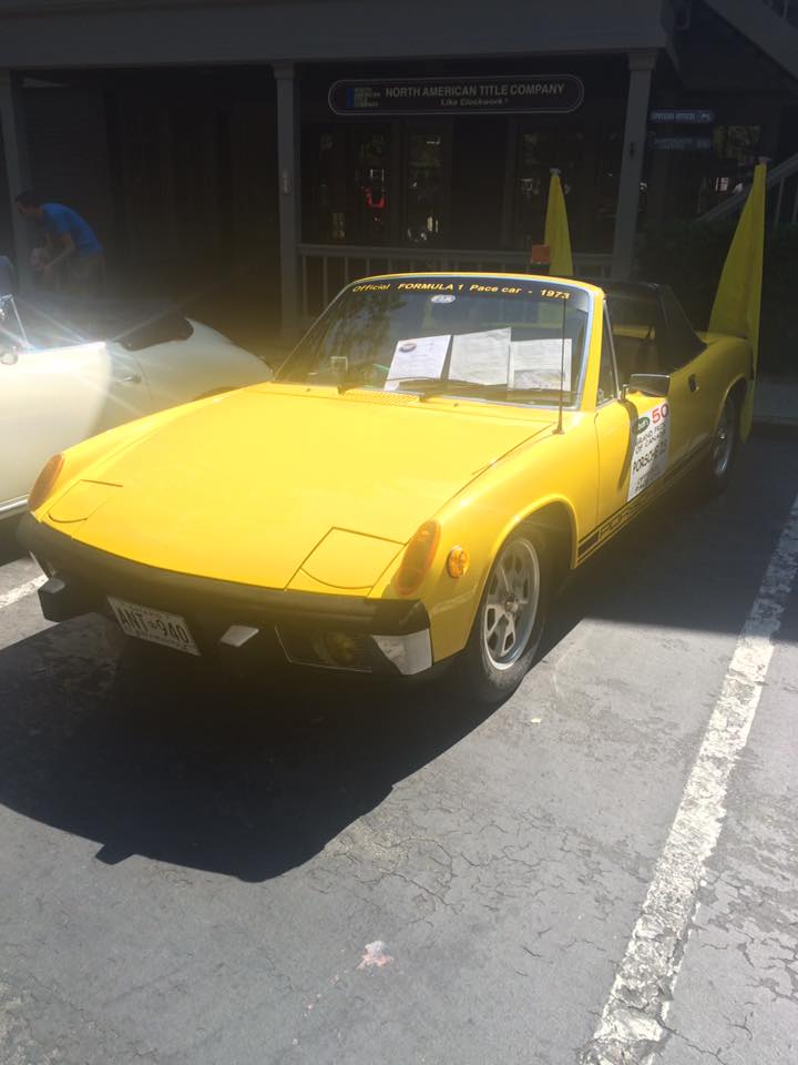

Participated in the PCA - Diablo 32nd annual Car Show.
won Best Theme / Decorated.
I was there in full F1 Pacecar livery

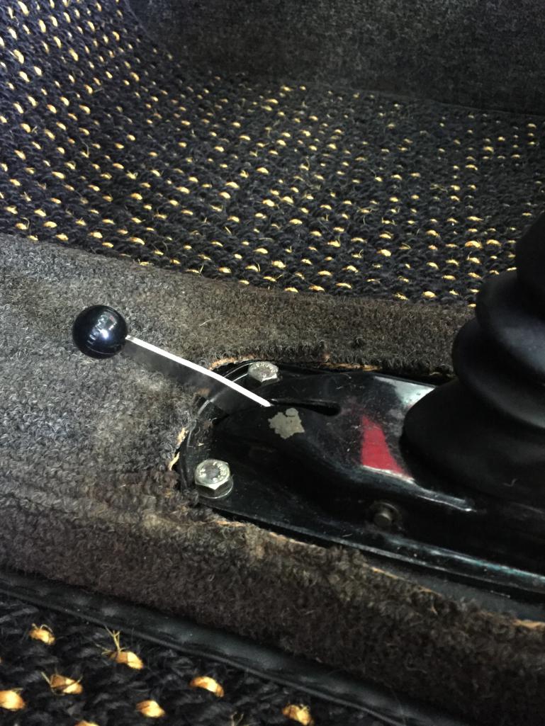

I'm still waiting for my /6 head work to get finished, next week short block possibly.
Meanwhile, I installed an early 911 type throttle lever and the linkage/shaft in the front tunnel and adjusted it. The carpet will be replaced.
Getting the car prepped for welding in the front six mount and oil tank install.

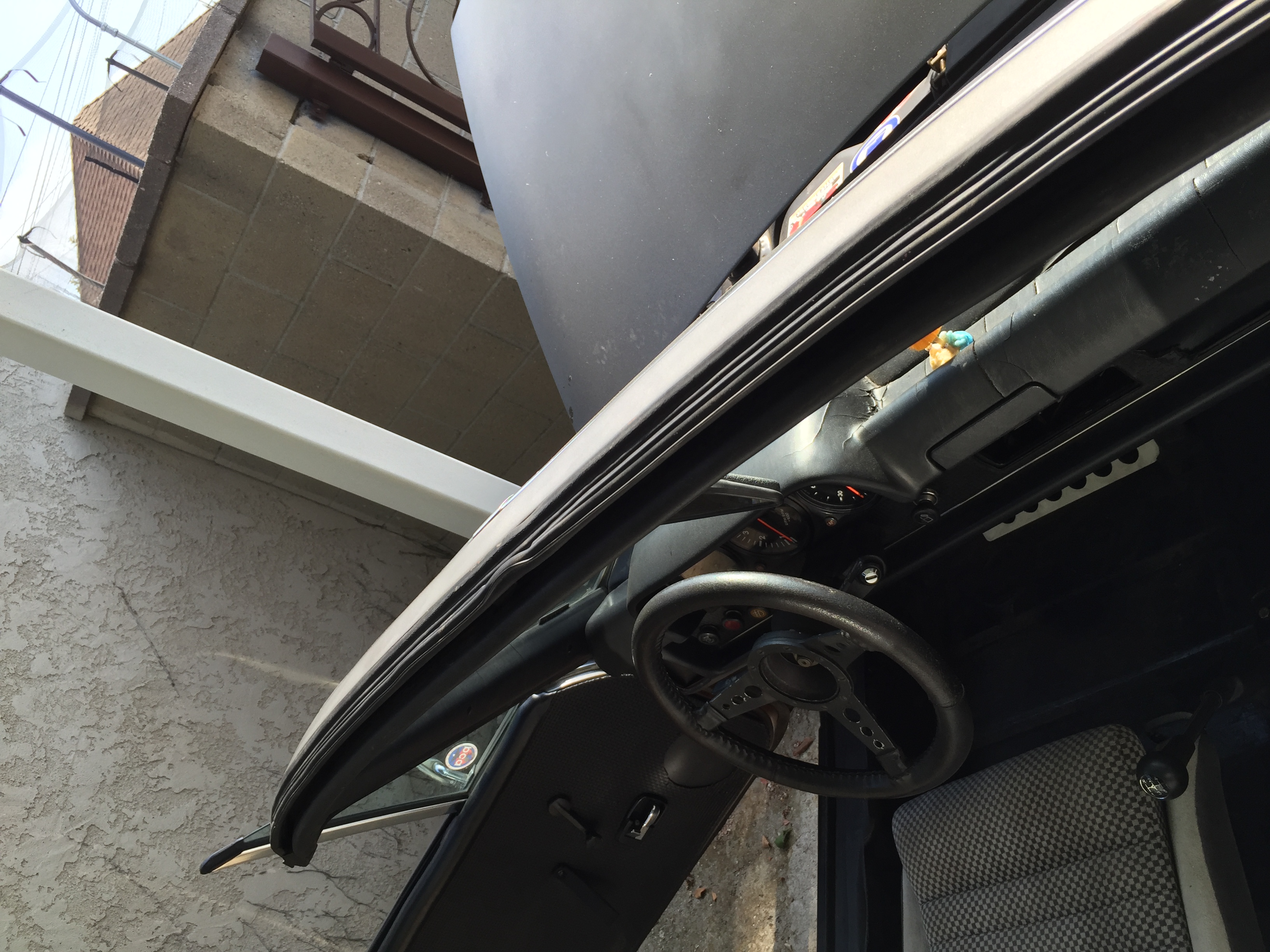

installed new to me main targa seal. thanks noel on hints on how to easily replace them. afrer installation, i vacummed the inside and both trunks. i also paid for new tires-special order since they were out of stock with $160 mail in rebate.

^^^ I like your seats .. (more pics ?)
What tires did you get that have a rebate ... I am in the market for new rubber.

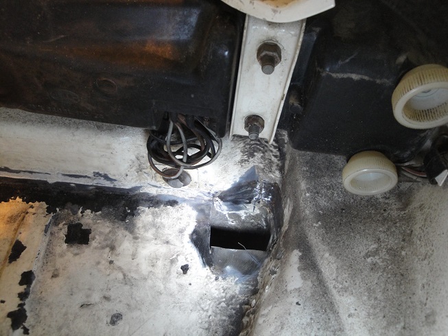

Today I cut out a small area of rust in the rear of the passenger floor and welded in fresh steel. Had a little help from my son who did a pretty good job of panel beating the front panel end ready for me to fit the new fender later this week.

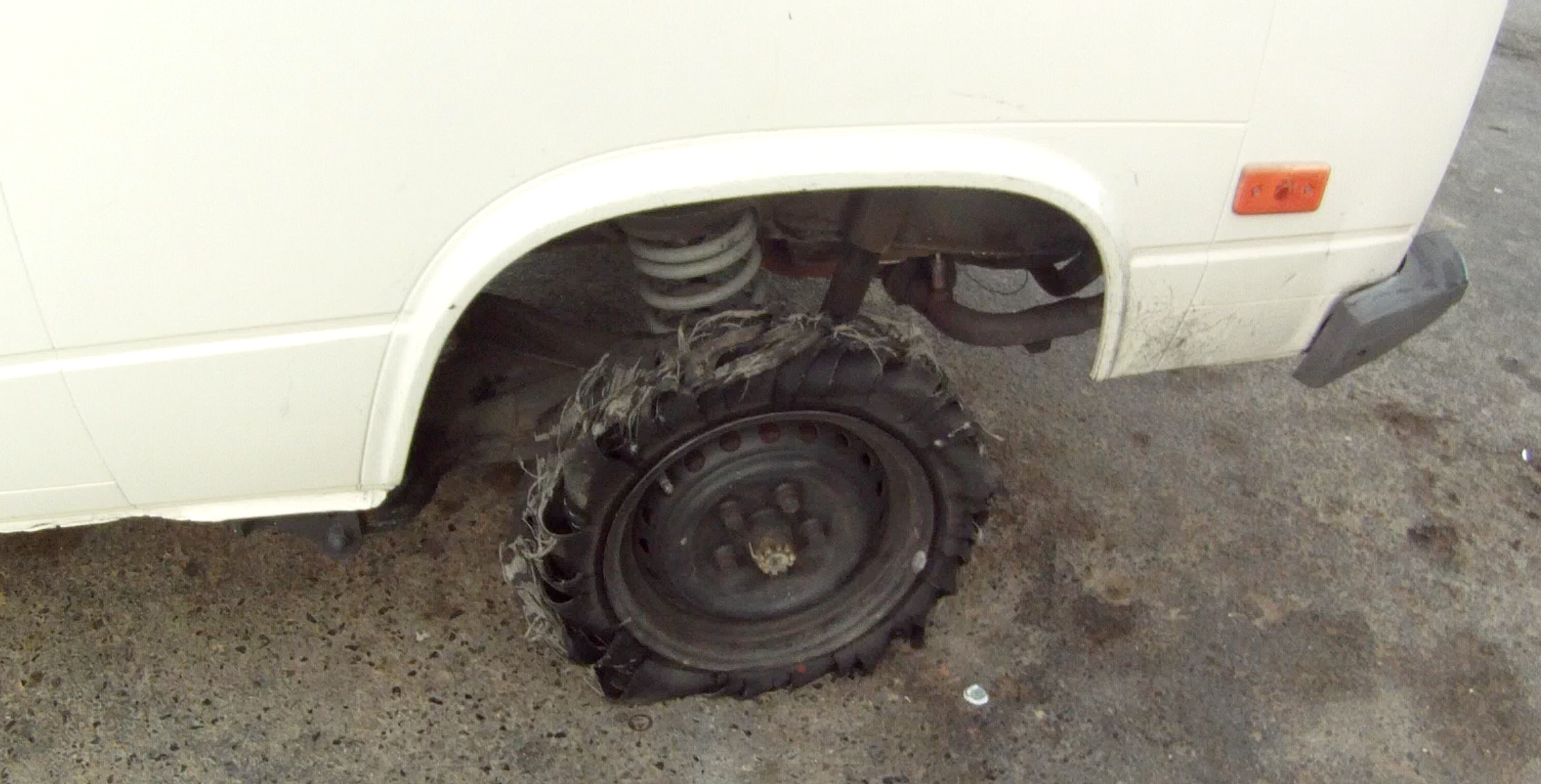

I had a Yokahama blowout on the Vanagon yesterday on my way home from Nor Cal (IMG:style_emoticons/default/sad.gif)
... film at 11
On the other hand, I'm really happy with the Kumho Solis tires on the 'BB'

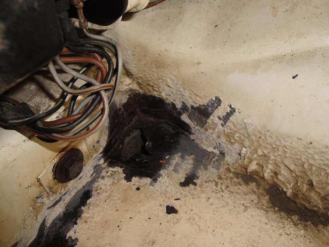

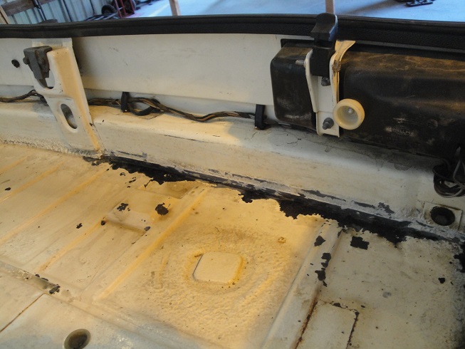

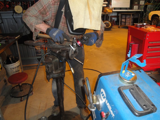

Forgot to mention on Saturday that I found some rust worm issues in the trunk of my DD. (IMG:style_emoticons/default/sad.gif) (IMG:style_emoticons/default/sad.gif)
Started here, pulling the seam sealer.
But found this when I got to the corner.
It couldn't been seen. It was totally covered with seam sealer.
After surgery.
Two plunge cuts with the Dremel. Then long cuts with the air hacksaw.
Worked the corner with the Dremel reinforced disk.
Super In Law making the two piece patch piece.
