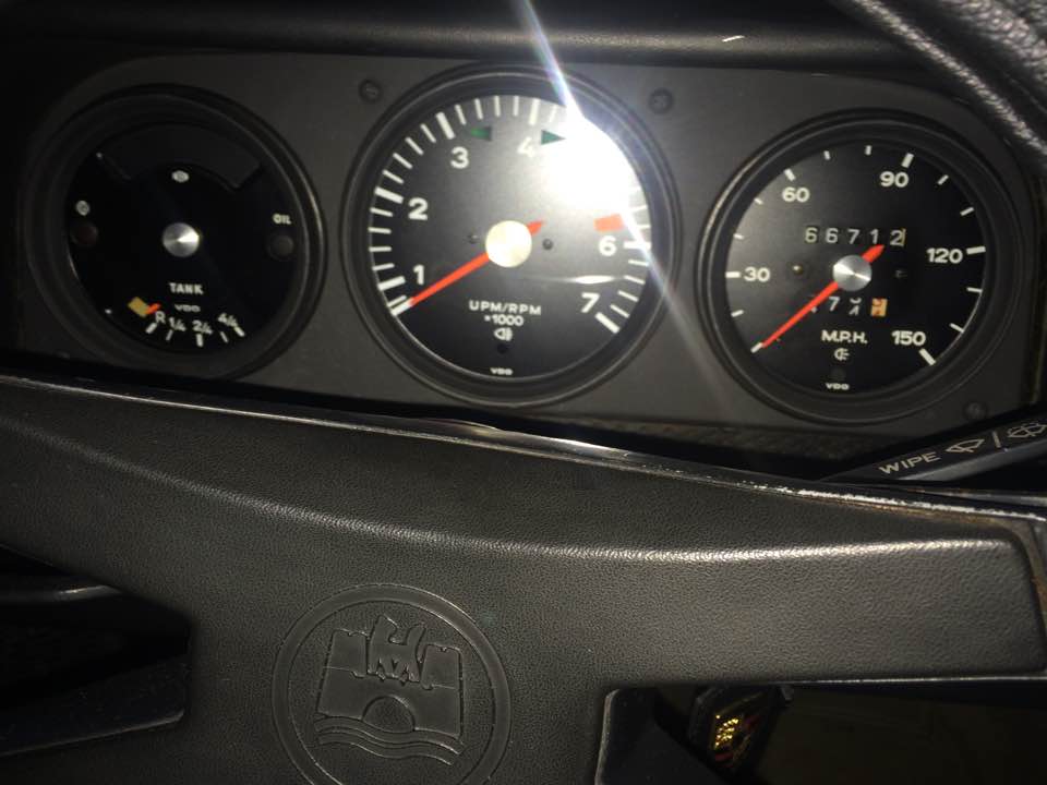

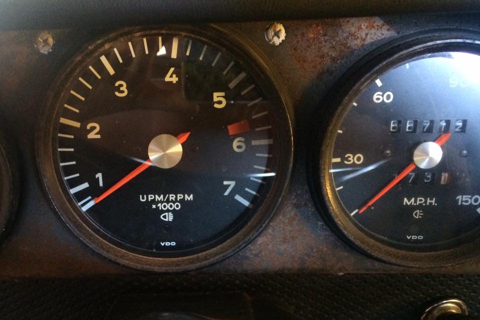

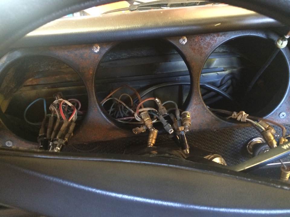

Actually a 3 "ish" day project.
Removed all the gauges:
Painted the instrument dash. Took the gauges apart and cleaned, painted bezels. Cleaned up the faces and replaced all the bulbs.
Before
After

Ahhh, a VW steering wheel pad! That's different for here in the states.

Looks great (IMG:style_emoticons/default/thumb3d.gif)
I replaced the plastic bezel on my 75 with a freshly-painted early metal one last year, Made a big difference - and spruced-up the interior quite nicely (IMG:style_emoticons/default/cool_shades.gif)

Can you explain how you cleaned the faces without destroying the color?
The attempts I have made now require the face to be replaced... (IMG:style_emoticons/default/dry.gif)

^^^ for the faces I used cotton balls and Q tips. distilled water only. For some reason the silver dots had a sticky film on them , I used rubbing alcohol on them
I may have been lucky.
The metal and bezels were really bad . Lots of wire brush and sanding, I couldn't get them perfect so I actually used some texture paint, then painted them.

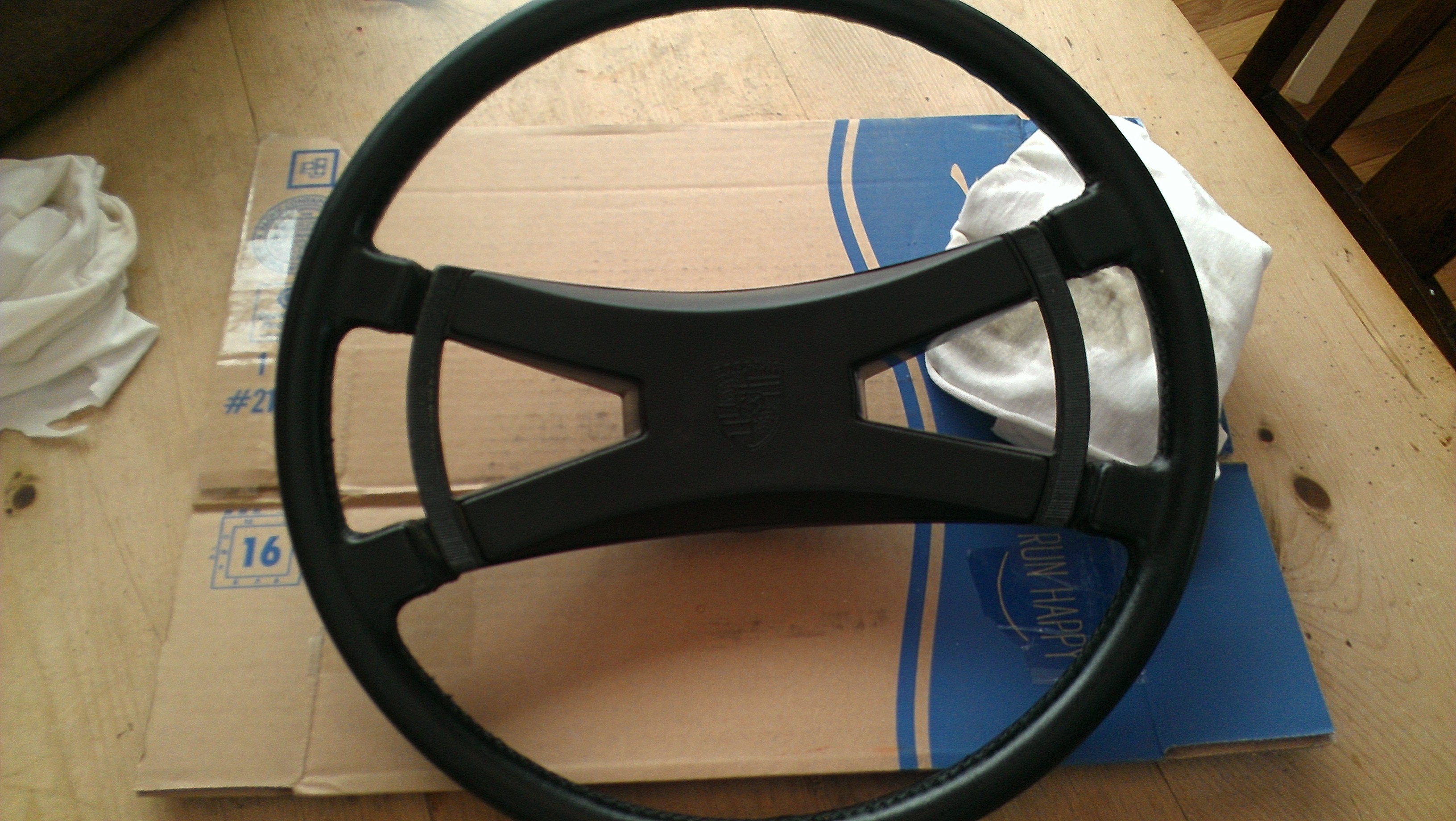

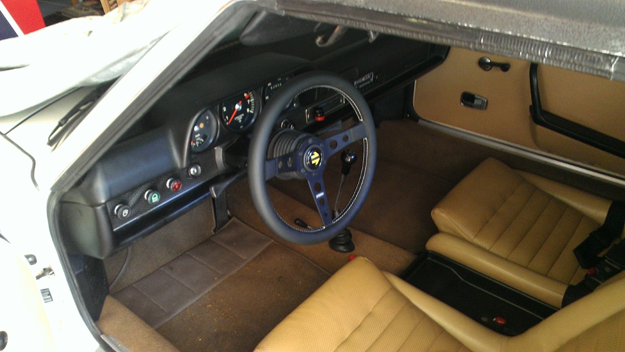

replaced my OEM wheel with a Momo Prototipo. I just can't drive a 914 with the large stock wheel very well. I started by removing the center console to get more leg/foot room, but I just needed more room...

nice Wolfsburg steering wheel... only seen one of those in the flesh when I drove a euro model 914 WAY back in 1970 when our local Porsche Audi dealership was opening...

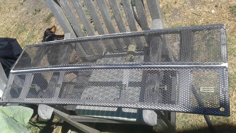

Worked on making a gt lid kind of fun. Considering pop riveting or welding. Attached Image (IMG:style_emoticons/default/welder.gif)
