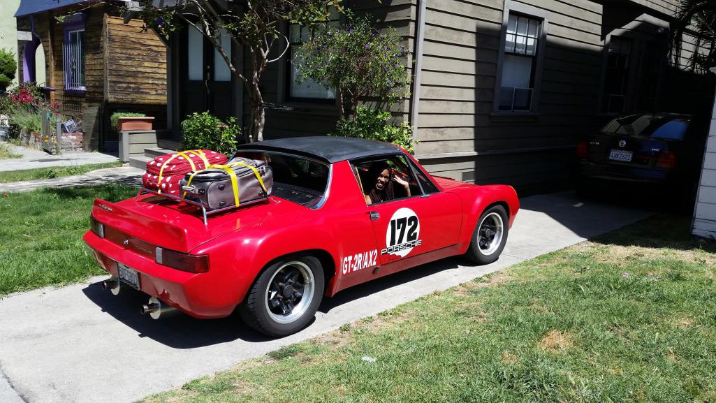

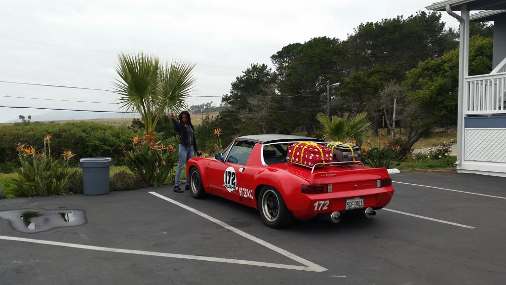

QUOTE(euro911 @ Oct 7 2016, 02:00 PM) *
QUOTE(SirAndy @ Oct 7 2016, 01:03 PM) *
... My current spare is a 225 on a 7" cookie cutter and it's just a bit too high for the rear trunk.
Isn't that why you have that rack on the rear deck-lid - for your Paris to Dakar runs?
No, the rack is for my luggage ...
(IMG:http://www.914world.com/bbs2/uploads/post-179-1430801778_thumb.jpg)
(IMG:http://www.914world.com/bbs2/uploads/post-179-1430801936_thumb.jpg)

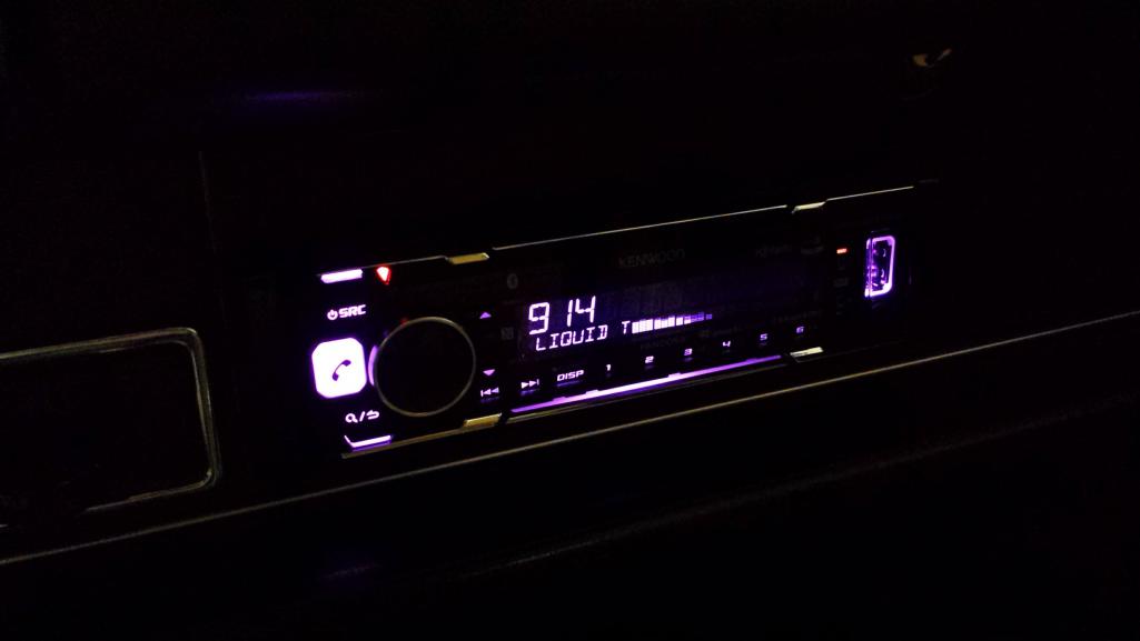

One more thing I did today, I updated my 16 year old head unit to a new Kenwood KMM-BT515HD digital media receiver. It's got built-in HD Radio (awesome sound), Bluetooth, Aux, Pandora, iHeartRadio, Android and iPhone control, USB, and gobs of other features. Installed super easy and was only $107 from Amazon, including a handy remote.
Good spot for the BT microphone
And there's only one song to play in your 914.... "914" by Liquid Tension Experiment!

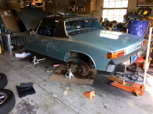

Installed new front sway bar bushings, replace front bearings and brakes. Also bled the brakes using the new power bleeder.
Now working on installing the tuna can and oil change.

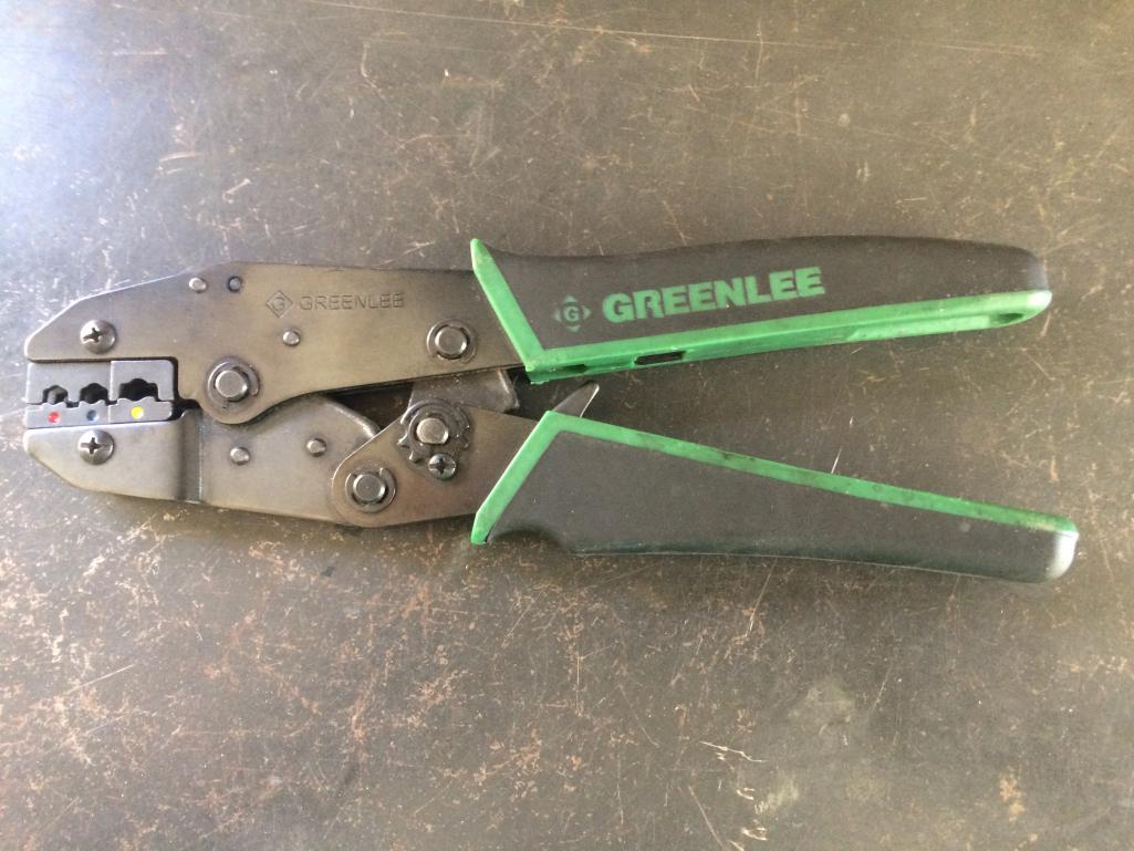

God, I love modern day electronics. Went to the grocery store this AM and noticed a flat spot during acceleration and twice it cut out. Connected the OBD2 reader and found the error code, P0113 (intake air temp sensor). The voltage wasn't there nor did it have continuity. Peeled back the wiring loom and found a wire had pulled out of the butt splice connector which was crimped, and I use this term loosely, with the red handle tool. It is excellent for cutting and stripping wire but not for crimping. At the time I did not have this tool. Which brings me to this:
This is crimping tool:
This is not:
