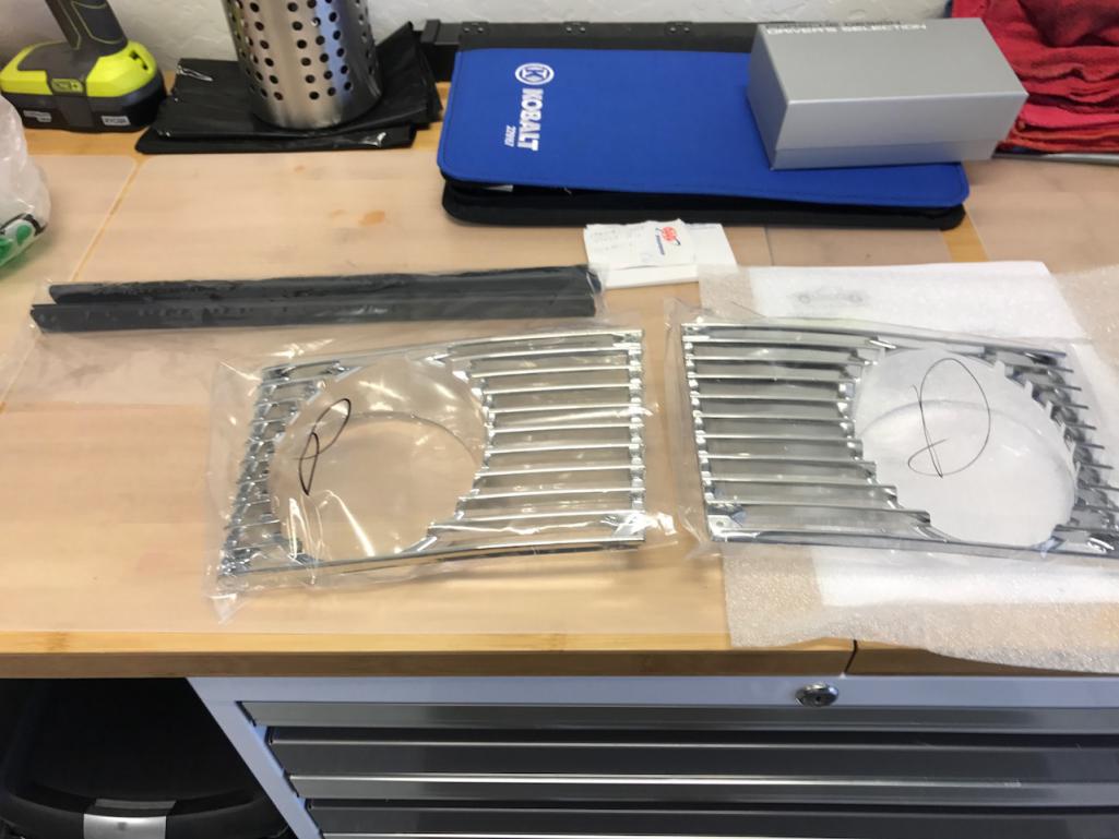

Got a package from 914rubber- the new fog light grills look great, and the targa window track rubber is really needed!!
A project after the Christmas rush is over...

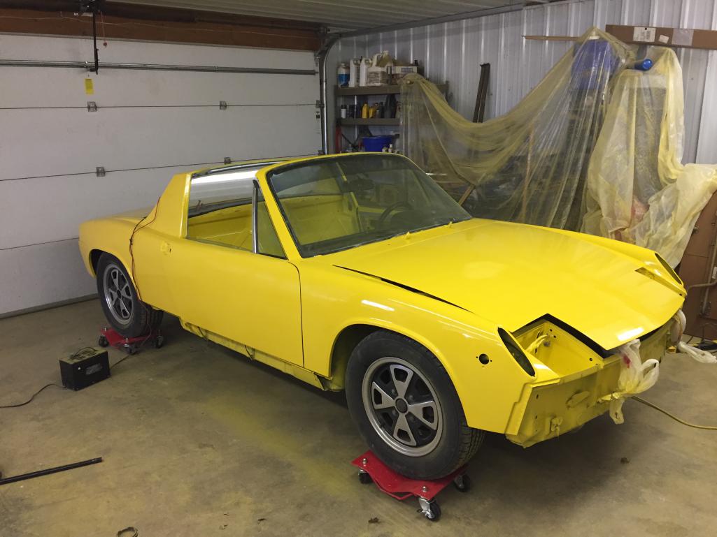

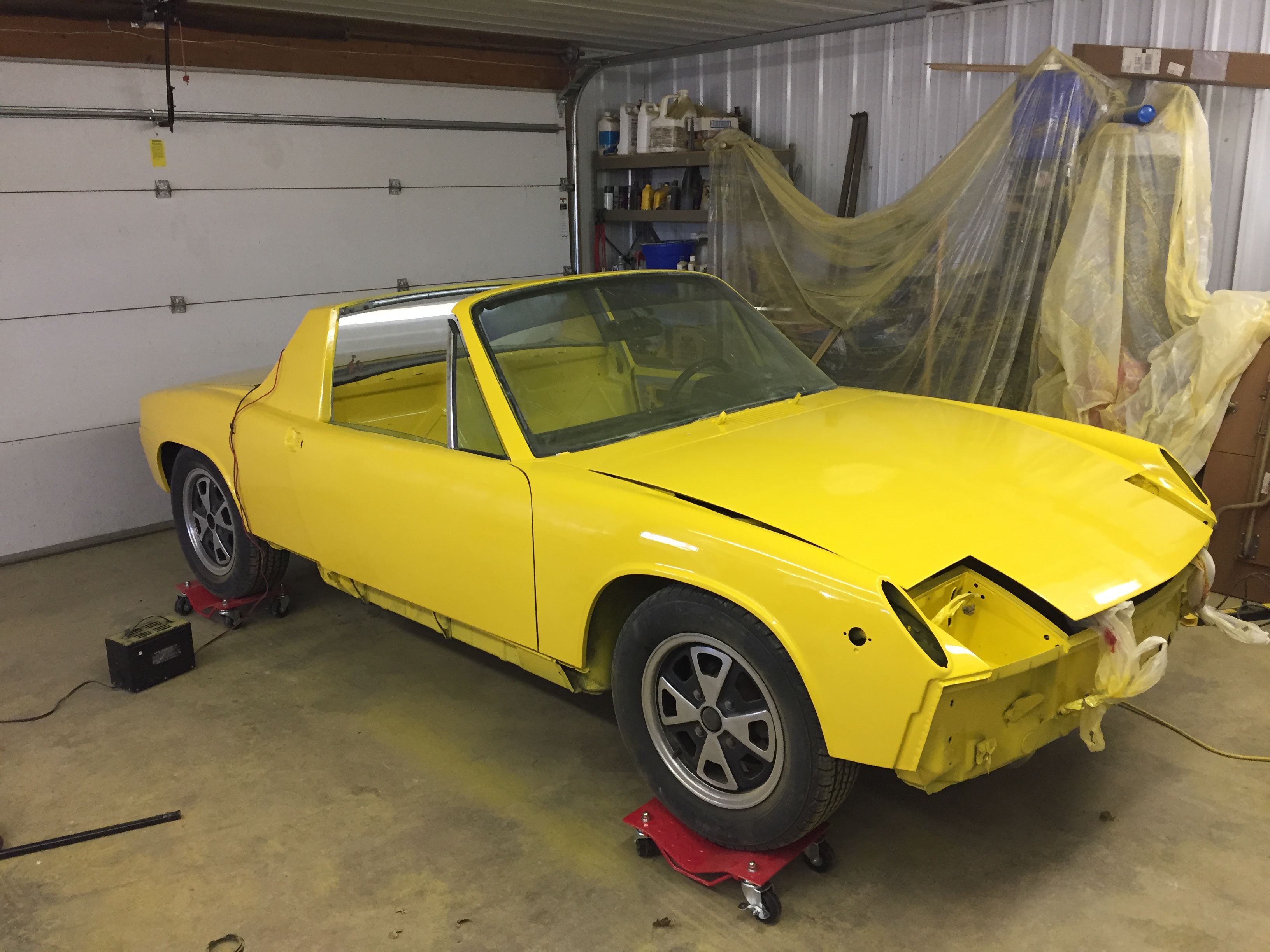

Sanding runs in clearcoat. First time painter and bad lighting did not go well. Hoping I can I can fix it. Trial run yields an acceptable result.

Looks great! I'm thinking about attempting the same with my car!

The key I have found to controlling runs in the paint is to adjust your gun on a test panel before you dive right into it. Open the fluid control nearly wide open then start dialing it back 1/2 and 1/4 turns until you get about a 1 second test shot "football" fan that does not run on you. Be sure you are on a vertical test panel so gravity is working against you. Adjust the fan shape and pressure (gun specs) as you dial into it too.

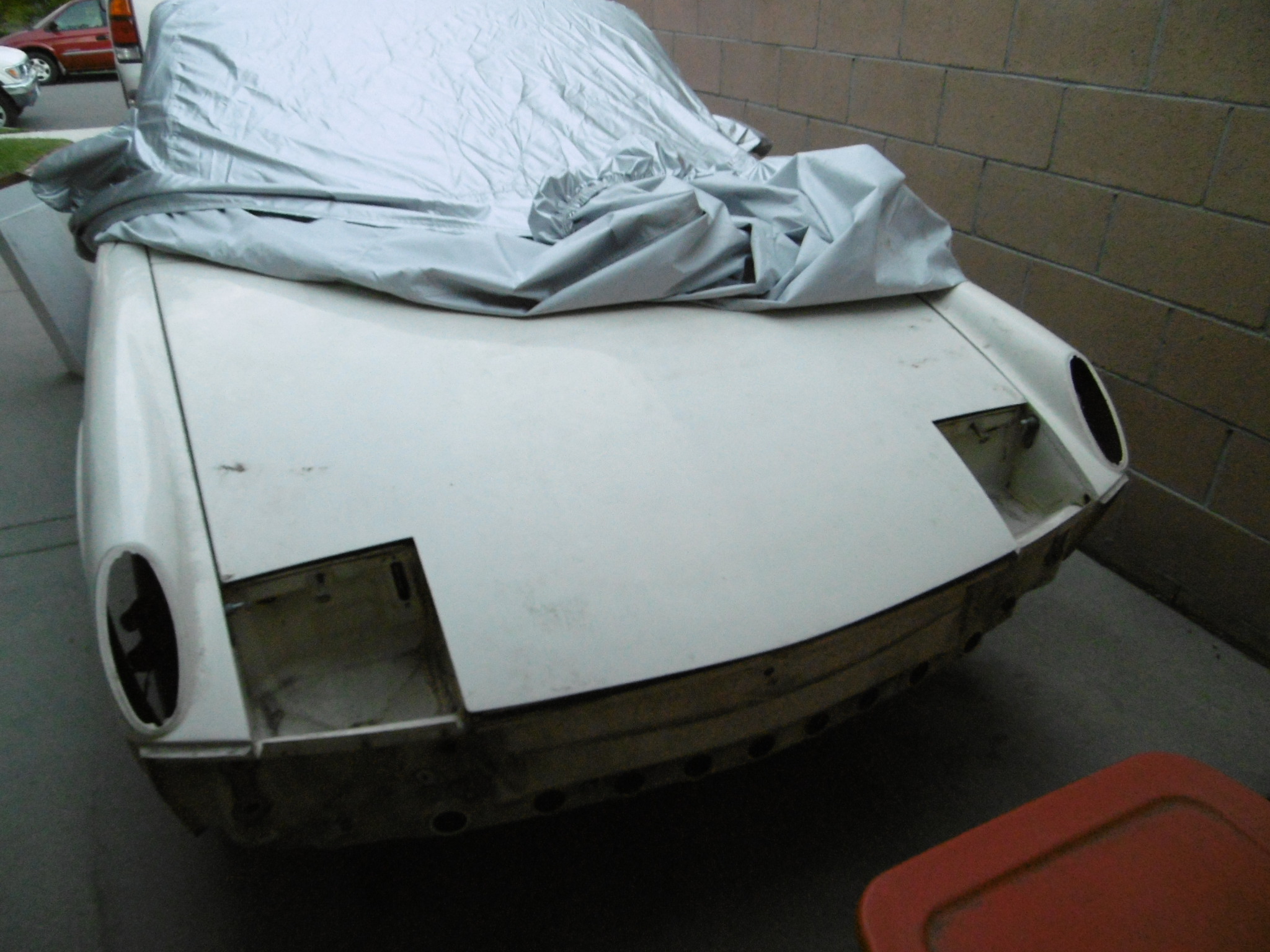

Removed the [in the up position] headlight assemblies so they don't tear the new car cover (more rain coming tomorrow).
A few more pieces still need to be removed before I can get it into the body shop for the paint prep, so, until then ...

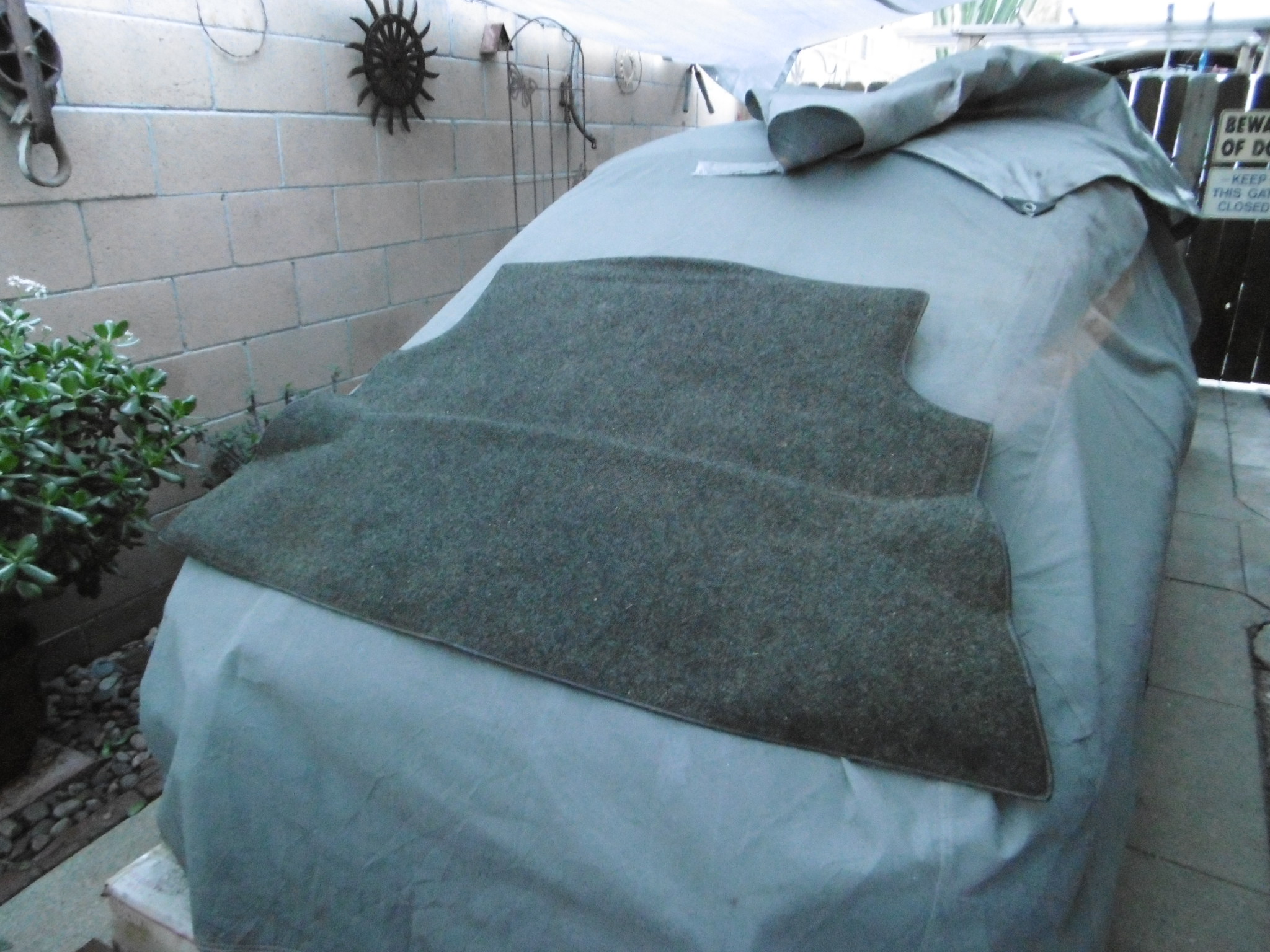

Makes me wonder if this is where Porsche got the idea for the shape for the 930 whale-tail (IMG:style_emoticons/default/idea.gif)

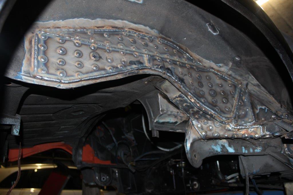

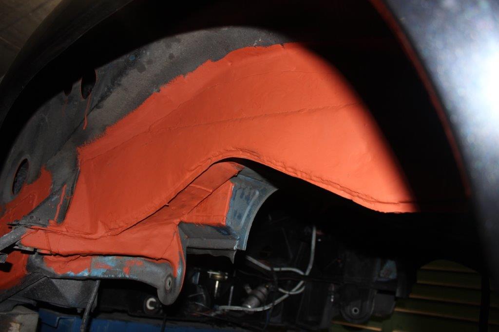

chassis stiffening kit welded in (IMG:style_emoticons/default/biggrin.gif) (IMG:style_emoticons/default/biggrin.gif)

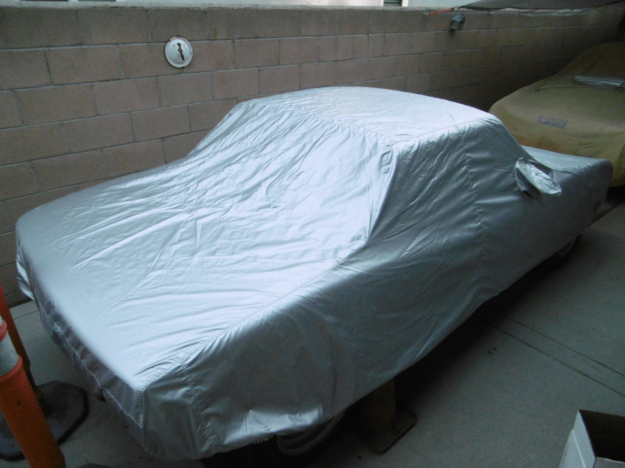

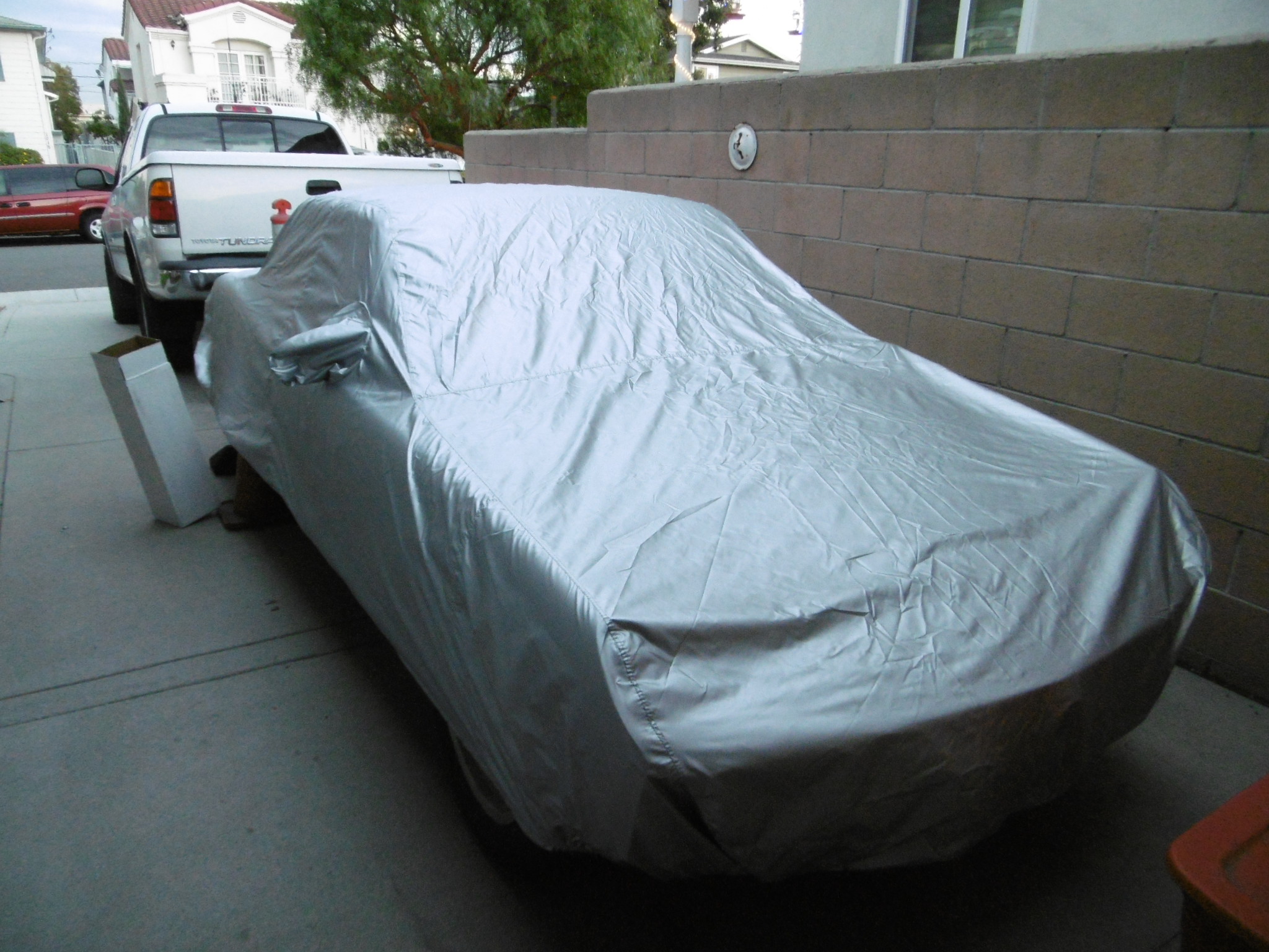

Hey Mike, not sure where my wife ordered them from, but it's a Covercraft, model# C15134RS (70~76 914 with 2 mirrors). As you can see from the pix, it's tailored to fit the 914 nicely (IMG:style_emoticons/default/mueba.gif)
It comes with a radio antenna grommet, but I didn't want to cut a hole, so I took a small plastic butter tub, cut a hole in the lid and placed the tub (upside down) over the protruding antenna tip (IMG:style_emoticons/default/cool_shades.gif)

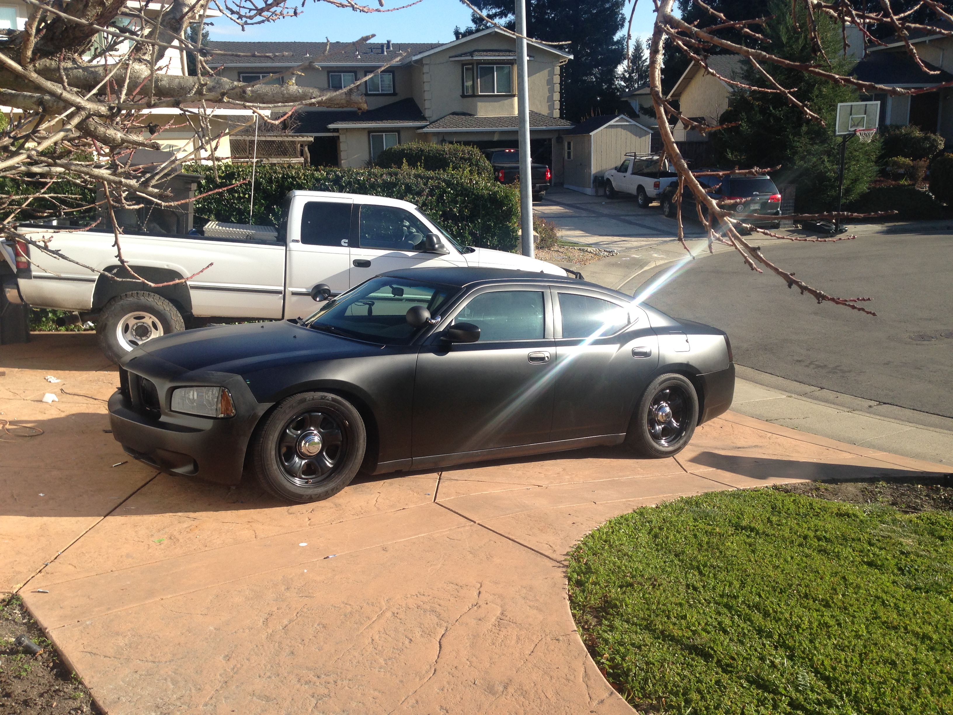

It's a little stiff but rides nicer than my 914. The springs have settled more and I'm going to dial up the ride height a little. Try to get it back to looking like this picture.

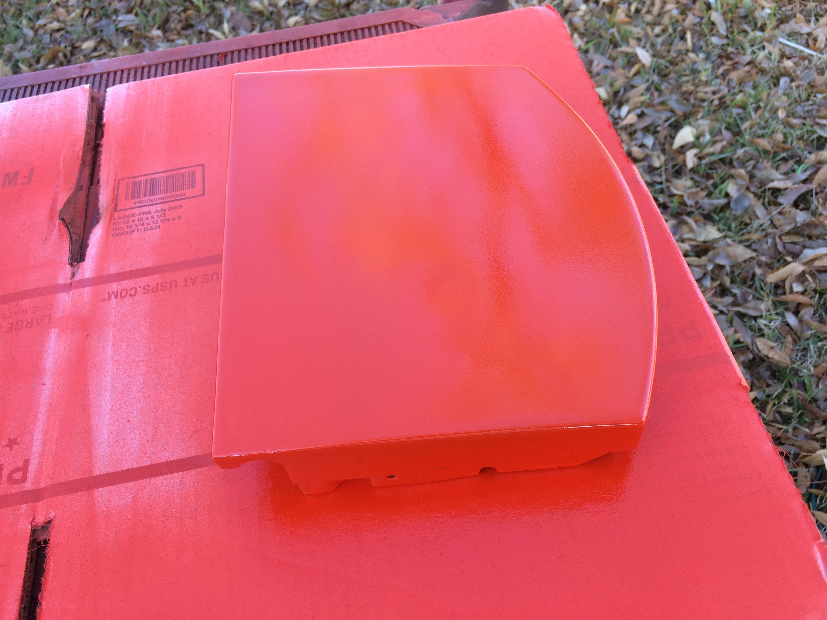

Re spray the headlight covers.
2 undercoats. 3 colors 2 clear. Nice and shiny!
