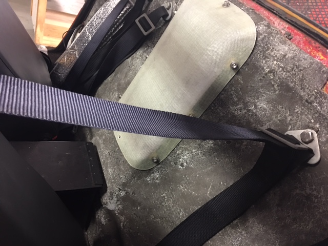

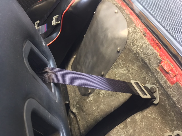

Delivered another 914-6 hatch cover kit w/ hardware and illustrated instructions. Then produced another one for another day.. (IMG:style_emoticons/default/piratenanner.gif)

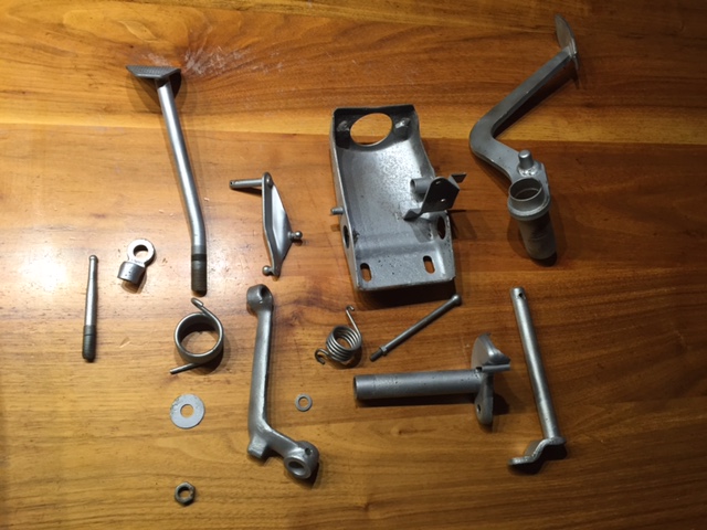

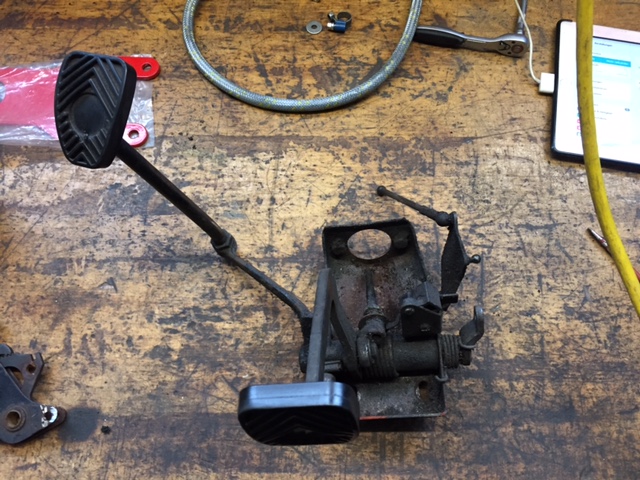

Pedals sand blasting

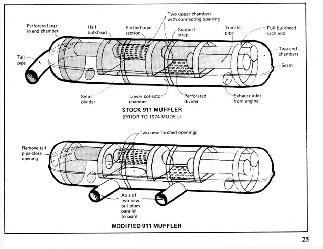

Here's the instructions.

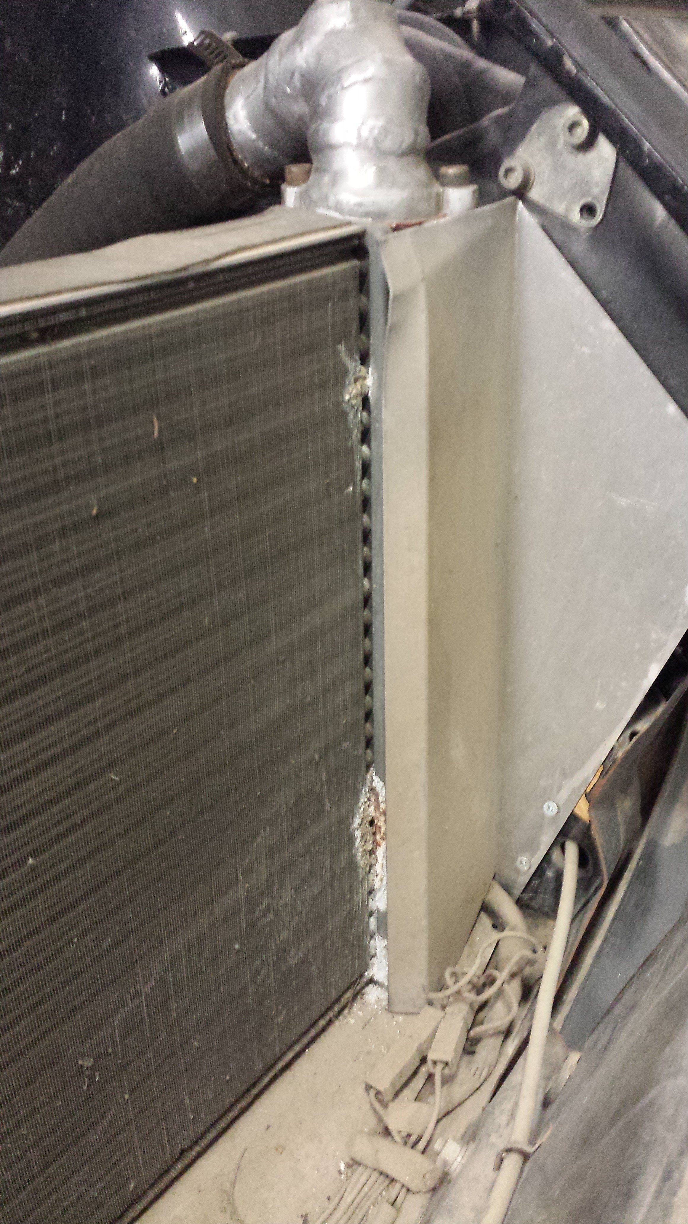

Got the Corrado radiator and hoses un-installed from the original 2001 build. Good thing I decided to jump on the Celica swap early as it looks like a bad road trip in the making (IMG:style_emoticons/default/huh.gif)
Things just don't last like they used to (IMG:style_emoticons/default/stirthepot.gif)

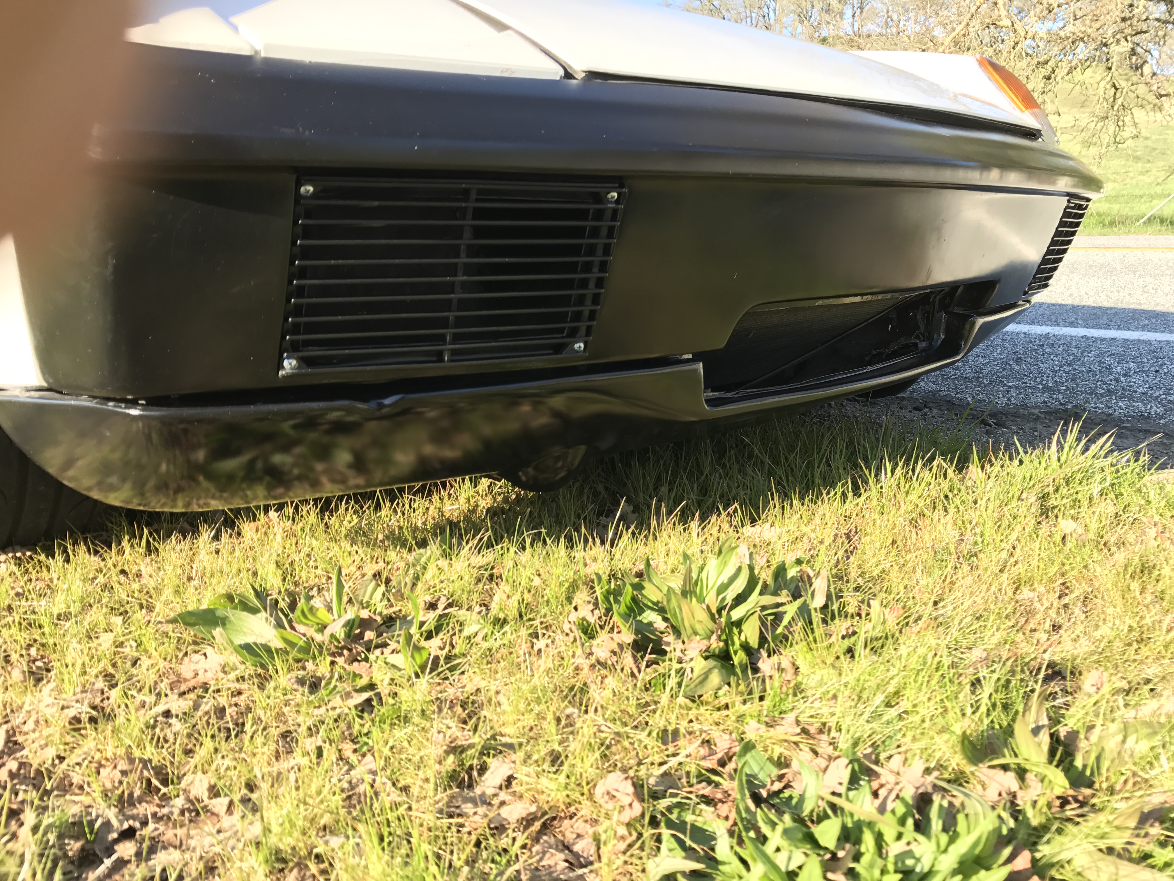

Installed a narrow body GT valence.

That is for a 2in 1out muffler to a sport conversion.. Never converted an sc muffler (1inlet) to a dual inlet.. That is a new one and I am not new to that business..

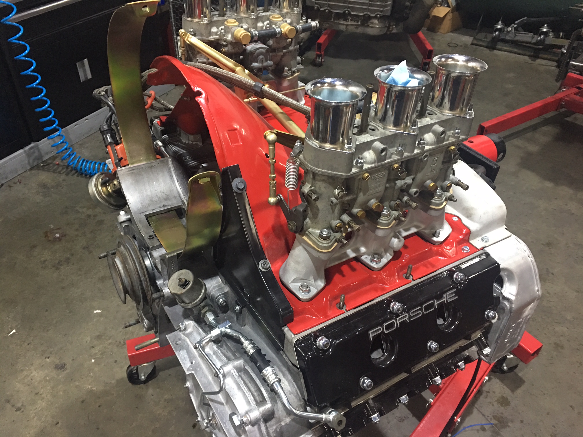

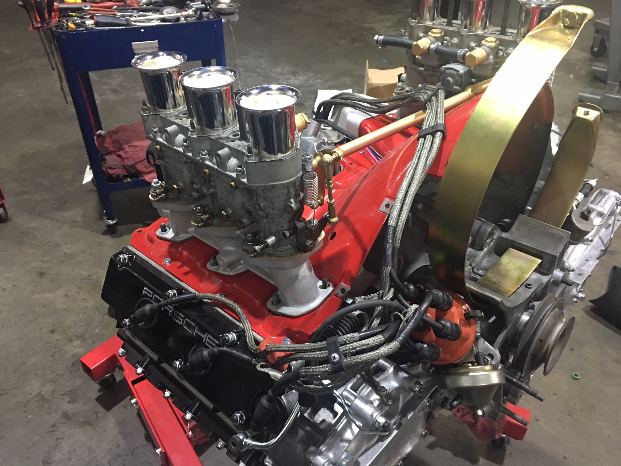

I am going to scope the innards of my SC muffler to see if it will work. As for what the heck did I do last night until 11pm... see progress pix
Also, as we were bolting up the headers that Larmo gave me such a good deal on, I discovered they will not fit a 914-6 but rather a 911 in standard backaswards motor config only. (IMG:style_emoticons/default/sheeplove.gif) AhhhGin!
Also, as we were bolting up the headers that Larmo gave me such a good deal on, I discovered they will not fit a 914-6 engine orientation but rather a 911 in standard backaswards motor config only. (IMG:style_emoticons/default/sheeplove.gif) ed AhhhGin!

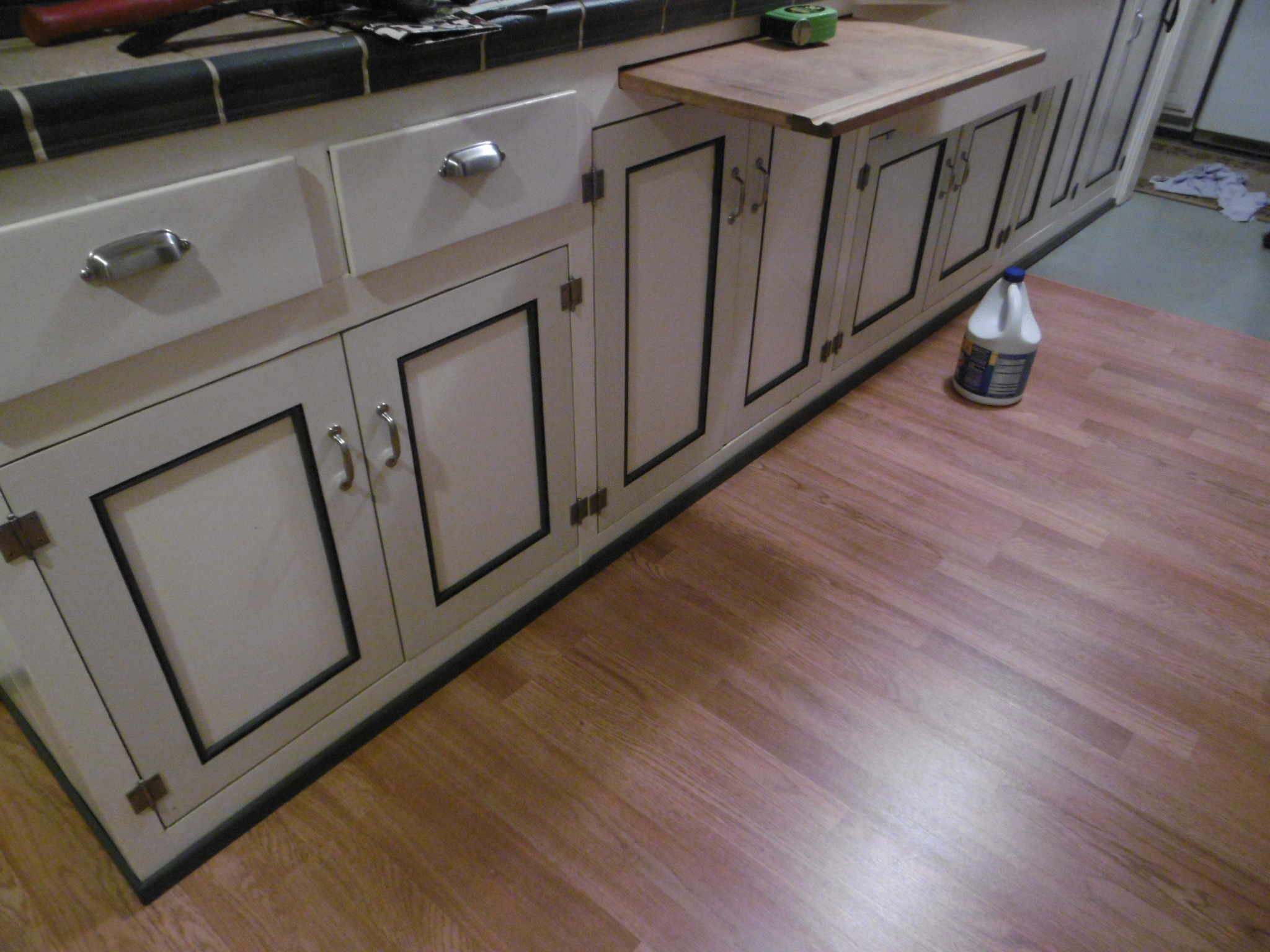

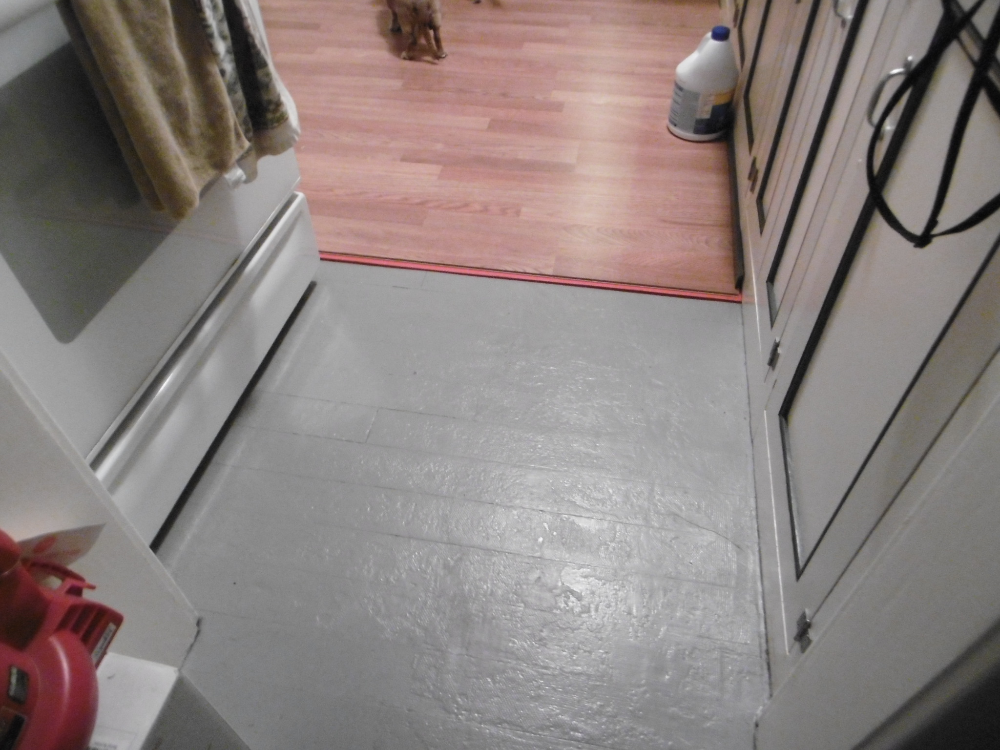

Made sure all the car covers were secured for the impending stormy week end (IMG:style_emoticons/default/pat.gif)

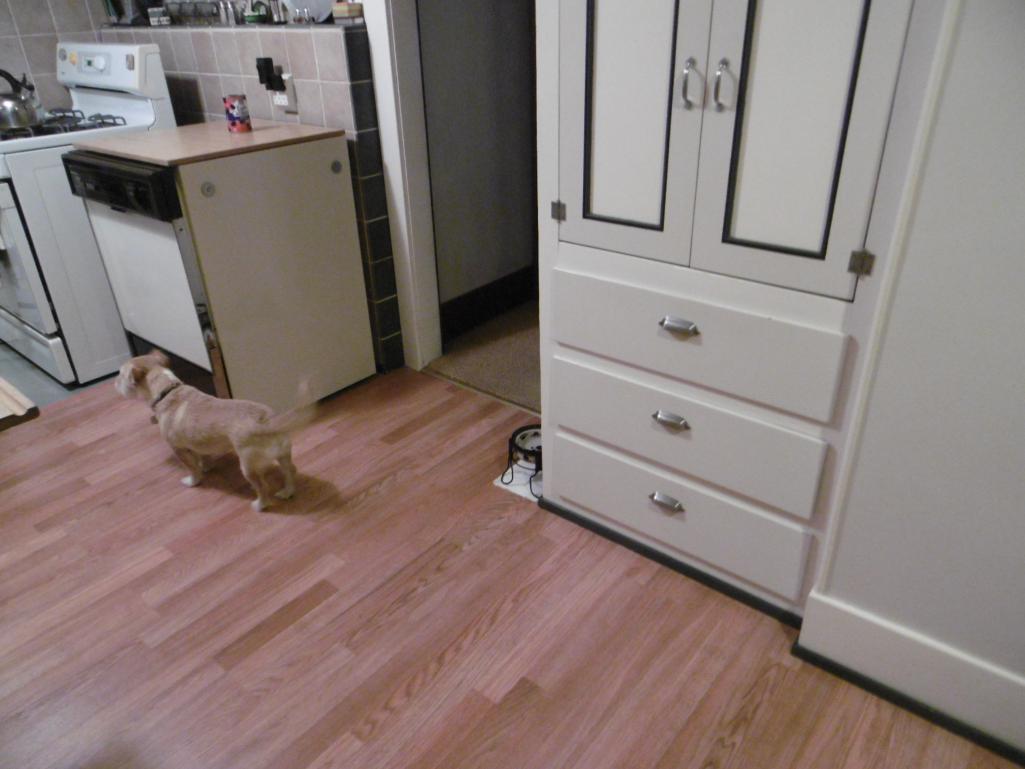

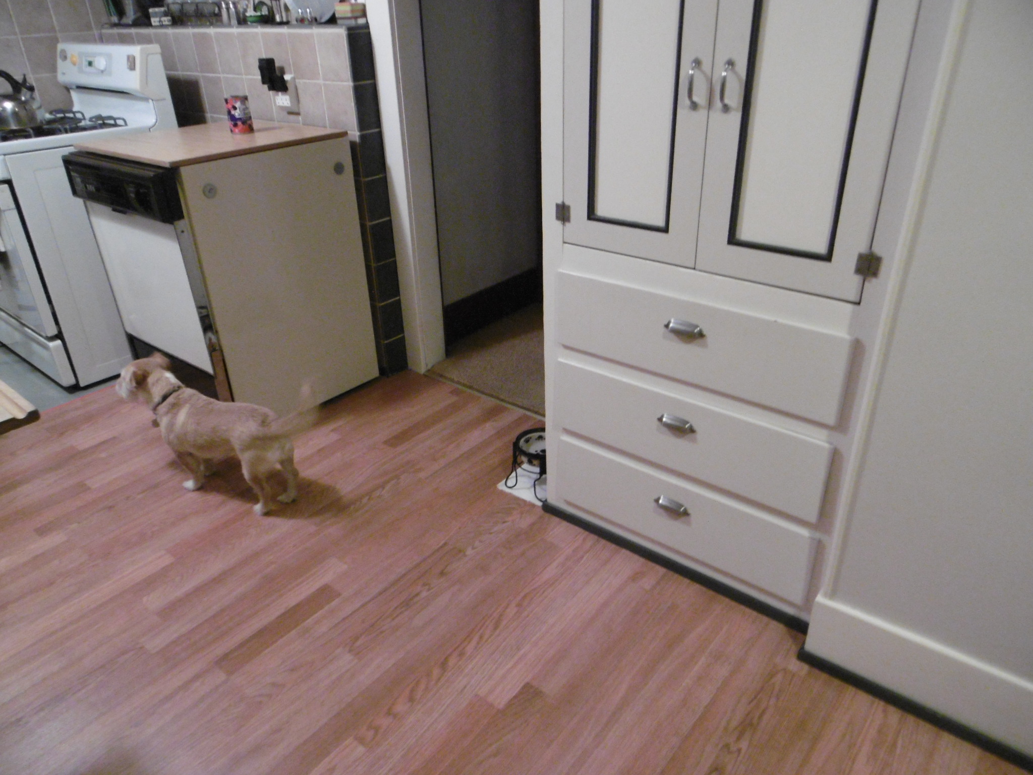

Inside honey-do work ... I spent 9 hours and 14 minutes working on the new kitchen floor (IMG:style_emoticons/default/rolleyes.gif)
BEFORE (sort-of) showing the old painted floor ...

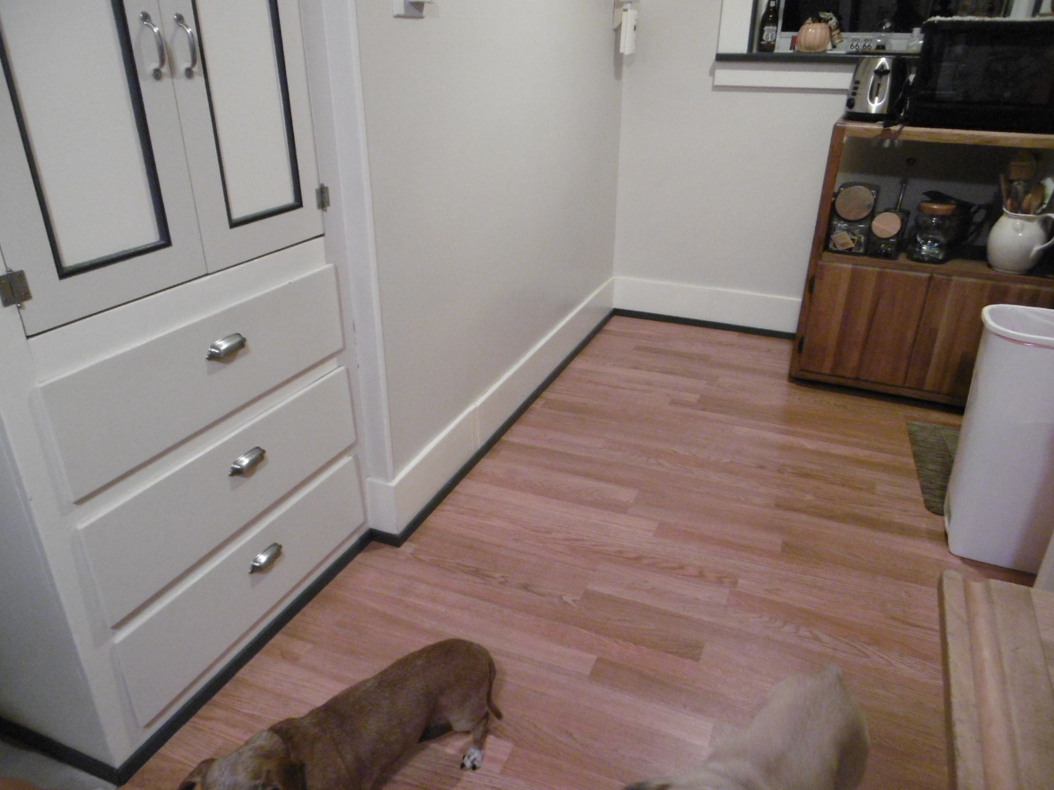

AFTER - still have a bit left to do in the kitchen and beyond in the pantry ... hoping to have it all done before the 'eggnogeration' festivities tomorrow evening (IMG:style_emoticons/default/shades.gif)

The floor looks great. that should earn you some quality 914 time!

Nice Porsche porn!!! Just converting the SC muffler to a pre 74 911/914-6 muffler, looks like a lot of work. I bought my Modified sport muffler at the Pomona swap meet for $200.00, but that was 15 years ago. Also sold it 15 years ago after all the evil stares from my neighbors.

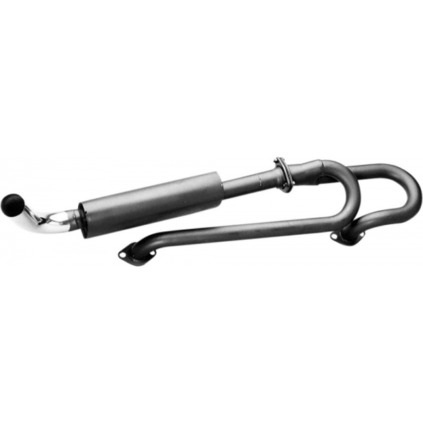

Can't beat the price of this muffler.
http://www.automotion.com/exhaust-sebring-...-1965-1973.html

That's for a -6 ?

Yep, look at the inlet flanges
