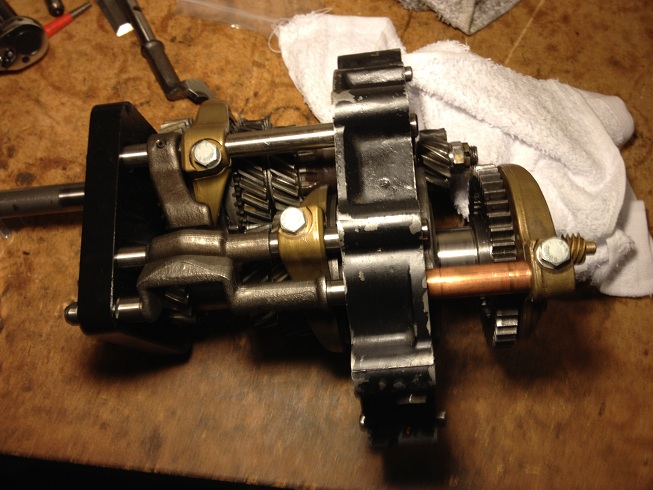

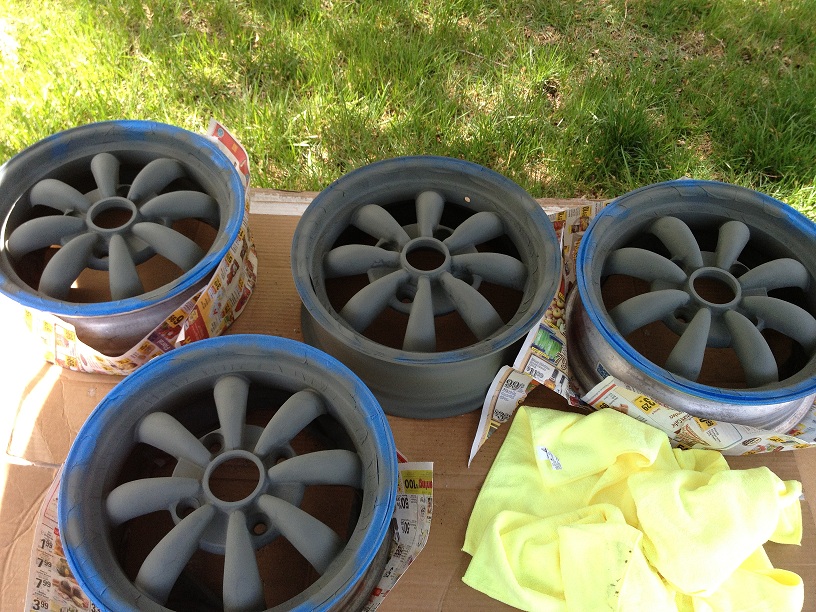

Rebuilt 901 last week, locked out first per Dr. Evil instructions then setup F N X Hf...aaawwww yeeeaaaahh!!!!

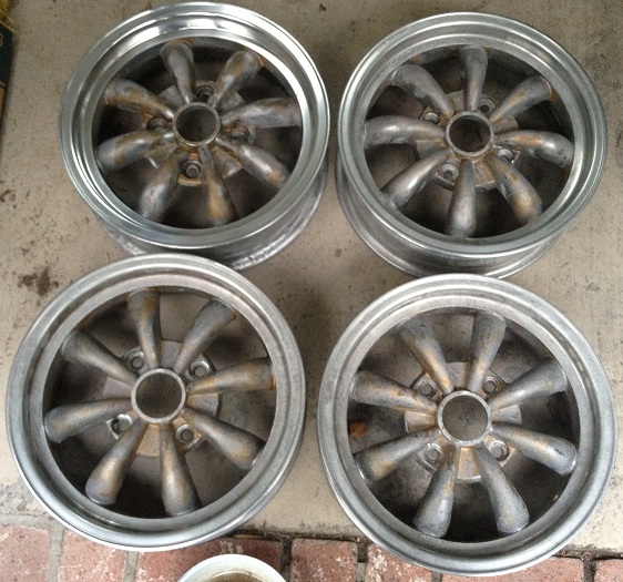

This week stripped my tired empi's

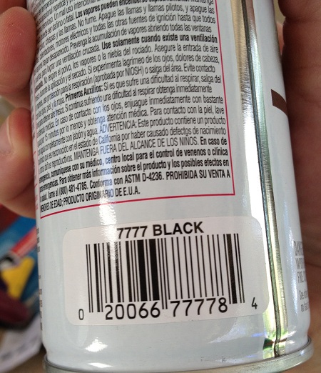

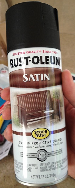

Primed 3 times to get that nasty rough surface semi-smooth then tonight going to shoot some satin black rustoleum 7777.
Attached ImageAttached Image
I'll sand and polish the lips this weekend.
Oh the elbow grease I'm gonna use up this week.

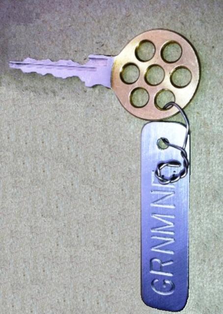

Made a dog tag

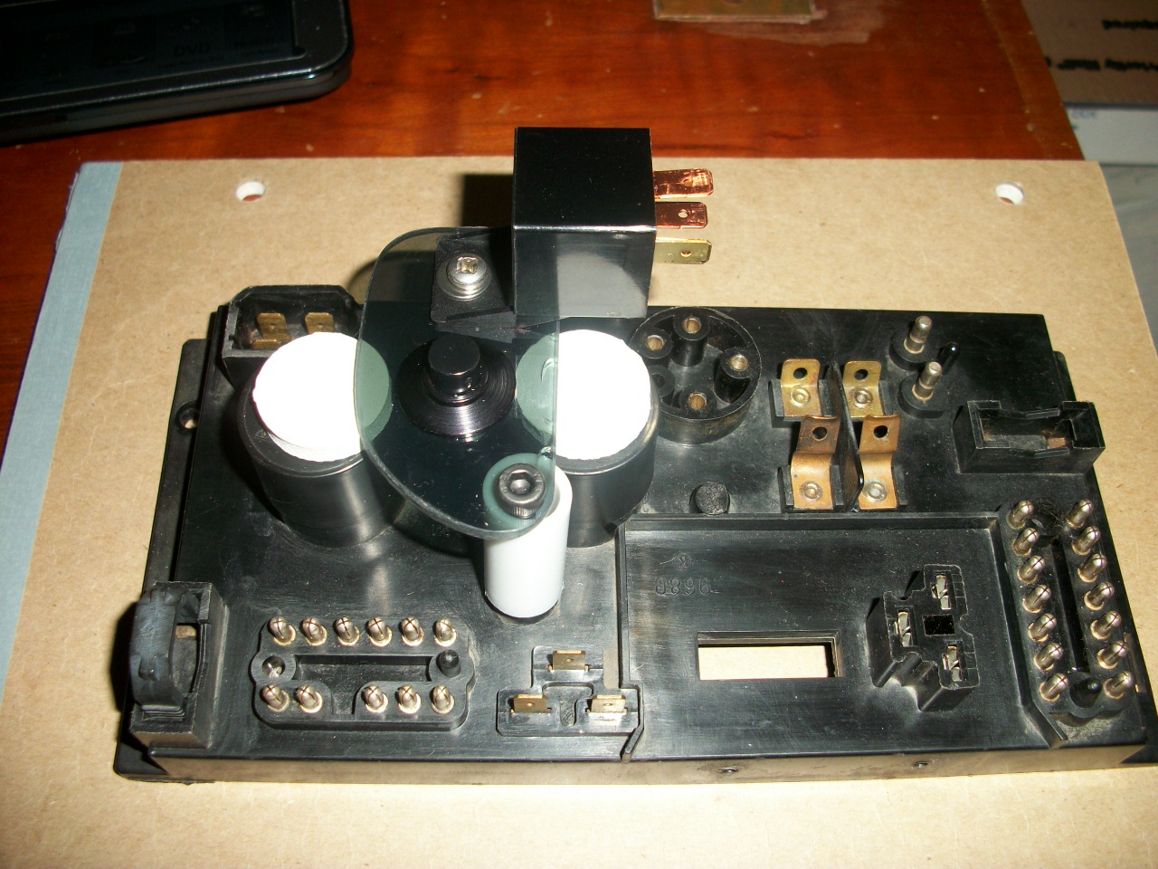

Worked on the second generation of my starter relay mod to fit under the cover of the relay panel. The push switch will allow bumping of the starter with the key switch off. Still have to draw the wiring diagram and install the wiring.

nice!

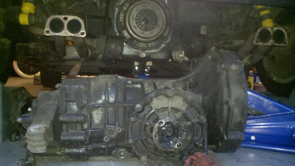

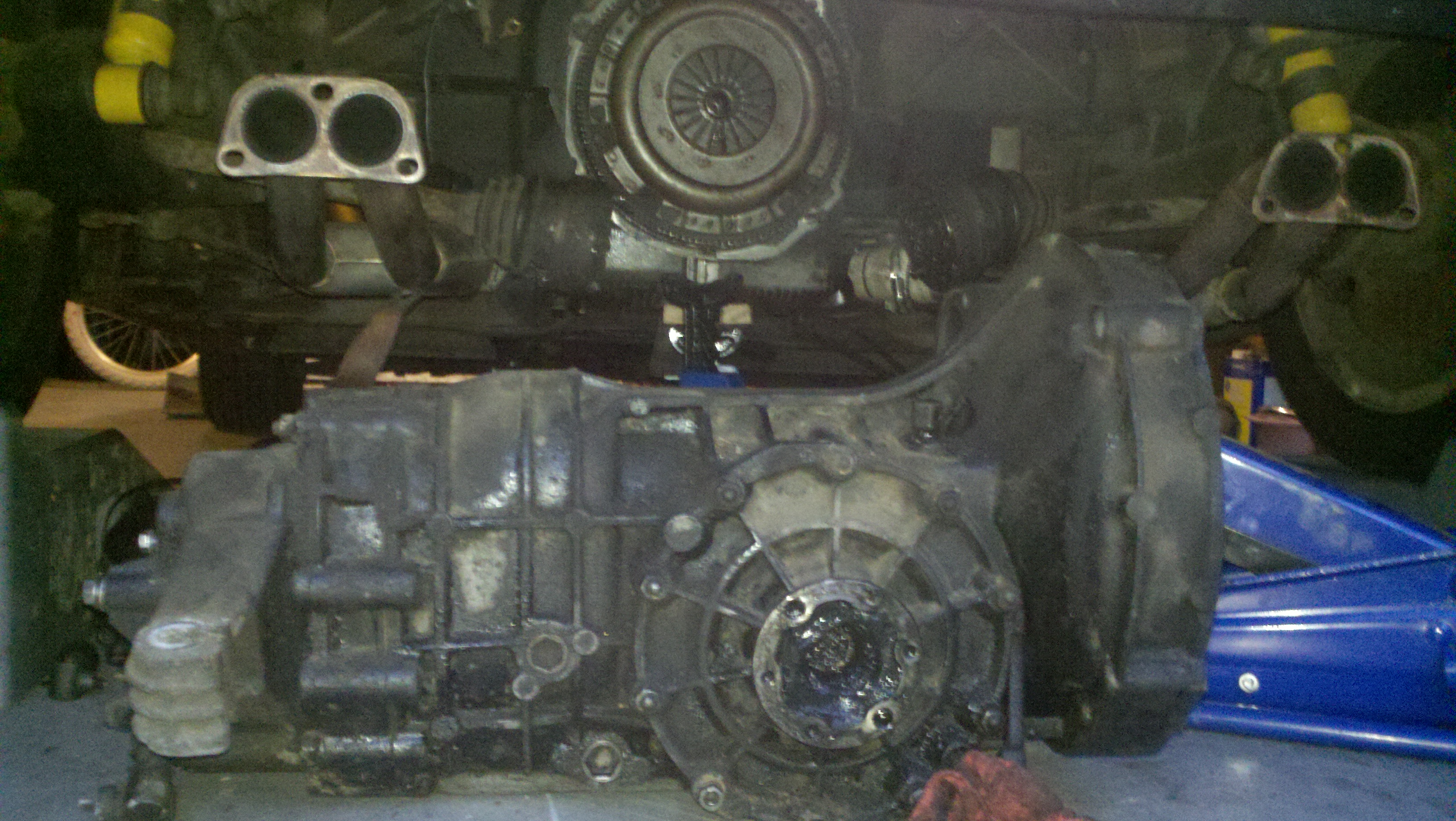

Pulled the transmission , taking it to the rebuild clinic next weekend in Richmond. Transmission mounts were really bad! Clutch looks good, but leek from rear main I believe. So "while I am in there" will include new shift bushings, seals etc.
