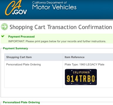

Ordered my Cal Legacy black plate.

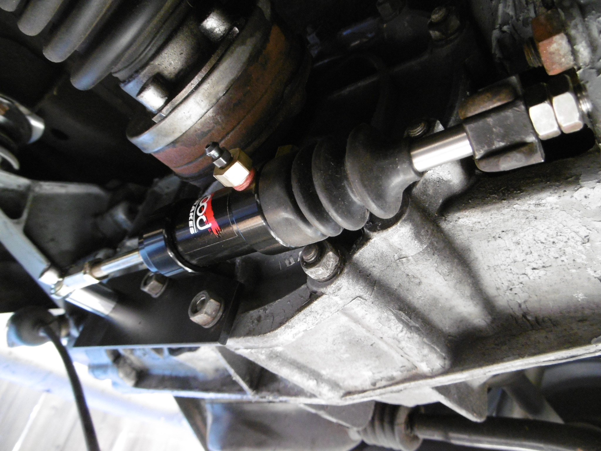

I got the bracket and Wilwood 260-1333 slave cylinder installed and adjusted on the 'BB'. I had to drill out the little block that pulls the throw-out bearing lever to fit the 5/16" shaft on the slave cylinder.
I'll have to hold off on the hydraulic hose & fittings until next week. I have to source some different AN fittings than what I had for the Honda M/C (IMG:style_emoticons/default/dry.gif)
Earl's Performance should have everything I'll need, and they're only a few miles from home ... but closed during the w/e.

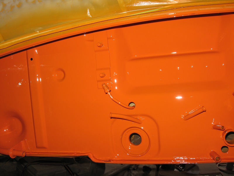

I sprayed my firewall (IMG:style_emoticons/default/smile.gif)
