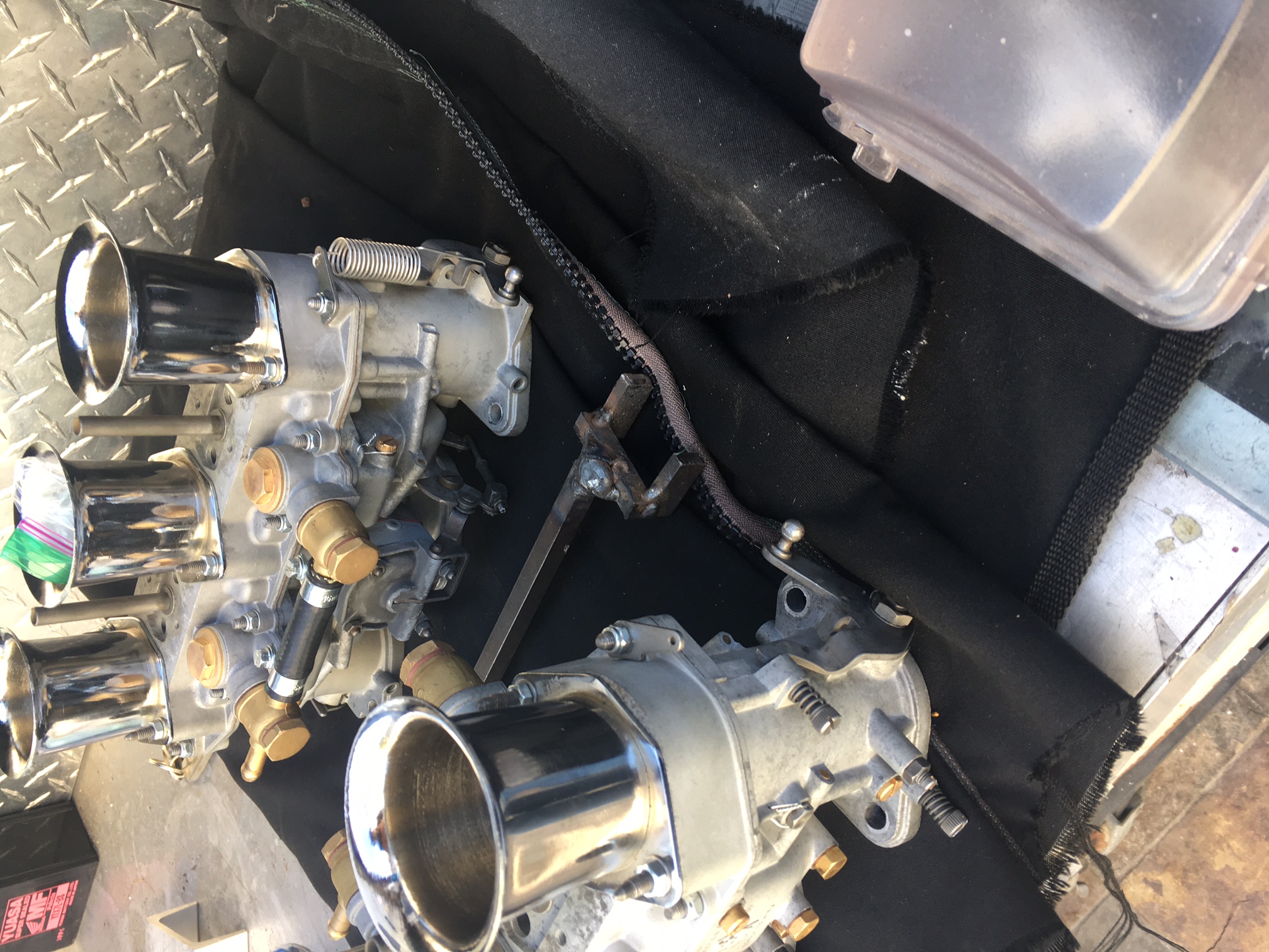

I started it. Listened to the roar at 4k (MSD rev limit until 1st 500 are under the belt, then shut it down. Instant and excellent oil pressure, Mocal opens up at 180 +/- and the front oil cooler leaks at the bolt on the toip due to lack of sufficient squashage on the washer.
Still awaiting some form of communication on the carb jets. I will find reamers tomorrow and fix the jets myself.
This puppy is ready for some varied breakin highway miles. (IMG:style_emoticons/default/piratenanner.gif)

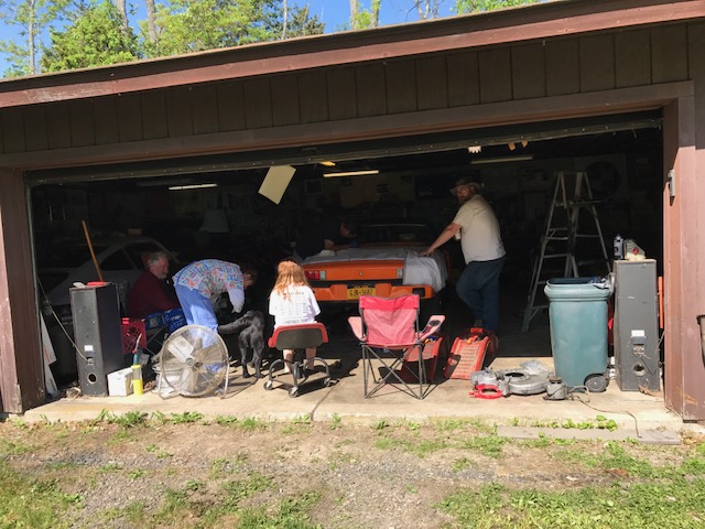

I used a 914 as a coffee table.
Spent the morning at injumort's with AndyB and Porschef watching him reinstall his heat exchangers.

Twins? Nice to see speaker aimed in and family involved..

Installed the correct idle jets for the Webers (65's vs. 55's) and the backfire and tail pipe issues are solved. Smooth and solid. The tach adaptor is now working too.
Tomorrow, once on the lift, a clutch adjustment and fine tune of the shift linkage / then put some miles on it. (IMG:style_emoticons/default/aktion035.gif) (IMG:style_emoticons/default/piratenanner.gif)

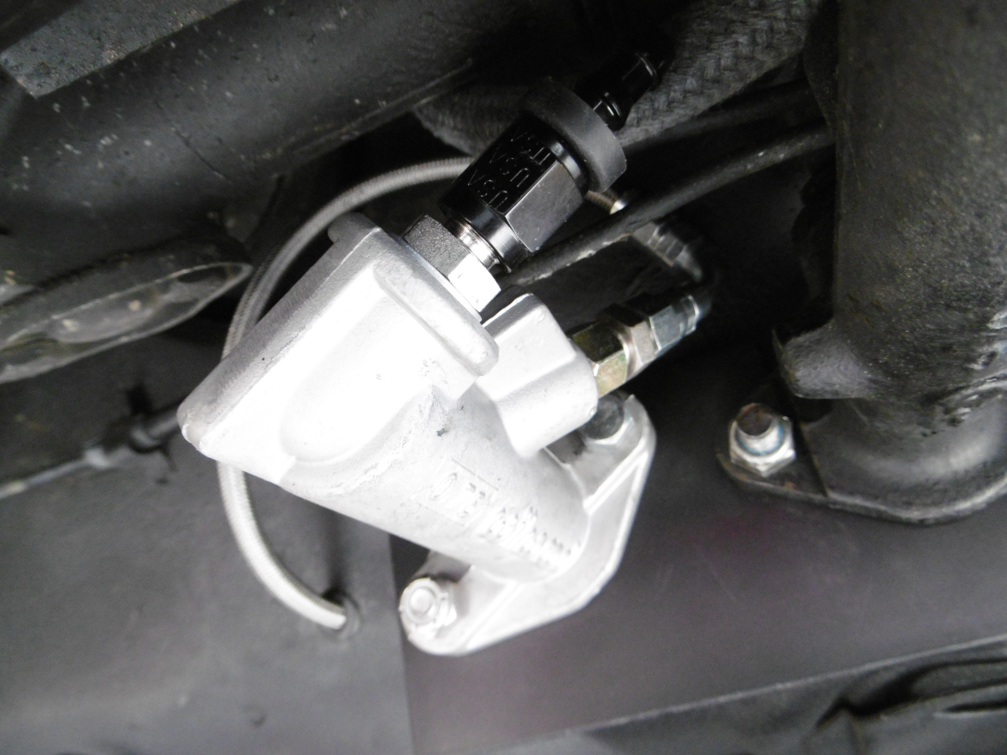

I'm stalled again ... the brake M/C supply line grommets are leaking, and there's less room to fiddle with them now that the clutch M/C takes up the adjacent hand space (IMG:style_emoticons/default/dry.gif)
Not sure how, or how long this setback is going to take to correct (IMG:style_emoticons/default/confused24.gif)
I think I'll have to uninstall the clutch M/C and move it to the side to allow me to replace the grommets and seat the hoses. Fuch (IMG:style_emoticons/default/mad.gif)

Finally sorted out the Webers on the six after a thorough ultrasonic cleaning and reassembly with 65 verses 55 idle jets - the engine was starving with the 55's but not so now....
When they work, they work really smooth and very ferocious compared to four-sound i was used to.
I also installed the air filter plates, gaskets, filters and powder coated rain hats. I now have to figure out the clutch adjustment issues I am having / or is it the new shift rod alignment???
