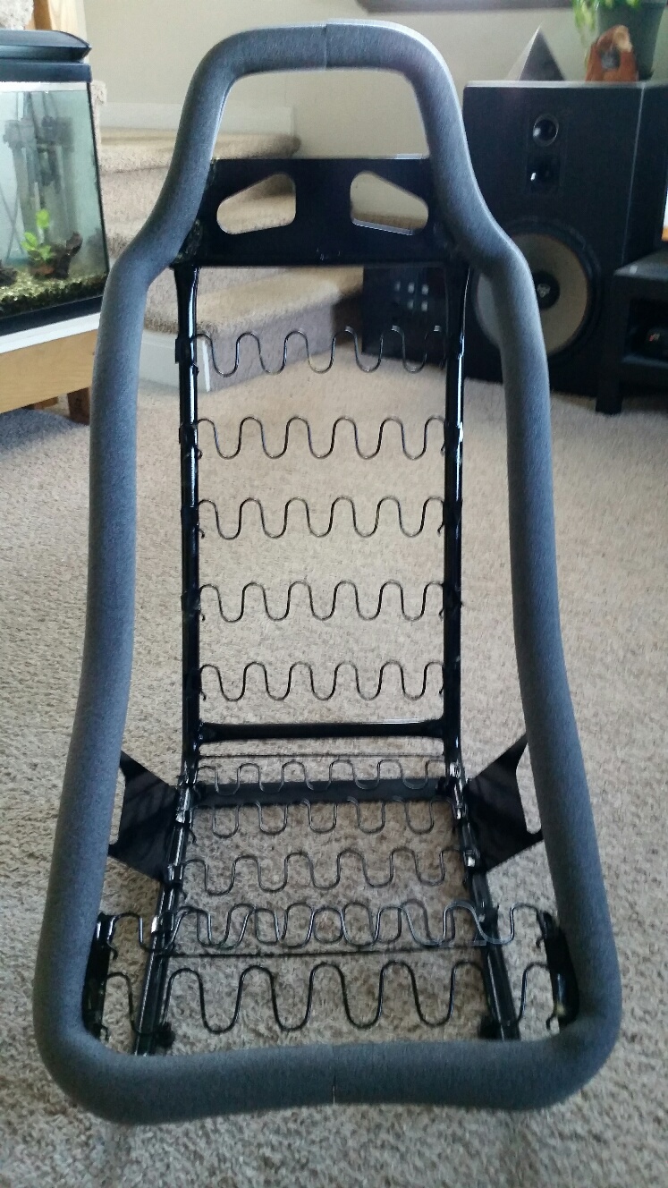

I fiddled with getting my Scheel seats to glide in the tracks today. I also drilled out & ditched those pesky "safety" tabs that are hard to pry up while you try to slide a set of 914 seats out of their tracks. After a few ins and outs, the seats didn't want to cooperate and slide, so I decided to put washers in between the seat tracks and the really thick vinyl at the bottom of these seats.
Voila!! That was the trick!!! *shimming reference
Now they are as easy as a downtown hooker at midnight. (IMG:style_emoticons/default/sheeplove.gif)

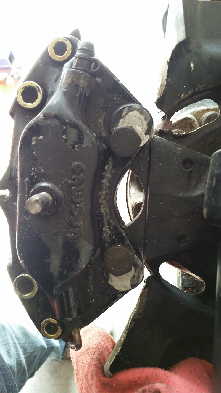

Did some unmentionable experiments with the Brembos... they now fit 3 inch caliper ears on the struts.
Also pulled my seat covers for a good washing. Got inventive with some new foam from the local upholsterers - turned out pretty nice and just in time to sit in and watch F1!

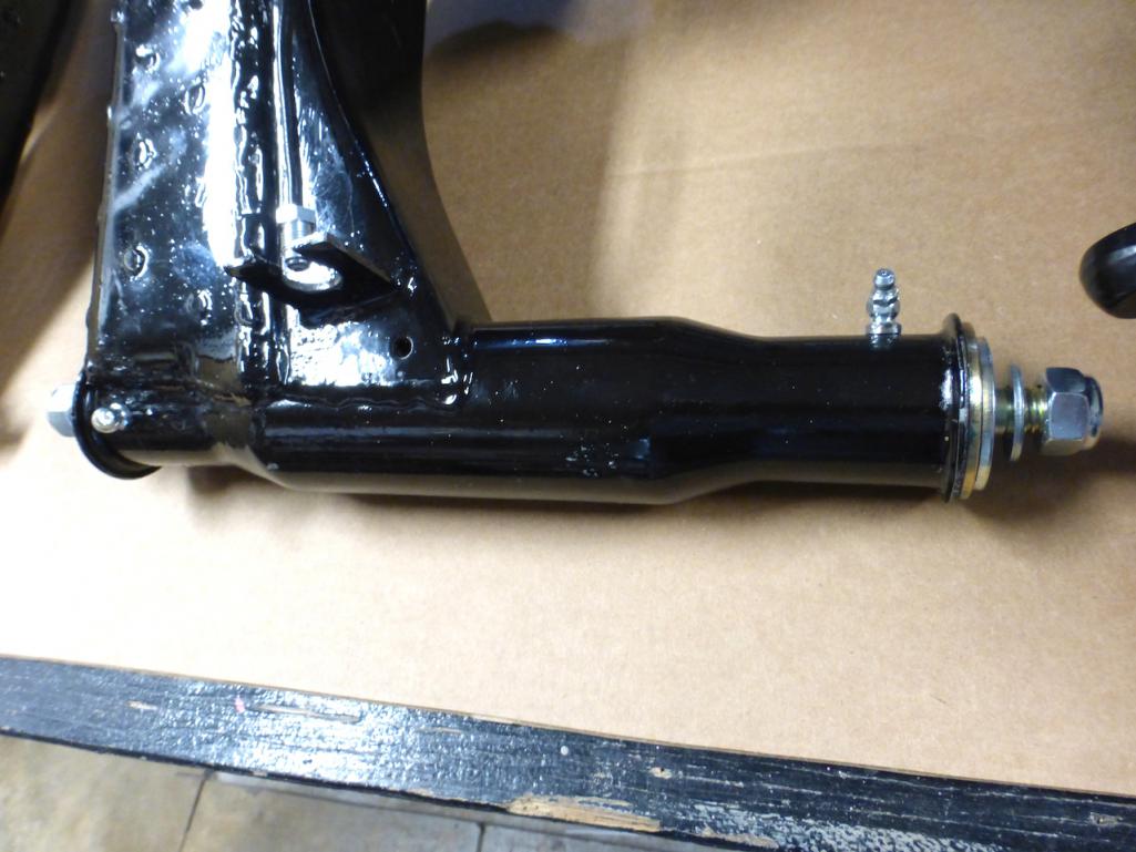

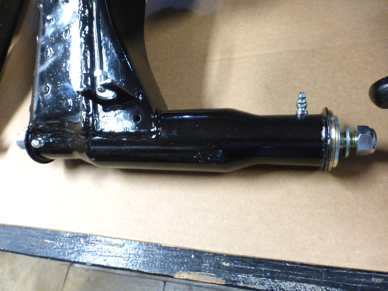

New Elephant Racing Poly-Bronz bushing.....WOW, some really nice hardware. MarkAttached ImageAttached Image
Lookin good!!! I bought a single GTS Lemans seat a while back.. Same problem. I had to shim it or the springs caught on the cross rails. PIA.....

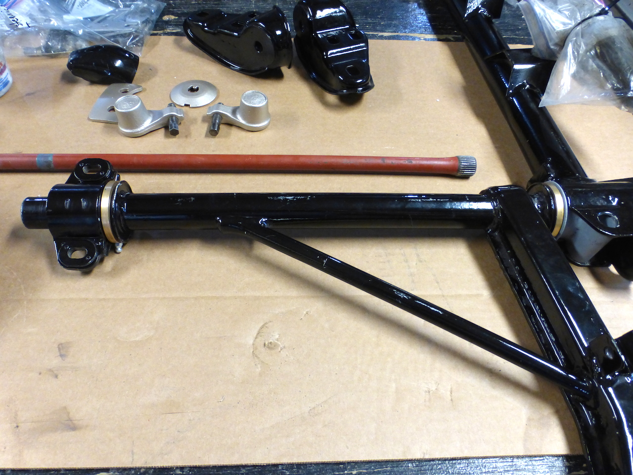

Curious is there a big difference on how it feels while driving?

I hadn't heard the bolt was already shimmed. I have some extra good T/O arms, but looks like the dime bag did the trick. I'll have to remember that trick (IMG:style_emoticons/default/wink.gif)
Glad to hear it's finally on the road, Forrest (IMG:style_emoticons/default/aktion035.gif)
Question ... Did you guys use NEW schnoor washers on the CVs every time you reinstallted the tranny?
Thanks Mark. We just noticed there was already a shim there when we took it apart yesterday. Yep good advice on the Schnoor washers. We just buttoned it up to get it drive-able. The rest is just cleanup and tweaking while he drives it. (IMG:style_emoticons/default/driving.gif) Looking good and sounds awesome!!

Member No.: 13,770
Steve, car has been apart for 30 years and not on the road yet...so lets say it a big difference in handling. But going together one nut/bolt at a time. Best, Mark
