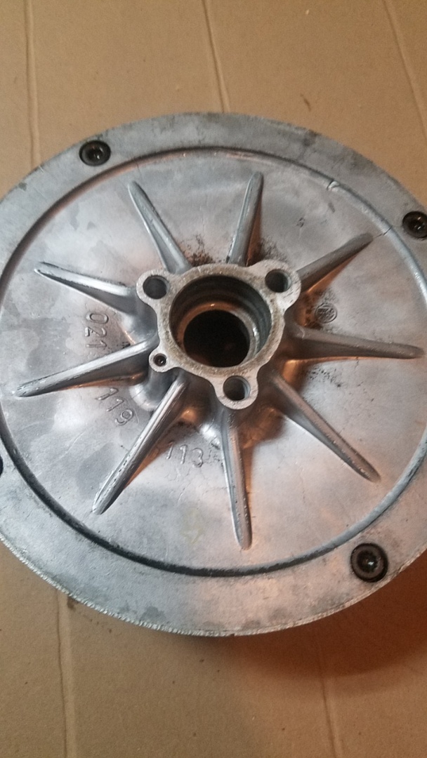

Bought a media blaster kit to hook up to my pressure washer....
I am using baking soda for the media.... 1st test and it works pretty darn good, just messy (more so the water spraying back at me ) I'll have to fix that!
There was a lot more build up between the webs before I gave it a blast. Just plain water out of the gun didn't do squat.

Looks good, Mike. Which pressure washer and blaster kit did you get?

At 1st it didn't suck up the soda very well, once I added some tape to the where the water wand hooks up to, it made a huge improvement since it works on venturi principle
Cheap Lowes gas pressure washer, 2600psi and 2.6gpm.
MTM Hydro 16.0117 5000 psi Industrial Sand Blast Kit from Amazon

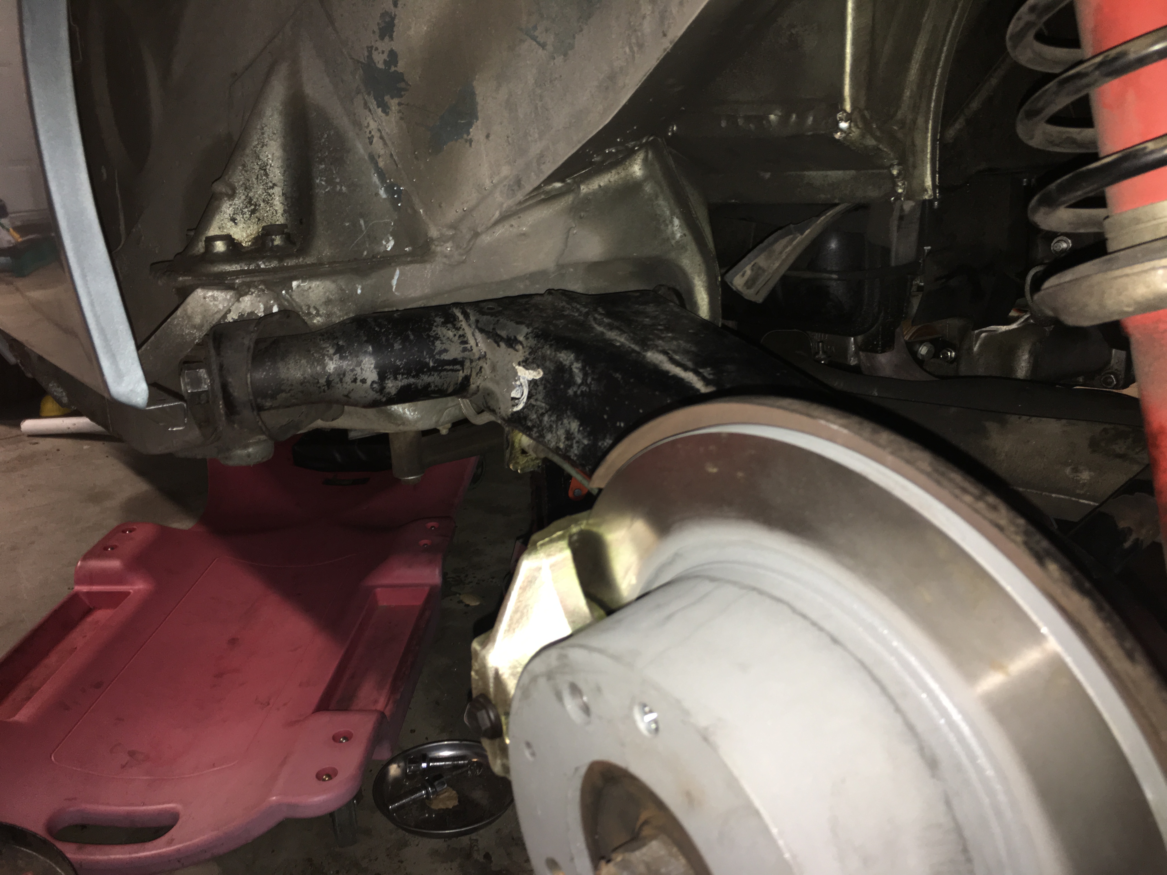

Finally replaced the rear trailing arms, rear calipers, and rotors. Now I just need to bleed the brakes and then drive it again.

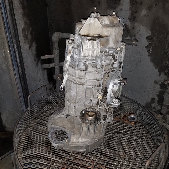

Cleaned your side shifter today ..............

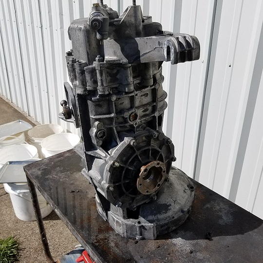

As long as I was cleaning Mike's (Warpig) gearbox and the jet washer was fired up, I started washing Mark's (Mikey914) gearbox too. It will need a little screwdriver work before it gets another wash.

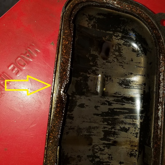

My 73 Appearance Group daily driver sprang a leak Saturday night................. (IMG:style_emoticons/default/mad.gif)
So I jacked her up and popped off the right valve cover. Hmmm.
It started at WCR, but wasn't enough for me to locate. It's interesting that my misalignment took 4000 miles to start leaking.

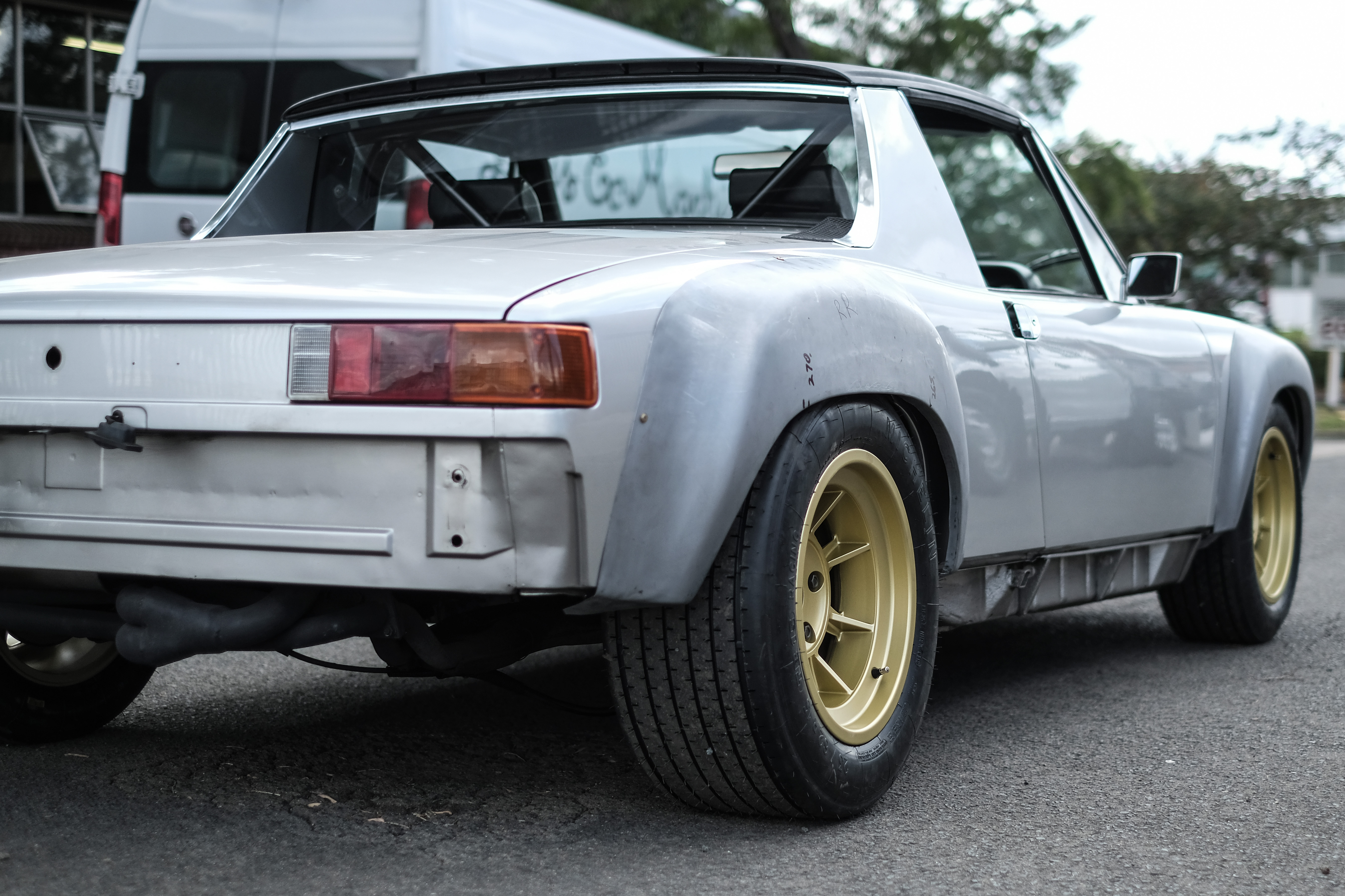

My GT build coming along with flares getting lined up with wheels and tyres on.

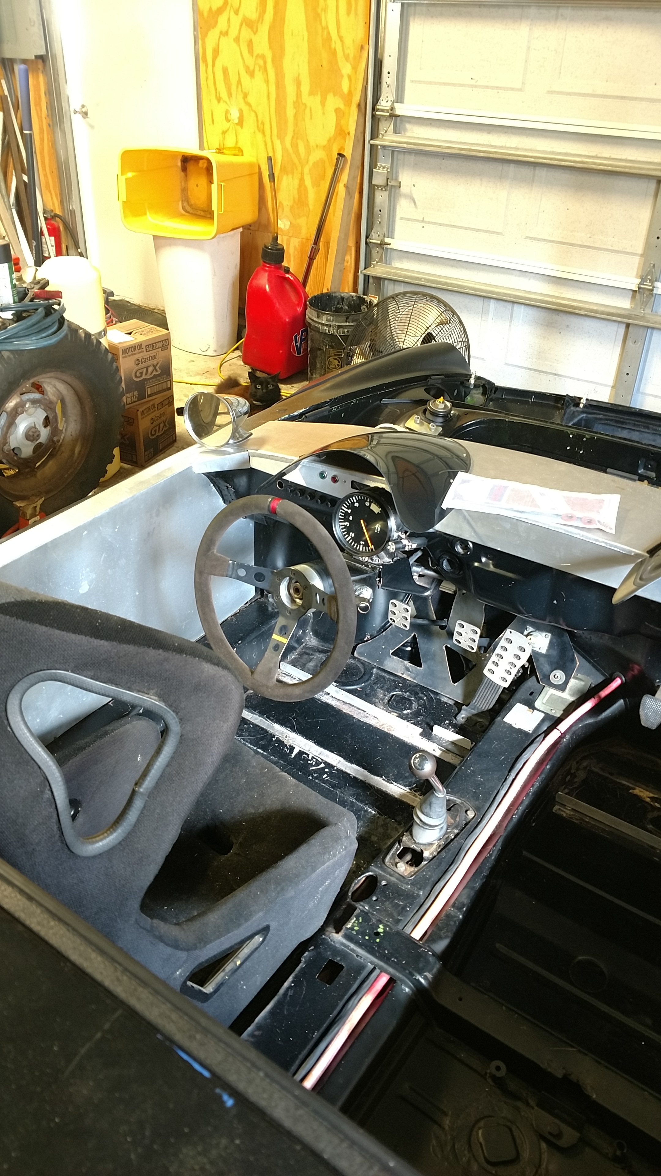

Took pictures.
