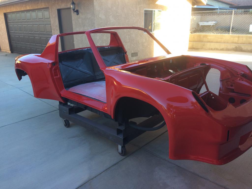

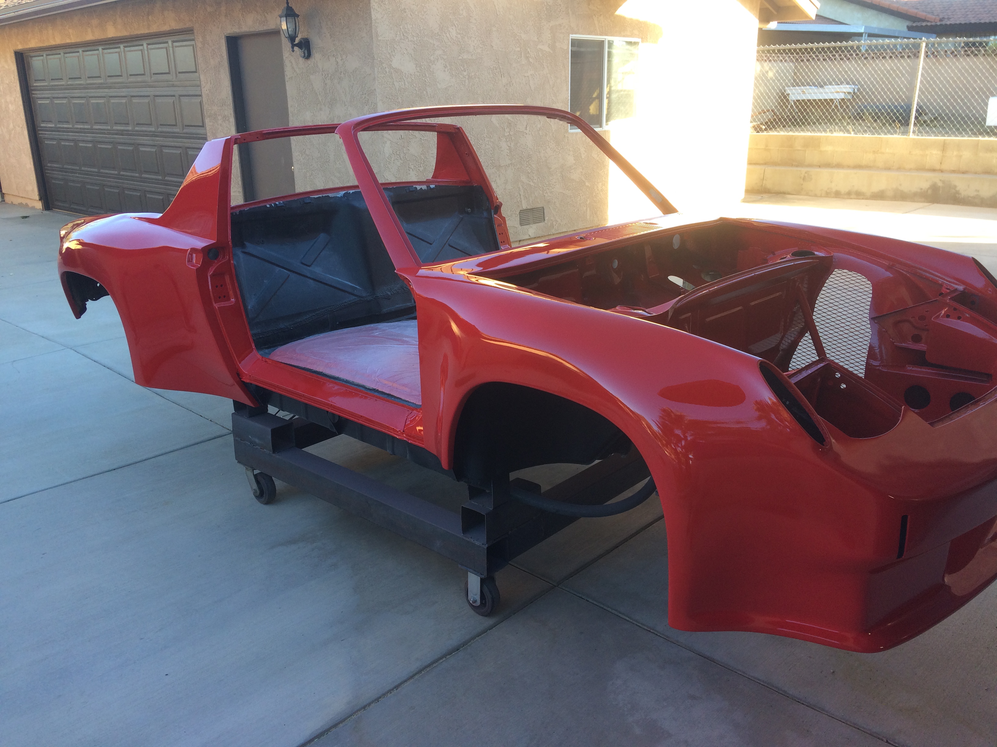

Alright, I technically did this yesterday... but took the picture today (IMG:style_emoticons/default/smile.gif) Finished painting the body and I am really happy with the results. One step closer to getting on the road.

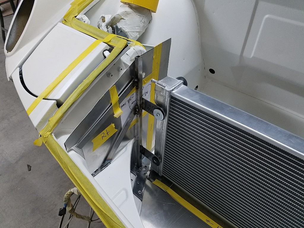

Worked on some radiator shrouding for my Subie conversion.Attached Image

Would it work to tilt the radiator forwards to get a more space efficient packaging?

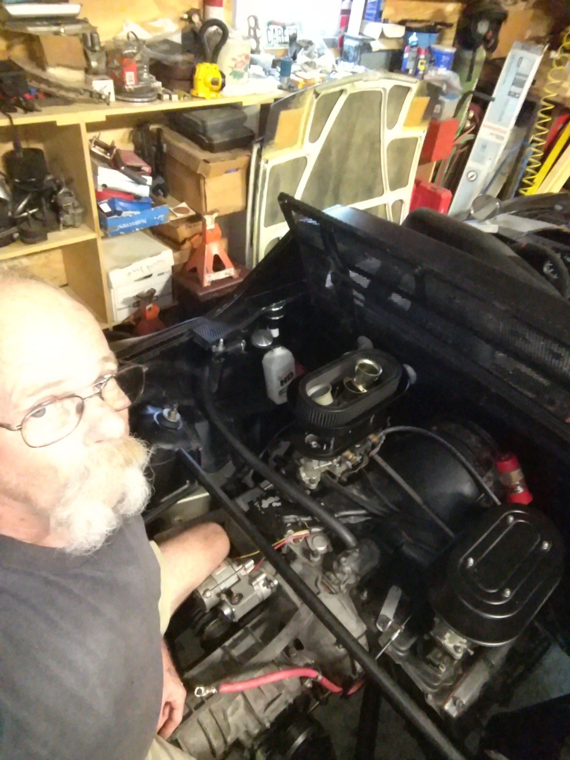

Took my first selfie today. That must be BEER...
Sitting in the engine bay.

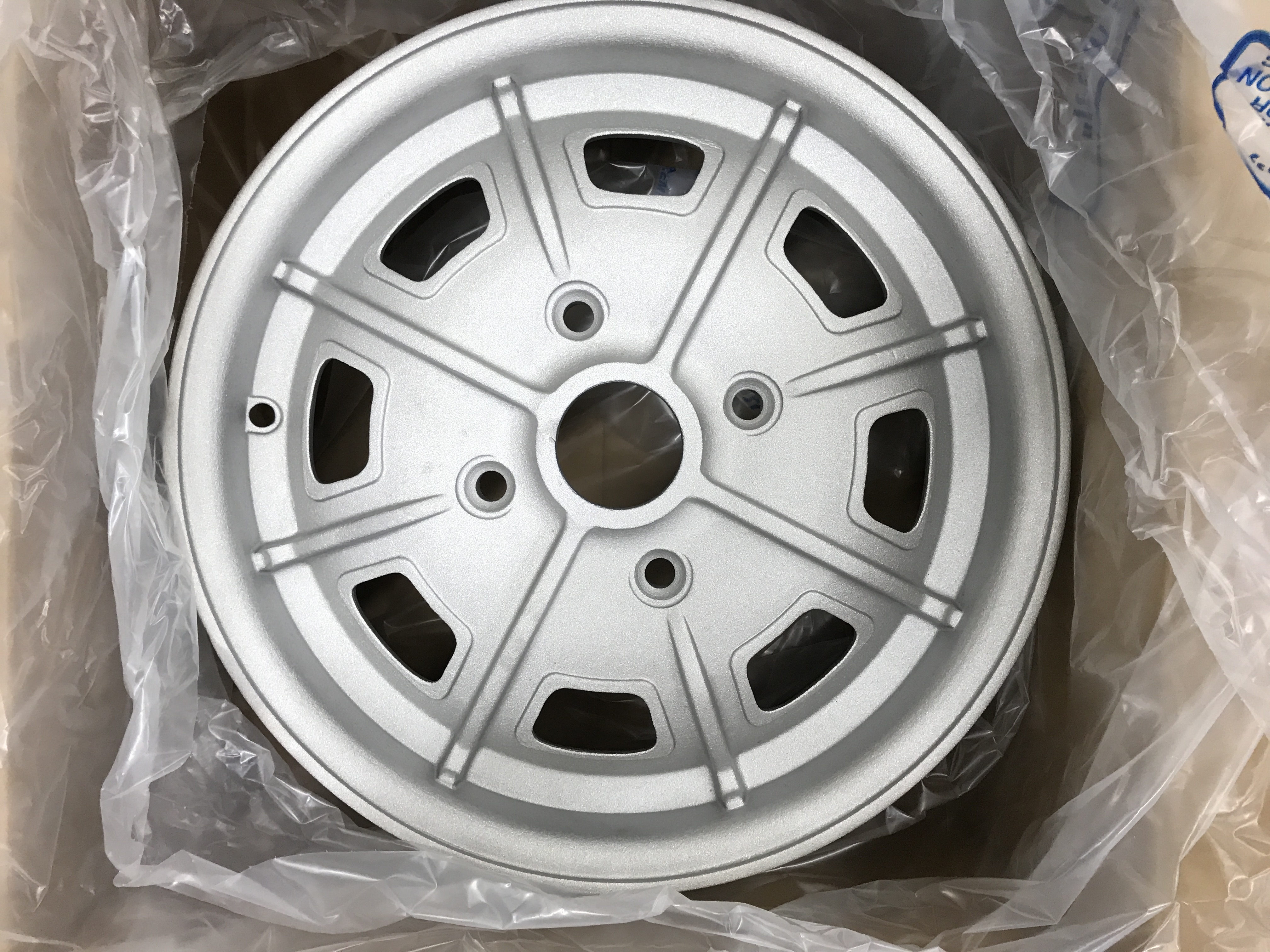

Pull the wheels out of the boxes that I’ve been saving for decades. Time to mount.

Nice looking. Can't tell from your pic; is the weight of the radiator supported beneath or by those 4 bolts from the frame to the fan shroud attach points? (IMG:style_emoticons/default/beerchug.gif)

That was considered and yes it would. Putting AC in the car so need room for condenser and dryer still so decided vertical. Fabrication of mounting system/servicing all influenced my decision.

Thanks. The radiator rests into two rubber grommets that support the weight of the radiator from below and provide vibration dampening. Similar to an OEM set up on newer cars. In addition there are the four bolts you noted above (also with grommets) holding it in its upright position to the frame. Pretty stout setup. I will be adding a AC condenser to the frame similarly but no bottom anchor next and finish shrouding.

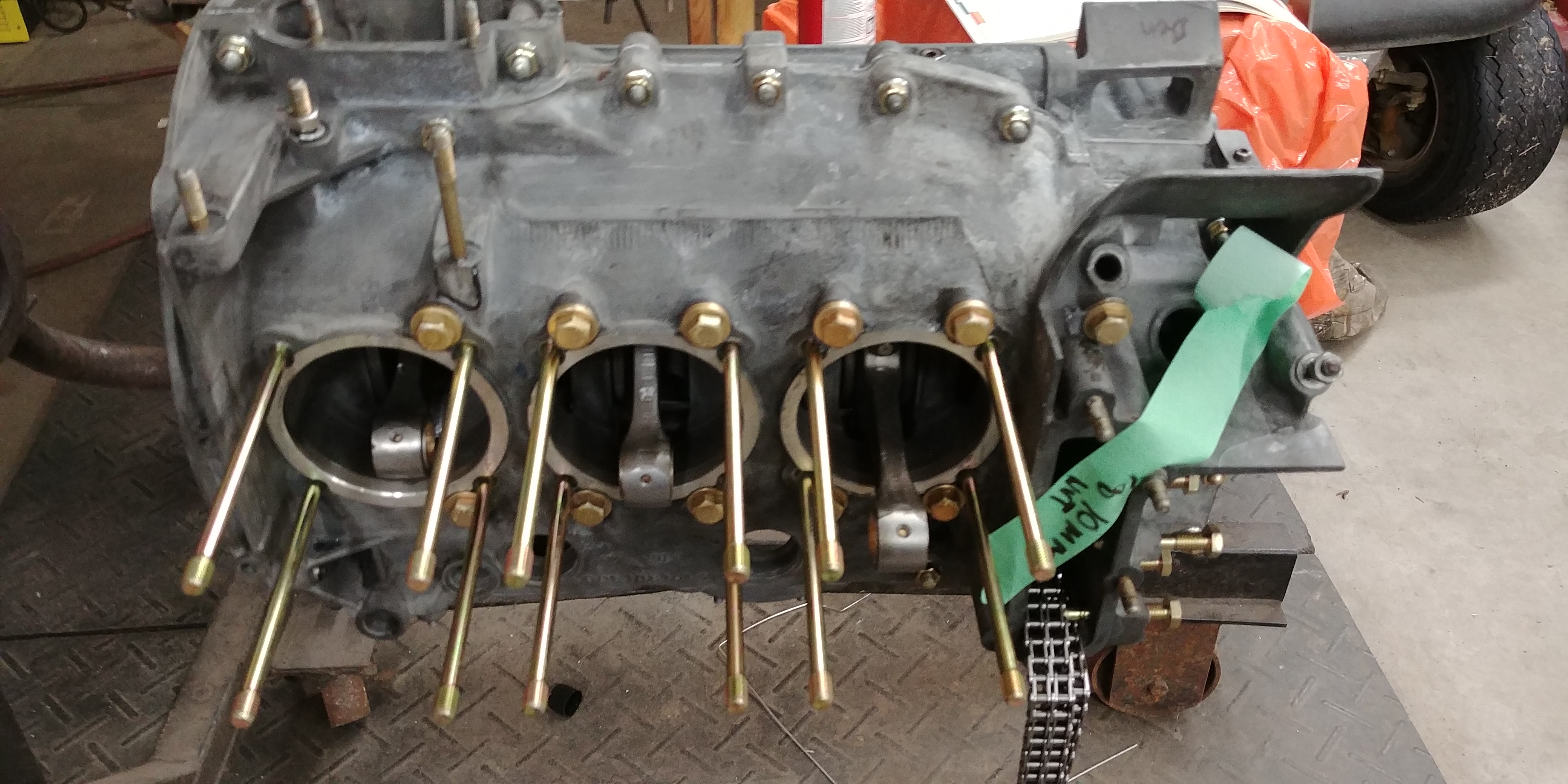

Started assembly of the 6.Attached Image

Yes, I can see the grommets since you pointed out. You'll love the AC. (IMG:style_emoticons/default/beerchug.gif)

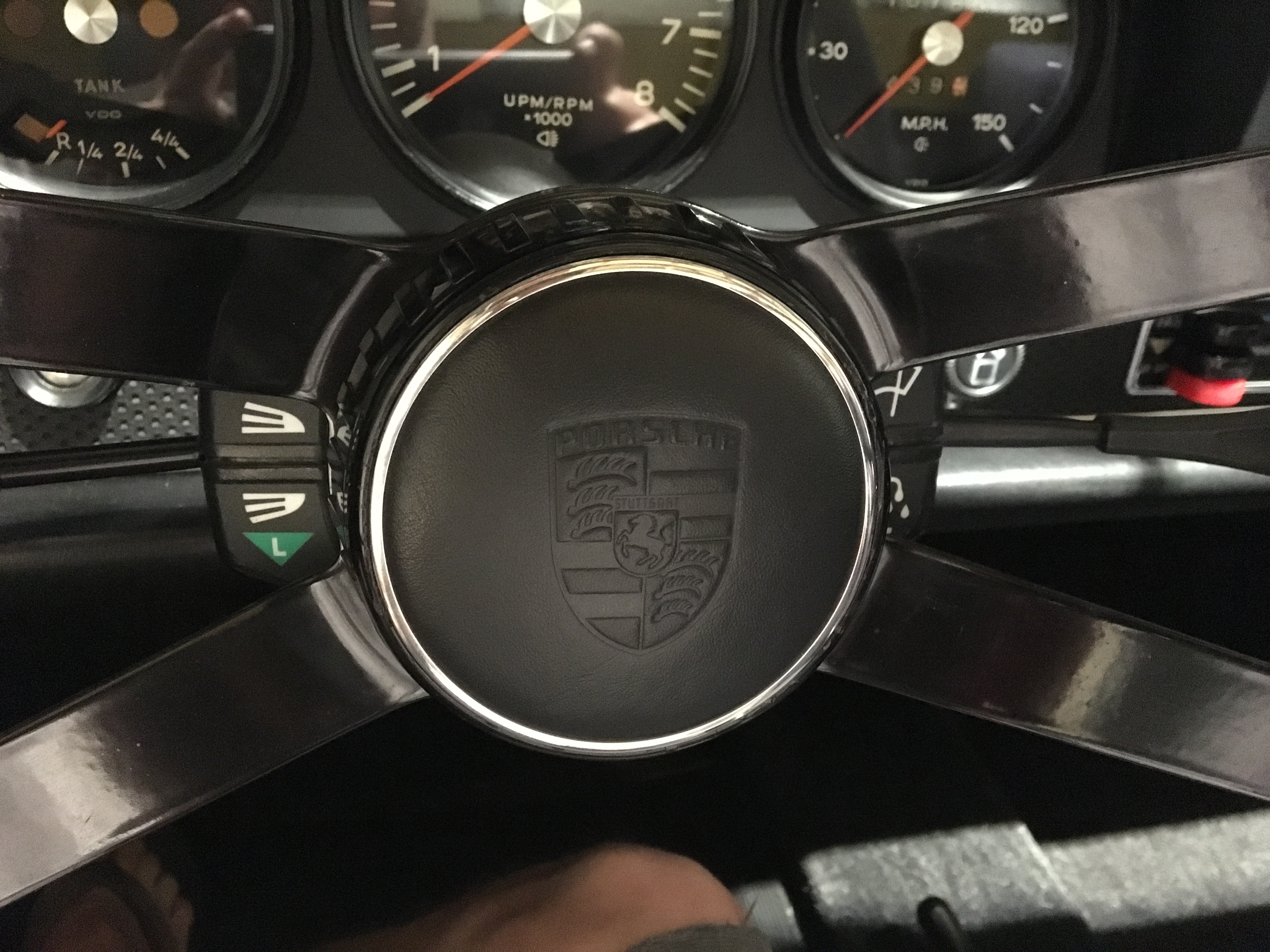

Got a chance to finish my hockey puck and use it (IMG:style_emoticons/default/driving.gif)
