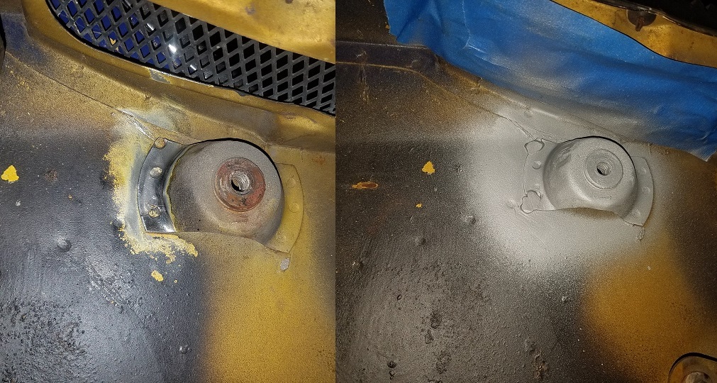

Swapped front right fender and fixed cowl rust. [attachmentid=635
725]
Nice work sir Mark!

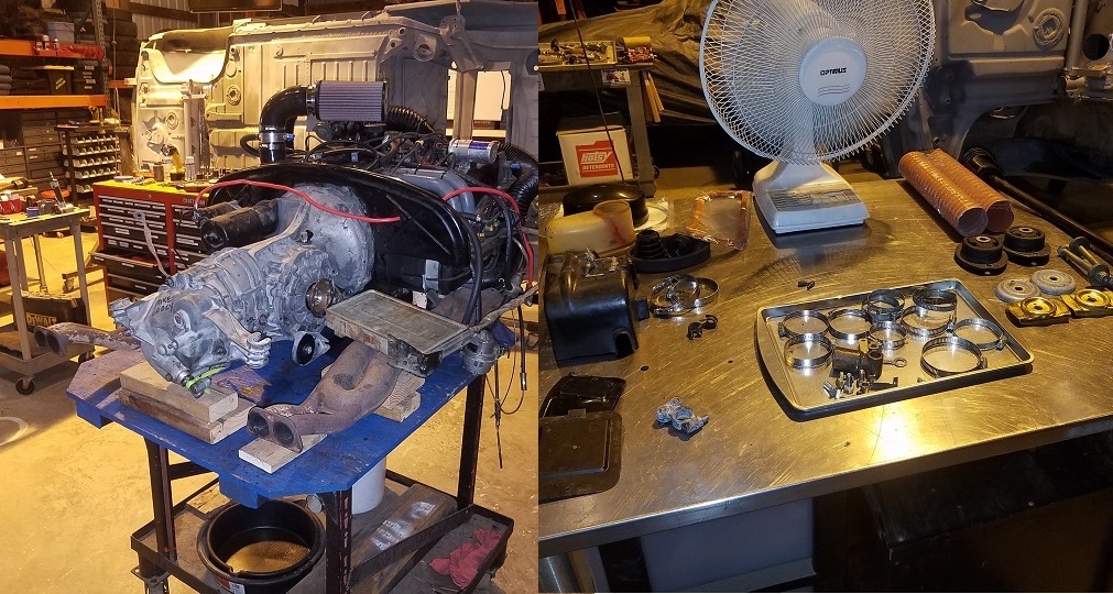

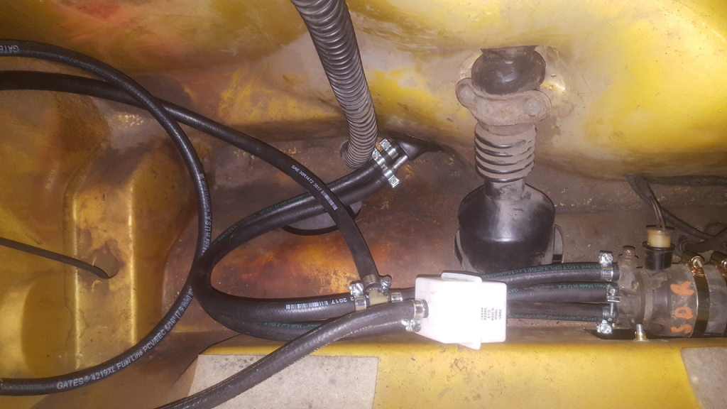

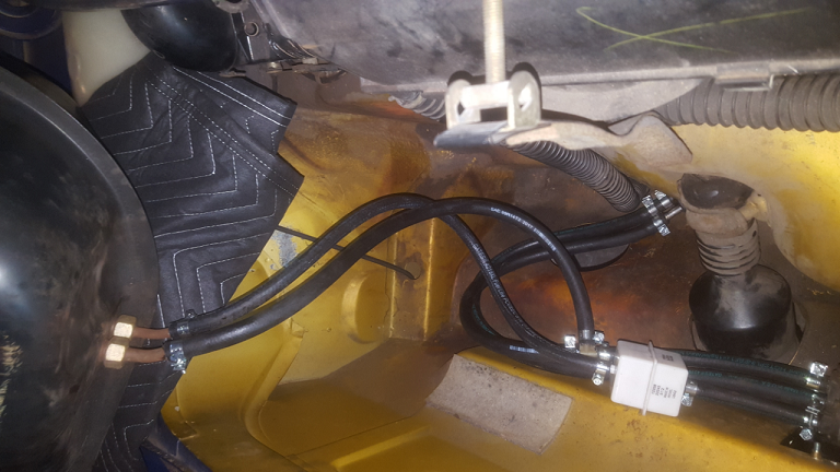

Mike and I are finishing up the refresh on his new blue car.
New SS fuel lines, fresh hoses and another fuel pump relocate.
Hoses long enough to remove pump and fuel filter from the tire wheel.
Tank hoses long enough to pull the tank out .................

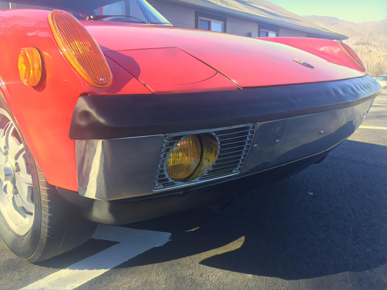

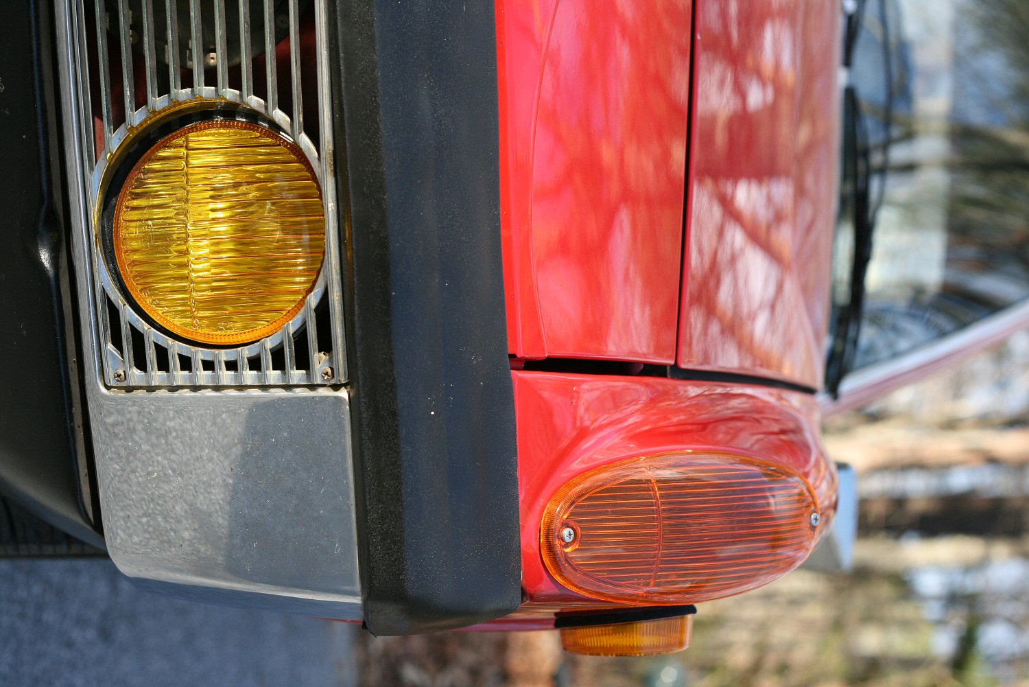

Replaced my fog light lens on my 914. The original ones were 45 years old, frosty, and pitted. I replaced them with European amber lens. The lens are glass and look like fine crystal. They were a pain in the ass to replace too. Got them from 914Rubber.com The end result is pretty neat. (I downloaded the picture correctly but it is sideways. If you click on the picture, it ups loads on another page and it correct! Gremlins!)

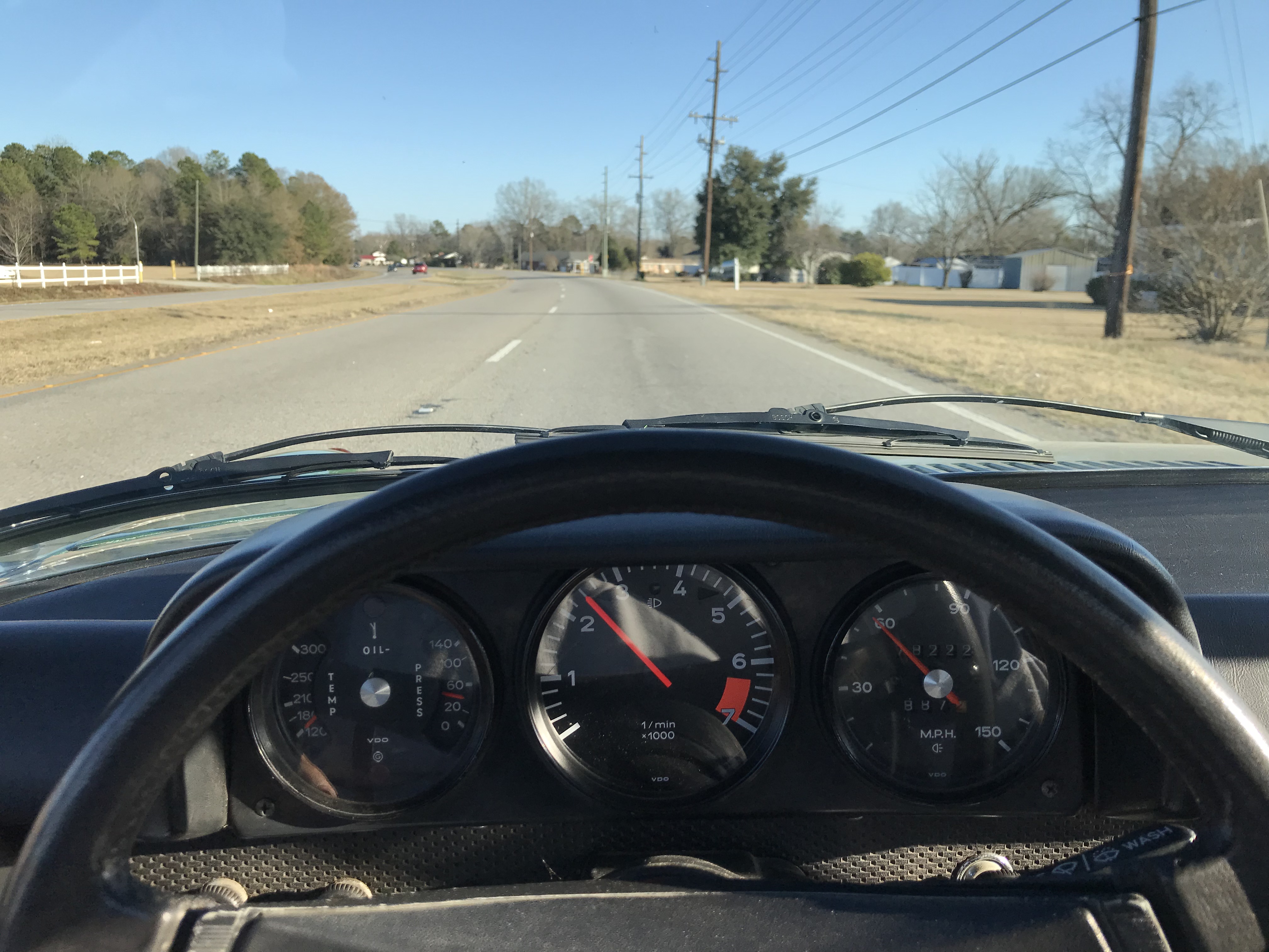

Drove it for the first time in a couple months. Getting ready to replace the transmission with one I got from Dr. Evil so I figured I better take her out and shake off the cobwebs

is that the green /6? good to see it out on the road again. now get that new transmission in there!

Yep....the Irish Green '72 with the 2.7. I'm going to pull the old transmission in the next couple of weeks.

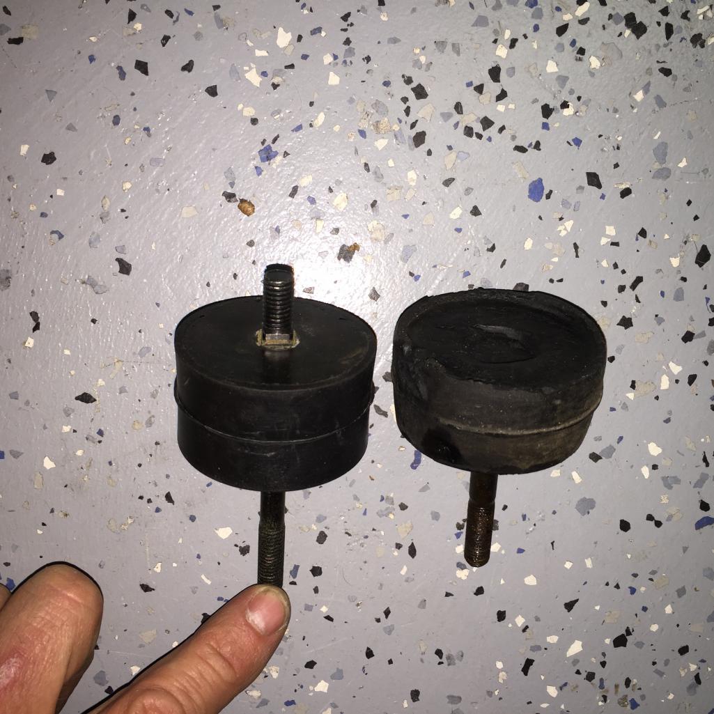

well i guess i need new motor mounts, anyone see this before? sheered off , - new one next to my old one

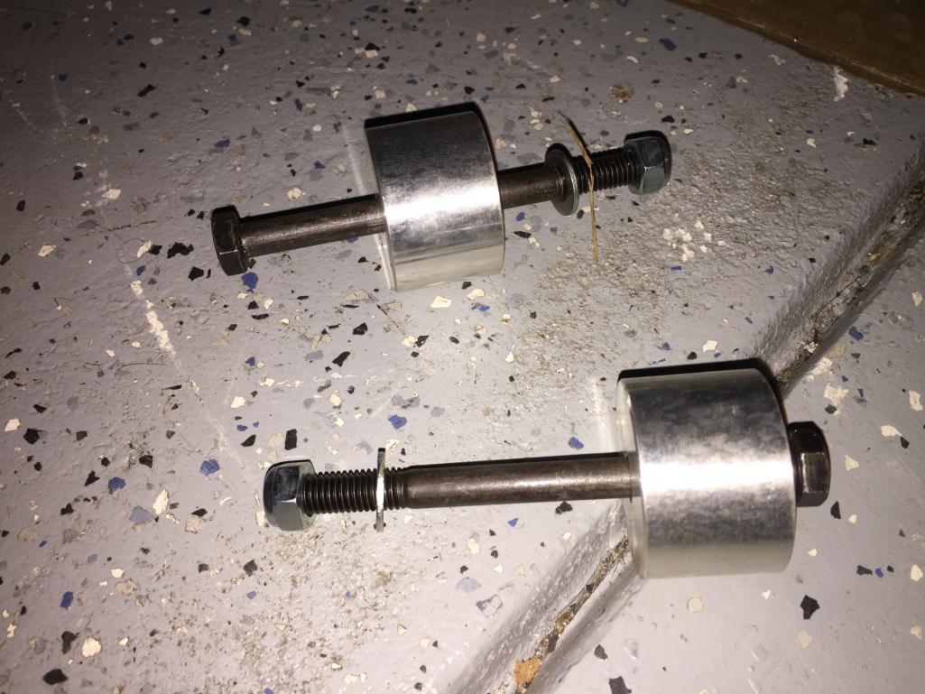

anyone used these solid mounts?

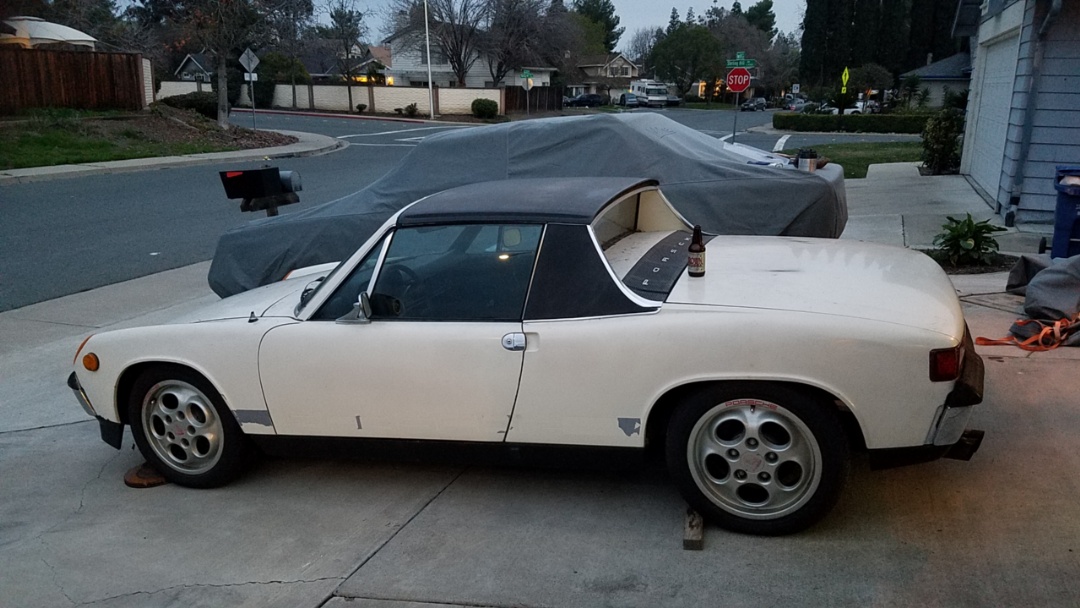

Moved my 914 from across the street to my own driveway, it has only been there for a year and half.

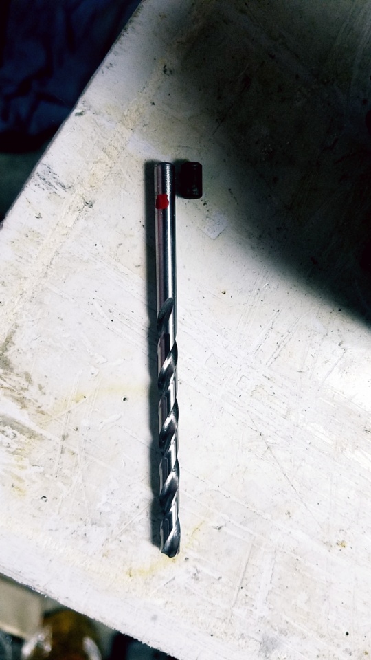

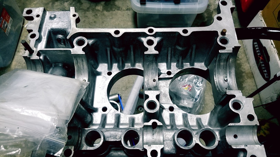

I saved .75 cents and made my own dowel pin for my 1.8 build from a HSS drill bit (IMG:style_emoticons/default/smile.gif)

Fuel gauge?

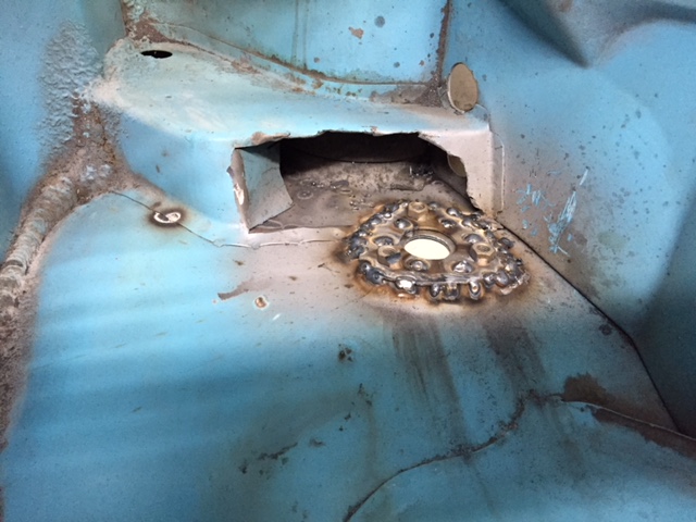

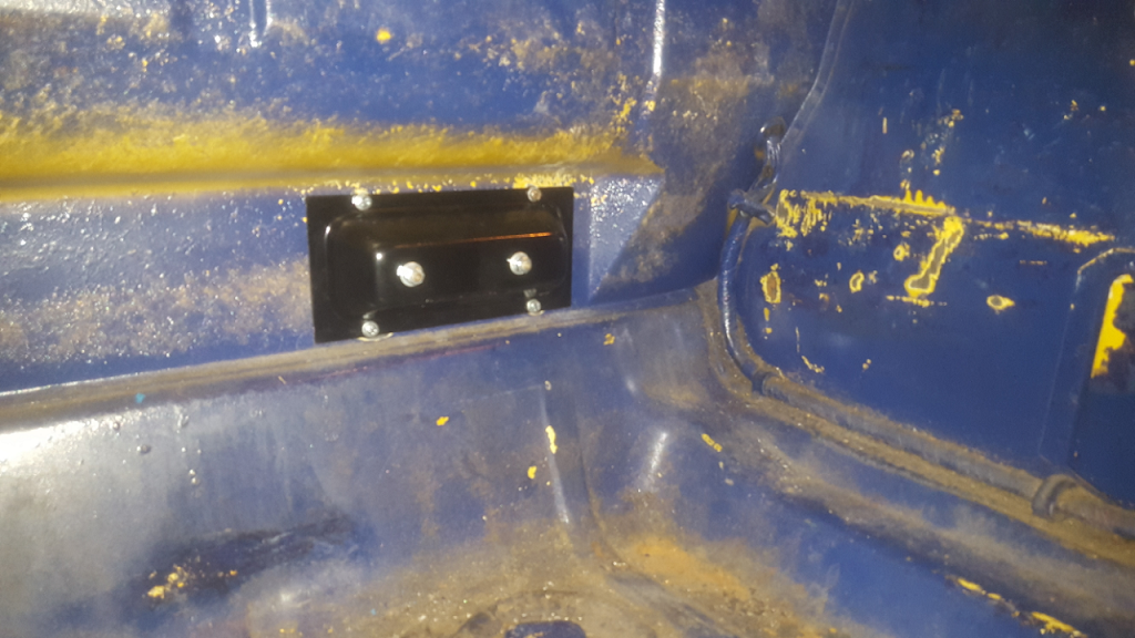

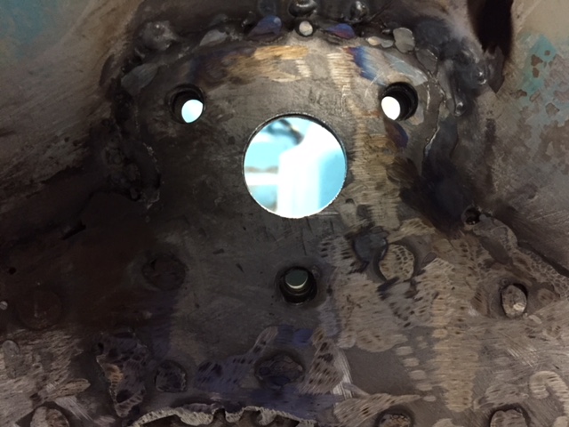

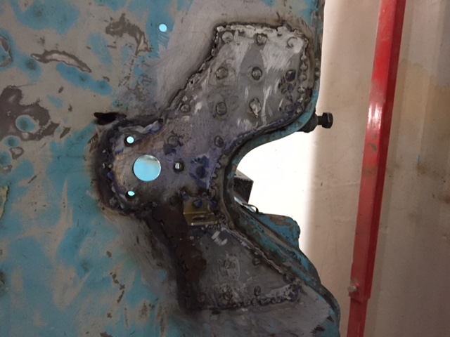

Overkill as I almost always do. Putting in the over the top front sway bar. 914 sway bar reinforcement from Maddog in the fender well and inside unit from Tangerine racing.
Eric said I needed one but if one is good, my mind says 2. I welded in the 2 parts and had to weld on a new brake line bracket, as the MadDog set up requires removing the factory one. . Had to drill 3 holes and a big 1.25-inch hole for the bar. Lots of grinding for me.

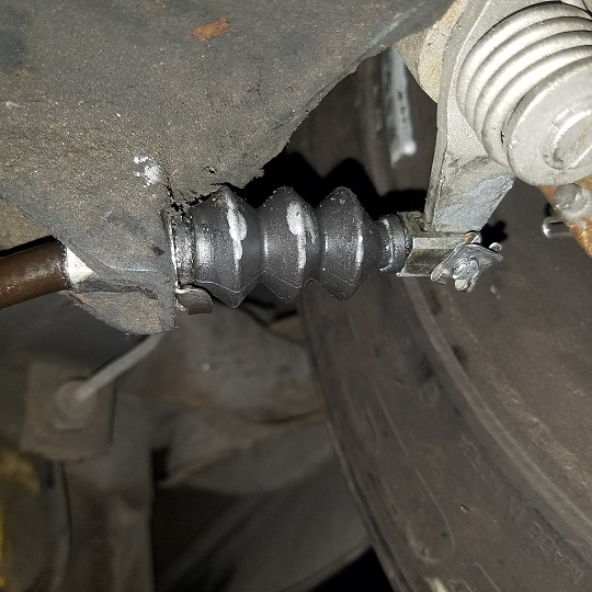

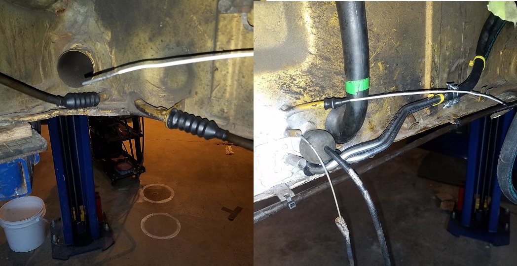

Freshened up Mike's parking brake boots and cleaned and anti-seized pin and keeper.
Did a little tune up on the console heat temp lever and replaced the cable and installed new seals.
Attached Image There's a good shot of Mike's new SS fuel lines.

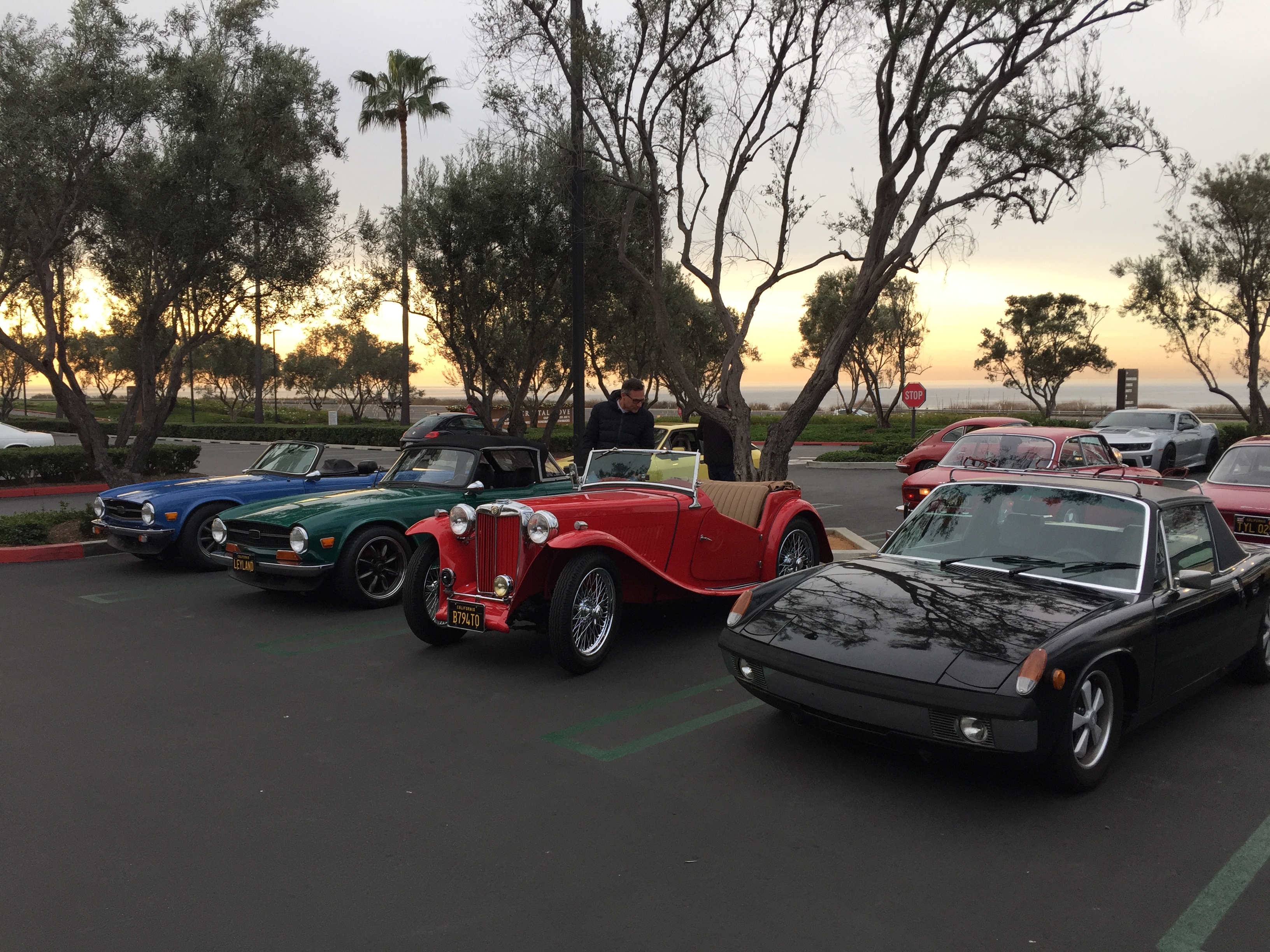

I've been doing little tweaks, just enjoying the heck out of a nice running 914 with a 2.4S motor.
Cars and coffee, errands, and going to get groceries for the little woman.

In the console

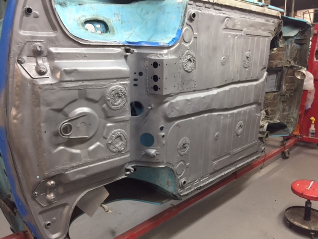

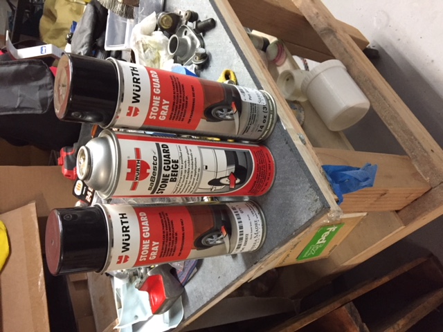

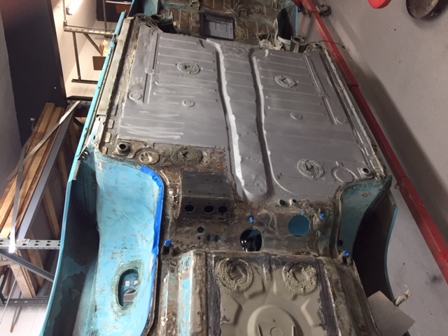

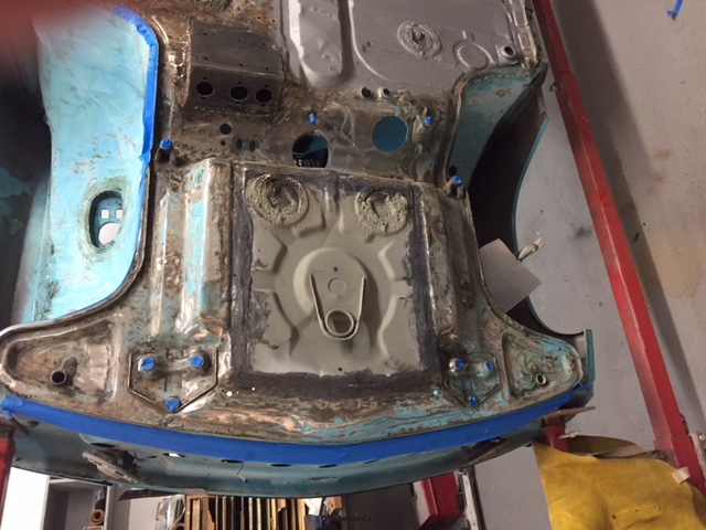

Working on the bottom of my V8 car. Cleaning up bottom and spraying Wurth underbody spray. It takes a lot of cans as it does not go that far but doing this work on my rotisserie and my ventilated shop for plastic makes it much easer than on the ground. My Rotisserie has indexing every few degrees to lock the car in position also has hydraulics cylinders to lower or raise the position of the car from the ground. At $1,200. In 2008 it seemed like lot of money. I welded the huge 5-inch super heavy-duty wheels. This makes it easer to weld or get just the right position and move around.

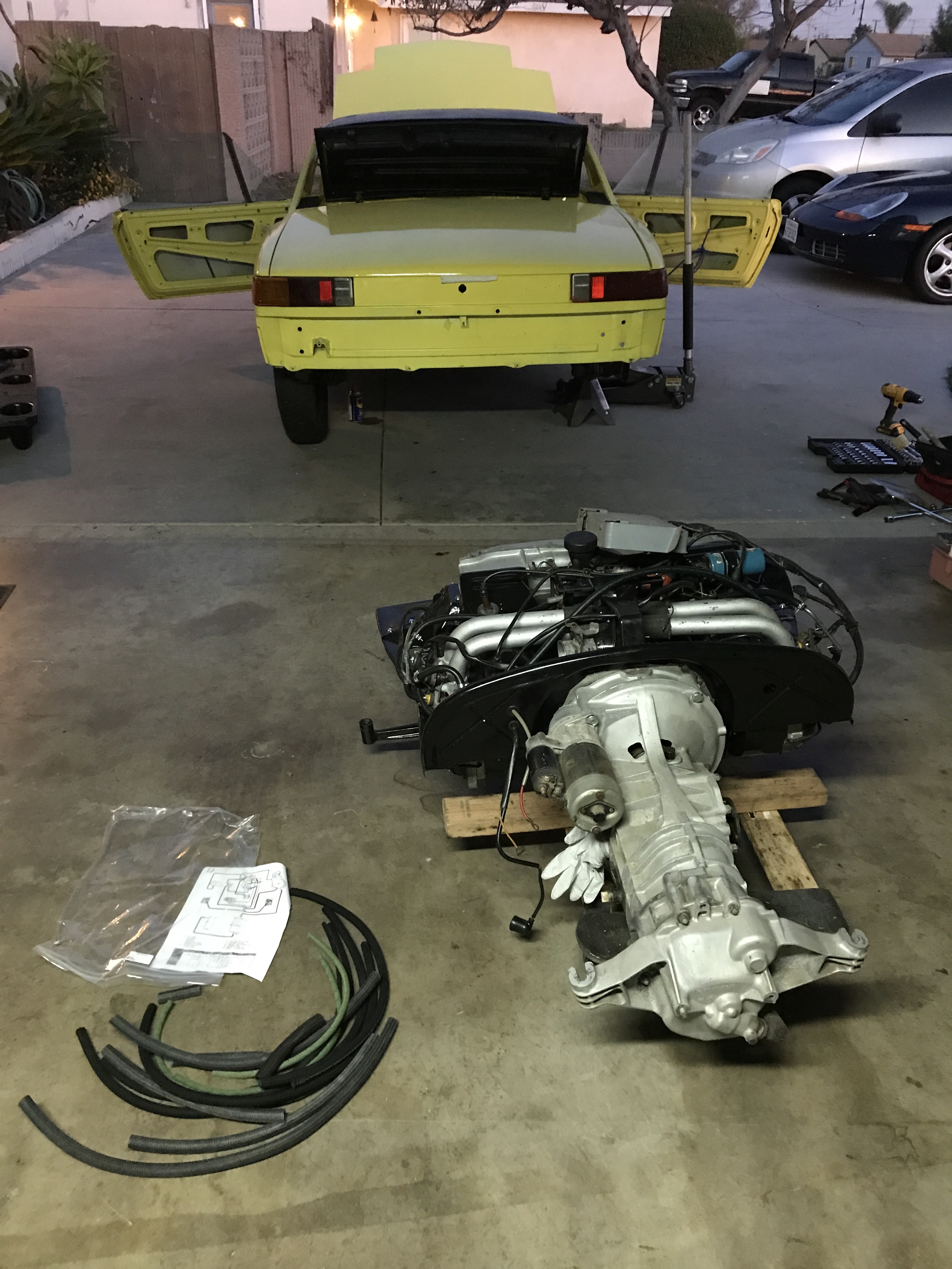

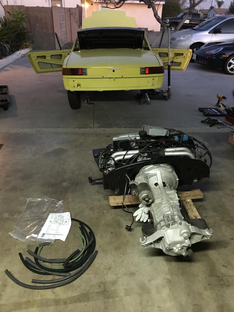

Installed Alan’s 1.7 FI engine last thursday including installation of SS fuel tunnel lines, engine to body seals.

Looks awesome, is there a build thread on this car?
