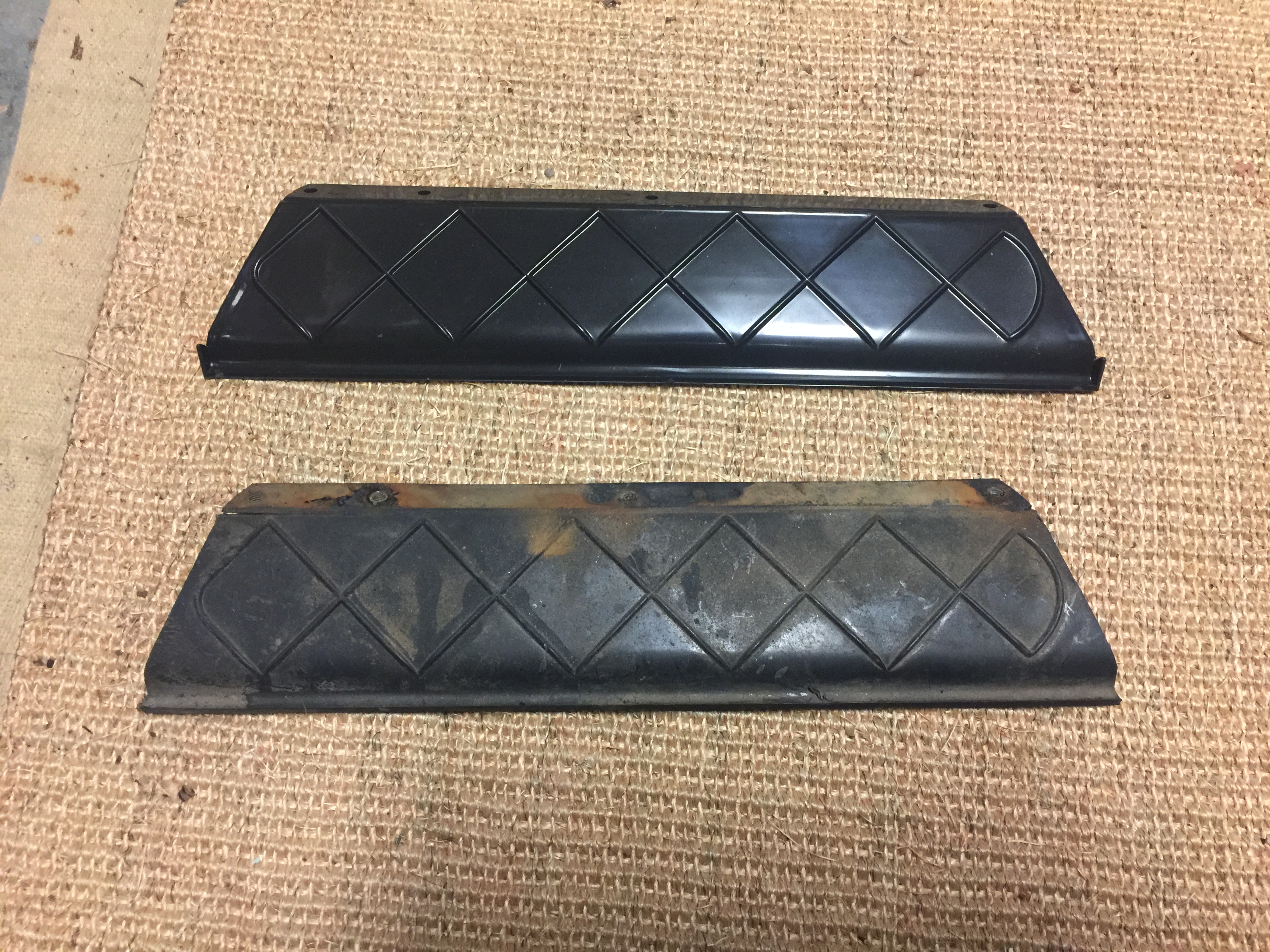

Replaced my air deflectors with new ones from 914Rubber.com
My other one was really trashed. Hope to have cooler running engine this summer. (IMG:style_emoticons/default/biggrin.gif)

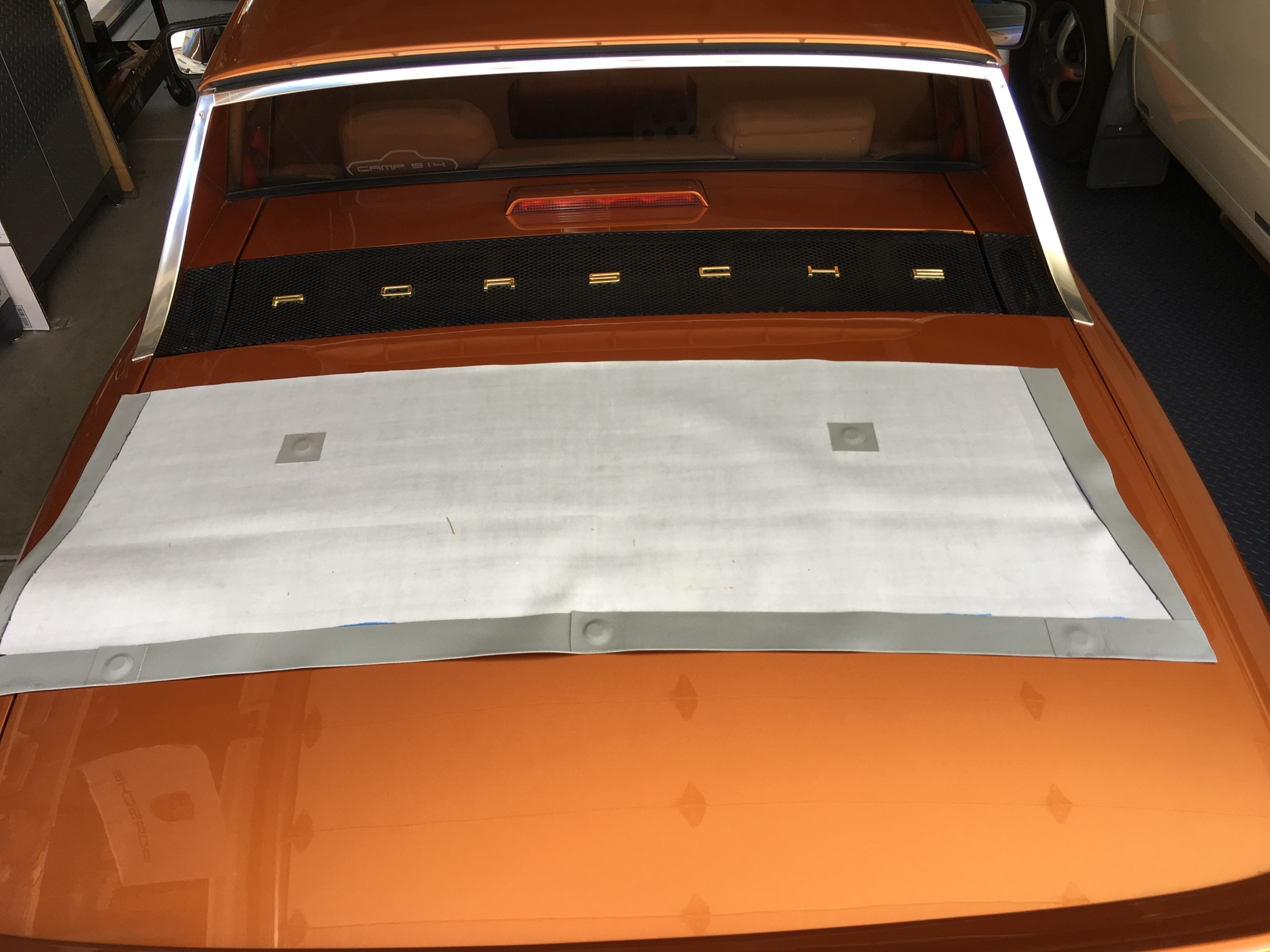

Made a prototype GT engine lid cover. To protect engine compartment from water while sitting. Made from vinyl from Hobby Lobby with 5 flat rare earth magnets from Home Depot.
* I switched out my GT grill for the winter....

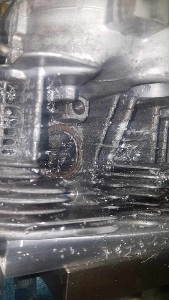

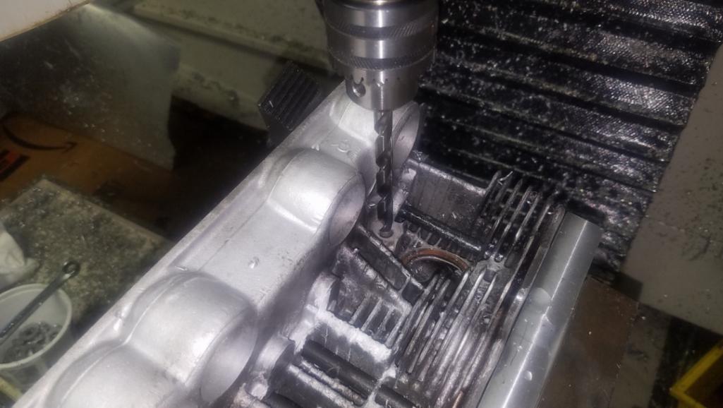

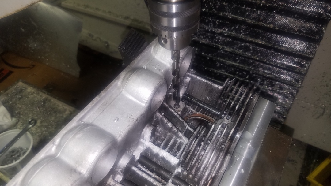

Installed M8 Time-Serts into the heads on my 1.8 for the exhaust studs, I had 2 broken studs per head when I got the motor and decided to replace all with brand new studs and inserts. Still need to find new inserts.

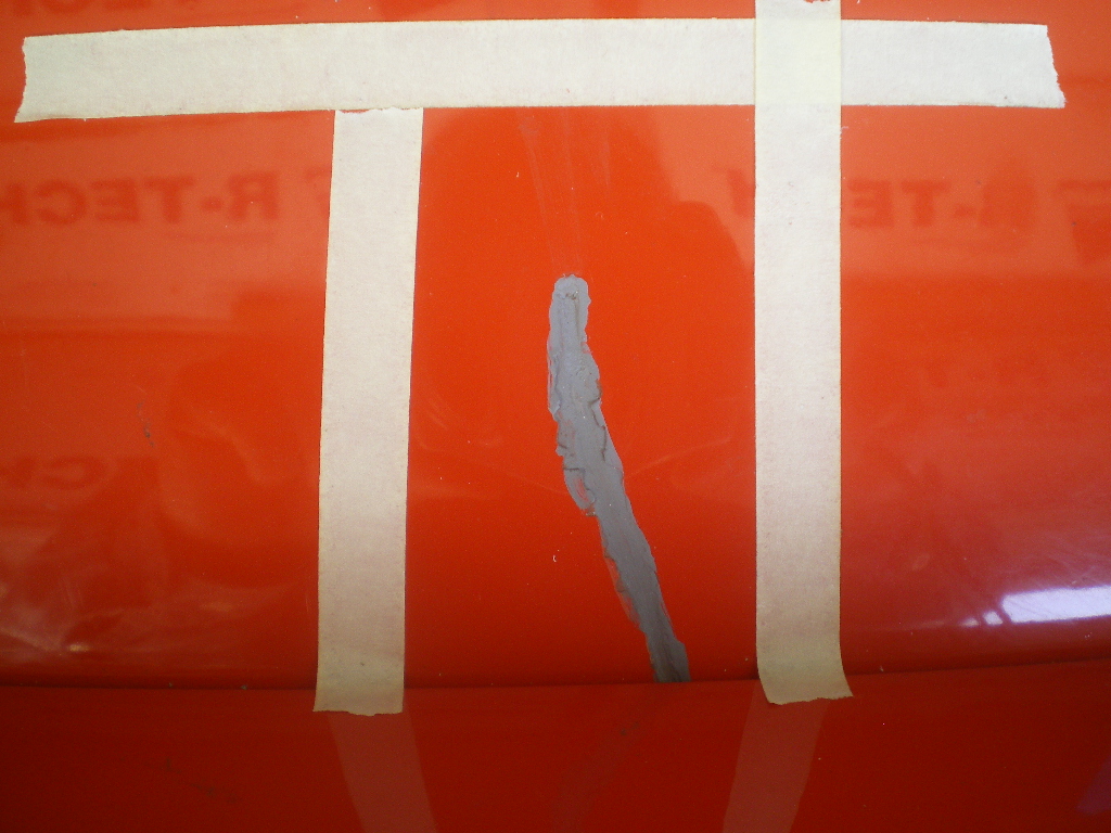

This wasn't fixing itself so.............................

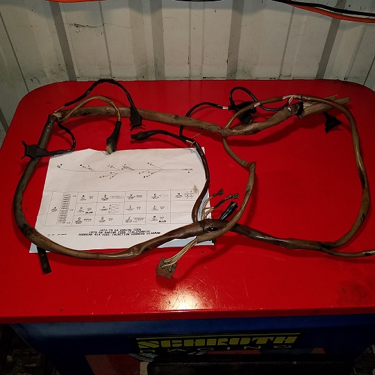

Well after getting Mike's engine plumbing all refreshed we had no spray out the fuel injectors. (IMG:style_emoticons/default/dry.gif) 34 lbs of fuel pressure. We'll tweak that down a bit.
We'd talk about pinning out the harness before we left Saturday night.
After sleeping on it I told Mike that I thought pinning out the harness was bad money. The harness was 46 years old and we need to change it. Especially because you want to drive it everyday. By chance Matt had a new Bowlsby harness in his on site parts stash. (IMG:style_emoticons/default/cheer.gif) So out with the old, in with the new.
After the R & R she fired right up. (IMG:style_emoticons/default/biggrin.gif) That's where we left it and headed home.
I'm almost certain I won't do another plumbing refresh without a new harness. They're just to old and brittle.

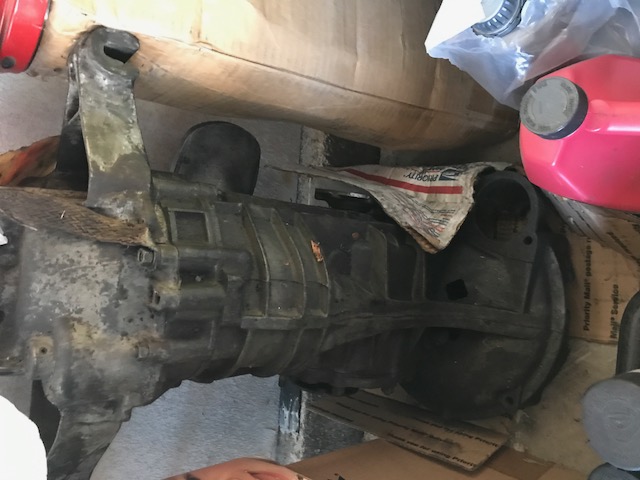

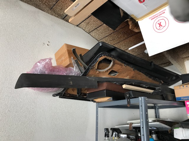

trying to empty the shed/storage.

QUOTE(ndfrigi @ Jan 29 2018, 01:42 PM) *
Are those all spare or extra parts?
I was "lucky" I think, when I bought my latest 914 I didn't have any left over parts from selling my car 8 years ago and the new one only came with a shoe box of "extras"
Besides a transmission I bought, I have no large extra parts and I plan on keeping it that way from now on.... just remembered I do have a complete 1.7 fuel injection setup that i plan on selling dirt cheap.

hehehe good that i have a very patient and very understandable wife with my 914 hobby. Those parts is not even included what I have in the garage. Last 2016 I even have 4 914s in our driveway and never heard a complain from my wife.
Well the reason i’m cleaning or disposing all the parts. We just bought a townhome and now I have to get rid of all the items from inside the 4 bedroom house and 2 car garage with full of trash!!!!

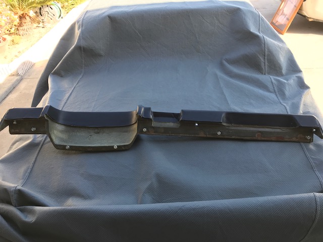

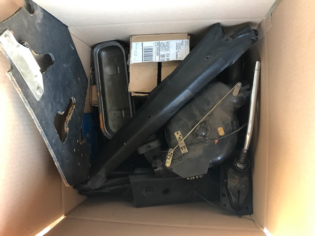

selling soon various parts. still need to sort them and move everything to a new place.

QUOTE(ndfrigi @ Jan 29 2018, 02:37 PM) *
GLWS, you are in a good location down there for sales I would think.
A few hot ticket items like those H/E's and Webers that people are always looking for.

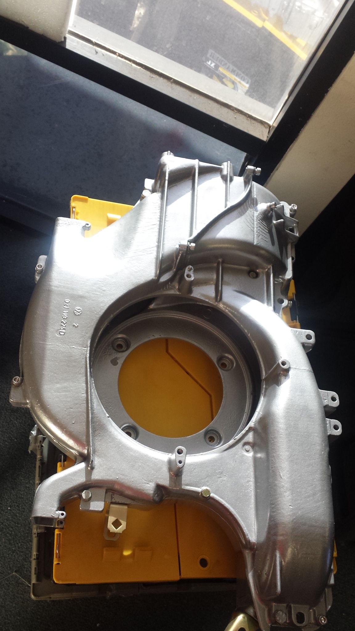

a few parts more and i will be ready to finish up refreshing my motor
