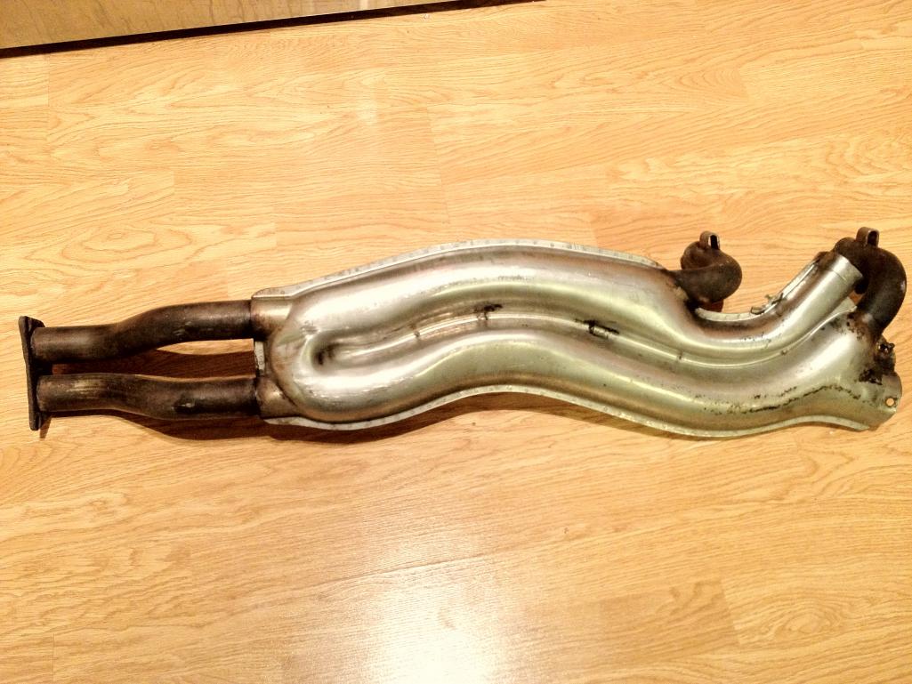

Forgive me if this has been asked already. I've recently acquired a set of heat exchangers from a popular auction site that were described as "little used, 1.7/1.8 heat exchangers". I got them for a steal. Upon receiving them, I realized they had very little rust, and we're in great condition. And by little rust, I mean no rust except for the muffler flanges which had little to moderate rust (looks like it may have been leaking for a while) The shrouds were "shiny" as if they were made of aluminum? And the headers are discolored with maybe light surface rust or something? Definately something a little polish or scouring pad could clean and make shiny again.  I checked it with a fridge magnet and the shroud was non-ferrous, and the headers barely if anything had any magnetism. Have I stumbled upon a set of well-used stainless heat exchangers or just a damn good set of originals? Is there a better tell like a stamping or something?

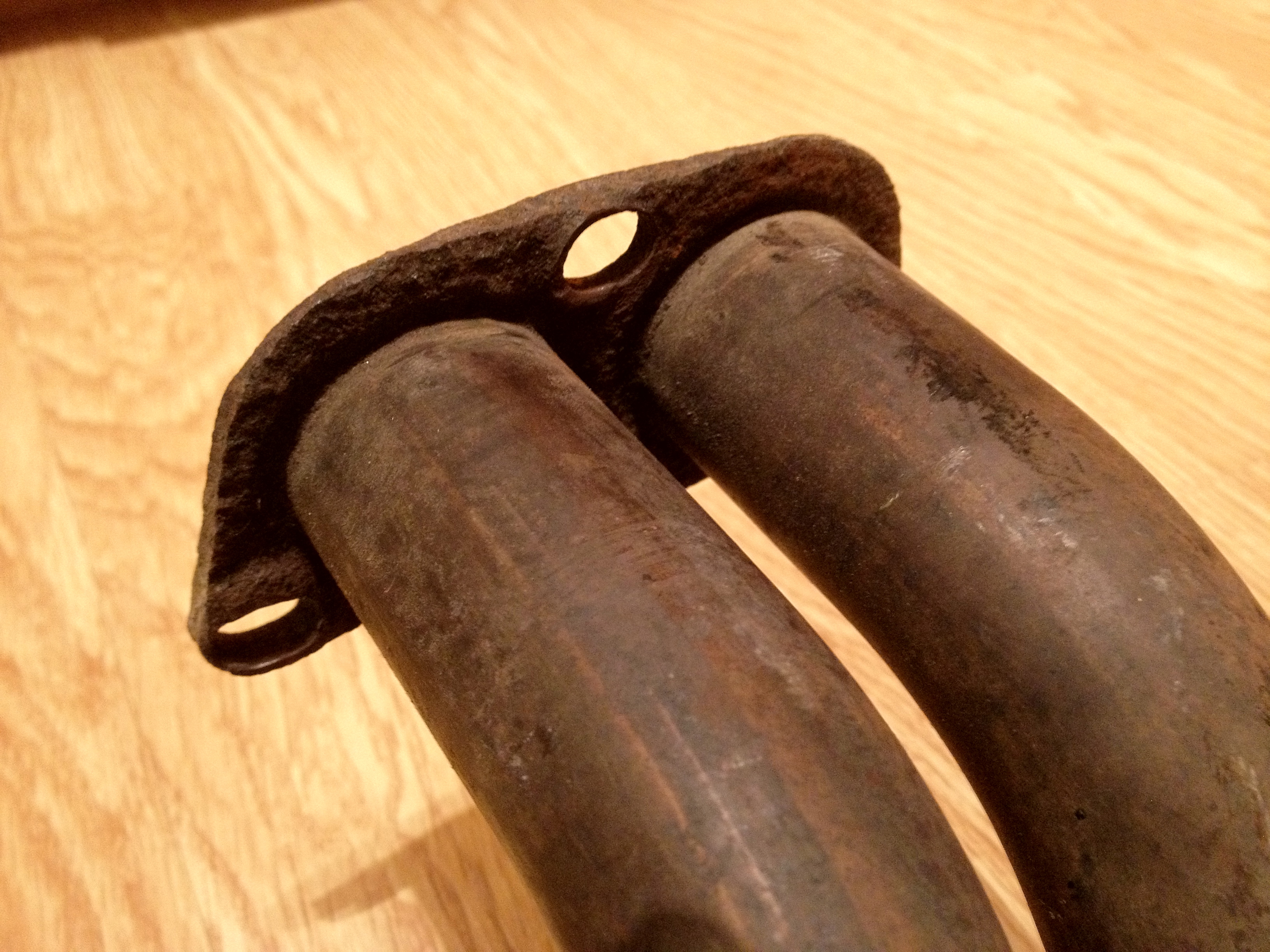

Well, that's kinda how I'm leaning, except the muffler flanges are fooling with me.  I thought SS HE had SS muffler flanges. These flanges, although I didn't check them with he magnet, are fairly rusty.

The early production models had mild steel flanges. I don't know why (call John at SSI, ask him, and then tell him he should sell the molds to Mark Whitesell so Mark we can have new ones made).
I think Mark Bland (Engman) sells SS replacements you can have welded on.
natemeins
post Dec 21 2011, 08:58 PM
Posts: 19
Joined: 9-February 11
From: Wichita, KS
Member No.: 12,686

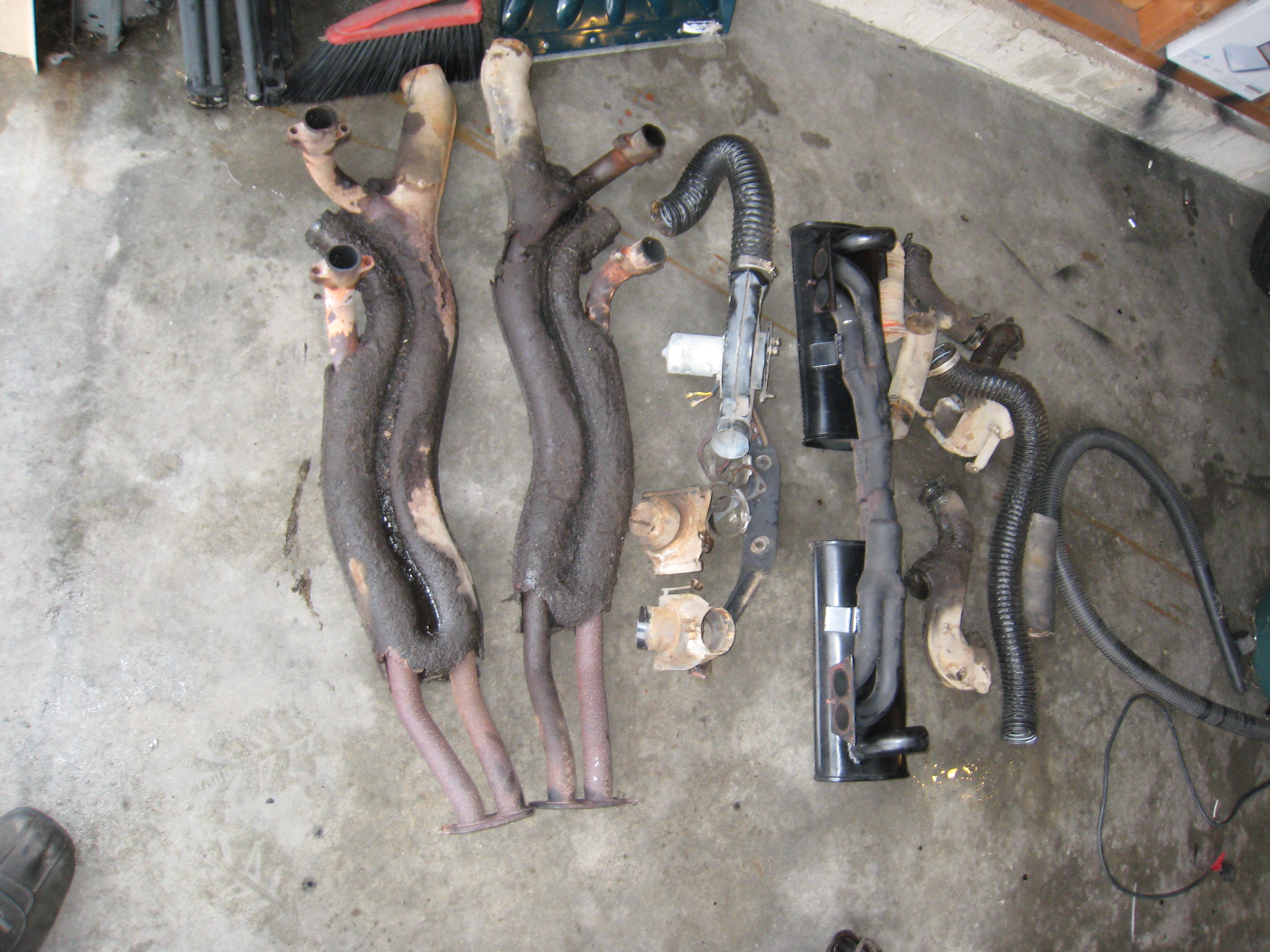

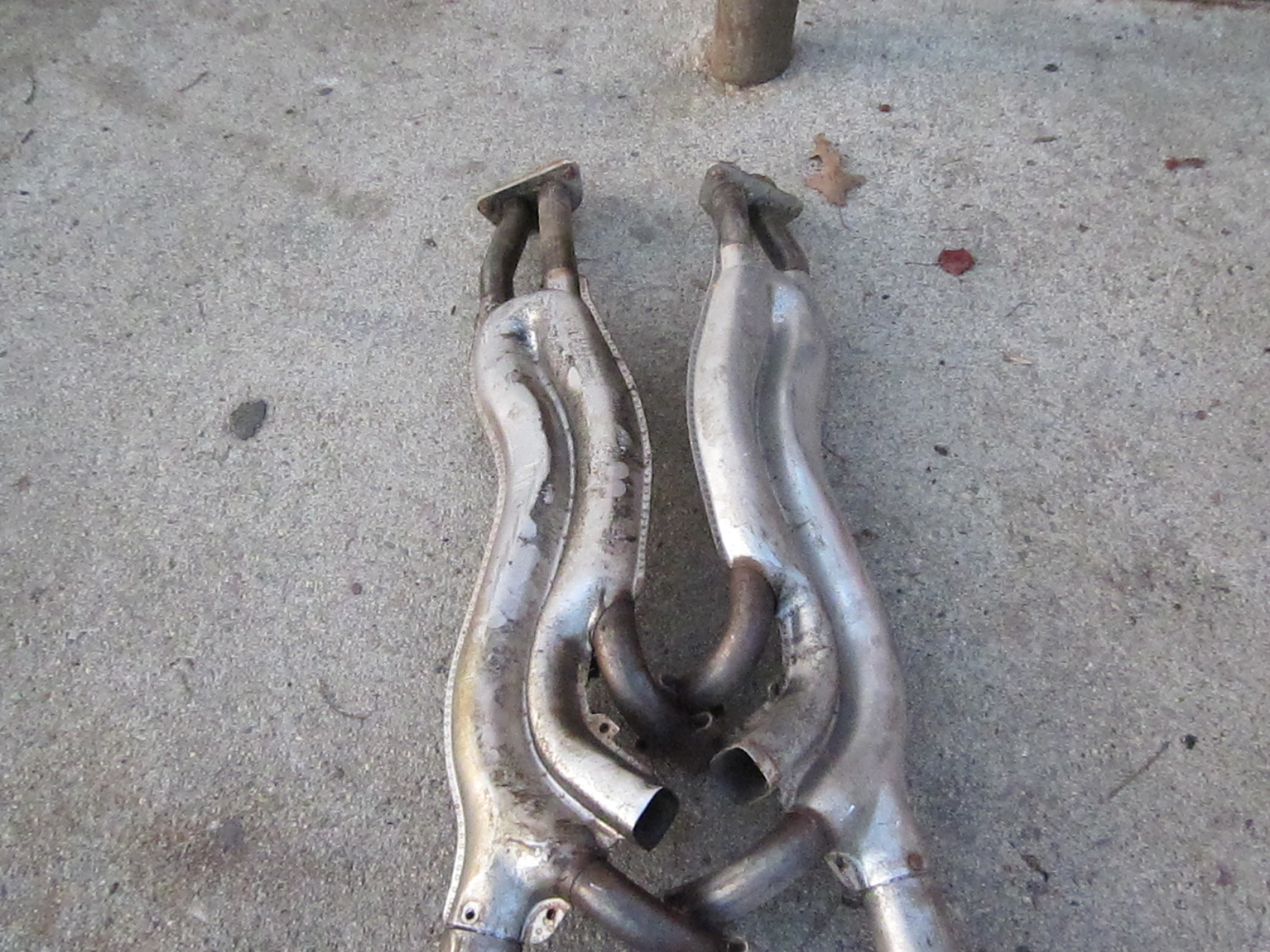

Interesting...I might have to give him a call. In the meantime, this is what I got, and what I took off the car last winter.Attached Image

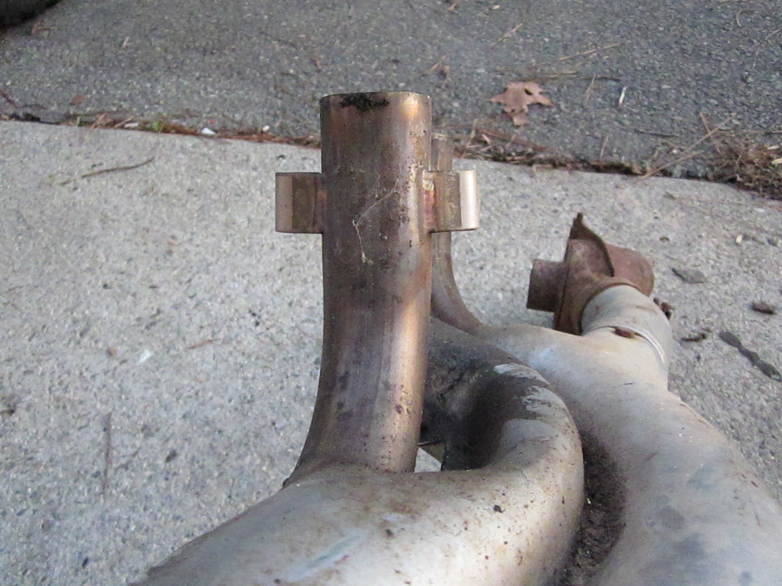

natemeins
post Dec 21 2011, 08:59 PM
Posts: 19
From: Wichita, KS
Member No.: 12,686

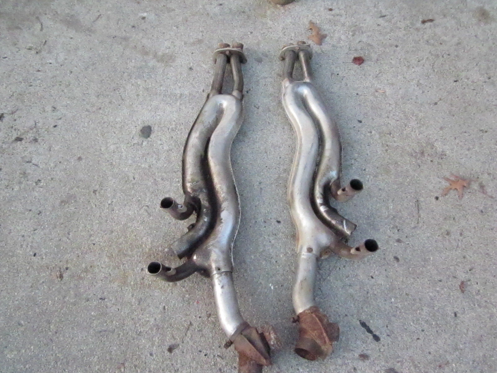

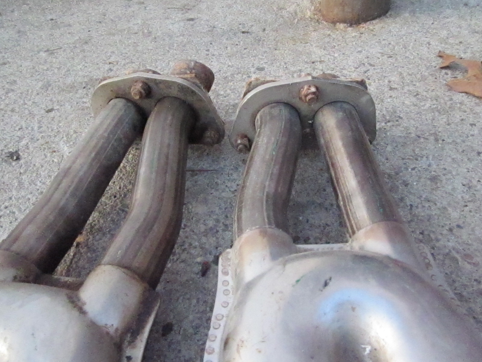

natemeins
post Dec 21 2011, 09:01 PM
Posts: 19
From: Wichita, KS
Member No.: 12,686
post Dec 21 2011, 09:13 PM
Resident German
Posts: 42,460
Joined: 21-January 03
From: Oakland, Kalifornia
Member No.: 179
Yepp, they look like early SSI exchangers that had the mild steel flanges. As McMark suggested, someone here makes a SS replacement for those rusted flanges.
Nice find!
Now, go and read the thread about how they can crack inside and leak CO into the cabin. There was a big discussion here a few weeks ago with some tips on how to test them for leaks.

I got a set of early SSIs on the evil-bay myself, no/little magnetism on the body, sticks on the mild steel flanges.
Yes it's Engman on here who sells the SS flanges if you want to replace them - or you can just clean up the rust, true-up the flange mating surfaces, prime & paint. I got those too & IIRC they were about $40-50 for a pair.
