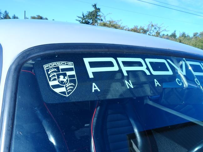

Almost a year after I began driving my car after the suspension fender mods, I finally have a mostly complete interior. Better late than never I guess (IMG:style_emoticons/default/biggrin.gif)

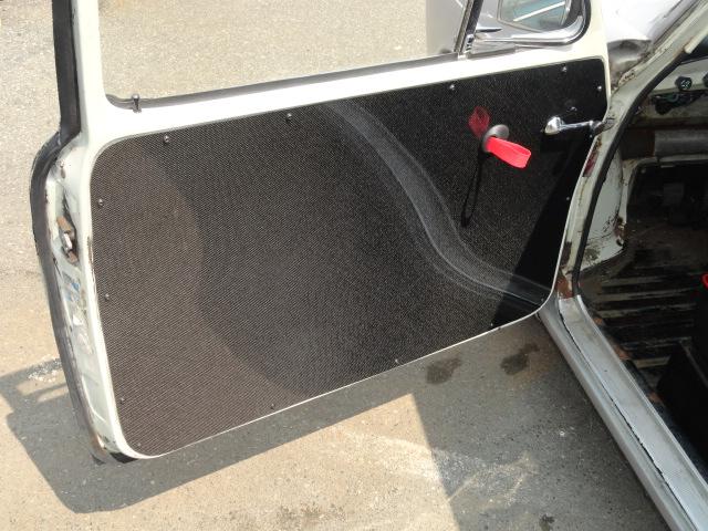

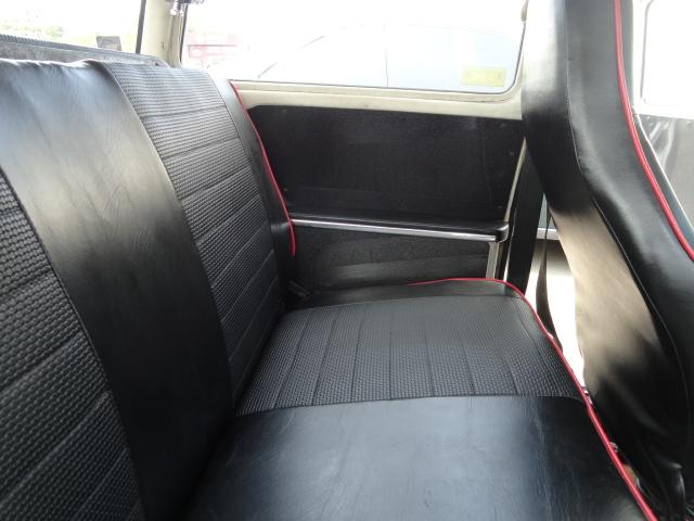

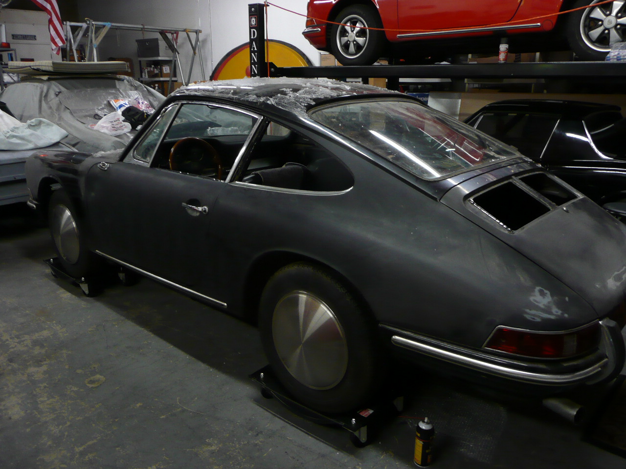

To keep the Porsche inspired theme going, I decided to make door panels reminiscent of the early 70s RS/RSR racers by deleting the metal door latch and replacing it with a light web strap and Porsche grommet.
(IMG:http://www.914world.com/bbs2/uploads_offsite/images.thesamba.com-9730-1436471701.1.jpg)
Instead of leather covering like a Porsche, I opted for carbon fiber. I infused all the blanks at my buddy Jim's shop Left Coast Development LLC. Then traced out OEM panels and attached them with black oxide screws.
(IMG:http://www.914world.com/bbs2/uploads_offsite/images.thesamba.com-9730-1436471701.2.jpg)
(IMG:http://www.914world.com/bbs2/uploads_offsite/images.thesamba.com-9730-1436471702.3.jpg)
(IMG:http://www.914world.com/bbs2/uploads_offsite/images.thesamba.com-9730-1436471702.4.jpg)
(IMG:http://www.914world.com/bbs2/uploads_offsite/images.thesamba.com-9730-1436471702.5.jpg)
Simple, light weight and un-cluttered. Now I can look at something other than a skeleton door as I drive.

Your door panels look good. Do the rigid CF panels rattle or vibrate, or did you dampen them in some way?
aircooledtechguy
post Jul 10 2015, 04:06 PM
Post #363
The Aircooledtech Guy
Posts: 1,966
Joined: 8-November 08
From: Anacortes, WA
Member No.: 9,730
QUOTE(maf914 @ Jul 10 2015, 01:41 PM) *
I didn't have to dampen them. I bought silicone washers to go under the heads of each screw, but didn't end up using them.

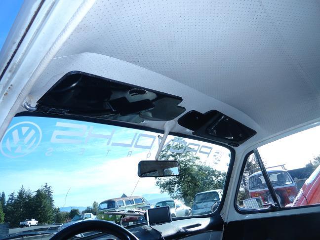

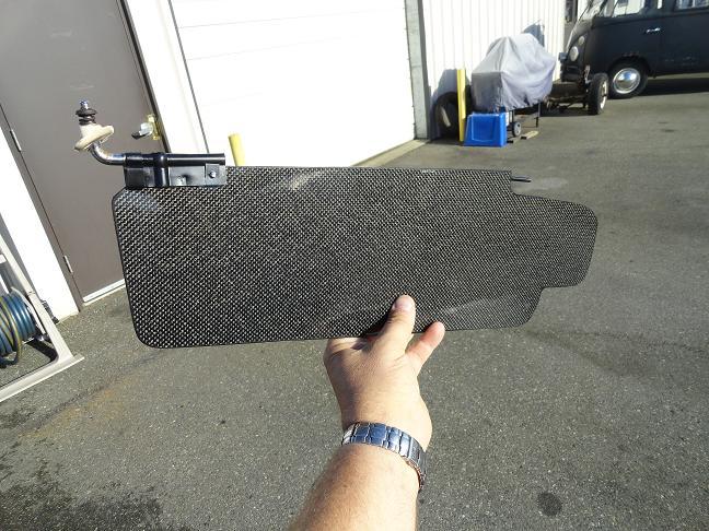

I was getting tired of not having any sun visors this summer. Especially since we are having one of the sunniest summers in a decade or more. I've got some exciting stuff happening at the end of the week, I figured that I had better get these done and on the car.
Originally I planned on having a custom set stitched-up to match the seats. But the upholstery guy flaked out and lost my custom set. (IMG:style_emoticons/default/dry.gif) So I ended up making these at the same time I did the door panel set. I used the same carbon fiber but used a 1/4" core filler to give them some structure and one layer of glass on top of the foam core. I cut them to shape, then painted the backs flat black for anti-glare. I made them so they will fill in around the mirror since as we all know, that's where the sun always is; right where the visors don't cover!! (IMG:style_emoticons/default/biggrin.gif)
(IMG:http://www.914world.com/bbs2/uploads_offsite/images.thesamba.com-9730-1438184576.1.jpg)
(IMG:http://www.914world.com/bbs2/uploads_offsite/images.thesamba.com-9730-1438184576.2.jpg)
(IMG:http://www.914world.com/bbs2/uploads_offsite/images.thesamba.com-9730-1438184577.3.jpg)
(IMG:http://www.914world.com/bbs2/uploads_offsite/images.thesamba.com-9730-1438184577.4.jpg)
In the near future, I will be adding a mirror to the passenger side to appease my wife (IMG:style_emoticons/default/shades.gif) but for all intents and purposes, they are a done-deal and work fantastic.

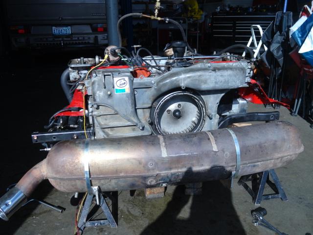

Just finished the initial break-in on the 2316cc engine my son built last summer. Yeah, not a lot of time to do my own thing since last year but I work better under pressure anyway. (IMG:style_emoticons/default/laugh.gif)
I wanted to run it out of the car first in case any issues came up since it's kind of a pain to work on in the car and not the easiest motor to install or remove. So I bolted up a set of type-4 DCNFs and an 009 dizzy and let it rip for 20 minutes. :twisted: Other than some carb issues :roll: everything went well. I can't wait to dump the carbs and dizzy and get that sweet running MS3X & LS2s on there and begin tuning.
(IMG:http://www.914world.com/bbs2/uploads_offsite/images.thesamba.com-9730-1440522285.1.jpg)
You know what I'll be doing this weekend. . . (IMG:style_emoticons/default/happy11.gif)
BTW, the 911 muffler sounds good. It's quieter than my current muffler.

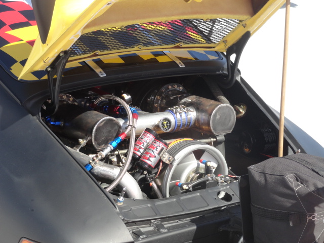

This guy showed-up last year in his 911.
I don't know what size the motor was (guessing 2.2/2.4L), but it was an MFI turbo engine that sounded like sh*t. For all the money and time thrown into that car, he only ran about 10mph faster than I did (around 105mph). . . (IMG:style_emoticons/default/shades.gif) Seriously, I don't think that motor ran on more than 4 cylinders at any given time and they still rolled it up to the line and ran it that way. (IMG:style_emoticons/default/barf.gif) Personally, I would have been embarrassed/scared to run it sounding like it did.

Awesome Nate! Can't wait to see the new motor in the car. Then get the report on how it compare's to your old one. Was the old a 2056? I forget
Yeah, 2056. Bone stock bottom-end and heads with only the flat-top 96mm P&C and the removal of the head gaskets for mods. Bottom-end and heads had around 150K miles on them since 1973.

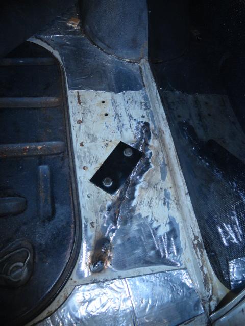

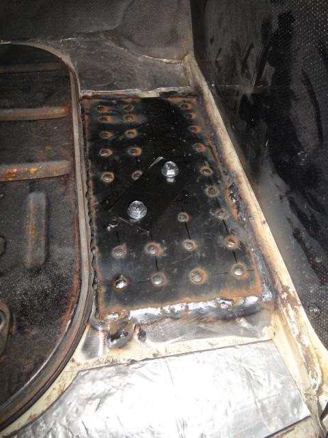

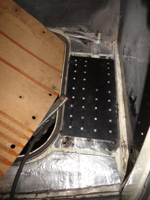

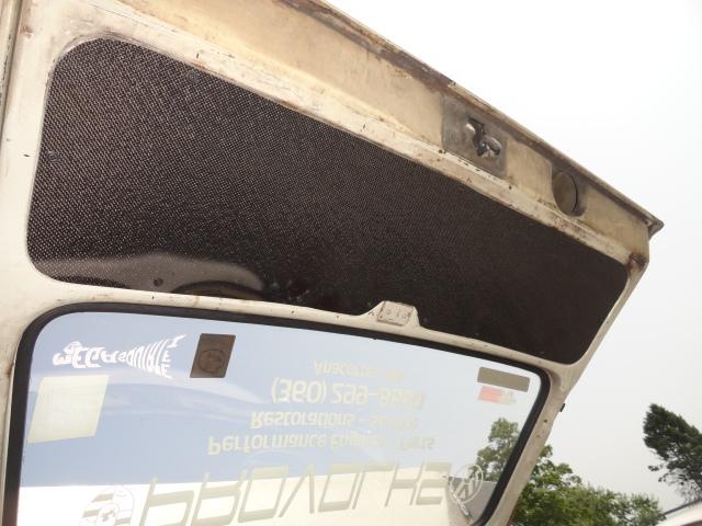

At a recent car show, I lifted up the carpet in the rear and noticed a crack in the cargo deck poking out from under the sound mat. (IMG:style_emoticons/default/blink.gif) Seems as though the constant abuse from my right foot has taken a toll on this area. (IMG:style_emoticons/default/rolleyes.gif) (IMG:style_emoticons/default/shades.gif)
After investigation and removal of the sound mat, I discovered a "small crack" had developed that was right along the seam where the air duct is spot welded and some significant flexing of the surrounding area was happening. (IMG:style_emoticons/default/rolleyes.gif) (IMG:style_emoticons/default/shades.gif)
(IMG:http://www.914world.com/bbs2/uploads_offsite/images.thesamba.com-9730-1440712983.1.jpg)
So after welding the crack and grinding the welds flat, I cut a 3/32" piece of steel plate that would distribute the load on the right side of the car over a large area spanning both the floor and the air duct. I drilled a couple dozen holes to rosette weld it to the floor and ensure it wasn't just the perimeter holding it all. The plate spans both the floor and the boxed air duct for extra rigidity. I'm much more comfortable now bolting in my race motor that has double the HP of the 2056. . . but I'm still gonna keep a close eye on it.
(IMG:http://www.914world.com/bbs2/uploads_offsite/images.thesamba.com-9730-1440712984.2.jpg)
(IMG:http://www.914world.com/bbs2/uploads_offsite/images.thesamba.com-9730-1440712984.3.jpg)
