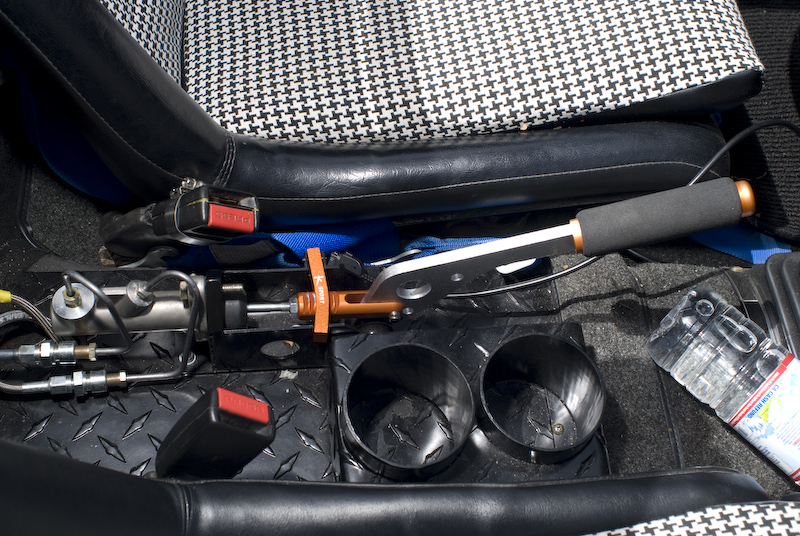

I made one change to the brakes. I had planned on running stock 914 calipers in the back so as to retain my stock e-brake. The issue I had was the cable routing since my brake calipers had to be on the rear of the trailing arm, the cables would end up being very close to the axles/CVs. So I traded them out for 912E calipers that I had. Fit like a glove!! But now i don't have en e-brake. Perusing eBay I came across a really simple hydraulic e-brake set-up used by drift cars guys. . . I pulled the trigger on it and now I'm going to have an fully functional hydraulic e-brake!! (IMG:style_emoticons/default/biggrin.gif)

So I've logged about 60 miles on the Square since getting the 5-speed installed and I LOVE it. Cruising down the hwy, I have less engine noise and we'll see about the fuel mileage when I get the bugs out of the speedo (needle sometimes works flawlesly; other times not at all).
Some things that I definitely need to do to make it a solid driver are:
- rear-end alignment. I can tell it's out. It drives perfectly straight, but becomes a little "twichy" as speed increases. It's O.K. below 55-60, but the couple times I sprinted to 85-90, it was beginning to feel dicey. Don't want to crack this thing up because of a simple alignment issue. . .
- I need to replace my rear axle bearings. Probably should have done that during mock-up, but i didn't think of it.
- Rear brakes slightly drag. I may need to do my Porsche brake MC upgrade sooner than later. . .
- I need to get the wider tires on this before I even attempt another high-speed run over 80mph!! The 155R15s(!) that are currently mounted are wholly insufficient for anything other than drifting (which is quite fun BTW), and don't add to the stability in or out of corners. (IMG:style_emoticons/default/lol-2.gif)
- The speedo works only about 1/3 of the time. I'll have to investigate that. I may just have a wire that is grounding on the back (they are really close to the chassis).
- The lights for high beam, park lights and blinkers don't work or don't work correctly. I just LOVE wiring. . . (IMG:style_emoticons/default/headbang.gif)
- My oil pressure gauge is not reading right. I may have the wrong sender. I also need to re-wire all the grounds for my gauges. I daisy-chained a few of the grounds together for simplicity of wiring and I think they are insufficient so some weirdness is going on.
Other than the alignment problem, the axle bearings and the brakes, the rest is more convenience stuff that I will just have to get sorted as time allows.
The ugly and unassuming "Squarsche Type-3/P SS" (Super Sleeper) is now mobile and prowling the roads for winged H*nda f@rt-cars to embarrass and demean publicly. (IMG:style_emoticons/default/happy11.gif)

I run one of those hydraulic brakes. It will loose pressure as the fluid cools. Not great for hills. It will hold on my steep driveway for a few hours, just not over night. If I wait until the fluid cools and press the brake pedal (under the dash), it will hold over night. Works great on flat ground to hold the car from moving.
Great thread btw. I had a 66 & 67 fastback. loved those cars. Still have a set of dual carbs for it. Now I need a T3 to put them on...
