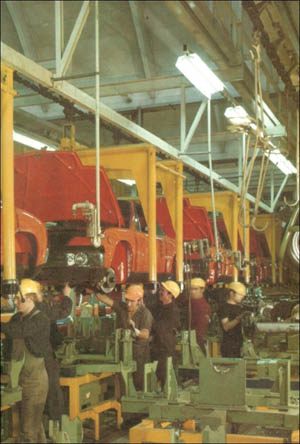

Here is the pic of the cars being built, note the wheel well color.

Hey Brad, see why there are so many orange 914s.

Thanks for the input guys. Love the pix of the assembly line. Where did you get it? Any more of them?
I guess my car was undercoated but most of it has been pressure washed away now. Now I know to piant the whole car the same colour and not to paint the wheel wells and underside black. (IMG:style_emoticons/default/beerchug.gif)

Brant, That is a pic I pulled off the net years ago, its not my car. I have always liked the two-toned bumpers that the factory did too. Why they did it I don't know but its cool. I can't say I would do it on a street car but on a track car hell yes, its very retro! I don't get too turned on by all the rice paint schemes.
