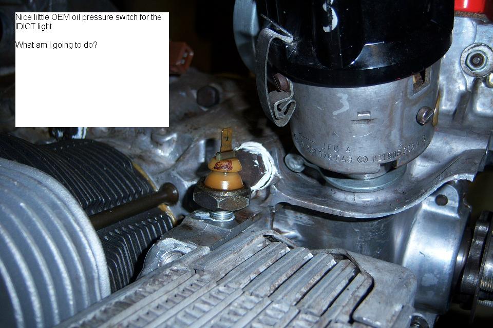

I am usually good to measure twice and cut once. Not sure why I messed this one up.
I have spent much time and a few dollars rebuilding this engine, so I wanted to be able to monitor it. Nothing too fancy or expensive, just some VDO gauges. I guess it is a little late now, but let me ask. Where can I put an oil pressure sensor that is 3 times as tall and twice as round as the OEM idiot light sender?
The distributor gets in the way damn it. I can get it installed, but I lose some range of motion for the distributor. Then there's the cooling tin issue. My engine is assembled so, if the answer is to drill and tap somewhere else, that option is out.
Somewhere online I saw an aluminum block that mounts to the oil filter attachment, then the oil filter screws into that. That block has 3 or 4 tapped holes to mount stuff. Where did I see that? And would it give me decent pressure?
What can I do?
Clark
Picture of the VDO monster
And the OEM version
76-914

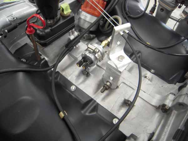

Elliot Cannon
post Jan 12 2012, 01:05 AM
Group: Retired Members
Posts: 8,487
Joined: 29-December 06
Member No.: 7,407
Here's mine.

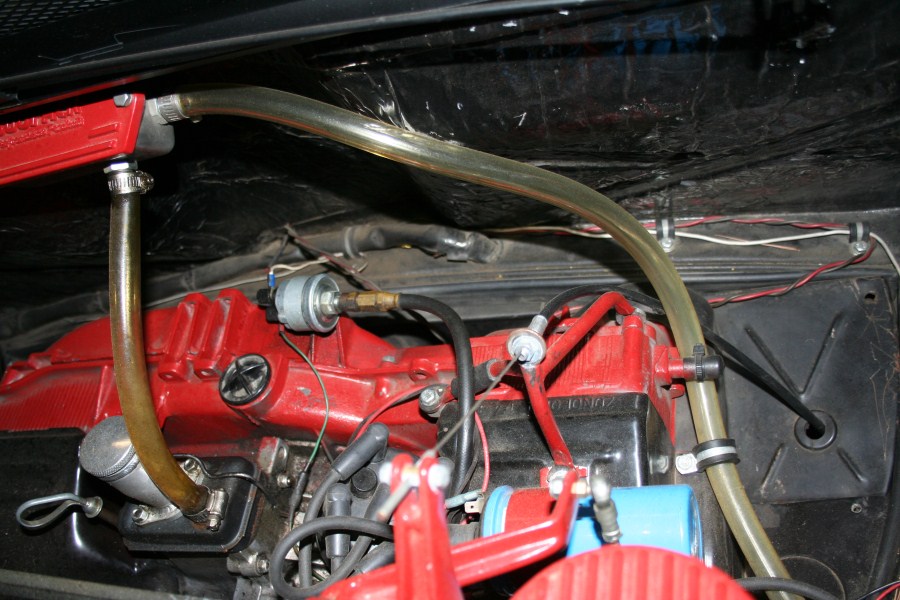

Cevan
post Jan 12 2012, 06:54 AM
Posts: 1,079
Joined: 11-December 06
From: Western Massachusetts
Member No.: 7,351
I used a paintball hose. They come in different lengths. I made a bracket that attached to one of the case perimeter bolts. That way, I didn't need to use a separate groound wire.

QUOTE(Elliot Cannon @ Jan 12 2012, 01:05 AM) *
Here's mine.
I like the fan mount Idea, cause I think with the L-jet, I am going to have lots of stuff on the top of the engine. Question for you. Your 2 wires run in opposite directions. 1 connection on the sender is for a gauge and 1 is for a light, both are on the dash. I guess 1 wire is the ground wire back to the engine?
How about the grommet to seal the hole. Is there a Grommets-R-Us type place that would have lots and lots to choose from?
Thanks for the input.
Clark
