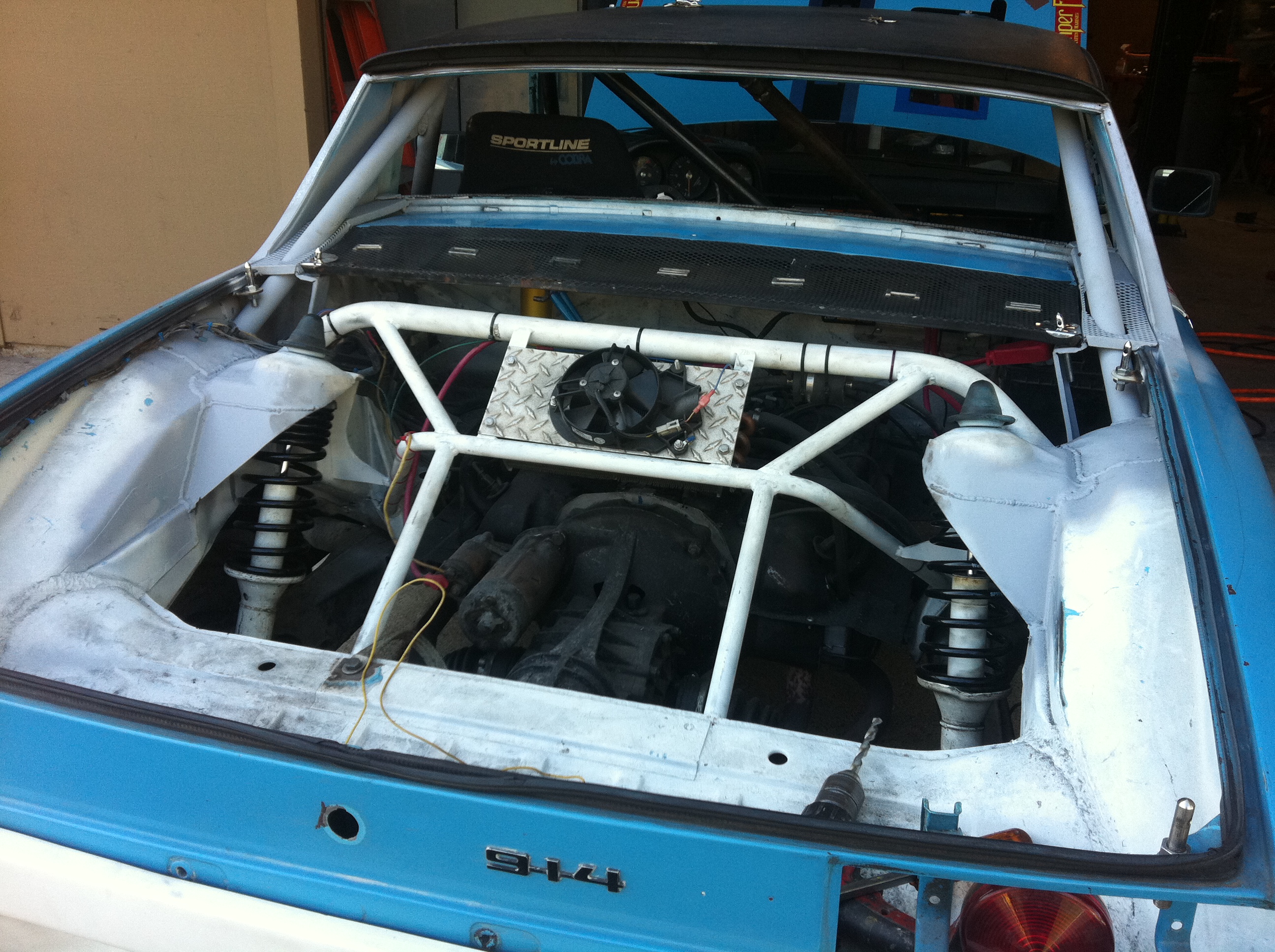

I've run my 914 in 6 LeMons races. Half with the stock setup and the other half with an extra oil cooler. I've yet have to run the cooler fan. I can't tell any running temperature difference. I don't think I would go to all the trouble of putting the cooler up front. Seems like a lot of work for very little if any gain.
Good luck with Chump cars.
