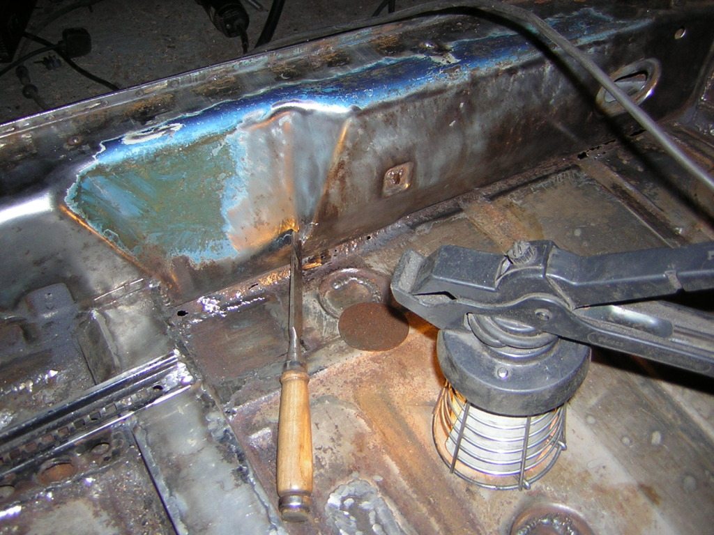

Just thought this might be of interest, in the photo at the chisel point is where I found a spiders web of fatigue cracks up to about 2 inches in length!
If you are lucky the factory will fill one of those holes with 2 metal discs and does anyone know what those 3 spot welds hold just to the right of the handbrake recess?
