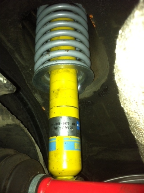

my recently purchased '75 5.7 is sagging in the rear, and I'm hoping someone can help me out. The clips are set to highest setting and it's still low, and when I jounce the rear end, there's no movement. here's my questions:
1. what do I have now, the coil diameter is roughly 3.625 (92 mm) X .47 (12 mm).

You need to take the springs out and measure them, Throw weight on them till they compress 1", Do it again for 2" (If you have enough weight), as they could be progressive.
They are thick coils which makes me think aftermarket.
If you like the ride, but just want to raise it up, you can get some threaded collars from Coleman Racing. Double check your shock diameter with a dial caliper.

suspension is a system. Proper handling is a safety concern. I recommend taking the time to investigate. you already have heavy springs back there so what is wrong?
what torsions are up front?
are your gas charged Bilsteins blown?
are the top hats installed corrctly?

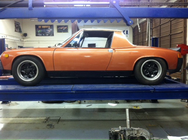

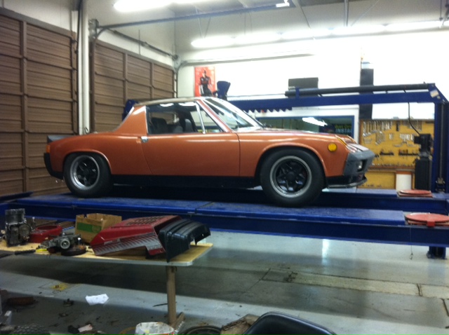

here's some profile pics. I measured it at the donuts, and found about 3/8" lower in the rear (probably about 1/2" for the length of the car). It does give an impression of pointing upward as you are driving.
xsJerry
post Jan 26 2012, 12:03 PM
Posts: 44
Joined: 26-November 11
From: Arcata, CA
Member No.: 13,822
it's also about 1/4" lower on the right side rear than the left. you can kind of see this in the photos (looks lower in the rear when looking at the passenger side)

Do some serious examination of the suspension console and ear on that side. I hope you don't find any serious rust or cracks.
I like the looks of the rear height as you have it. I would lower the front and put some lower profile tires on - but that's partially a personal taste thing. Then readjust the alignment. Maybe corner balance.

(IMG:style_emoticons/default/agree.gif) lower the front. (IMG:style_emoticons/default/biggrin.gif) I like the tires though...

Those are some tall tires...
I agree with the body suspension point check. Do a visual to see how many shims about are on each side as well for the trailing arm lower mount.

rt rear is low and has more neg camber. everyone else made some good observations except eric shea
are all 4 tires the same size? brand?
