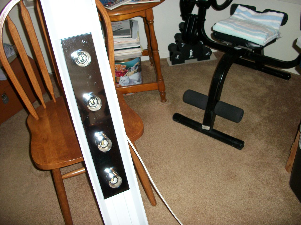

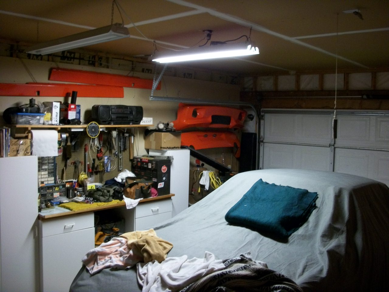

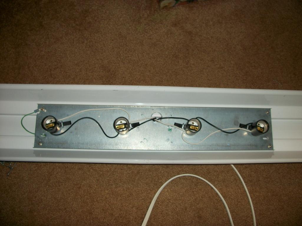

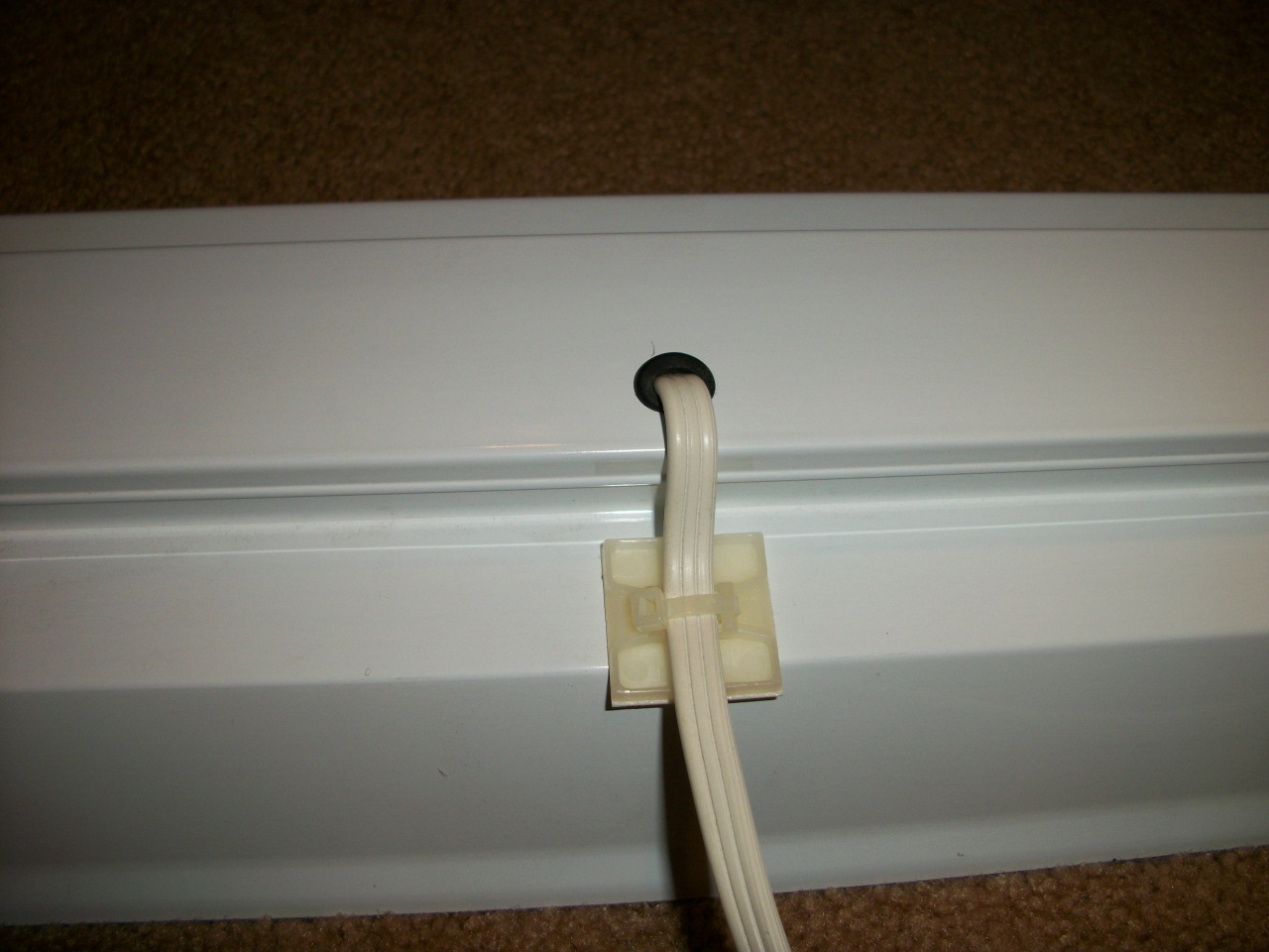

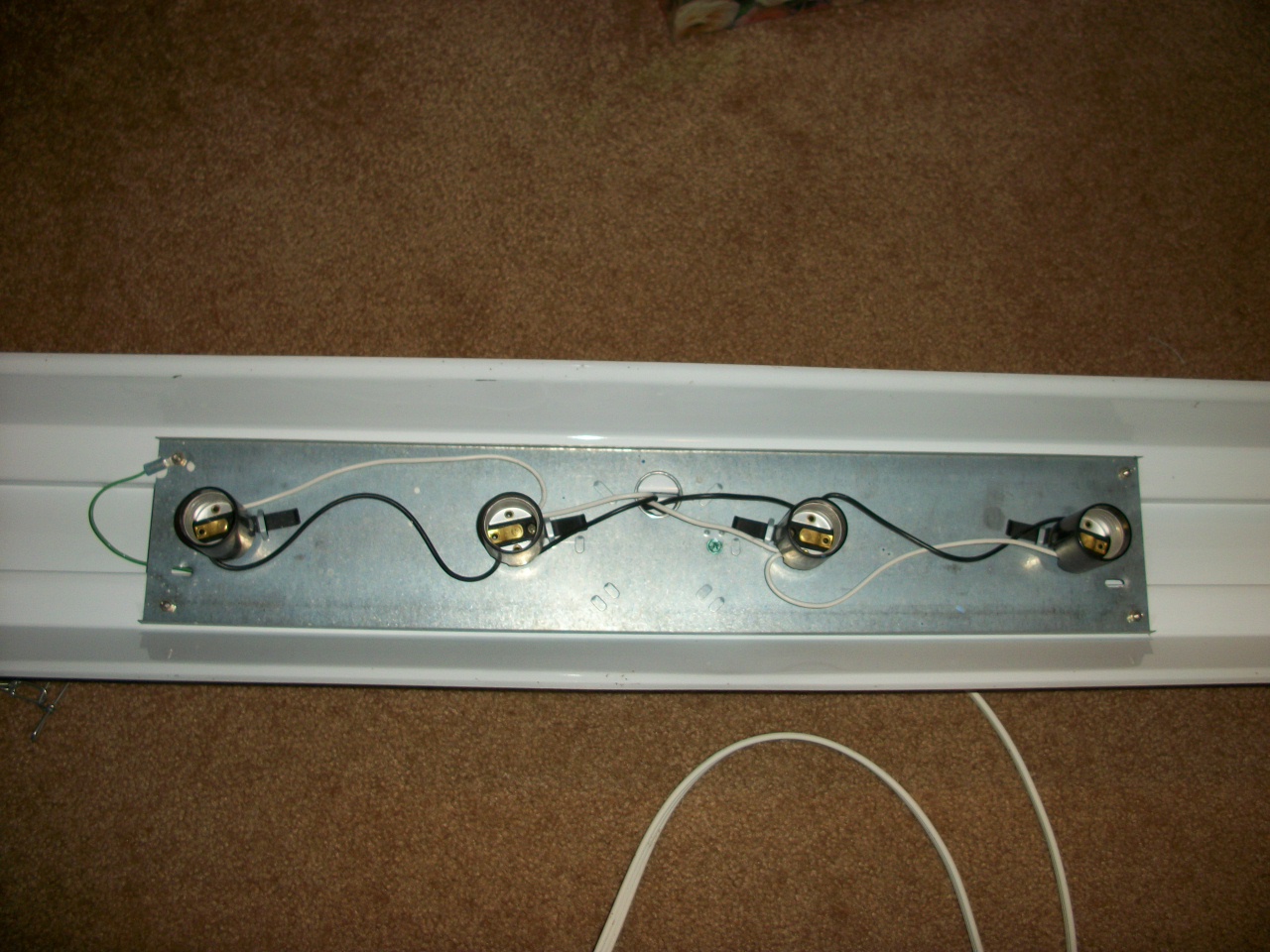

So I have three 4-foot shop lights in my garage. When they all are working, the light is pretty good. However, the dern bulbs keep burning out!! I have had CFL's in my outside lights for several years and have yet to have to replace one. So, I thought, why not put CFL's in the garage? So here is what I did. I like it so far and only have two 100 watt CFL's in the fixture, with room to add two more.
Found a fixture at Goodwill for $3.99 and 4 CFL's for $1.49 for two, so a total of less than $8.00 invested and about 1 hour to modify.
First is the before pic and then the after, followed by a couple of the modification pics.

I have had those 4 footers for 10 years or more and when I disassembled them, I think I see why they ate bulbs so often. There was no ballast, just a transformer and capacitor. They were the inexpensive, about $10.00 shop lights, so I guess I got what I paid for. The single one left in the pic with 4 foot bulbs is an even older one that does have a ballast and it seems to let bulbs last longer. I never had a 4 footer that would last years tho'.
As to more light for less power,? I don't know. I replaced two 4 footers at 40 watts each with two CFL's at 23 watts each and seem to have more lumen's, but I may be a little biased. (IMG:style_emoticons/default/biggrin.gif) But thanks for your thoughts and observations. Maybe the best answer would be to buy quality fixtires and the best bulbs to ensure longivity.

Tom, is that Goodwill 4 bulb fixture wired in series or parallel? Does it matter?
Tom
post Jan 31 2012, 10:19 AM
Posts: 2,139
Joined: 21-August 05
From: Port Orchard, WA 98367
Member No.: 4,626
Prospectfarms,
Parallel. Yes, it matters. Anything electrical wired in series depends on all of the individual components being wired to be good. As soon as one fails, they all fail.

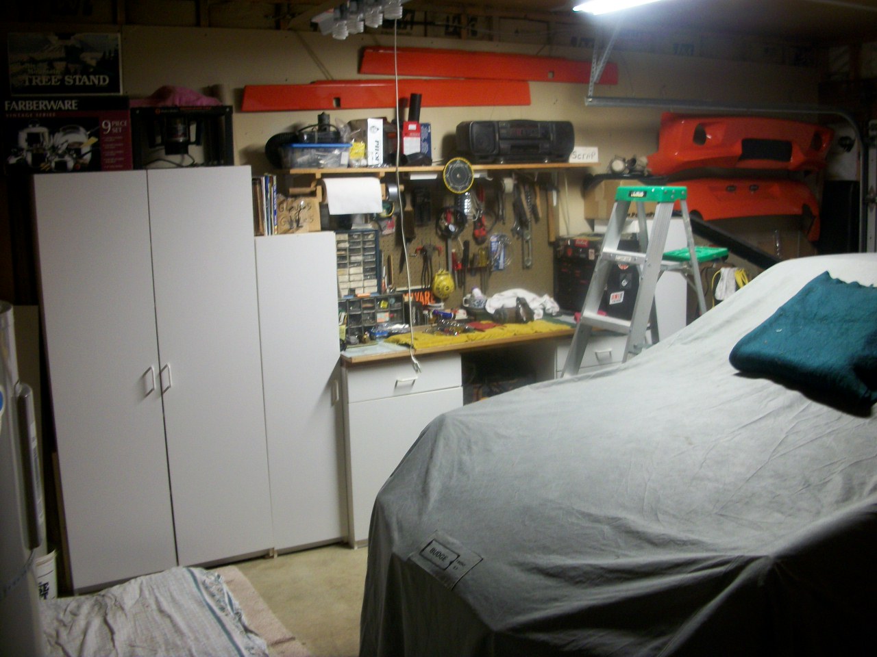

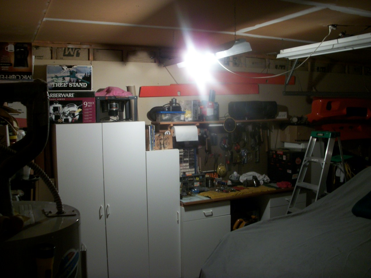

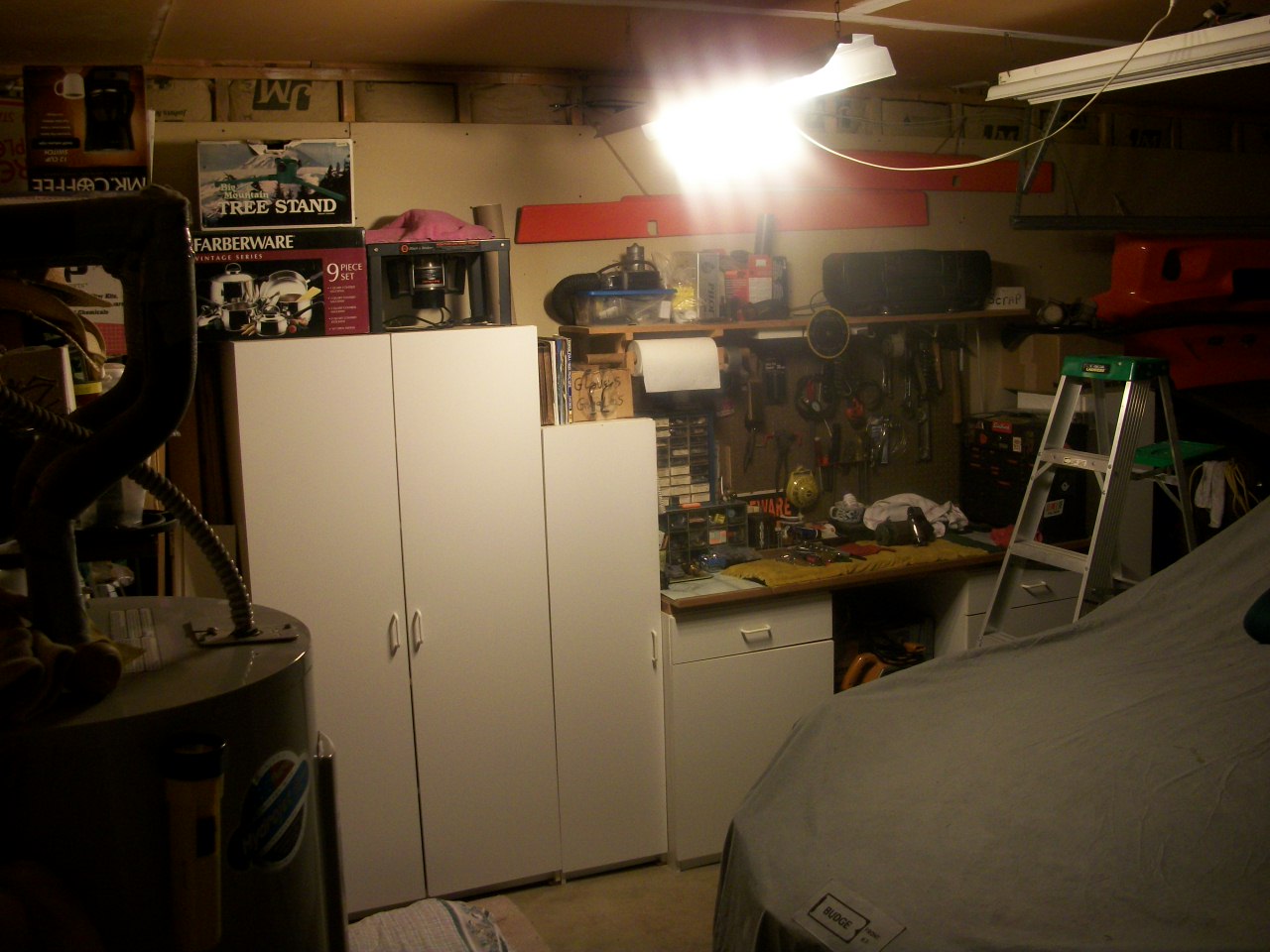

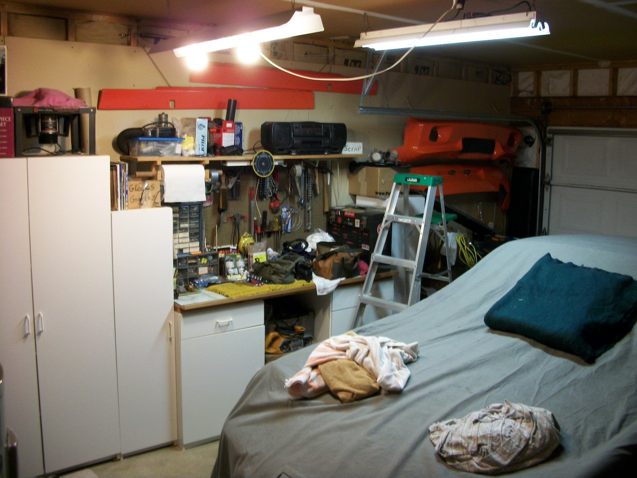

Three pics:
#1 - One 100 watt incandescent lamp.
#2 - Two 40 watt 4 ft bulbs.
#3 - Four 23 watt CFL's
Here are my observations:
The two 4 ft. bulbs seem to give the best lighting for the energy use, color is better and the spread of the light is better.
I think I will start looking for some quality 4 foot replacement fixtures and change over to T8 bulbs sometime in the near future.
Nothing ventured, nothing gained! Maybe I have helped someone else make a decision on what they need to do. Again, thanks to those who responded and Prospect, those links were very informative, never knew the troffer made such an impact. (IMG:style_emoticons/default/smile.gif)
Tom
