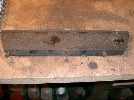

> What is this part?, Do members of the world run without it...any problems?
saigon71
post Jan 29 2012, 09:39 AM
Posts: 2,015
Joined: 1-June 09
From: Dillsburg, PA
Member No.: 10,428
This piece of plastic was mounted on the rear edge of the floorpan at the engine bay on the drivers side. The one on the passenger side mush have fallen off due to rust.
Not looking for a concourse car here, but don't want to omit any pieces that will cause me problems down the road.
Anyone run their car without these plastic flaps?

RobW   Unlike my time here on the world site, the flaps a...   Jan 29 2012, 09:45 AM
nathansnathan   I can see the flaps making a difference in cooling...   Jan 29 2012, 10:25 AM
Randal   Think they were put there by the Porsche engineers...   Jan 29 2012, 10:35 AM
Cap'n Krusty   This piece of plastic was mounted on the rear edg...   Jan 29 2012, 11:08 AM
Tom_T   This piece of plastic was mounted on the rear ed...   Jan 29 2012, 04:10 PM
Cap'n Krusty   [quote name='Cap'n Krusty' post='1613969' dat...   Jan 29 2012, 04:56 PM
hot_shoe914   'nuff said.   Jan 29 2012, 01:15 PM
stugray   Sorry, but I am on my 3rd 914, and I have never se...   Jan 29 2012, 01:37 PM
MLedesma   Early cars don't have them. My 71 and 72 don...   Jan 29 2012, 01:47 PM
9146986   It's a worthwhile retro fit to any early car.   Jan 29 2012, 02:17 PM
SirAndy   It's a worthwhile retro fit to any early car. ...   Jan 29 2012, 03:37 PM
flash914   I have a 70' how about someone putting a pictu...   Jan 29 2012, 04:05 PM
saigon71   I have a 70' how about someone putting a pict...   Jan 29 2012, 06:57 PM
Spoke   Here's my 71 retrofitted with air dams.   Jan 29 2012, 04:28 PM
Eric_Shea   I made sure they were on my build. They create a ...   Jan 29 2012, 04:43 PM
saigon71   Thanks for all the responses - great info! :...   Jan 29 2012, 06:51 PM
ThePaintedMan   Thanks for all the responses - great info! ...   Jan 29 2012, 06:56 PM
Eric_Shea   3 M5x.8x10 with nuts, washers and lock washers p...   Jan 29 2012, 07:53 PM
saigon71   Have one on the way from a 914world member. Thank...   Feb 2 2012, 02:45 PM
Drums66   Wise........don't run without them, especially...   Feb 2 2012, 07:01 PM
