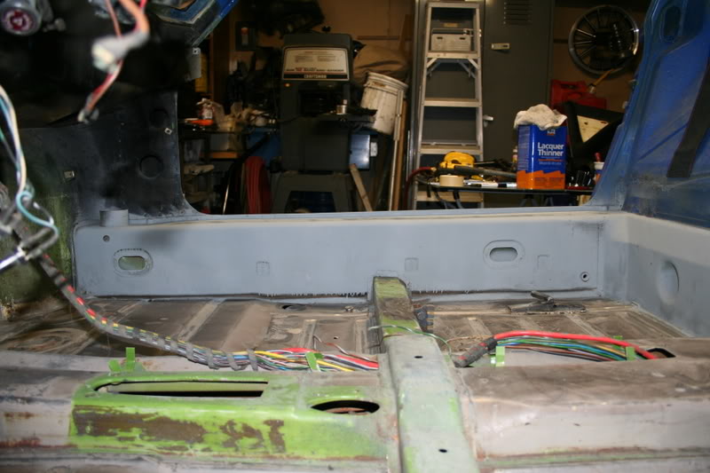

I recently bought one of those inspection cameras from HF (the pricer one with the camera head small enough to insert into a spark plug hole.) Should be easy enough to see inside the tunnel, but I'll need to find a good location to insert the camera head to take a peek inside longs. I'm almost certain that I'll need to spray 'something' in both places.
Do these oval openings allow full access into the long?
