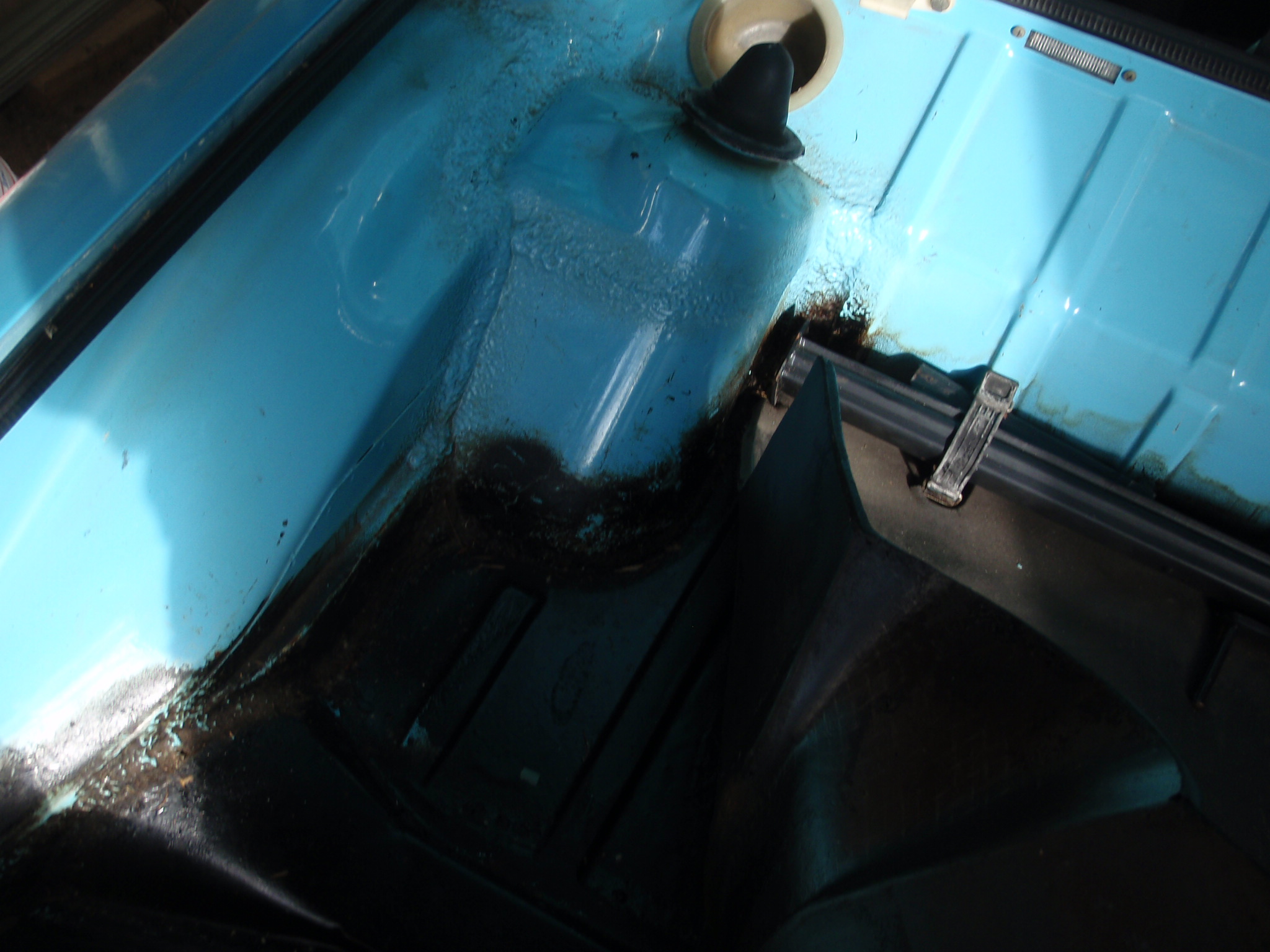

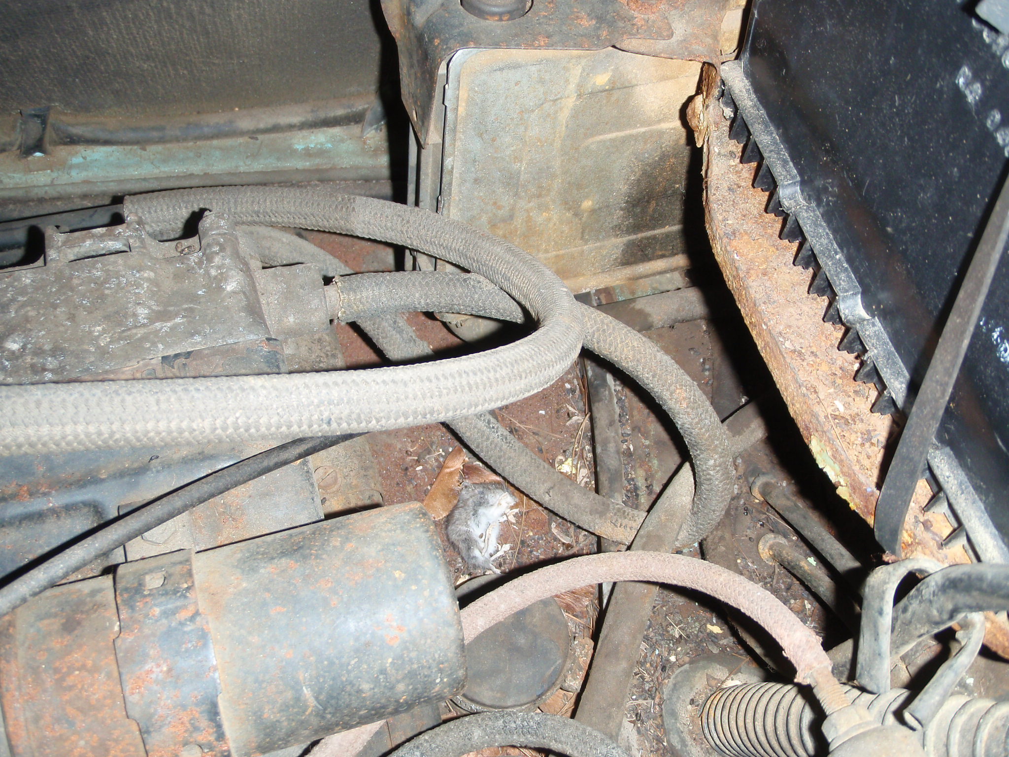

Well Thank you all for the great input. The car is 175 miles away and I thought I could do it myself. However, I guess I might be in over my head on this car for now. All 4 tires are flat, don't know if they will hold air, I expect the brakes are siezed, and I think I will have to hire a flat bed to drag it out of the garage and deliver it. The outer rockers are totally shot and there are some holes in the inners. The fenders have rust also. The good news is the pans look solid, the hell hole looks solid, the battery pan is almost solid. Car has been in storage since 1989. It is all there, even the expected mouse.

Well the mouse was cute.....
