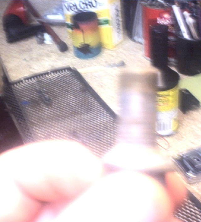

After I got my '74 up in Chicago (gave a once over and drove it home from there...353 miles), my wife and I went to a little "fun run" down in SE Missouri on some of the squirreliest roads I've ever seen. On the way home I started feeling that the brakes were definitely less than acceptable, so I pulled the wheels the next day. Nothing particularly scary about the brakes, other than 'zip' for pads left. But upon removing the lug nuts I realized that the PO had used the stock steel wheel lug nuts to hold on the Empi repro rims (IMG:style_emoticons/default/ohmy.gif) , each lug nut had only 3-4 threads in the hub! (IMG:style_emoticons/default/ohmy.gif) (IMG:style_emoticons/default/ohmy.gif)
Here's a pic only Sir Andy could appreciate (IMG:style_emoticons/default/rolleyes.gif)
The discolored 'blur' at the end of the larger blur (lug nut) is all that was threaded into the hub.
Oh...did I mention that my digi camera is a POS <_<

Is there a bolt in that picture? (IMG:style_emoticons/default/laugh.gif)
Even Andy would look at that picture and say, "damn, that's really blurry" (IMG:style_emoticons/default/chairfall.gif)

QUOTE(Special_K @ Sep 7 2004, 09:35 AM)
give me my camera back !!!
(IMG:style_emoticons/default/laugh.gif) Andy
PS.: scary stuff, the bolts i mean ... (IMG:style_emoticons/default/icon8.gif)

What's sad is that this was the better of the two pics of the lug nut...My wife's birthday is Oct. 17 and she's been talking about getting a new camera.... (IMG:style_emoticons/default/idea.gif) Just in time for the FFC.
