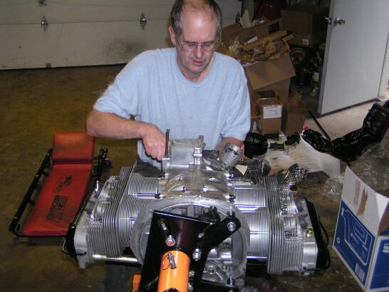

We're starting to get this thing buttoned up. I cut the pushrods today so we finished the valve train adjusted the valves to 0.0 lash (that's what Jake wants), started putting on tin and got the valve covers on.
Here's Gerry putting in one of the oil relief pistons

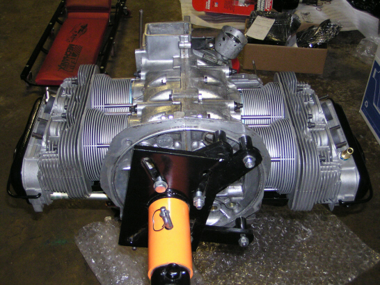

Check this out. It really looks like an engine
