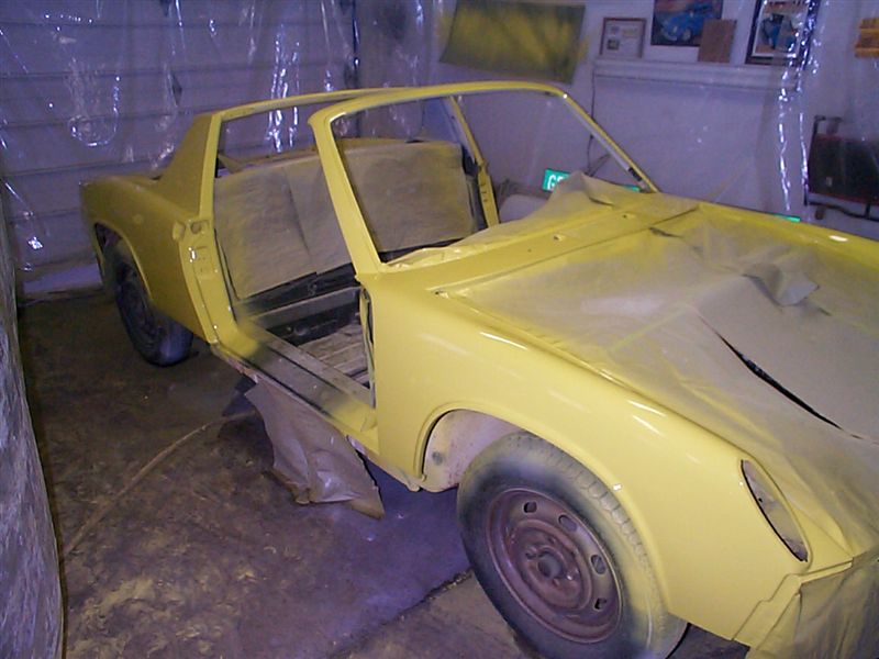

I took the afternoon off yesterday and painted the car. It turned out well, the color is Saturn Yellow, L13M. I made one major screw-up, let's see if you can find it. This car is slated for a 327-300 SBC conversion. Every time I paint I learn something. I am living proof that anyone can paint a car, 90% prep, 5% paint and 5% luck! Since I live in Michigan, any part that is covered, gets a coat or two of Por-15, that's why the door sills and firewall are not painted. The car was white!

rear fender?

Nope! Must be glare from my 5 year old 1.2 mega pixel POS camera!

did you mean not to do the door sill?

Forgot to paint the inside of the roll bar. I did the same thing. Its a PITA do go back after.

i have made this mistake b4 in painting a 914
you missed the inside of the sail panel.but other wise looks great just tape it off after everything dries and shoot it.

Skline you got it! (IMG:style_emoticons/default/smilie_pokal.gif) I did not realize that I had missed it until three hours after I was done! I was sitting in the car at my son's football practice going over the job in my head and went "Oh Sh#$". Oh well, part of the process.That's one thing, anything you screw up can be fixed when painting a car. This is the third I have done, it is very satisfying, yet very nerve wracking! I get so nervous before I spray that my hands shake, I was still fired up 4 hours after I finished.
For those of you that paint, I tried PPG Omni MBC, it went down well, covered in three coats and was cheap! $66.00 a gallon! All of the basecoat, clear and reducers was less than $180.00, I paid more than that for 3 quarts of Dupont Chromabase by itself. We'll see how it lasts.

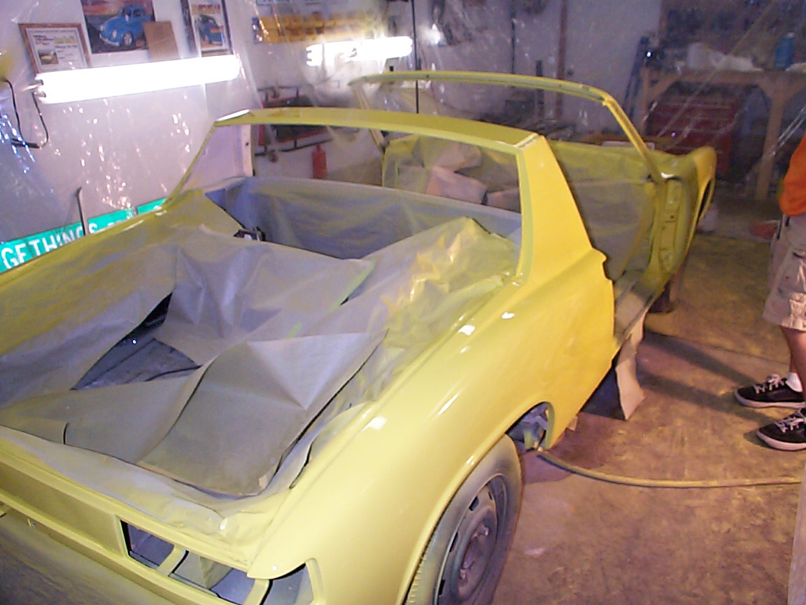

Another pic, I pulled it out into the sun today, it looked totally different. I'll take a pic of that tomorrow.

Looks like you got the garage sealed up pretty well with plastic. How were you able to breathe? SCBA? What method of ventilation did you use and did the neighbors complain about the smell to EPA?

Thomas, I lived in SA for ten years, I flew R/C at Brooks Field all the time, you're right, it is the same feeling, I call it "getting the shaky knees". I talked to a guy last night that paints custom choppers, he said he still get's the shaky knees everytime he paints.
Ctrout, I have a four car garage, I take the end stall and completely enclose it in 3-4 mil plastic from ceiling to floor, then I put a 24 inch by 24 inch filter in the plastic at the front. I then open the garage door enough to put a box fan under it and fill in the sides with plastic. It is not completely air tight, but I have very few if any problems with dust in my clear. The rule of thumb is the paint room should be clear of all overspry in 5 minutes or less. You want just a little negative air pressure. I then pull the car out and blow everything off, then bring the car back in and do the final cleaning and prep, wet the floor and spray away. Since I only paint a car once a year, I can't justify the cost of a fresh air system, I use 3m disposable masks, they block the dangerous isocyanates enough for the limited exposure. There has been a lot of research on this, the fresh air system is the best, but is more geared toward production shop, guys like me can use a mask, I do also wear a suit and goggles. Iso cyantes are mainly acummulative, they are oderless and never leave your kidneys. I wear the mask from the time I open the paint can until I walk out of the garage.
