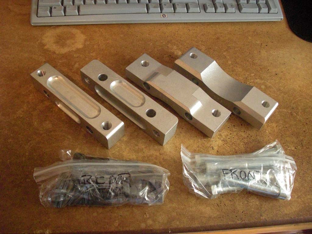

About time too as my Carrera brake pads were down to the metal.
The idea was simple, get rid of the Carrera Calipers and mount Boxster Calipers all around using the mounting adapters from Rich Johnson. Of course, nothing ever goes as planned: (IMG:style_emoticons/default/headbang.gif) First, i failed to read Rich's instructions that clearly state that you have to use a 20mm 911 SC rear rotor. Well, i have 24mm Carrera rear rotors. The Boxster Calipers had to be machined (2mm off each of the brake pad pins) and the adapters had to be milled to center the Boxster Calipers over the wider rotors. (IMG:style_emoticons/default/smash.gif) Then, after everything was bolted together, i recalled reading that the hard brake lines may not be long enough. And sure enough (of course) the front brake lines were about 1" too short. Arrghhh. (IMG:style_emoticons/default/rolleyes.gif) McMark came to the rescue and we made two new lines. (IMG:style_emoticons/default/thumb3d.gif) In the rear, i used banjo fittings on the Calipers (Thanks to Eric Shea for those!) and the rear brakelines were no problem. Mark and i then bled the brakes. I was still getting some air in the front, but it was already 9pm so we decided to call it a night and i drove it home (40+ miles). The brakes actually felt fine, they seem to work great. I'll go back to the OC shop next weekend and we'll bleed them again. (IMG:style_emoticons/default/driving.gif) And now for the pitchers: (IMG:style_emoticons/default/beer3.gif) |

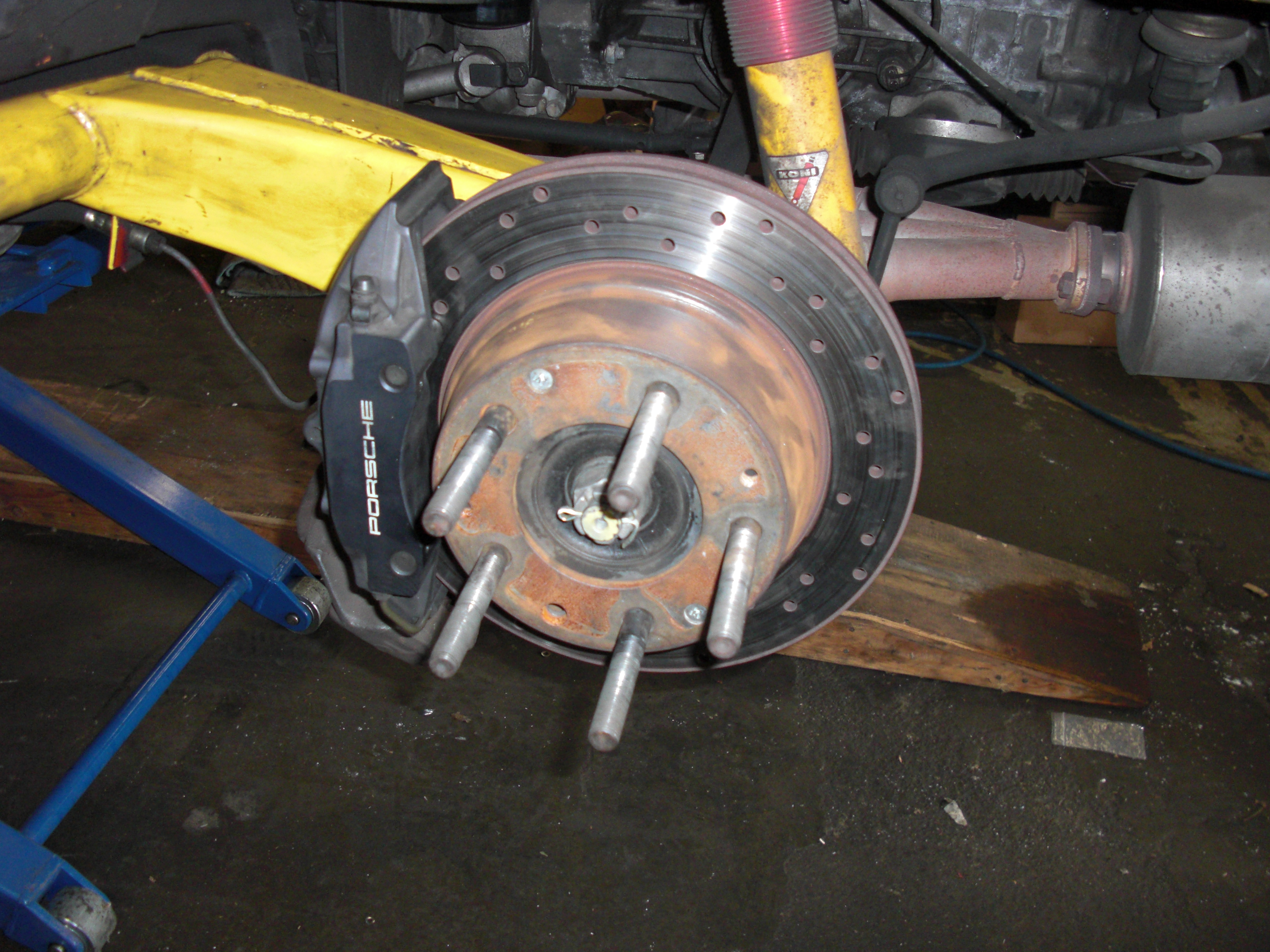

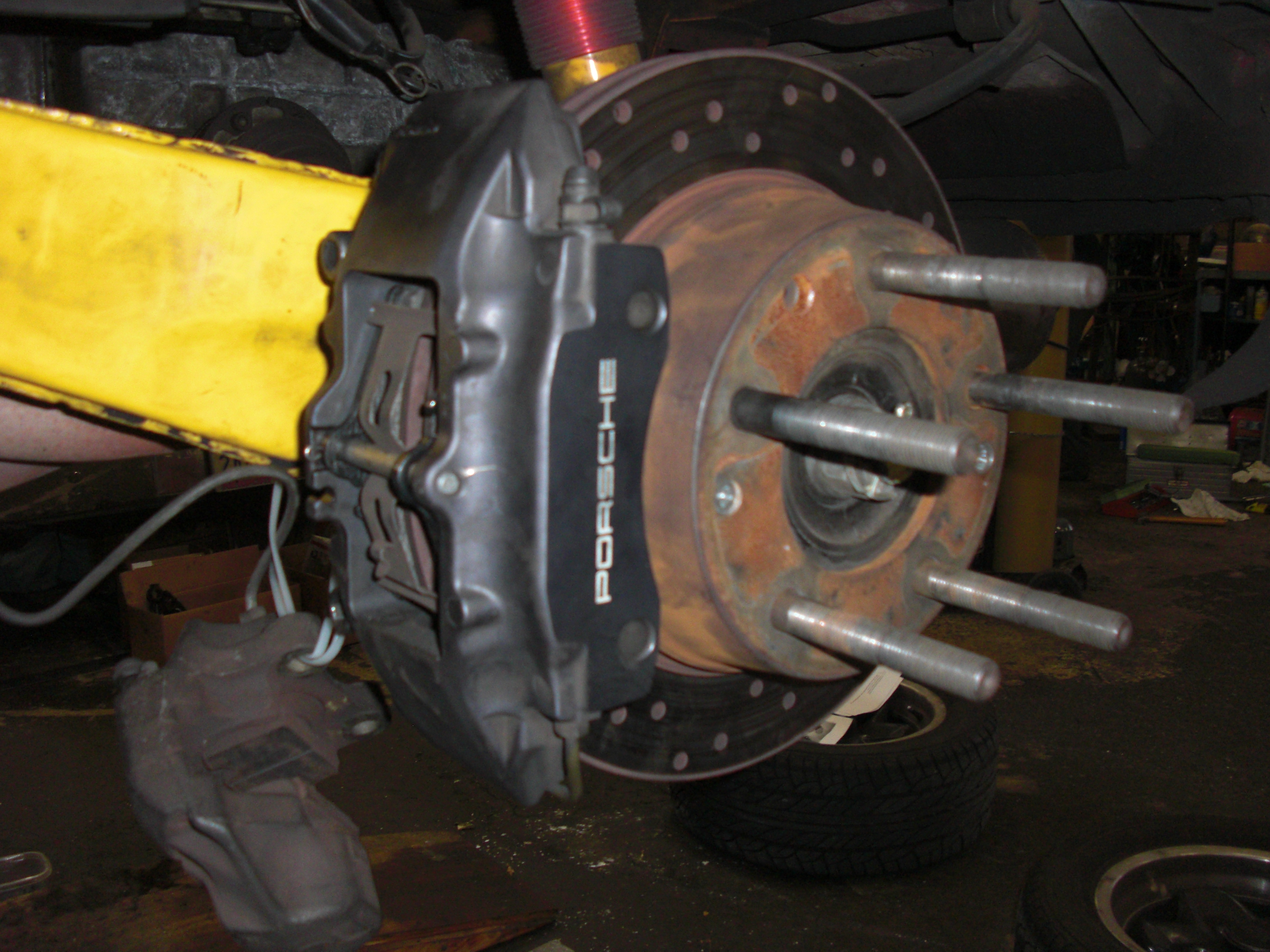

Test fit in the rear:
Attached thumbnail(s) |

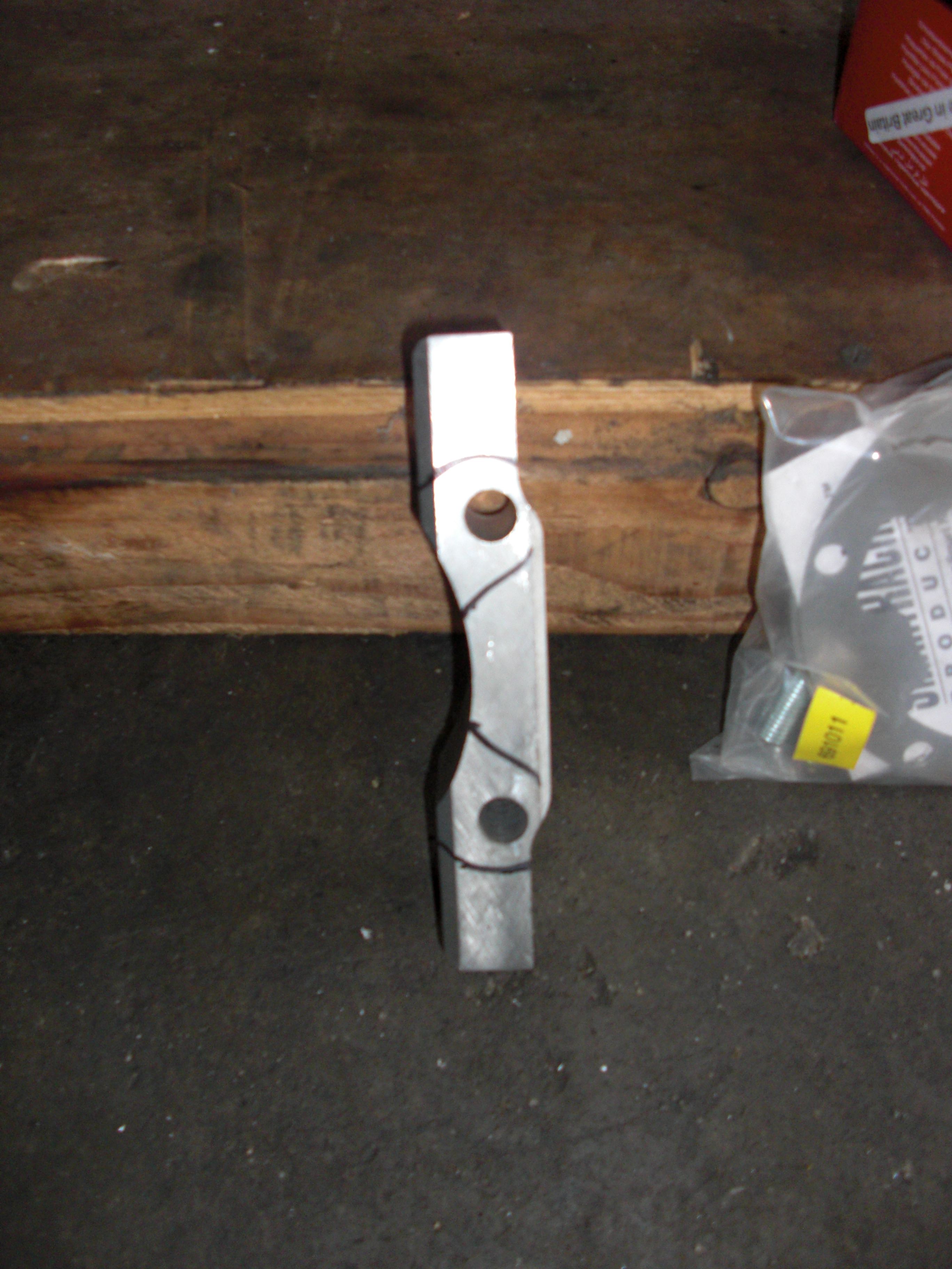

Sharpie marks for milling the adapters so they would center over the 24mm rear rotors:

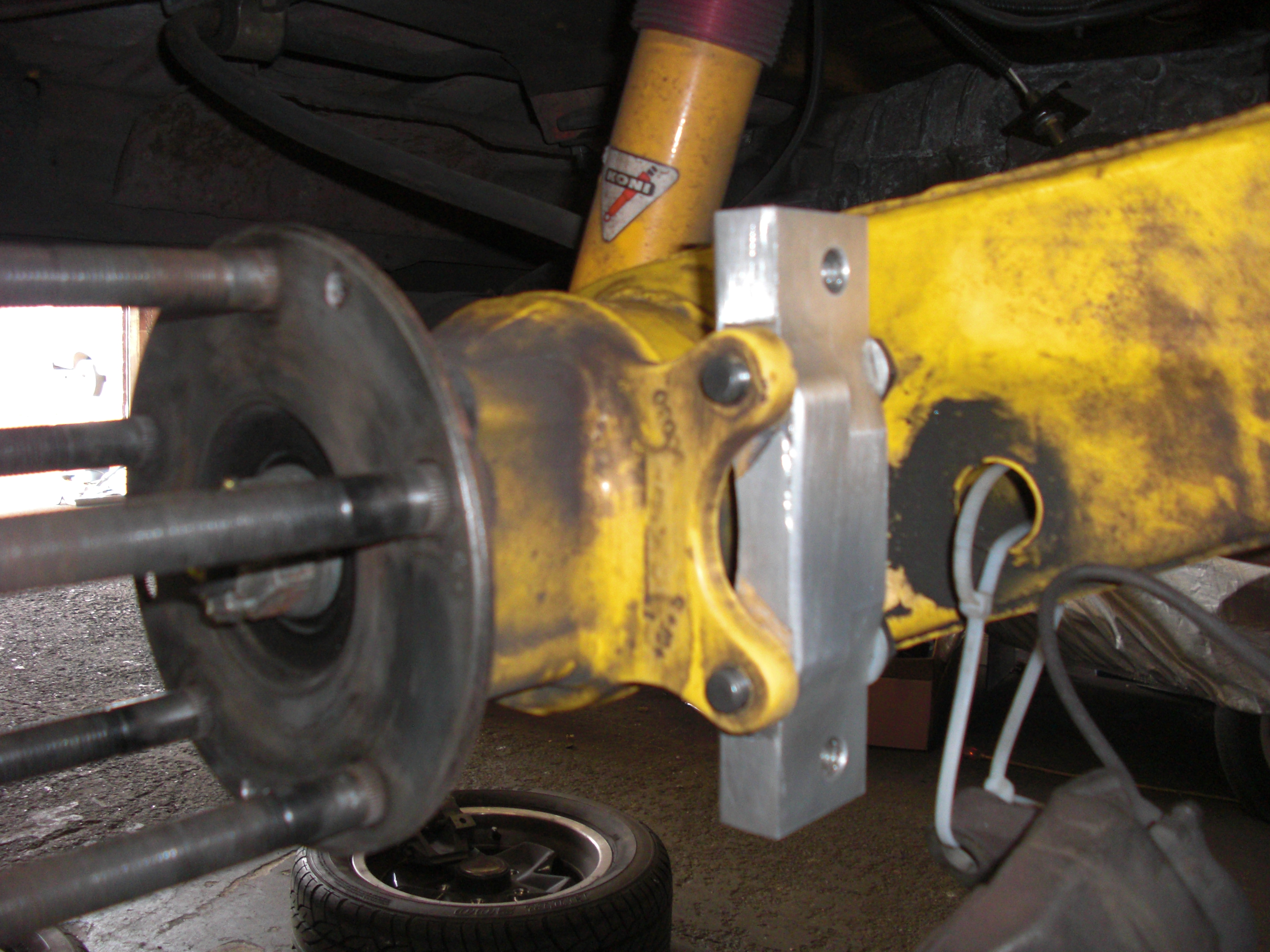

Milled down rear adapter mounted:

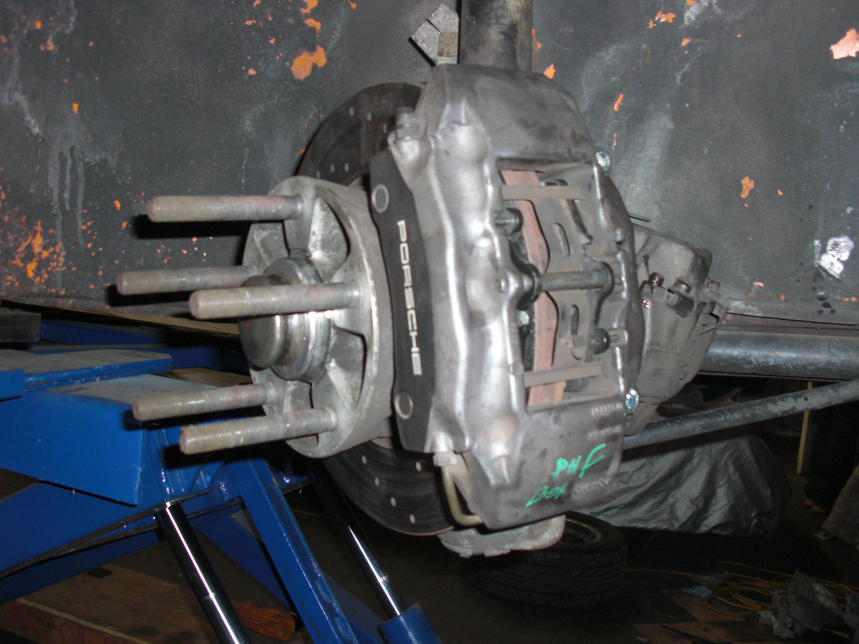

Rear Caliper bolted up:

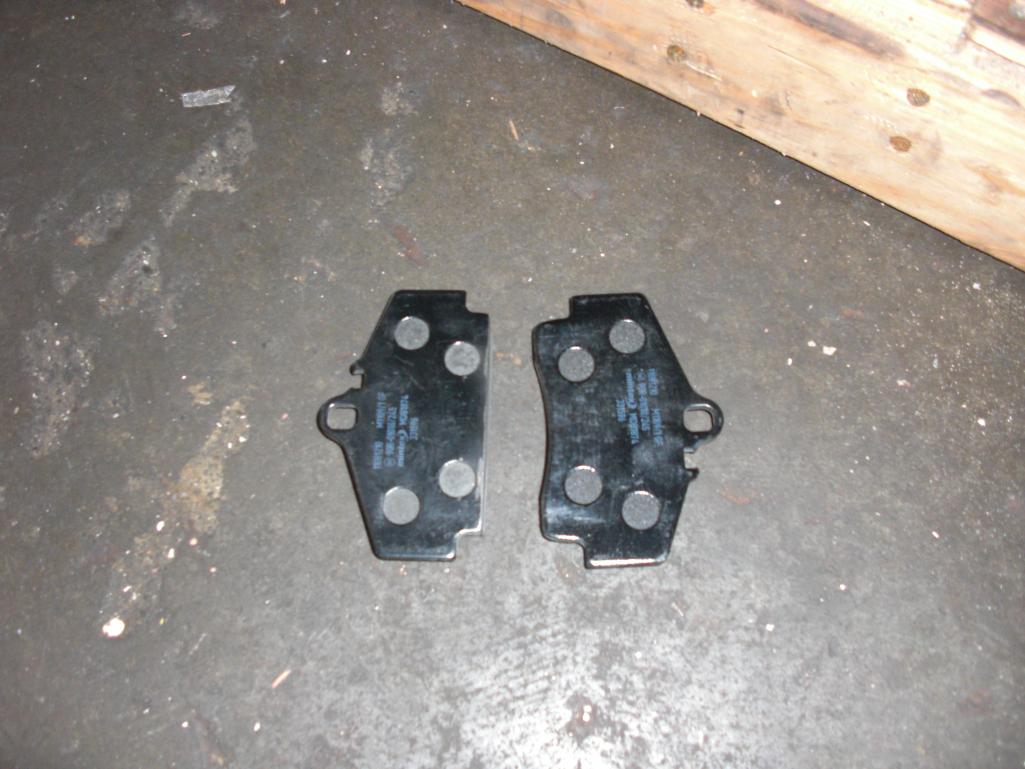

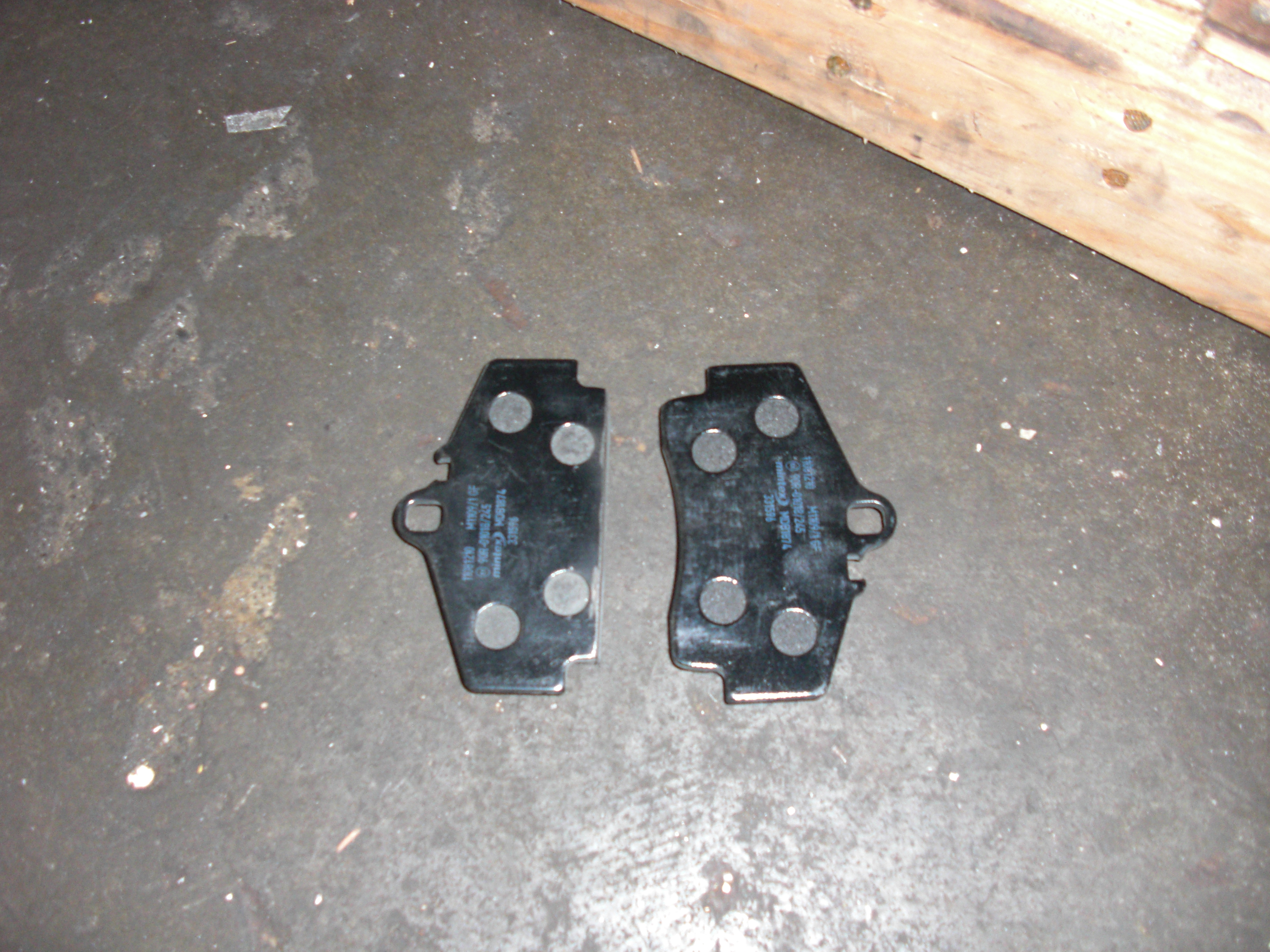

The inner rear pads need to be shaved down a bit as they would otherwise hit the mounting ears (shaved one on the left):

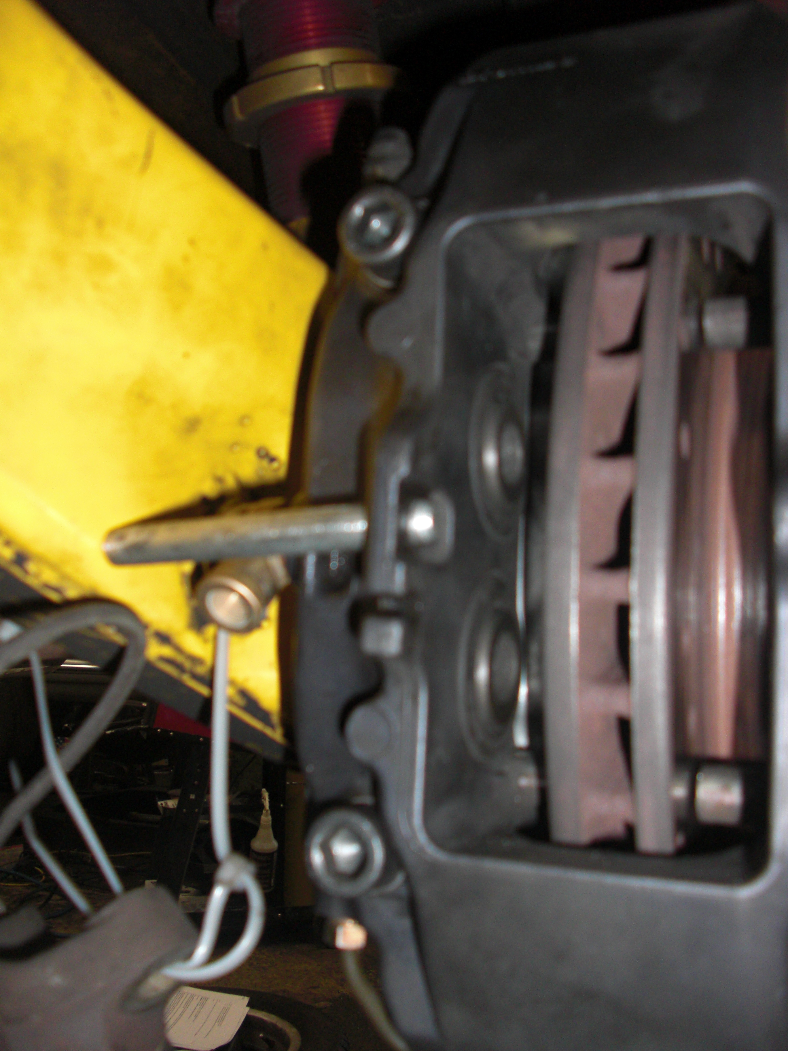

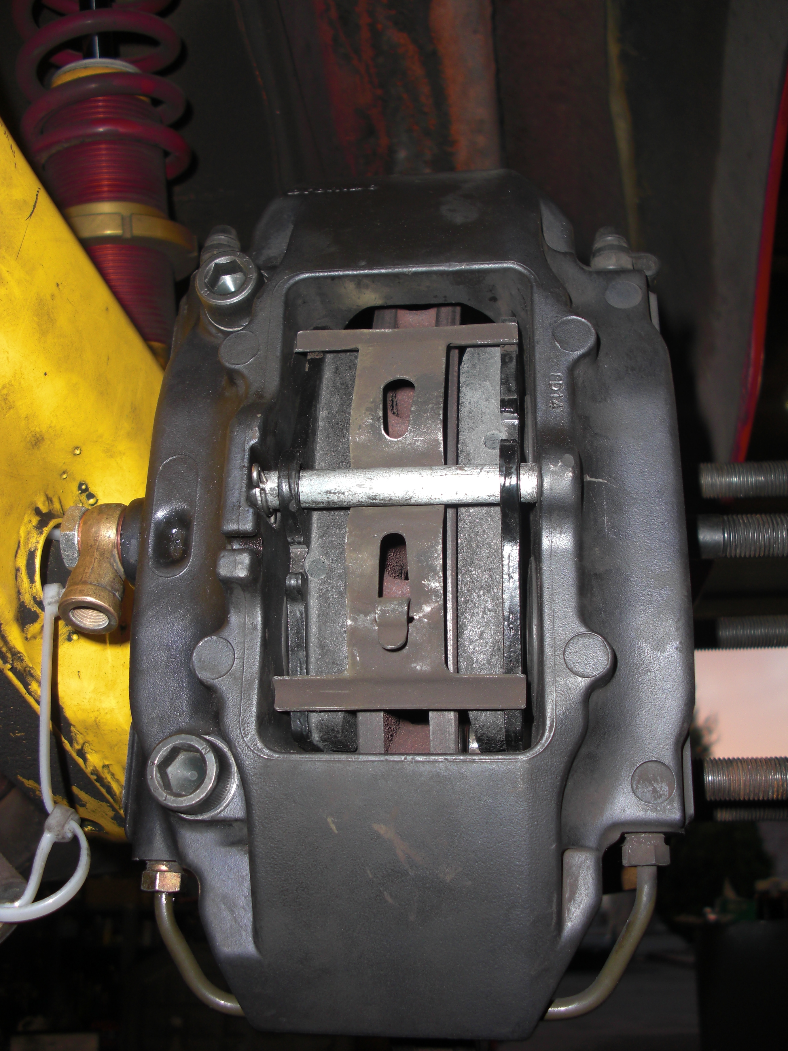

Fuzzy pic of the retaining pin that i cut down to 78mm length. Otherwise it's too long to completely move out of the way to replace the rear brake pads:

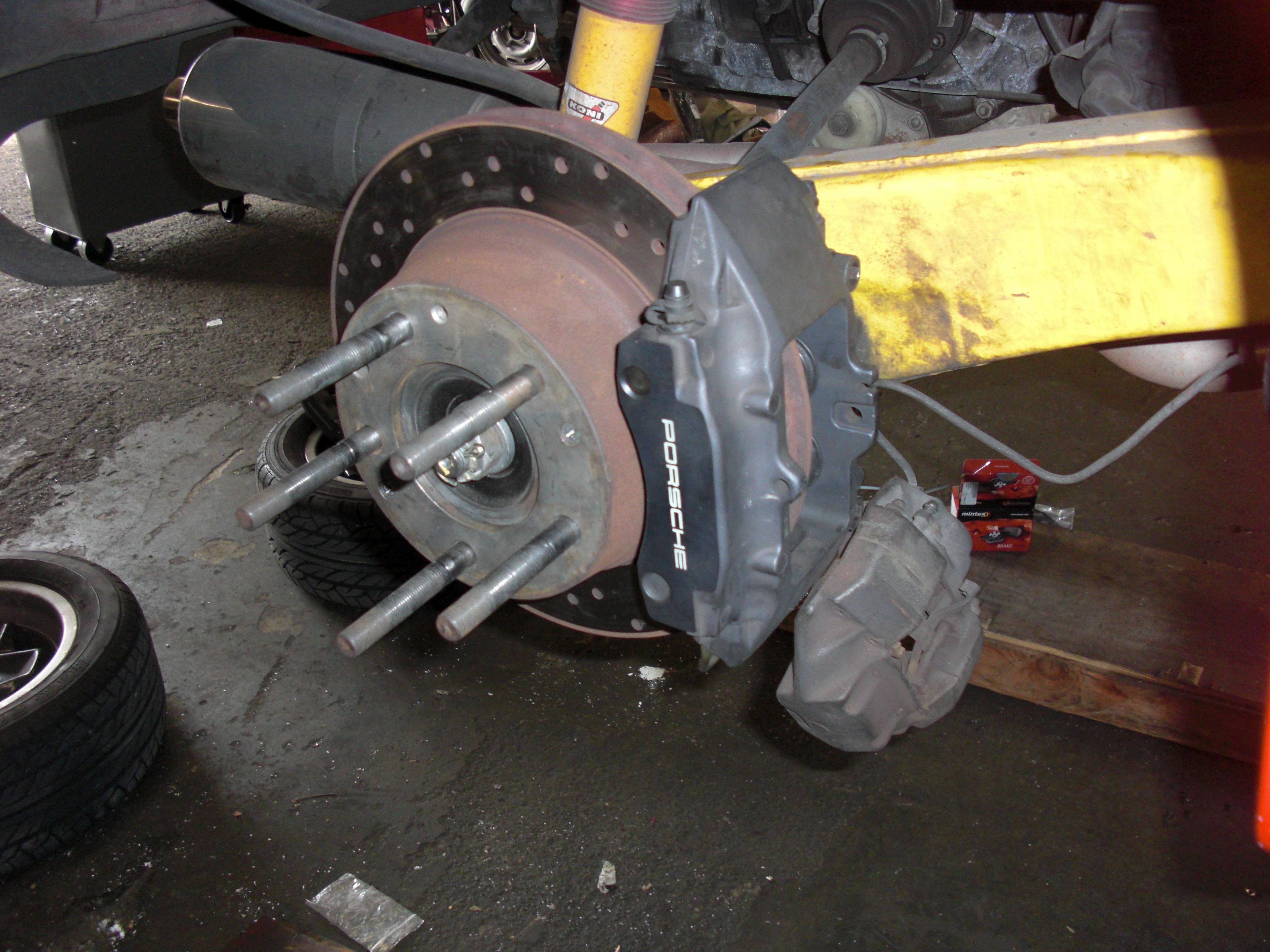

Everything in place. I added some blue loctite to the mounting bolts for the final assembly:

One more, rear all installed:

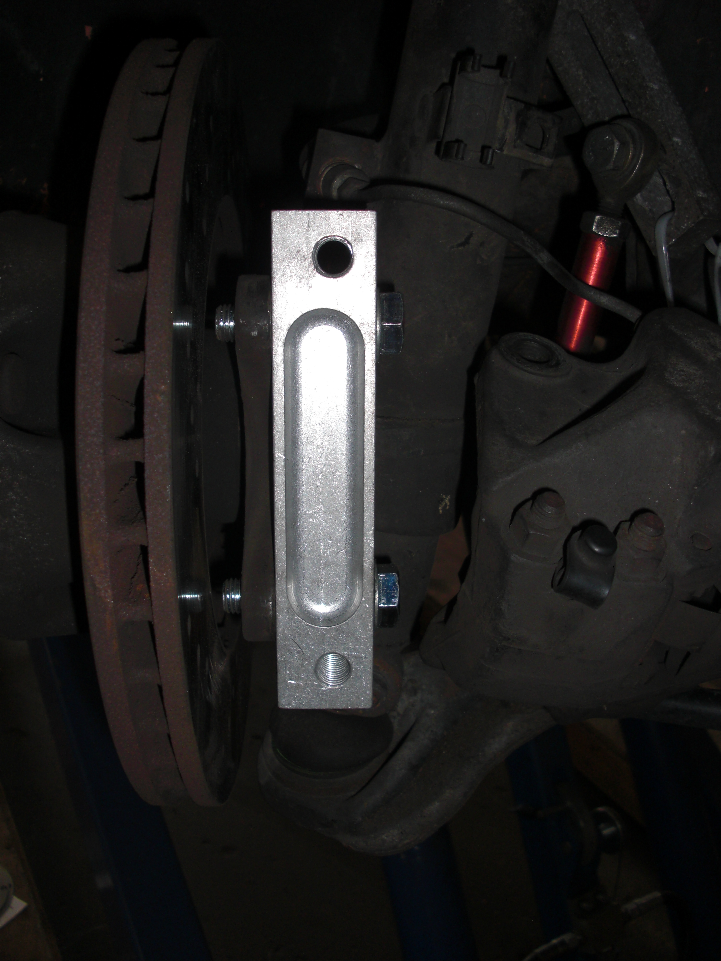

The front went on much easier. Here's the adapter mounted:

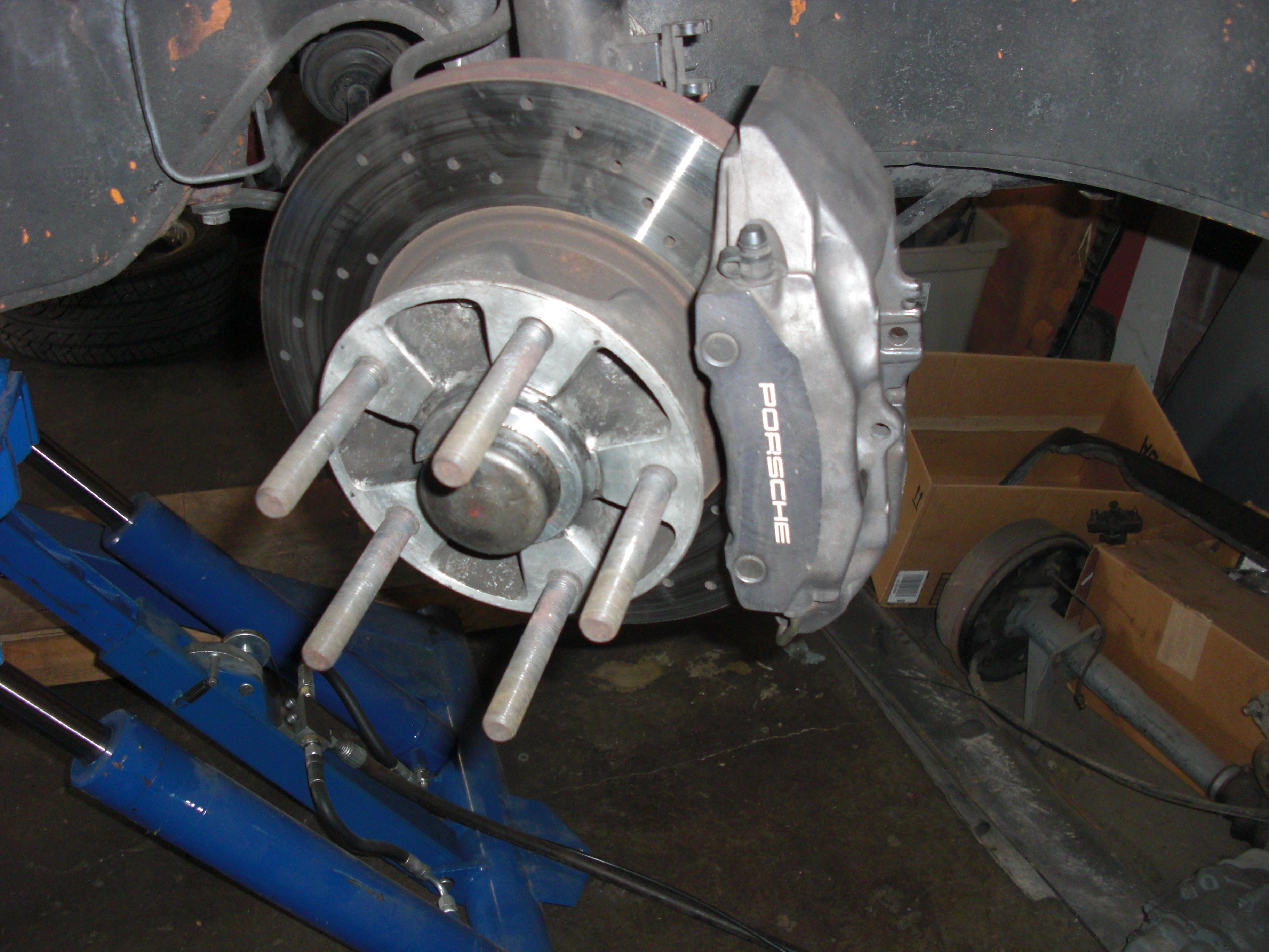

And final assembly:
