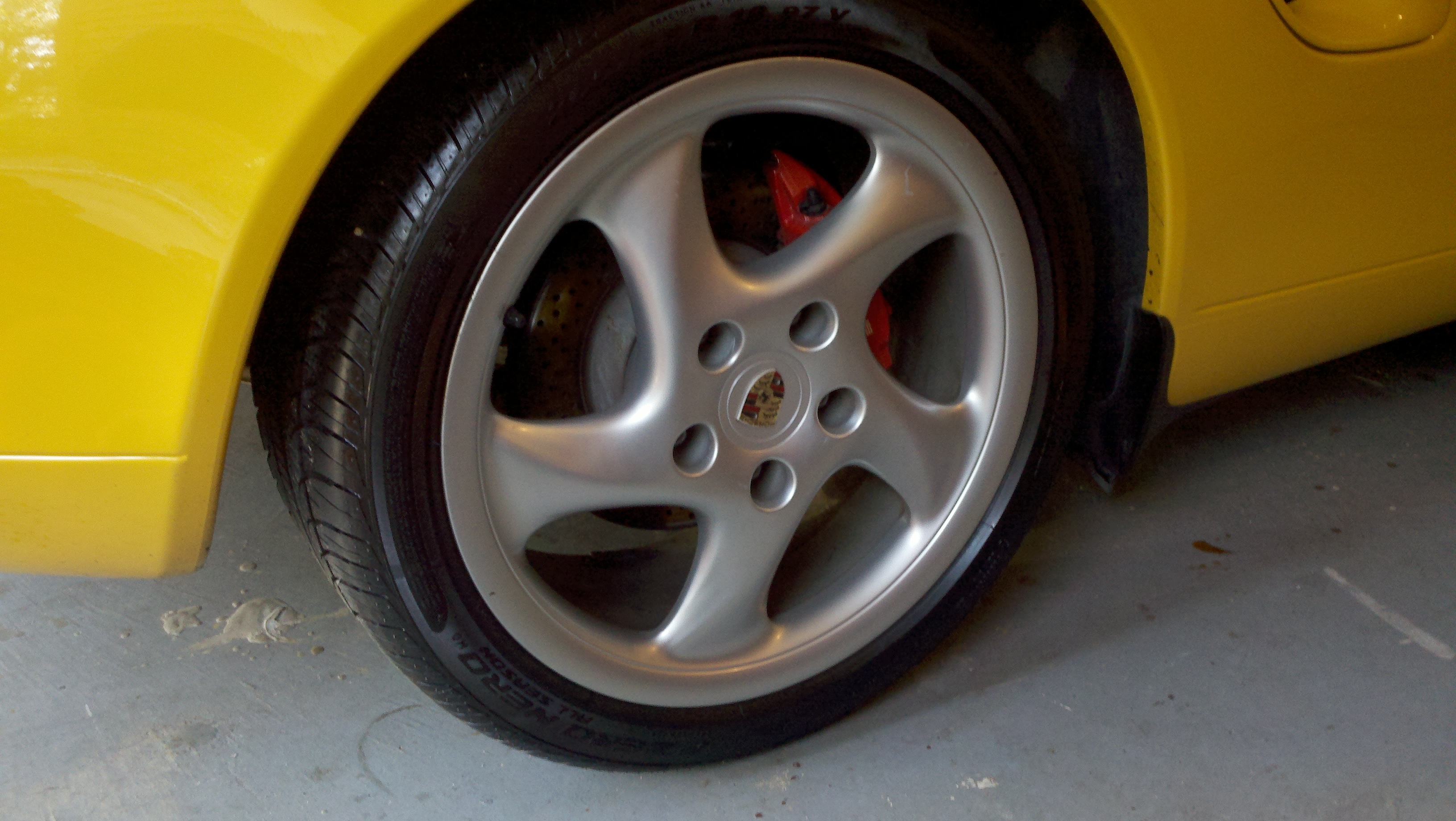

Finally upgraded my brakes like Andy had done. Was running Boxster front and Carerra rear. Using Rich Johnson's beautifully made adapter the task was uncomplicated and as Andy described, but simpler in my case as I went with the SC rotors (20 mm) vice the Carerra (24 mm). I had been running the 24 mm rotors but thought that I'd give the 20 mm ones a try and if I have heat/warping issues can always perform the rest of the mod later and go to 24 mm rotors.
My brake lines had enough room to thread into the caliper without a banjo like Andy used.
Looking forward to trying out this upgrade next month at my first event of the year at Buttonwillow.
