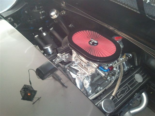

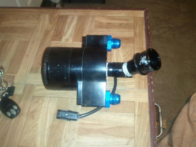

Here is a pictue of the remote mount water pump the guys were talking about. This is what I am running in my car. The pump is about 300.00 and the fittings are about 150.00. Meziere is proud of their stuff so If you can find the fittings elsewhere I am sure they are cheaper. In one of the pictures you can see where I have the WP mounted. DO NOT MOUNT IT THERE. Mount it as low as you can go so the lower radiator is is level as you can get it.
Why mount it low? If you take a water hose and point it straight up, the water only goes so high before it stops and falls back down. If you hold a water hose out level, the stream is rather strong and has good pressure outward. That is the idea you want to accomplish.
Post some pics of your set up.
